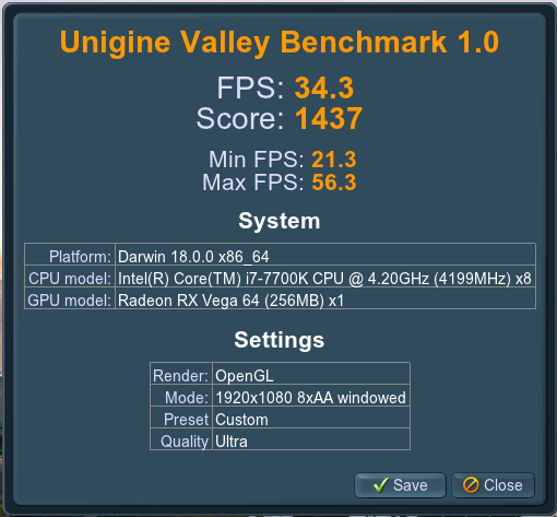

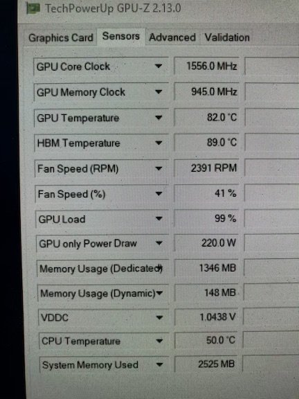

douirc Posted October 21, 2018 Share Posted October 21, 2018 7 hours ago, CMMChris said: My fan also doesn't spin up on Cinebench. Run Valley Benchmark for a while and it will start spinning. Mine turns on once the card reaches 72°C. Thanks for the info! Ran Valley in windowed while monitoring temp/RPM: 36/687 (idle) 40/700 50/700 62/800 65/900 70/1400 72/1500 73/1600 74/1700 (max) back to idle after GPU cools down. Slight coil whine while doing stuff but overall pretty darn good! Thank you @CMMChris Link to comment https://www.insanelymac.com/forum/topic/325120-vega-frontier-edition-on-high-sierra/page/18/#findComment-2642239 Share on other sites More sharing options...

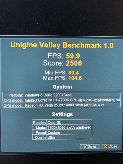

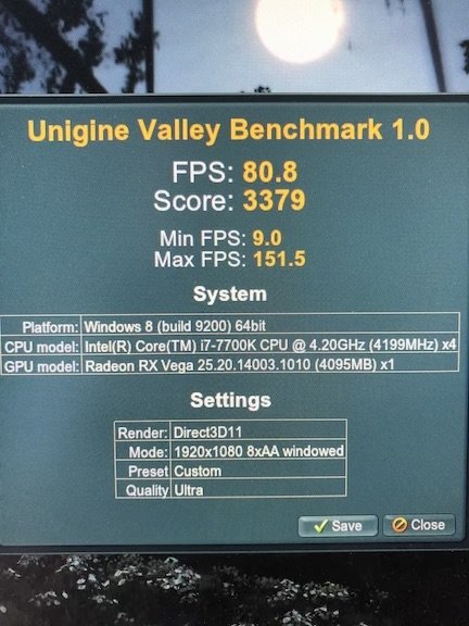

douirc Posted October 21, 2018 Share Posted October 21, 2018 (edited) Here are my results on Win10. I guess the goal with VegaTab_64.kext is keep it cool and safe, not shoot for the limits. I'm ok with that anyway since I dual boot Win10 for gaming. Edited October 21, 2018 by douirc Link to comment https://www.insanelymac.com/forum/topic/325120-vega-frontier-edition-on-high-sierra/page/18/#findComment-2642249 Share on other sites More sharing options...

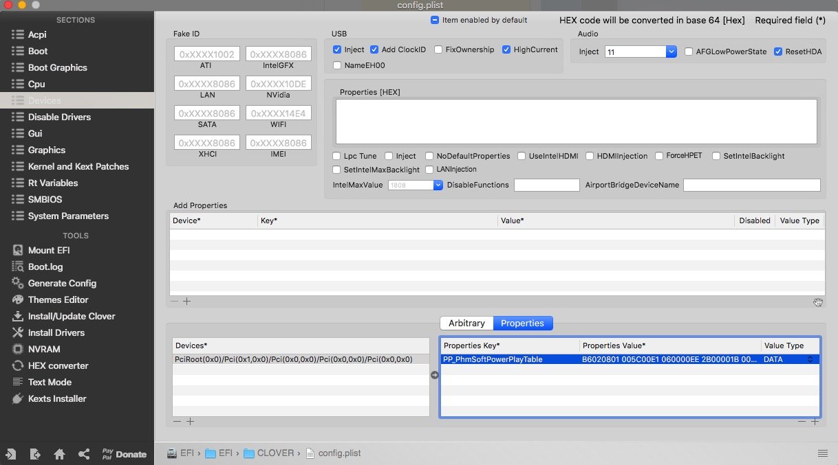

douirc Posted October 26, 2018 Share Posted October 26, 2018 (edited) 8 hours ago, meaganmargaret said: Quote Well, yes it can. The PP_PhmSoftPowerPlayTable doesn't show up normally, but if you download MSIAfterburner and load it up (your AMD Vega card does not have to be MSI, btw - my Vega 64 is an XFX), and go into settings and tick "show extended power adjusts" (Thanks Max!!), the PP_PhmSoftPowerPlayTable will show up in the registry. You will have to massage it some to get the tables to hex version (so that they will show up like the "B6020801 0050....., etc" like CMMChris shows a lot in his VegaTab kexts). Then you can convert them using a couple of different methods. Iodine131 outlined one method in this thread - check page 11 of this thread, his post dated June 21 for that method. If you add in the hex version using Xcode, and then save the file (info.plist), and then open that in Clover Configurator, it will show you the version (text) that usually starts with TGII.... Installed Afterburner but can't find an option under the General tab called Show Extended Power Adjusts. You also said the table will show up in Registry. How do I find that? The only reason I care is because CMMChris's kext causes coil whine after a few hours. Rebooting resolves it but I don't know if it's doing damage. Was hoping copy/pasting the powertable from win 10 to macOS would be the safest bet but after reading more posts in this thread, doesn't look like it's the perfect solution either. Edited October 26, 2018 by douirc Link to comment https://www.insanelymac.com/forum/topic/325120-vega-frontier-edition-on-high-sierra/page/18/#findComment-2643125 Share on other sites More sharing options...

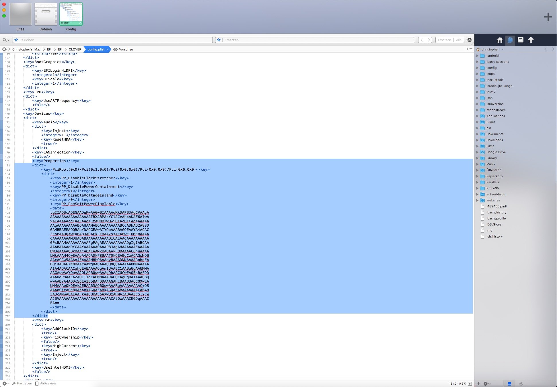

CMMChris Posted October 26, 2018 Share Posted October 26, 2018 (edited) No, don't change system files. Might be overwritten by updates. Either inject your PPT by Kext or Clover Device Properties method. Put this inside your Clover config.plist as shown in the screenshot. <key>Properties</key> <dict> <key>PciRoot(0x0)/Pci(0x1,0x0)/Pci(0x0,0x0)/Pci(0x0,0x0)/Pci(0x0,0x0)</key> <dict> <key>PP_DisableClockStretcher</key> <integer>1</integer> <key>PP_DisablePowerContainment</key> <integer>1</integer> <key>PP_DisableVoltageIsland</key> <integer>0</integer> <key>PP_PhmSoftPowerPlayTable</key> <data> tgIIAQBcAOEGAADuKwAAGwBIAAAAgKkDAPBJAgCVAAgA AAAAAAAAAAAAAAAAAAIBXABPAkYClACeAb4AKAF6AIwA vAEAAAAAcgIAAJAAqAJtAUMBlwHwSQIAcQICAgAAAAAA AAgAAAAAAAAABQAHAAMABQAAAAAAAAABCCADhAO2A88D 6AMBBAEEAQQBAbYDAQGEAwAIYOoAAABAGQEAAYA4AQAC 3EoBAAOQXwEABAB3AQAFkJEBAAZssAEABwEIOMEBAAAA gAAAAAAAAMDUAQABAAAAAAAAAABI6AEAAgAAAAAAAAAA 0PsBAAMAAAAAAAAAAFgPAgAEAAAAAAAAAADgIgIABQAA AAABAAAAaDYCAAYAAAAAAQAAAPBJAgAHAAAAAAEAAAAA BWDqAAAAQBkBAACAOAEAANxKAQAAkF8BAAAACChuAAAA LMkAAAH4CwEAAoA4AQADkF8BAAT0kQEABdCwAQAGwNQB AAcACGw5AAAAJF4AAAH8hQAAAqy8AAADNNAAAARobgEA BQiXAQAG7KMBAAcAAWg8AQAAAQQ8QQAAAAAAUMMAAAAA AIA4AQACAACghgEABAAAAQgAmIUAAEC1AABg6gAAUMMA AAGAuwAAYOoAAJQLAQBQwwAAAgDhAACUCwEAQBkBAFDD AAADeP8AAEAZAQCIJgEAUMMAAARAGQEAgDgBAIA4AQBQ wwAABYA4AQDcSgEA3EoBAFDDAAAGAHcBAAB3AQCQXwEA UMMAAAeQkQEAkJEBAAB3AQBQwwAAARgAAAAAAAAAC+QS AAAoCjcACgBUA5ABkAGQAZABkAGQAZABAAAAAAACAB4H 3ADcANwALAEAAFkAaQBKAEoAXwBzAHMAZABAAJCSl2CW AJBVAAAAAAAAAAAAAAAAAAAAAAACAtQwAAACEGDqAAAC EA== </data> </dict> </dict> This should give you around 28k in Luxmark, 190,000 in Geekbench and a silent card. Edited October 26, 2018 by CMMChris Link to comment https://www.insanelymac.com/forum/topic/325120-vega-frontier-edition-on-high-sierra/page/18/#findComment-2643247 Share on other sites More sharing options...
