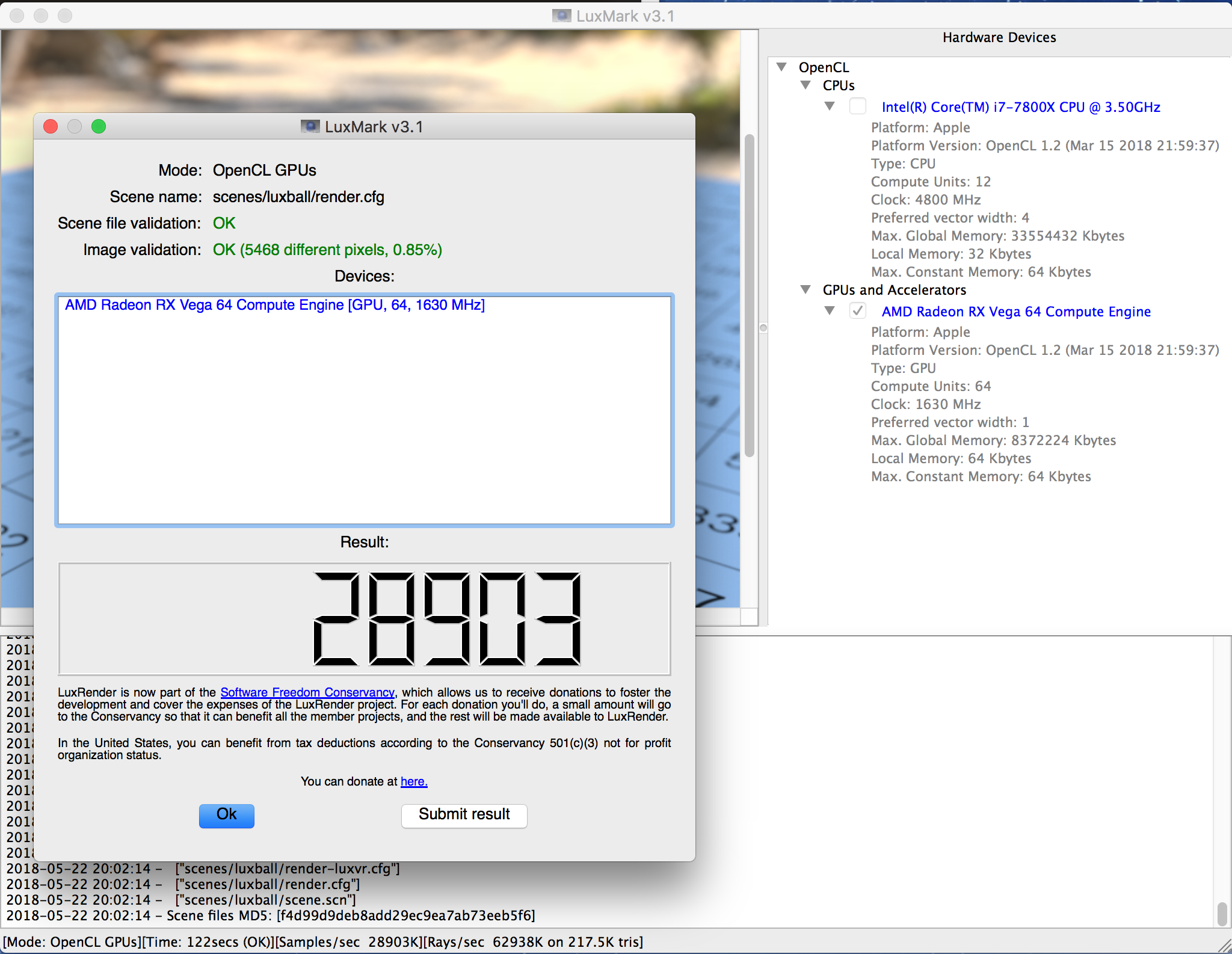

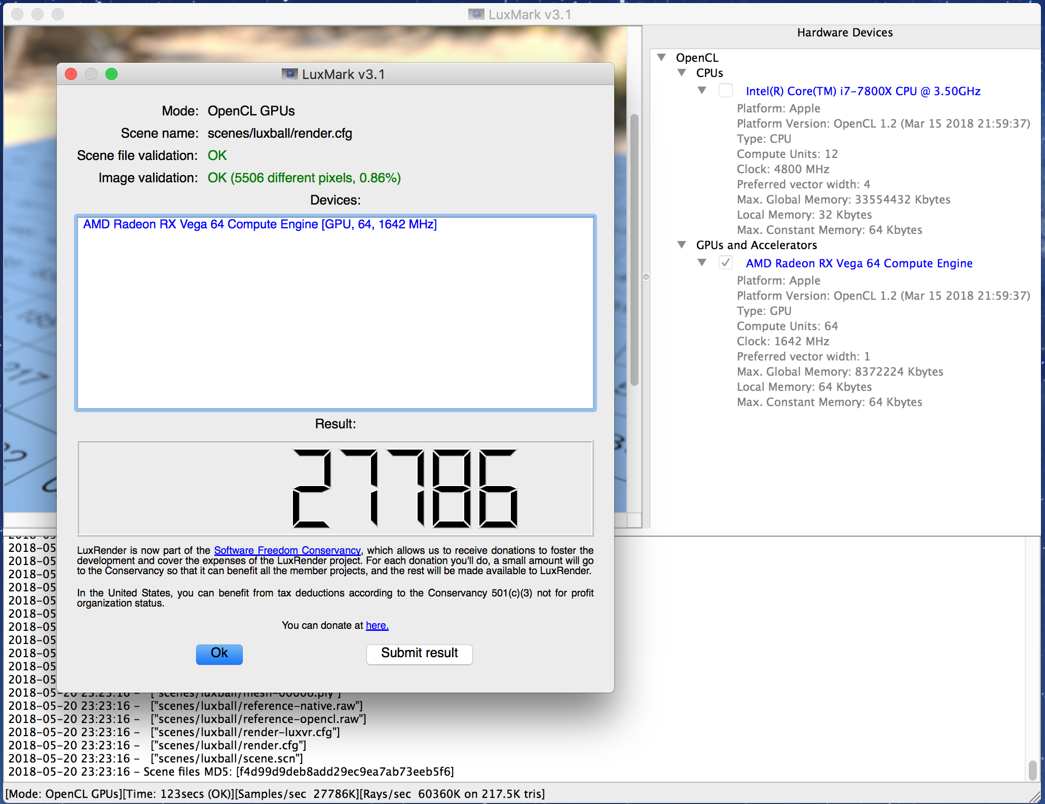

Plasticbomb1986 Posted May 22, 2018 Share Posted May 22, 2018 (edited) And, even better, that we can monitor the card itself, now just need a little application what can get every desired stat value, convert them from hex to decimal and show them on the screen somewhere. Until now i tried hwsensors from slice and from rehabman, one of them show 3 volts on the 12 volt rail and the other one show 127C on the vega GPU (and other little things, what i dont even bother after these issues)... And all of them need some additional kexts... The only thing left to check with this, is the fan curve. I have a Morpheus 2 on the VEGA, with 2 akasa apache 1300RPM fan, and not sure how long it keeps for the systems current fan curve to reach the max 1300 RPM. So currently running them on 1300 RPM at all time. (and its almost too quiet. sometimes i forgot, that i left some app running on the card, and just leave it there, without even think about it... While the card is running on full blast... Edited May 22, 2018 by Plasticbomb1986 Link to comment https://www.insanelymac.com/forum/topic/325120-vega-frontier-edition-on-high-sierra/page/9/#findComment-2614596 Share on other sites More sharing options...
