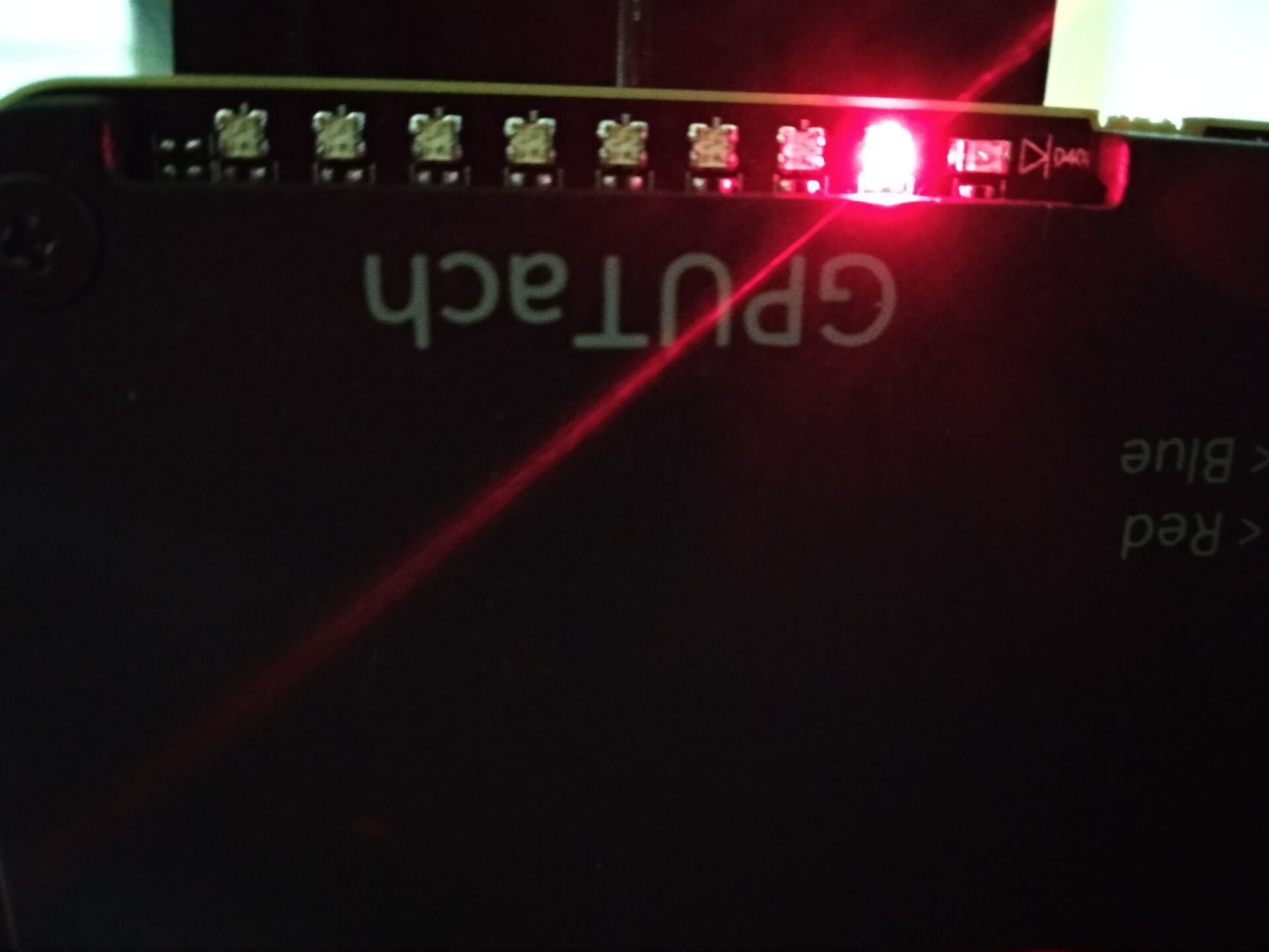

Yangbe Posted October 13, 2018 Share Posted October 13, 2018 (edited) Please Check this GPUTach LED. Compared with Windows, I can see it flicker abnormality in Mac OSX. Anyone has idea?? But, when I open a video with Quicktime, GPUTach LED works great. It is just confusing. Edited October 13, 2018 by Yangbe Link to comment https://www.insanelymac.com/forum/topic/325120-vega-frontier-edition-on-high-sierra/page/17/#findComment-2640459 Share on other sites More sharing options...

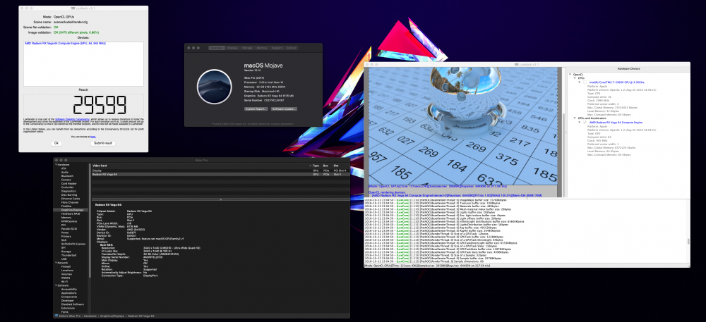

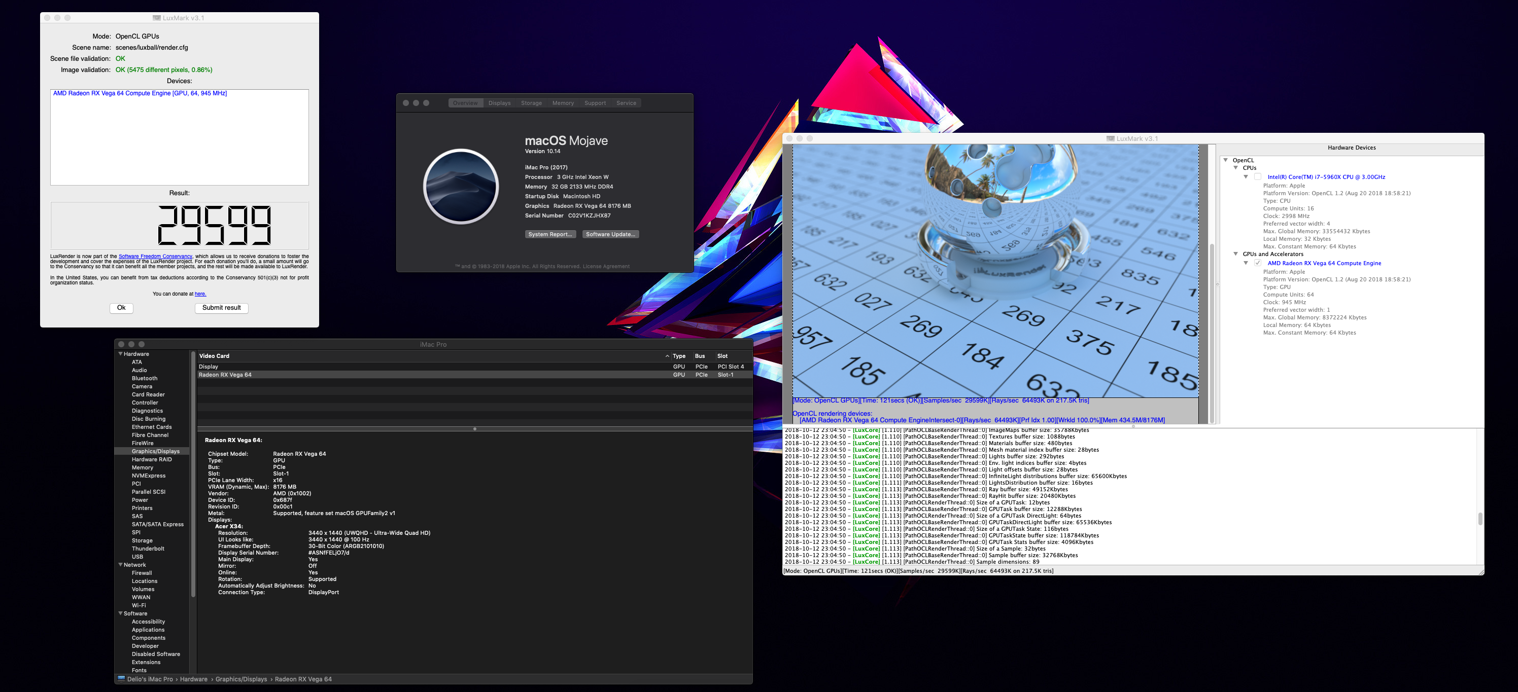

Max.1974 Posted October 13, 2018 Share Posted October 13, 2018 1 hour ago, delioroman said: So, @max.1974, I tested out the 2000rpm kext that you provided last night and at first it ran perfectly! The fans adjusted perfectly under load and the card worked very well! I scored a decent score in LuxMark and was very happy. Here is a screenshot: Unfortunately, my system still suffers the GPU randomly going to 100% utilization randomly and it just stays there until the temps start creeping up. The system now although still functions and doesn't freeze up but I just don't understand why the processor clock just randomly jumps to 100%. I won't have any programs open and it'll randomly jump up to 100%. Sometimes it can be right at boot, or sometimes it doesn't take until 10-15 min until it jumps to 100% and the GPUTach lights will all light up. It is random. I deleted lilu and whatevergreen kexts from Clover/kexts/other folder and no change. So I infer, it must be the ATI10000Controller kext. I am using iStat Menu's to monitor my Vega's temps and clocks. Processor clock max 1600ish MHz and the temps start to creep up from 50C up to 70C. Mine will also do this @Yangbe. Anytime i scroll down on a webpage, the lights will flicker. I guess anytime the GPU processes any data, is when those lights go a little crazy under macOS. Under Windows, the light's are fine. Seems like a driver issue. Windows drivers are much more polished than those on macOS. Hi my friend!! Sorry about the issue ... im just try help you and others guys...im using Lilu and Whatevergreen last release... Try use this please: kexts MOJAVE GM 14.10.zip Use Lilu + Whatevergreen + Fakesmc and another Amd10000controller.kext (good performance and low fan). I hope so you can get fix that!! Link to comment https://www.insanelymac.com/forum/topic/325120-vega-frontier-edition-on-high-sierra/page/17/#findComment-2640616 Share on other sites More sharing options...

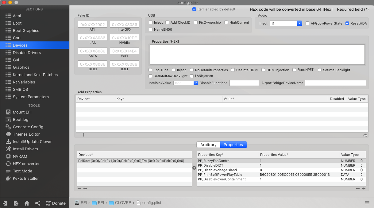

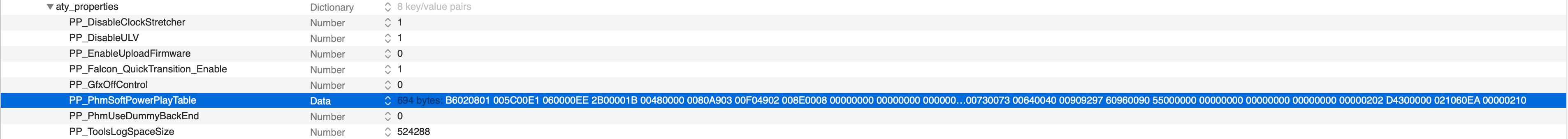

ICULikeMac Posted October 14, 2018 Share Posted October 14, 2018 Hi @max.1974 Thank you again for your replies and continued support. Sorry I probably wasn't clear in my first post, I had previously added a softpowertable in the info.plist as pictured below. This worked and the fans are at idle 700RPM with normal activity; temps around 40c & Luxmark score 30800 so that is fine but all I wanted to know was whether that softpowertable configuration I added is safe for the card I'm running? I just don't know what all the number mean after the entry. Also just to confirm you wanted the info.plist from the AMDController10000.Kext not the clover config.plist from the EFI file right? Thanks again. 1 Link to comment https://www.insanelymac.com/forum/topic/325120-vega-frontier-edition-on-high-sierra/page/17/#findComment-2640675 Share on other sites More sharing options...

Max.1974 Posted October 15, 2018 Share Posted October 15, 2018 On 10/13/2018 at 10:04 PM, ICULikeMac said: Hi @max.1974 Thank you again for your replies and continued support. Sorry I probably wasn't clear in my first post, I had previously added a softpowertable in the info.plist as pictured below. This worked and the fans are at idle 700RPM with normal activity; temps around 40c & Luxmark score 30800 so that is fine but all I wanted to know was whether that softpowertable configuration I added is safe for the card I'm running? I just don't know what all the number mean after the entry. Also just to confirm you wanted the info.plist from the AMDController10000.Kext not the clover config.plist from the EFI file right? Thanks again. Hi My friend!! Im use just 2 settings, because im never change with another or try another...not is good to my Vega... is this: Core: 1642MHz/1150mV, Memory: 1045MHz/1075mV, SOC: 1199MHz, Temp target: 70, Idle fan: 700rpm - probably yours and Core: 1642MHz/1150mV, Memory: 1045MHz/1075mV, SOC: 1199MHz, Temp target: 75, Idle fan: 1000rpm You can choice and just add in softpowertable. Im recommend for you, add in Clover, like CMMChris use, and add with my method here: And settings to choice was here: Sorry im not advanced user, im just use okrasit settings, and try best performance. To me now is very good. Any models can use powersofttable because the Bios is almost the same. So settings are the same, doesn't matter the models...sorry to me if my English is not so acure... I Hope you enjoy this much is I am... Link to comment https://www.insanelymac.com/forum/topic/325120-vega-frontier-edition-on-high-sierra/page/17/#findComment-2640995 Share on other sites More sharing options...
