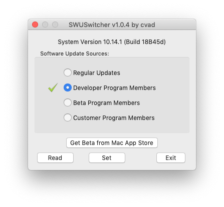

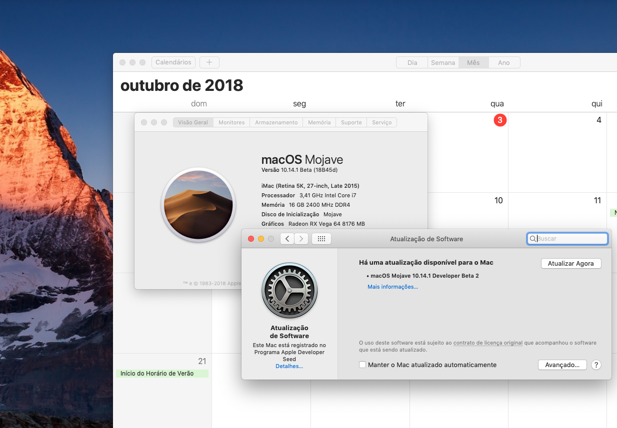

Max.1974 Posted October 3, 2018 Share Posted October 3, 2018 (edited) 50 minutes ago, Moviemakergr said: Are u platinum member, Thanks bro.. Why u steel on High sierra and mojave beta 1 ? Mojave works like charm .. So many thanks bro!! In my job I need some apps that works much better in High Sierra, like e-token to digital signature... this Mojave beta 1 is out after Mojave GM (first release 24 se t2018) ... Developer Program https://www.insanelymac.com/forum/topic/334319-macos-1014-mojave-betas-dps/?do=findComment&comment=2638502 By the way... just out right now beta 2... use SWUSwitcher to set your Mac to receive news betas... SWUSwitcher.zip Edited October 3, 2018 by max.1974 1 Link to comment https://www.insanelymac.com/forum/topic/325120-vega-frontier-edition-on-high-sierra/page/16/#findComment-2638579 Share on other sites More sharing options...

Max.1974 Posted October 6, 2018 Share Posted October 6, 2018 (edited) 6 hours ago, flyfree said: Max, Thanks for sharing this file. You saved my life. Even the graphics card is not the same as yours, it works charmingly so far. Mine is Sapphire RX Vega 64 Nitro+. BTW, can I ask what's the different setting between GM and Beta 1? Hi my friend @flyfree sorry late, im was in travel at work!!! So glad to help you. .. about the differences, About GM, im felling more performance in beta 1 or 2. But if the GM was nice for you, im think that you not need upgrade... a little bit more power and fan issue persist little bit too in betas 1 and 2... GM is good but, not so good (to me) for Amd10000controller.kext. First posts is better quiet and good scores. The last so more loud ... but im hang on... kkkkk You can change only PP_PhmSoftPowerPlayTable (copy and past in info.plist) in any kext AMD10000 version...works for all Vega RX 64 controller Good know that help you!!! So enjoy my friend!!! Many thanks !! Edited October 6, 2018 by max.1974 1 Link to comment https://www.insanelymac.com/forum/topic/325120-vega-frontier-edition-on-high-sierra/page/16/#findComment-2639039 Share on other sites More sharing options...
flyfree Posted October 6, 2018 Share Posted October 6, 2018 58 minutes ago, max.1974 said: Hi my friend @flyfree sorry late, im was in travel at work!!! So glad to help you. .. about the differences, About GM, im felling more performance in beta 1 or 2. But if the GM was nice for you, im think that you not need upgrade... a little bit more power and fan issue persist little bit too in betas 1 and 2... GM is good but, not so good (to me) for Amd10000controller.kext. First posts is better quiet and good scores. The last so more loud ... but im hang on... kkkkk You can change only PP_PhmSoftPowerPlayTable (copy and past in info.plist) in any kext AMD10000 version...works for all Vega RX 64 controller Good know that help you!!! So enjoy my friend!!! Many thanks !! 11 Thanks again, Max. Yes, I'm doing that way you mentioned, changing only PP_PhmSoftPowerPlayTable in AMD10000Controller.kext. I'll report here if there is any issue. 1 Link to comment https://www.insanelymac.com/forum/topic/325120-vega-frontier-edition-on-high-sierra/page/16/#findComment-2639042 Share on other sites More sharing options...

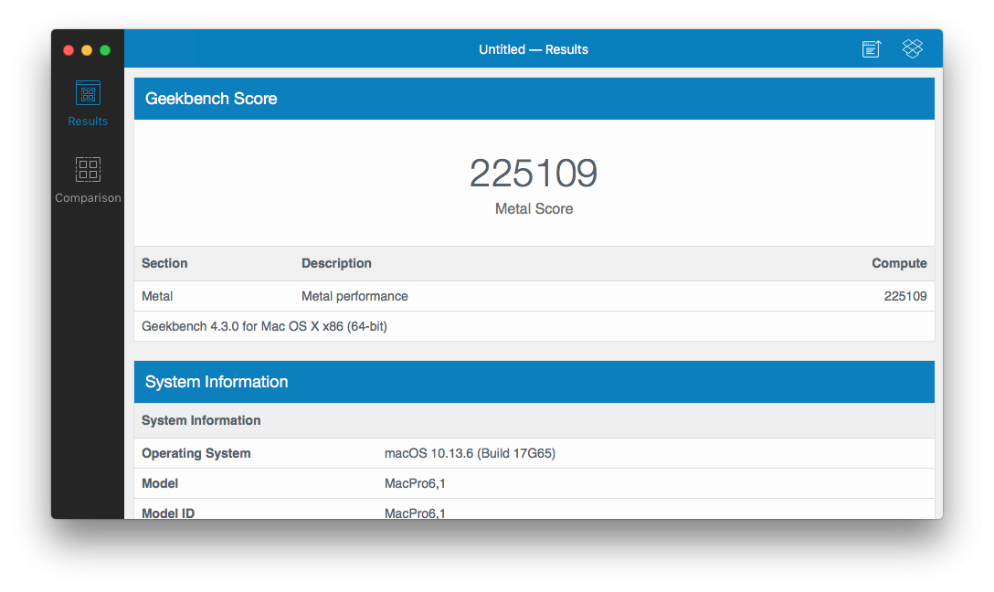

pbryanw Posted October 6, 2018 Share Posted October 6, 2018 (edited) On 10/1/2018 at 10:41 AM, CMMChris said: @okrasit Thanks! I meanwhile fixed it myself though. Created an undervolted custom config with VGTab and 1500MHz max clock that runs stable on my machine. Gets me a solid 185k score in Geekbench and 29k score in Luxmark. Also, coil whine is completely gone. Sweet! @CMMChris - After reading through this thread, and banging my head against the wall because I didn't grasp most of it, your post suddenly made everything make sense for me - thanks! As per your guide, I used VGTab to create custom tables for my Vega 64 (Powercolor Red Devil), then dropped them in my config.plist under Devices ->Properties To get my GPU device address, I used gfxutil (./gfxutil -f display). It turned out to be the same address as your GPU device (so I guess this is probably a standard address for a PCI-E GPU). After this was done, and added to my config.plist, my fans no longer spin up in Mojave after boot (before it usually took 10-20 seconds for them to turn on full blast), so I'm taking this as a sign of your method's success. I've included the relevant portion of my config.plist below, if it might help others, and to see if anyone can see any errors with it. I guess, it would just be a case of changing the data in <key>PP_PhmSoftPowerPlayTable</key> if I want to make any fan/voltage changes in the future? Thanks <key>Devices</key> <dict> <key>Properties</key> <dict> <key>PciRoot(0x0)/Pci(0x1,0x0)/Pci(0x0,0x0)/Pci(0x0,0x0)/Pci(0x0,0x0)</key> <dict> <key>PP_DisableDIDT</key> <integer>0</integer> <key>PP_DisablePowerContainment</key> <integer>1</integer> <key>PP_DisableVoltageIsland</key> <integer>0</integer> <key>PP_FuzzyFanControl</key> <integer>1</integer> <key>PP_PhmSoftPowerPlayTable</key> <data> tgIIAQBcAOEGAADuKwAAGwBIAAAAgKkDAPBJAgBkAAgA AAAAAAAAAAAAAAAAAAIBXABPAkYClACeAb4AKAF6AIwA vAEAAAAAcgIAAJAAqAJtAUMBlwHwSQIAcQICAgAAAAAA AAgAAAAAAAAABQAHAAMABQAAAAAAAAABCCADhAO2A+gD AQQaBDMETAQBAUwEAQGEAwAIYOoAAABAGQEAAYA4AQAC 3EoBAAOQXwEABAB3AQAFkJEBAAZssAEABwEIgDgBAAAA gAAAAAAAAJBfAQABAAAAAAAAAACghgEAAgAAAAAAAAAA sK0BAAMAAAAAAAAAAMDUAQAEAAAAAAAAAADQ+wEABQAA AAABAAAA4CICAAYAAAAAAQAAAPBJAgAHAAAAAAEAAAAA BWDqAAAAQBkBAACAOAEAANxKAQAAkF8BAAAACChuAAAA LMkAAAH4CwEAAoA4AQADkF8BAAT0kQEABdCwAQAGwNQB AAcACGw5AAAAJF4AAAH8hQAAAqy8AAADNNAAAARobgEA BQiXAQAG7KMBAAcAAWg8AQAAAQQ8QQAAAAAAUMMAAAAA AIA4AQACAAAkcQEABAAAAQgAmIUAAEC1AABg6gAAUMMA AAGAuwAAYOoAAJQLAQBQwwAAAgDhAACUCwEAQBkBAFDD AAADeP8AAEAZAQCIJgEAUMMAAARAGQEAgDgBAIA4AQBQ wwAABYA4AQDcSgEA3EoBAFDDAAAGAHcBAAB3AQCQXwEA UMMAAAeQkQEAkJEBAAB3AQBQwwAAARgAAAAAAAAAC+QS AABYAlAACgBUA5ABkAGQAZABkAGQAZABAAAAAAACBBQH 3ADcANwALAEAAFkAaQBKAEoAXwBzAHMAZABAAJCSl2CW AJBVAAAAAAAAAAAAAAAAAAAAAAACAtQwAAACEGDqAAAC EA== </data> </dict> Edited October 8, 2018 by pbryanw 3 Link to comment https://www.insanelymac.com/forum/topic/325120-vega-frontier-edition-on-high-sierra/page/16/#findComment-2639212 Share on other sites More sharing options...
Max.1974 Posted October 6, 2018 Share Posted October 6, 2018 4 hours ago, pbryanw said: @CMMChris - After reading through this thread, and banging my head against the wall because I didn't grasp most of it, your post suddenly made everything make sense for me - thanks! As per your guide, I used VGTab to create custom tables for my Vega 64 (Powercolor Red Devil), then dropped them in my config.plist under Devices ->Properties To get my GPU device address, I used gfxutil (./gfxutil -f display). It turned out to be the same address as your GPU device (so I guess this is probably a standard address for a PCI-E GPU). After this was done, and added to my config.plist, my fans no longer spin up in Mojave after boot (before it usually took 10-20 seconds for them to turn on full blast), so I'm taking this as a sign of your method's success. I've included the relevant portion of my config.plist below, if it might help others, and to see if anyone can see any errors with it. I guess, it would just be a case of changing the data in <key>PP_PhmSoftPowerPlayTable</key> if I want to make any fan/voltage changes in the future? Thanks <key>Devices</key> <dict> <key>Properties</key> <dict> <key>PciRoot(0x0)/Pci(0x1,0x0)/Pci(0x0,0x0)/Pci(0x0,0x0)/Pci(0x0,0x0)</key> <dict> <key>PP_DisableDIDT</key> <integer>0</integer> <key>PP_DisablePowerContainment</key> <integer>1</integer> <key>PP_DisableVoltageIsland</key> <integer>0</integer> <key>PP_FuzzyFanControl</key> <integer>1</integer> <key>PP_PhmSoftPowerPlayTable</key> <data> tgIIAQBcAOEGAADuKwAAGwBIAAAAgKkDAPBJAgBkAAgA AAAAAAAAAAAAAAAAAAIBXABPAkYClACeAb4AKAF6AIwA vAEAAAAAcgIAAJAAqAJtAUMBlwHwSQIAcQICAgAAAAAA AAgAAAAAAAAABQAHAAMABQAAAAAAAAABCCADhAO2A+gD AQQaBDMETAQBAUwEAQGEAwAIYOoAAABAGQEAAYA4AQAC 3EoBAAOQXwEABAB3AQAFkJEBAAZssAEABwEIgDgBAAAA gAAAAAAAAJBfAQABAAAAAAAAAACghgEAAgAAAAAAAAAA sK0BAAMAAAAAAAAAAMDUAQAEAAAAAAAAAADQ+wEABQAA AAABAAAA4CICAAYAAAAAAQAAAPBJAgAHAAAAAAEAAAAA BWDqAAAAQBkBAACAOAEAANxKAQAAkF8BAAAACChuAAAA LMkAAAH4CwEAAoA4AQADkF8BAAT0kQEABdCwAQAGwNQB AAcACGw5AAAAJF4AAAH8hQAAAqy8AAADNNAAAARobgEA BQiXAQAG7KMBAAcAAWg8AQAAAQQ8QQAAAAAAUMMAAAAA AIA4AQACAAAkcQEABAAAAQgAmIUAAEC1AABg6gAAUMMA AAGAuwAAYOoAAJQLAQBQwwAAAgDhAACUCwEAQBkBAFDD AAADeP8AAEAZAQCIJgEAUMMAAARAGQEAgDgBAIA4AQBQ wwAABYA4AQDcSgEA3EoBAFDDAAAGAHcBAAB3AQCQXwEA UMMAAAeQkQEAkJEBAAB3AQBQwwAAARgAAAAAAAAAC+QS AABYAlAACgBUA5ABkAGQAZABkAGQAZABAAAAAAACBBQH 3ADcANwALAEAAFkAaQBKAEoAXwBzAHMAZABAAJCSl2CW AJBVAAAAAAAAAAAAAAAAAAAAAAACAtQwAAACEGDqAAAC EA== </data> </dict> Oh great!! Very good!! would you said how settings are you using? Thanks!!!!! 1 Link to comment https://www.insanelymac.com/forum/topic/325120-vega-frontier-edition-on-high-sierra/page/16/#findComment-2639295 Share on other sites More sharing options...
