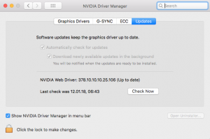

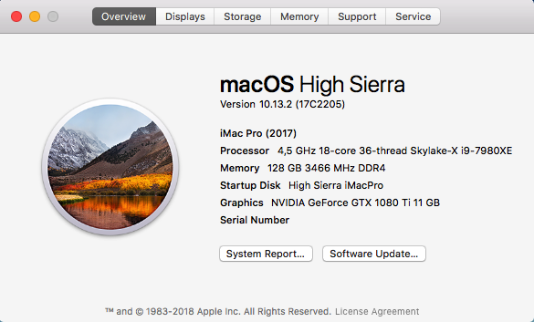

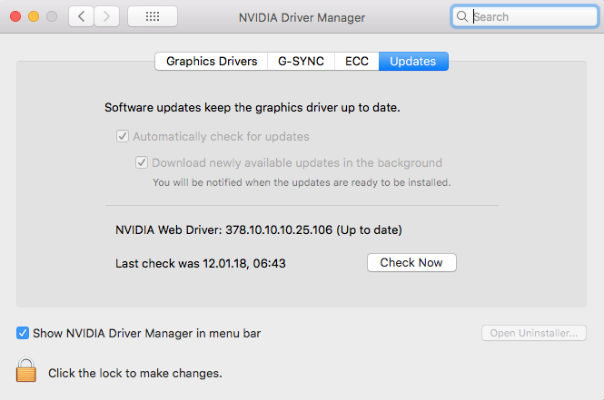

kgp Posted January 12, 2018 Share Posted January 12, 2018 Upon my request from 7 January 2018, Nvidia released today WebDriver-378.10.10.10.25.106 for special iMacPro Build 10.13.2 (17C2205) It took them exactly 4 days to implement the new driver! Perfect work and Hotline Support! Many thanks to Younus, Ray and the Nvdida Team Link to comment https://www.insanelymac.com/forum/topic/324195-nvidia-web-driver-updates-for-macos-high-sierra-update-nov-13-2020/page/38/#findComment-2567668 Share on other sites More sharing options...
fantomas Posted January 12, 2018 Author Share Posted January 12, 2018 There's also a driver .105 for build 17C2120 1 Link to comment https://www.insanelymac.com/forum/topic/324195-nvidia-web-driver-updates-for-macos-high-sierra-update-nov-13-2020/page/38/#findComment-2567687 Share on other sites More sharing options...
kgp Posted January 12, 2018 Share Posted January 12, 2018 There's also a driver .105 for build 17C2120 Yea that's in fact the one I originally asked for. Nvidia finally provided both in one step: WebDriver-378.10.10.10.25.105 - 10.13.12 (17C2120) - special build SMBIOS iMacPro1,1 WebDriver-378.10.10.10.25.106 -10.13.12 SA (17C2205) - Supplemental Update - special build SMBIOS iMacPro1,1 Thanks for the reminder .. Link to comment https://www.insanelymac.com/forum/topic/324195-nvidia-web-driver-updates-for-macos-high-sierra-update-nov-13-2020/page/38/#findComment-2567746 Share on other sites More sharing options...

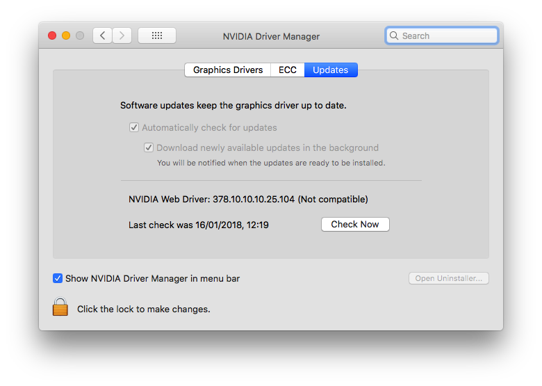

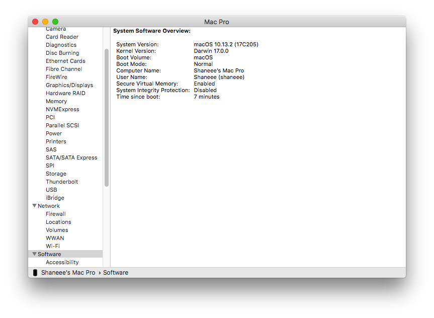

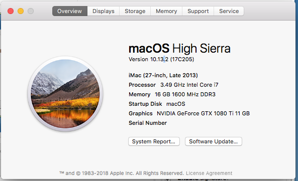

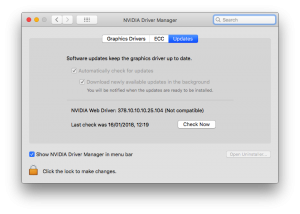

Shaneee Posted January 16, 2018 Share Posted January 16, 2018 I've got a strange one here. I'm using 10.13.2 (17C205) and the correct web drivers for it (378.10.10.10.25.104) Problem is the Nvidia Driver Manager shows incompatible version and no newer version available... MacPro6,1 is in use with the AGDP fixed with hardware in signature. It's not an AMD issue as was fine before the security patch. Anyone else had this issue? Link to comment https://www.insanelymac.com/forum/topic/324195-nvidia-web-driver-updates-for-macos-high-sierra-update-nov-13-2020/page/38/#findComment-2570185 Share on other sites More sharing options...
SavageAUS Posted January 16, 2018 Share Posted January 16, 2018 I've got a strange one here. I'm using 10.13.2 (17C205) and the correct web drivers for it (378.10.10.10.25.104) Problem is the Nvidia Driver Manager shows incompatible version and no newer version available... MacPro6,1 is in use with the AGDP fixed with hardware in signature. It's not an AMD issue as was fine before the security patch. Anyone else had this issue? Make sure your info.plist in /Library/Extensions/NVDAStartupWeb.kext is set to the right NVDARequiredOS. Sent from my SM-G930F using Tapatalk Link to comment https://www.insanelymac.com/forum/topic/324195-nvidia-web-driver-updates-for-macos-high-sierra-update-nov-13-2020/page/38/#findComment-2570197 Share on other sites More sharing options...

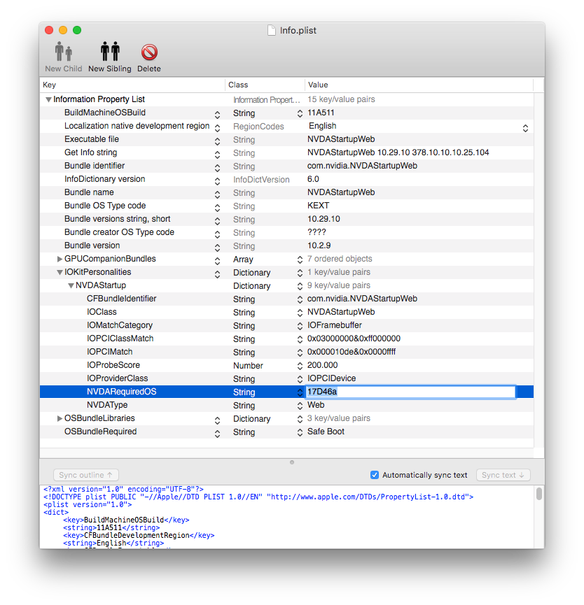

Shaneee Posted January 16, 2018 Share Posted January 16, 2018 Make sure your info.plist in /Library/Extensions/NVDAStartupWeb.kext is set to the right NVDARequiredOS. Sent from my SM-G930F using Tapatalk Yeah first thing I checked. Also tried an uninstall and reinstall of the web drivers, <key>NVDARequiredOS</key> <string>17C205</string> 1 Link to comment https://www.insanelymac.com/forum/topic/324195-nvidia-web-driver-updates-for-macos-high-sierra-update-nov-13-2020/page/38/#findComment-2570200 Share on other sites More sharing options...
Guest Posted January 16, 2018 Share Posted January 16, 2018 Yeah first thing I checked. Also tried an uninstall and reinstall of the web drivers, <key>NVDARequiredOS</key> <string>17C205</string> check also if it is loaded or not and which and where Nvidia kext are located Link to comment https://www.insanelymac.com/forum/topic/324195-nvidia-web-driver-updates-for-macos-high-sierra-update-nov-13-2020/page/38/#findComment-2570206 Share on other sites More sharing options...

MaLd0n Posted January 20, 2018 Share Posted January 20, 2018 Hi, Are there any drivers for 10.13.3 Beta (17D39a)? I cannot install the drivers for 10.13.2. Thanks Just edit NVDAStartupWeb.kext here NVDAStartupWeb.kext.zip u can use it https://cl.ly/oxVO/download/NvWeb_Patcher-V2.zip credits gengik84 3 Link to comment https://www.insanelymac.com/forum/topic/324195-nvidia-web-driver-updates-for-macos-high-sierra-update-nov-13-2020/page/38/#findComment-2572702 Share on other sites More sharing options...

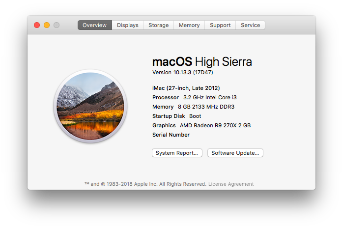

darthsian Posted January 24, 2018 Share Posted January 24, 2018 New Webdriver for 10.13.3 (17D47): https://images.nvidia.com/mac/pkg/387/WebDriver-387.10.10.10.25.156.pkg 5 Link to comment https://www.insanelymac.com/forum/topic/324195-nvidia-web-driver-updates-for-macos-high-sierra-update-nov-13-2020/page/38/#findComment-2575424 Share on other sites More sharing options...
Cyberdevs Posted January 24, 2018 Share Posted January 24, 2018 New Webdriver for 10.13.3 (17D47): https://images.nvidia.com/mac/pkg/387/WebDriver-387.10.10.10.25.156.pkg You beat me to it 1 Link to comment https://www.insanelymac.com/forum/topic/324195-nvidia-web-driver-updates-for-macos-high-sierra-update-nov-13-2020/page/38/#findComment-2575427 Share on other sites More sharing options...

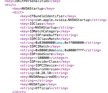

avkills Posted January 24, 2018 Share Posted January 24, 2018 So I just copied the NVDAStartup.kext to my desktop and opened the info.plist under Contents and the string for the required OS was blank; Web driver installed is 378.10.10.10.25.104, and was downloaded from nVidia. Geforce 1080ti seems to be working properly. Since that string is blank, does that mean an update to 10.13.3 should not pose a problem, or should I just wait for the new nVidia Web driver when released. I am kind of concerned since going from 10.13.2 to 10.13.2 SU hosed me big time, since no new nVidia driver was out. I have seen the patching info for the NVDAStartup.kext, but perhaps the string being blank bypasses the check? Can anyone verify this? Link to comment https://www.insanelymac.com/forum/topic/324195-nvidia-web-driver-updates-for-macos-high-sierra-update-nov-13-2020/page/38/#findComment-2575456 Share on other sites More sharing options...

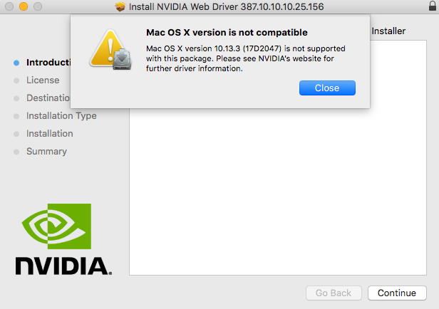

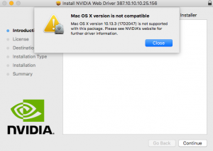

edupedu Posted January 24, 2018 Share Posted January 24, 2018 The latest drivers get automatically pulled from NVIDIA database here https://create.pro/nvidia_drivers Tha latest drivers for "10.13 - 17D47 - 387.10.10.10.25.156" seems to be broken right now, but I hope they get fixed from NVIDIA when available. The link @darthsian posted looks good also. Is it secure to install those drivers as they are not listed on the official lists? Link to comment https://www.insanelymac.com/forum/topic/324195-nvidia-web-driver-updates-for-macos-high-sierra-update-nov-13-2020/page/38/#findComment-2575507 Share on other sites More sharing options...

Awesome Donkey Posted January 24, 2018 Share Posted January 24, 2018 Tha latest drivers for "10.13 - 17D47 - 387.10.10.10.25.156" seems to be broken right now, but I hope they get fixed from NVIDIA when available. Looks like it's bad driver too, it never fully boots correctly. Link to comment https://www.insanelymac.com/forum/topic/324195-nvidia-web-driver-updates-for-macos-high-sierra-update-nov-13-2020/page/38/#findComment-2575532 Share on other sites More sharing options...
