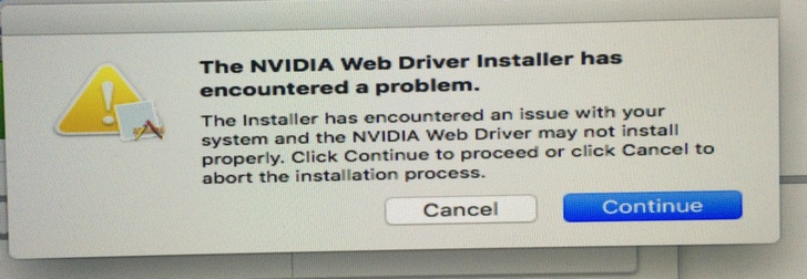

alireza_sh Posted December 26, 2017 Share Posted December 26, 2017 hello for all. I install hackintash h.s 10.13.0 but i can not install nvidia web driver . when i try to install nvidia web driver this error appear. MB:Asus H170 Pro CPU : Intel Core i5 7500 Gpu: Nvidia 960GTX Link to comment https://www.insanelymac.com/forum/topic/324195-nvidia-web-driver-updates-for-macos-high-sierra-update-nov-13-2020/page/36/#findComment-2556601 Share on other sites More sharing options...
Cyberdevs Posted December 26, 2017 Share Posted December 26, 2017 hello for all. I install hackintash h.s 10.13.0 but i can not install nvidia web driver . when i try to install nvidia web driver this error appear. MB:Asus H170 Pro CPU : Intel Core i5 7500 Gpu: Nvidia 960GTX Just click on continue and it will install the driver. Link to comment https://www.insanelymac.com/forum/topic/324195-nvidia-web-driver-updates-for-macos-high-sierra-update-nov-13-2020/page/36/#findComment-2556766 Share on other sites More sharing options...
alireza_sh Posted December 28, 2017 Share Posted December 28, 2017 Just click on continue and it will install the driver. thanks i install it but nvidia web driver not work. Link to comment https://www.insanelymac.com/forum/topic/324195-nvidia-web-driver-updates-for-macos-high-sierra-update-nov-13-2020/page/36/#findComment-2557375 Share on other sites More sharing options...

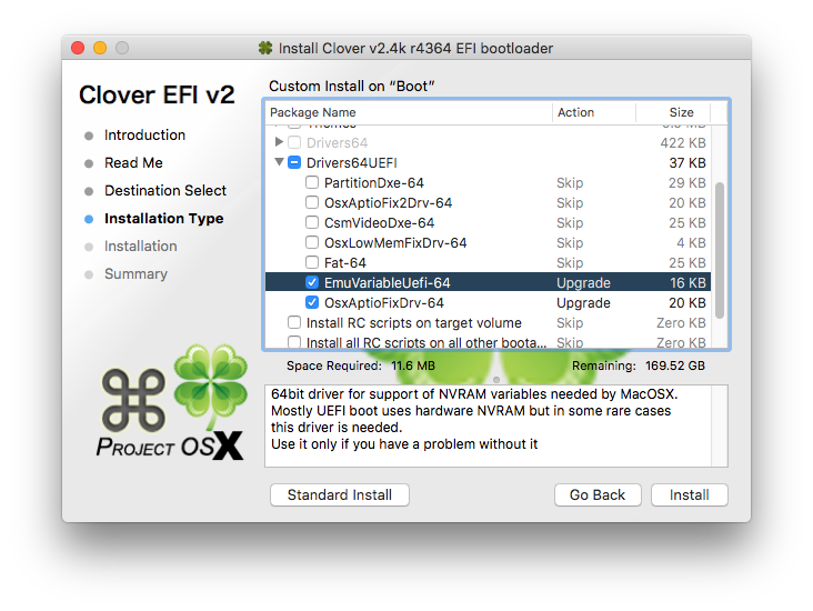

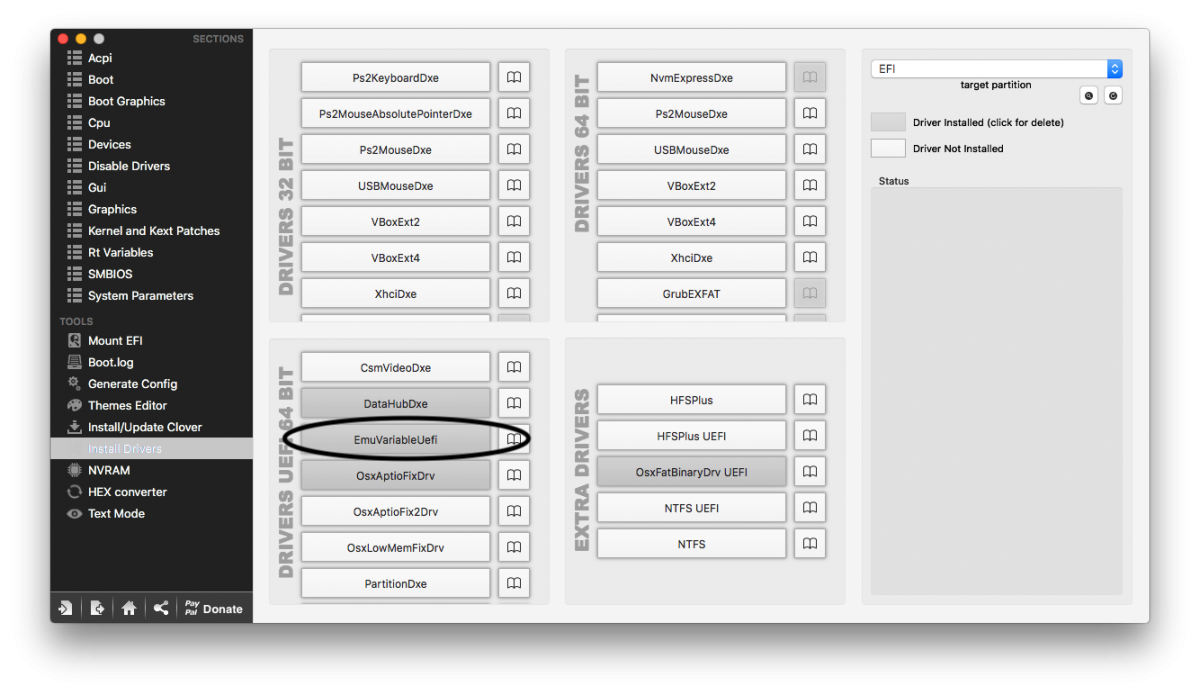

bbmatias3 Posted December 28, 2017 Share Posted December 28, 2017 hey do you have NvidiaGraphicsFixup.kext lilu.kext whatevergreen.kext in your clover , kext folder also you might need EmuVariableUefi-64.efi in EFI-CLOVER-drivers64UEFI you can install this with clover configurator one of the bottom options youll see it then enable web drivers should enable after that (via clover) https://drive.google.com/open?id=1tAIMkZOGEkeawb6Tz3qMwHekHjqox0VW goog luck!! Link to comment https://www.insanelymac.com/forum/topic/324195-nvidia-web-driver-updates-for-macos-high-sierra-update-nov-13-2020/page/36/#findComment-2557376 Share on other sites More sharing options...
Cyberdevs Posted December 28, 2017 Share Posted December 28, 2017 thanks i install it but nvidia web driver not work. Make sure you have the latest version of clover boot loader and the kexts that @bbmatias3 mentioned (NvididaGraphicsFixup and Lilu) and the EMUVariableUEFI64.efi. You don't need whatevergreen it's for AMD GPUs only. Please update your signature with your hardware specs, it will help others to help you easier. You might also need to check the NvidiaWeb flag under the "System Parameters" in your config.plist Link to comment https://www.insanelymac.com/forum/topic/324195-nvidia-web-driver-updates-for-macos-high-sierra-update-nov-13-2020/page/36/#findComment-2557394 Share on other sites More sharing options...

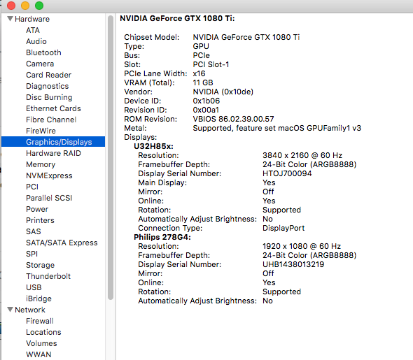

bilbo Posted December 28, 2017 Share Posted December 28, 2017 Hi. Does anyone know if the black screen issue using DVI + Displayport has Been fixed in High Sierra and last version driver? . I have that problem with my two monitors (one with DVI and the another one with Displayport). With the Monitor with Displayport, turned-on on boot I get a blank screen. Displayport doesn't work in any case on Sierra 10.12.6. I was wondering if could be worth update to High Sierra. 1 Link to comment https://www.insanelymac.com/forum/topic/324195-nvidia-web-driver-updates-for-macos-high-sierra-update-nov-13-2020/page/36/#findComment-2557499 Share on other sites More sharing options...

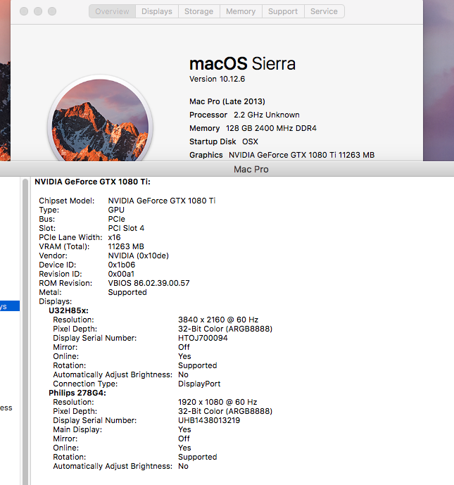

Guest Posted December 28, 2017 Share Posted December 28, 2017 Hi. Does anyone know if the black screen issue using DVI + Displayport has Been fixed in High Sierra and last version driver? . I have that problem with my two monitors (one with DVI and the another one with Displayport). With the Monitor with Displayport, turned-on on boot I get a blank screen. Displayport doesn't work in any case on Sierra 10.12.6. I was wondering if could be worth update to High Sierra. Hi bilbo I have two monitor connected and one in DP and I have no problem at all Now I am on beta 2 but before I was in 10.13.2 Link to comment https://www.insanelymac.com/forum/topic/324195-nvidia-web-driver-updates-for-macos-high-sierra-update-nov-13-2020/page/36/#findComment-2557504 Share on other sites More sharing options...
bilbo Posted December 28, 2017 Share Posted December 28, 2017 Great!! . You made my day!! Trying to fix this issue last 5 days without success. I'm gonna try with high Sierra right now. Did you any special tweak? Link to comment https://www.insanelymac.com/forum/topic/324195-nvidia-web-driver-updates-for-macos-high-sierra-update-nov-13-2020/page/36/#findComment-2557592 Share on other sites More sharing options...

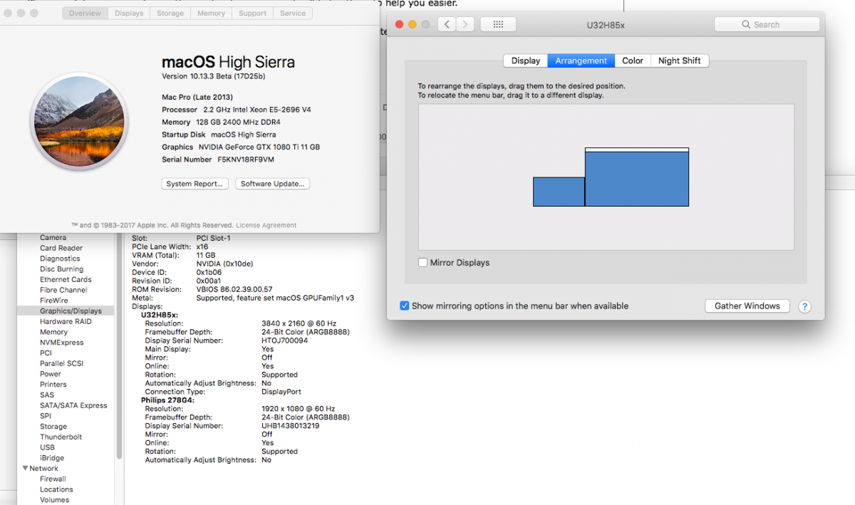

Guest Posted December 28, 2017 Share Posted December 28, 2017 No Bilbo..but bad news for you is that my system starts also fine in 10.12.6 with my spare usb disk (I have tried it now for you) so your problem is different Great!! . You made my day!! Trying to fix this issue last 5 days without success. I'm gonna try with high Sierra right now. Did you any special tweak? Link to comment https://www.insanelymac.com/forum/topic/324195-nvidia-web-driver-updates-for-macos-high-sierra-update-nov-13-2020/page/36/#findComment-2557610 Share on other sites More sharing options...
bilbo Posted December 28, 2017 Share Posted December 28, 2017 ops!! weird.. I have a 1080 ti too.... Could yo tell me if your monitors works with displayport 1.2 or 1.1? is the other monitor connected by DVI? Link to comment https://www.insanelymac.com/forum/topic/324195-nvidia-web-driver-updates-for-macos-high-sierra-update-nov-13-2020/page/36/#findComment-2557655 Share on other sites More sharing options...
Guest Posted December 28, 2017 Share Posted December 28, 2017 I think 1.2 other one is in HDMI ops!! weird.. I have a 1080 ti too.... Could yo tell me if your monitors works with displayport 1.2 or 1.1? is the other monitor connected by DVI? Have you patched Applegraphics policy? What do you mean with "Blank screen"? black screen on dp monitor and correct signal on DVI? Link to comment https://www.insanelymac.com/forum/topic/324195-nvidia-web-driver-updates-for-macos-high-sierra-update-nov-13-2020/page/36/#findComment-2557660 Share on other sites More sharing options...
bilbo Posted December 28, 2017 Share Posted December 28, 2017 mmm HDMI .... maybe the issue is only DVI + DP. But my main monitor doesn't have HDMI. Yes, I'm aware of the black screen problem. I use lillo and NvidiaGraphicsFixup without problems. The issue is when I connect the second monitor with DP. And I see a lot of people with same problem. I have installed my new 1080 ti this morning on my rig under sierra, without reinstall anything. Maybe a clean install of the SO do the magic. Generating the new usb installer righ now. Link to comment https://www.insanelymac.com/forum/topic/324195-nvidia-web-driver-updates-for-macos-high-sierra-update-nov-13-2020/page/36/#findComment-2557666 Share on other sites More sharing options...
Guest Posted December 28, 2017 Share Posted December 28, 2017 DP Monitor is a 4k monitor? In bad condition you can operate with dvi monitor? Link to comment https://www.insanelymac.com/forum/topic/324195-nvidia-web-driver-updates-for-macos-high-sierra-update-nov-13-2020/page/36/#findComment-2557667 Share on other sites More sharing options...
bilbo Posted December 28, 2017 Share Posted December 28, 2017 No. Eizo 246. HD monitor. To use with DP because of professional reason (I work on video). On HDMI it doesn´t support 1920x1200 and gives me a KP if I boot with the monitor sitched on. The other monitor (main) is an old but honorable dell, only with DVI as digital output. My first attemp with High Sierra has been a complete faliure. KP. Again , as usual, with every new version , a new battlefield shows up. And I'm still dealing with Sierra. So I'm going to reinstall Sierra from scratch. Could be a liitle more specific about your monitors setup.? If what works is HDMI+DP , and the wrong combination is DVI + "whatever" I´m ready to buy a new monitor with HDMI as main monitor plus my Eizo DP. But I have to be sure. Thanks Link to comment https://www.insanelymac.com/forum/topic/324195-nvidia-web-driver-updates-for-macos-high-sierra-update-nov-13-2020/page/36/#findComment-2557744 Share on other sites More sharing options...
bilbo Posted December 28, 2017 Share Posted December 28, 2017 Finally , the problem is fixed (a sort of). I re-installed Sierra again, updated to last security update, and installed appropiated driver. With the monitor with DP switched on, system goes to black. But , If I left it turned off, boot only with DVI monitor, and I turn it on only after get to desktop ...now it works .... and both of them perfectly recognized. It's not perfect but enough for me. Thanks for your info, fabiosun, it has been very useful to keep trying. And sorry for the off - topic Link to comment https://www.insanelymac.com/forum/topic/324195-nvidia-web-driver-updates-for-macos-high-sierra-update-nov-13-2020/page/36/#findComment-2557823 Share on other sites More sharing options...

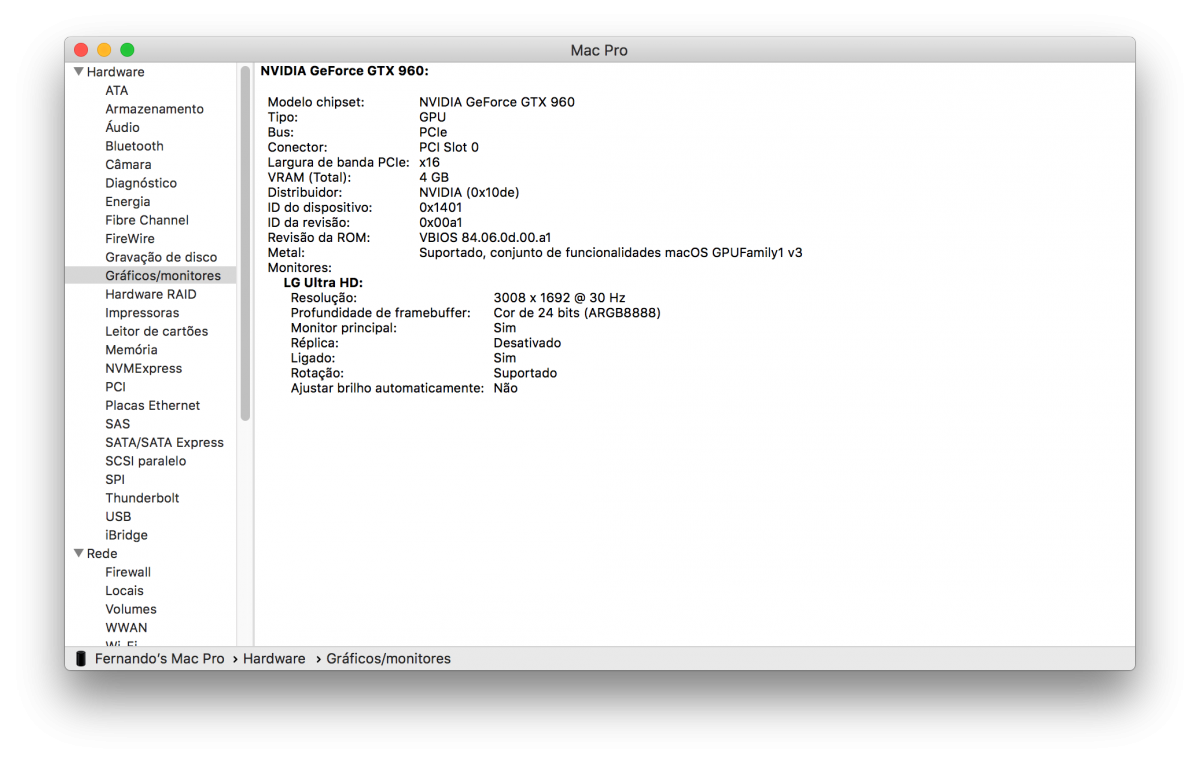

Fergarth Posted December 28, 2017 Share Posted December 28, 2017 Finally I got high resolution graphics again. But not by DP, only by HDMI. I would prefer the 60Hz of the DP but unfortunately after the Clover's boot it only goes in no signal. For HDMI works but in high resolution only makes 30Hz and the graphics do not flow as well. If I select high resolution HDMI at 60Hz, it loses the signal as well. For me, something changed from 13.2 or was it in the OS or the Nvidia Driver. I've always used DP and I've never had problems.And yes I did all the possible tests being the last one a new OS installation...?? Link to comment https://www.insanelymac.com/forum/topic/324195-nvidia-web-driver-updates-for-macos-high-sierra-update-nov-13-2020/page/36/#findComment-2557841 Share on other sites More sharing options...

Cyberdevs Posted December 30, 2017 Share Posted December 30, 2017 Thanks. I install NvididaGraphicsFixup and Lilu kext but i dont konw how do i install EMUVariableUEFI64.efi But i can not install nvidia web driver .when i erase hdd i have two partition :EFI and main partition after install mac os x both partitions have EFI directory .i install clover bootloder.where dose i install this kext? You can use the Clover installer and from the "Drivers64UEFI" select the EmuVaraiableUEFI.efi or You can use clover configurator and mount the EFI partition, Open your config.plist with clover configurator and then select "Install Drivers" and install the EmuVaraiableUEFI.efi from the Drivers UEFI 64 BIT. Link to comment https://www.insanelymac.com/forum/topic/324195-nvidia-web-driver-updates-for-macos-high-sierra-update-nov-13-2020/page/36/#findComment-2558438 Share on other sites More sharing options...
bbmatias3 Posted December 30, 2017 Share Posted December 30, 2017 Thanks. I install NvididaGraphicsFixup and Lilu kext but i dont konw how do i install EMUVariableUEFI64.efi But i can not install nvidia web driver .when i erase hdd i have two partition :EFI and main partition after install mac os x both partitions have EFI directory .i install clover bootloder.where dose i install this kext? I put all the files in the zip file from google drive in the earlier post You can use pandora to mount once you see your efi EMUVariableUEFI64 Goes in EFI-CLOVER-drivers64UEFI (in this folder you put EmuVariableUefi-64.efi) So it goes in drivers64UEFI If your able too boot into Mac make you you don’t have anything selected in graphic settings (in clover) then try to install the drivers If you inject nvidia before you install anything you fill face problems Also I had to use 14,2 smbios to enable web drivers on my i7 4970 18,1 didn’t work for me Link to comment https://www.insanelymac.com/forum/topic/324195-nvidia-web-driver-updates-for-macos-high-sierra-update-nov-13-2020/page/36/#findComment-2558444 Share on other sites More sharing options...
