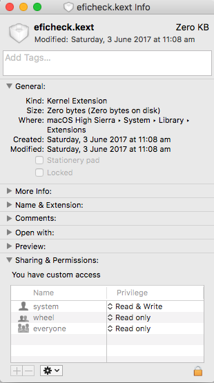

SavageAUS Posted July 11, 2017 Share Posted July 11, 2017 Guys there's a new kext in /S/L/E called eficheck.kext which is an empty kext file with 0 KB. Does anybody know what is it? Ive got it here. Not a "fresh" install but i downloaded the new .app again and installed that on my desktop. I'll check laptop soon as that was an app store update. Link to comment https://www.insanelymac.com/forum/topic/324194-pre-release-macos-high-sierra/page/70/#findComment-2460566 Share on other sites More sharing options...

arsradu Posted July 11, 2017 Share Posted July 11, 2017 Yep. So it seems to be included with the full app file. Not the incremental upgrades. That would explain why I don't have it while you guys do. As to what would be the purpose of that...I have no idea. I remember getting a pop-up even with Sierra, when the OS would detect some changes to the EFI partition. I never bothered to go deeper into that since it was only a one time thing. It wouldn't pop-up every time. Also, I'm not sure it's related to this file. If I try to mount it via terminal I get the failed to mount error. Tools like EFI Mounter Clover Configurator also doesn’t mount the EFI drive...Tried to reinstall High Sierra a couple of times, everytime the same problem! What does diskutil list output for you? Also, what's the exact error you get when trying to mount EFI? So, the problem is not with Clover, but with the EFI partition. You're not in Safe Mode, right? Just asking. Probably stupid question, but just asking. Cause if I remember correctly, you can't mount the EFI partition in Safe Mode. Link to comment https://www.insanelymac.com/forum/topic/324194-pre-release-macos-high-sierra/page/70/#findComment-2460580 Share on other sites More sharing options...
Cyberdevs Posted July 11, 2017 Share Posted July 11, 2017 I'm using an iMac17,1 SMBIOS, I think this little kext is the one responsible for checking the firmware on the EFI partition and if there's an update available it will tell the OS to update the Firmware and other wise it will bypass the firmware update. Link to comment https://www.insanelymac.com/forum/topic/324194-pre-release-macos-high-sierra/page/70/#findComment-2460586 Share on other sites More sharing options...
arsradu Posted July 11, 2017 Share Posted July 11, 2017 I'm using an iMac17,1 SMBIOS, I think this little kext is the one responsible for checking the firmware on the EFI partition and if there's an update available it will tell the OS to update the Firmware and other wise it will bypass the firmware update. I'm also using iMac17,1 SMBIOS. But I guess there might be something specific to your machine... Or...as I said before, maybe that little kext is just not included with the updates. And it only comes with the full installer app. At this point, your guess is as good as mine. Probably even better than mine. ) 2 Link to comment https://www.insanelymac.com/forum/topic/324194-pre-release-macos-high-sierra/page/70/#findComment-2460598 Share on other sites More sharing options...
SavageAUS Posted July 11, 2017 Share Posted July 11, 2017 Yes that's exactly what I meant. I just did clean install the 17A306f and after rebuilding the kext cache I noticed a new message which was "eficheck.kext has no info.plist" and when I checked /S/L/E I saw the kext and I opened it and there was nothing inside it. The upgrade and clean install shouldn't matter as you said if it's supposed to be there, then it should. so that's weird That's strange! so why do we have it and arsradu doesn't? and why it's an empty file? I dont have the eficheck kext on my laptop so it must be only for fresh or refresh installs? Link to comment https://www.insanelymac.com/forum/topic/324194-pre-release-macos-high-sierra/page/70/#findComment-2460601 Share on other sites More sharing options...
Cyberdevs Posted July 11, 2017 Share Posted July 11, 2017 I'm also using iMac17,1 SMBIOS. But I guess there might be something specific to your machine... Or...as I said before, maybe that little kext is just not included with the updates. And it only comes with the full installer app. At this point, your guess is as good as mine. Probably even better than mine. ) I dont have the eficheck kext on my laptop so it must be only for fresh or refresh installs? Yeah that must be it. I will try to update my other macOS High Sierra PB 1 to the latest versions and see if I still get the kext file or not. Link to comment https://www.insanelymac.com/forum/topic/324194-pre-release-macos-high-sierra/page/70/#findComment-2460604 Share on other sites More sharing options...

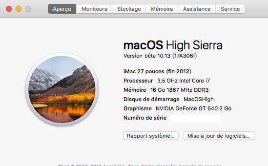

Matgen84 Posted July 11, 2017 Share Posted July 11, 2017 macOS High Sierra 10.13 beta 3 (17A306f)= succeed for fresh Install (cyberdev's EFI Folder) Some issue: -Now, OOB wifi card didn't work despite reinstalling the Apple Kext (IO80211...). But work on USB pendrive for installation ? -External USB drive recognized as internal with sliver icon. No success with patches. Link to comment https://www.insanelymac.com/forum/topic/324194-pre-release-macos-high-sierra/page/70/#findComment-2460652 Share on other sites More sharing options...
Cyberdevs Posted July 11, 2017 Share Posted July 11, 2017 macOS High Sierra 10.13 beta 3 (17A306f)= succeed for fresh Install (cyberdev's EFI Folder) Some issue: -Now, OOB wifi card didn't work despite reinstalling the Apple Kext (IO80211...). But work on USB pendrive ? -External USB drive recognized as internal with sliver icon. No success with patches. Send me both EFI folders from your pen drive and hdd. if it works when you use your pen drive then it should work on hdd. Or you can just replace the EFI on your hard disk (Make a copy of it for further use first) with the one you have on your pen drive. 1 Link to comment https://www.insanelymac.com/forum/topic/324194-pre-release-macos-high-sierra/page/70/#findComment-2460653 Share on other sites More sharing options...
jsl Posted July 11, 2017 Share Posted July 11, 2017 Can iGPU and dGPU be used together? If intel injection is set to true, it will stack at startup. (It will work if it is only one of the GPUs) ----- macOS High Sierra 10.13 beta 3 (17A306f) Core i3 4130 GA-Z87-UD3H Intel HD 4400 Geforce 9600GT Clover 4114 SMBIOS iMac14,2 Lilu 1.1.5 NvidiaGraphicsFixup 1.1.2 IntelGraphicsFixup 1.1.5 AppleALC 1.1.3 bootargs dart=0 darkwake=0 -lilubeta -alcbeta -ngfxbeta -igfxbeta For those Nvidia cards which need either Nvidia Web Driver or inject Nvidia by Clover (or GE=Y by Enoch/Chameleon) only Intel HD or Nvidia alone was working. To boot High Sierra either disabled Intel HD by BIOS or set nv_disable=1 was working at present. 1 Link to comment https://www.insanelymac.com/forum/topic/324194-pre-release-macos-high-sierra/page/70/#findComment-2460656 Share on other sites More sharing options...
Matgen84 Posted July 11, 2017 Share Posted July 11, 2017 Send me both EFI folders from your pen drive and hdd. if it works when you use your pen drive then it should work on hdd. Or you can just replace the EFI on your hard disk (Make a copy of it for further use first) with the one you have on your pen drive. Thanks. I just copy EFI folder from USB pen drive to hard disk. I replace vboxhfs by hfsplus-64.efi and add hdmiaudio.kext EFI_Hard_Disk.zip EFI_Pendrive.zip Link to comment https://www.insanelymac.com/forum/topic/324194-pre-release-macos-high-sierra/page/70/#findComment-2460662 Share on other sites More sharing options...
Cyberdevs Posted July 11, 2017 Share Posted July 11, 2017 Thanks. I just copy EFI folder from USB pen drive to hard disk. I replace vboxhfs by hfsplus-64.efi and add hdmiaudio.kext These folders are identical (except for the kext that you added), the config.plist are the same. When you boot from USB you have WiFi and when you boot from hdd it doesn't work? 1 Link to comment https://www.insanelymac.com/forum/topic/324194-pre-release-macos-high-sierra/page/70/#findComment-2460673 Share on other sites More sharing options...
