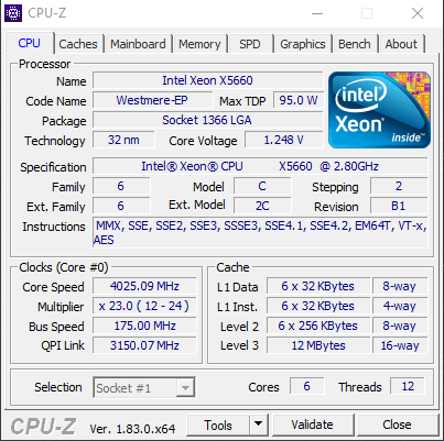

General11 Posted February 8, 2018 Share Posted February 8, 2018 I'll check, need travellin' 3 days, back fast Hello. Can you check my hackintosh Asus P6T with Xeon 5650 overclocked to 4.0 Ghz? SSDT and DSDT and anything else Send me iMac-Konstantin.zip 1 Link to comment https://www.insanelymac.com/forum/topic/323184-guide-el-capitan-sierra-high-sierra-mojave-catalina-on-intel-lga-775-motherboards-dsdt/page/18/#findComment-2587456 Share on other sites More sharing options...
