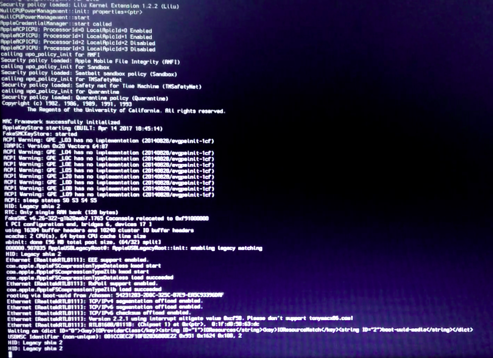

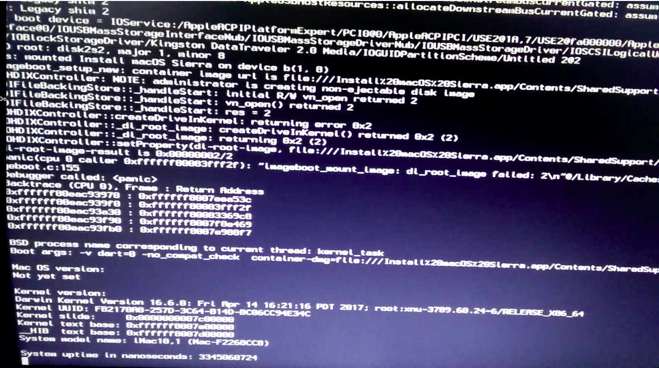

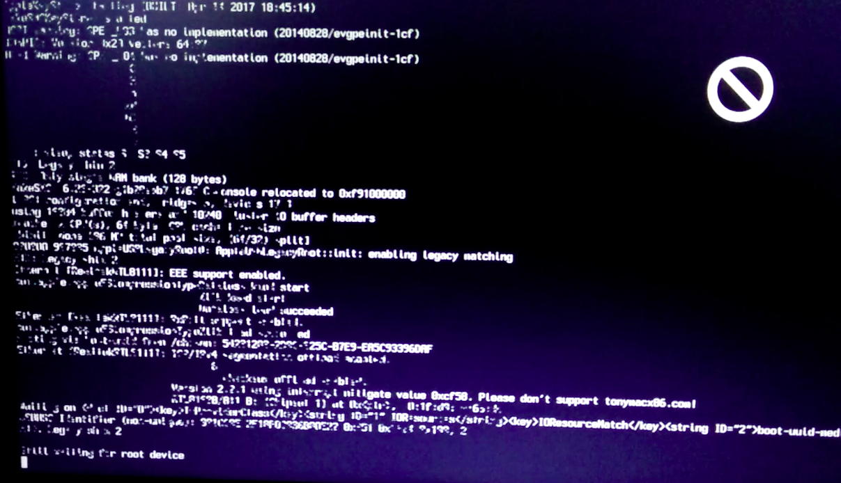

I'm trying to get the High Sierra on an old PC.
GA-P35-S3G, Core 2 Duo e8500, Nvidia GF210, RAM 8gb.
Old versions are working on hurray, but with High Sierra did not happen))))....
dsdt.zip
what happens?
2 minutes ago, MaLd0n said:
what happens?
It is not possible to start the installation of High Sierra. I use a clover and a minimal set kexts, it's cursing at boot, it's not Mac.
Tell me in which direction to move, so that I can launch Highe Sierra on my hardware?
Thank you in advance!)
check here, use my folder, just remove my DSDT

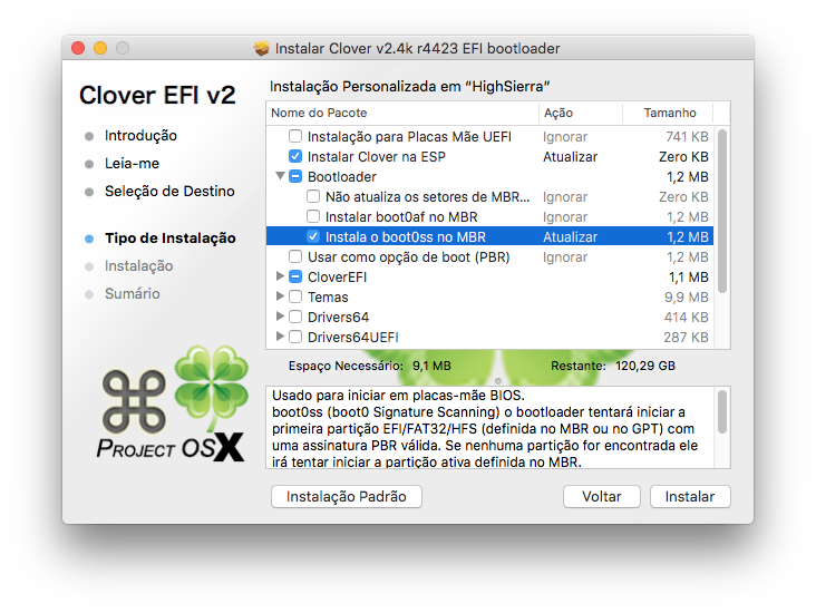

Please help, I followed your instructions and I can't get anything at all after verifying DMI - it's a blank screen with a cursor.
Things I've done:
1. BIOS set to ACHI. Chose USB-HDD as primary boot
2. 16GB USB formatted in Mac OS Extended using GUID (GPT)
3. Created a bootable USB with High Sierra

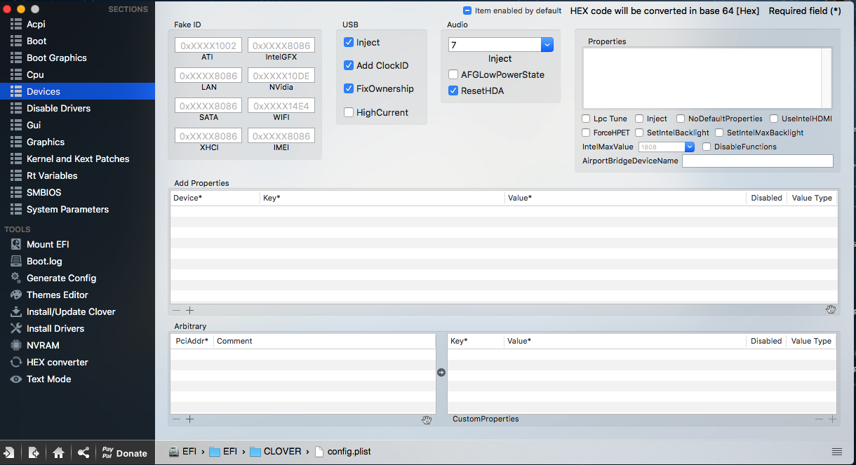

4. Installed Clover on same USB with Legacy settings: Install Boot0af in MBR, CloverEFI 64bit SATA, EMUVariableUEFI-64, OSXaptioFixDrv 64, PartitionDxe 64.
5. Replaced Clover folder with yours.

1 hour ago, jayston said:
MaLd0n,
Things I've done:

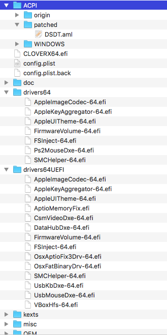

...just in case ,here is my clover folder from the usb stick
http://www69.zippyshare.com/v/ETaSU8Dd/file.html
U have a good patches, chipset is NVIDIA, Clover have a good patches for it ;)

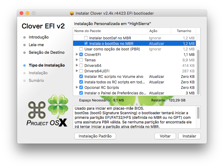

Just for testing, I used a couple of 2GB USB formatted to MBR instead if GPT i have laying around and just load Clover with different customizations at Clover install, nothing else. I checked off Boot0ss, CloverEFI 64 bit and everything under Driver64. And it worked and booted Clover - but intermittently. Once I shut off the computer and restart again, it won't recognize Clover.
This post has the same issue I'm describing. https://sourceforge.net/p/cloverefiboot/tickets/228/
Black screen, boot1 :/boot 6
21 minutes ago, MaLd0n said:
i install OSX in many old mobos, if i used config above...no problems
I'm not saying I'm doubting that; obviously its working for many people. I just need help getting the right settings - like is it my BIOS settings, is it my GPU that's conflicting or even the memory ... I don't know. because there's something that's stopping Clover from booting.
I also realize the last item "Install Clover Preference Pane" is grayed out on my screen unless I install Clover directly to the computer, but your screenshot shows it's selected even when installing to the USB.

put ur bios in default, just enable AHCI
