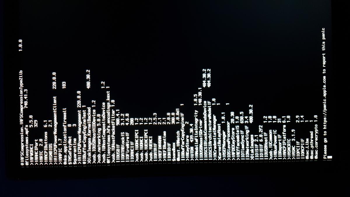

Lucy183 Posted February 12, 2018 Share Posted February 12, 2018 send me error photo It's the same screen, I don't think it's useful, just enumarate kexts I think. I'll try to get a boot log because it writes more very fast before this screen and then reboot, I used Don't reboot on panic to take the photo. Edit: What the.... I just booted without dsdt and it actually booted... Clover folder is the one I sent you PM yesterday but without dsdt... that's very very weird. Edit2: I found the trick, when I check InjectNvidia in clover I get the weird kp, if I uncheck it the system boots. I'll put again your post clover and run runme.app and send you the file. Edit3: Attached SendMe.zip Send me LuCys-Mac-Pro.zip 1 Link to comment https://www.insanelymac.com/forum/topic/323184-guide-el-capitan-sierra-high-sierra-mojave-catalina-on-intel-lga-775-motherboards-dsdt/page/20/#findComment-2590972 Share on other sites More sharing options...
Lucy183 Posted February 13, 2018 Share Posted February 13, 2018 It's the same screen, I don't think it's useful, just enumarate kexts I think. I'll try to get a boot log because it writes more very fast before this screen and then reboot, I used Don't reboot on panic to take the photo. Edit: What the.... I just booted without dsdt and it actually booted... Clover folder is the one I sent you PM yesterday but without dsdt... that's very very weird. Edit2: I found the trick, when I check InjectNvidia in clover I get the weird kp, if I uncheck it the system boots. I'll put again your post clover and run runme.app and send you the file. Edit3: Attached SendMe.zip @MaLd0n can you help me? Sorry for bothering you.. 1 Link to comment https://www.insanelymac.com/forum/topic/323184-guide-el-capitan-sierra-high-sierra-mojave-catalina-on-intel-lga-775-motherboards-dsdt/page/20/#findComment-2591129 Share on other sites More sharing options...
MaLd0n Posted February 13, 2018 Author Share Posted February 13, 2018 back ur old DSDT, have a GPU patch and work if clover fail with ur GPU... 1 Link to comment https://www.insanelymac.com/forum/topic/323184-guide-el-capitan-sierra-high-sierra-mojave-catalina-on-intel-lga-775-motherboards-dsdt/page/20/#findComment-2591216 Share on other sites More sharing options...

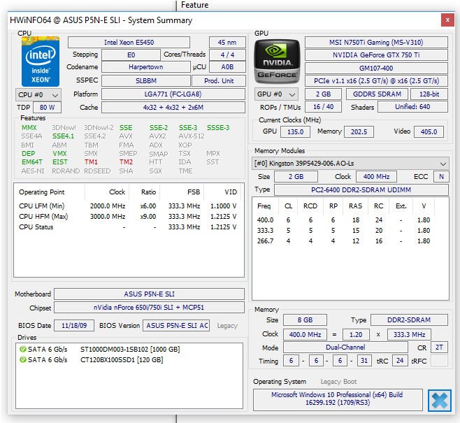

Endriu1987 Posted February 15, 2018 Share Posted February 15, 2018 Hi MaLd0n, I'm from Poland Spec: MOBO: ASUS P5N-E SLI (nForce 650i SLI) (LEGACY BIOS)CPU: QuadCore Intel Xeon E5450GPU: nVIDIA GeForce GTX 750 TiRAM: 8 GB (DDR2-800 (400 MHz) DDR2 SDRAMEthernet: nVIDIA nForce 430i (MCP51)Wi-Fi: NoAudio: nVIDIA HDMI/DP @ nVIDIA GM107 - High Definition Audio Controller My problem is: When I want install High Sierra without NullCPUPowerManagement.kext, I got this panic: When I install with this kext, my computer does not want to reboot. Problem video: https://drive.google.com/file/d/1jFH93TgFHNJ7PTD6A81XHidpltbZpRLv/view A message appears and nothing else happens: Then I must restart PC with restart button. This is my: DSDT and SSDT from Clover F4 DSDT + SSDT.zip This is my: RunMe file: Send me Mac-Endriu.zip I tried many settings in config.plist and still the same. Now my config it has only "Boot" options, the other tabs are default. My config.plist: config.zip Please help me, I do not know how to fix this restart 1 Link to comment https://www.insanelymac.com/forum/topic/323184-guide-el-capitan-sierra-high-sierra-mojave-catalina-on-intel-lga-775-motherboards-dsdt/page/20/#findComment-2592604 Share on other sites More sharing options...
MaLd0n Posted February 15, 2018 Author Share Posted February 15, 2018 Hi MaLd0n, I'm from Poland Spec: MOBO: ASUS P5N-E SLI (nForce 650i SLI) (LEGACY BIOS) CPU: QuadCore Intel Xeon E5450 GPU: nVIDIA GeForce GTX 750 Ti RAM: 8 GB (DDR2-800 (400 MHz) DDR2 SDRAM Ethernet: nVIDIA nForce 430i (MCP51) Wi-Fi: No Audio: nVIDIA HDMI/DP @ nVIDIA GM107 - High Definition Audio Controller 123.jpg My problem is: When I want install High Sierra without NullCPUPowerManagement.kext, I got this panic: 20180215_161828.jpg When I install with this kext, my computer does not want to reboot. Problem video: https://drive.google.com/file/d/1jFH93TgFHNJ7PTD6A81XHidpltbZpRLv/view A message appears and nothing else happens: 20180210_202018.jpg Then I must restart PC with restart button. This is my: DSDT and SSDT from Clover F4 DSDT + SSDT.zip This is my: RunMe file: Send me Mac-Endriu.zip I tried many settings in config.plist and still the same. Now my config it has only "Boot" options, the other tabs are default. 1.jpg My config.plist: config.zip Please help me, I do not know how to fix this restart try DSDT.aml.zip 1 Link to comment https://www.insanelymac.com/forum/topic/323184-guide-el-capitan-sierra-high-sierra-mojave-catalina-on-intel-lga-775-motherboards-dsdt/page/20/#findComment-2592620 Share on other sites More sharing options...

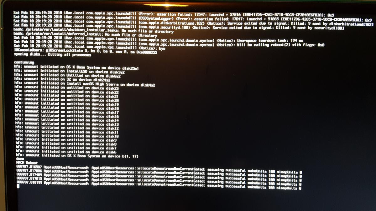

Endriu1987 Posted February 15, 2018 Share Posted February 15, 2018 Now it looks like this. help again https://drive.google.com/file/d/16wYdR2oiNARrOIq0127WvEgQyUU5EwHD/view?usp=sharing 1 Link to comment https://www.insanelymac.com/forum/topic/323184-guide-el-capitan-sierra-high-sierra-mojave-catalina-on-intel-lga-775-motherboards-dsdt/page/20/#findComment-2592680 Share on other sites More sharing options...
MaLd0n Posted February 15, 2018 Author Share Posted February 15, 2018 Now it looks like this. help again https://drive.google.com/file/d/16wYdR2oiNARrOIq0127WvEgQyUU5EwHD/view?usp=sharing use Reset button and go to next step xD Link to comment https://www.insanelymac.com/forum/topic/323184-guide-el-capitan-sierra-high-sierra-mojave-catalina-on-intel-lga-775-motherboards-dsdt/page/20/#findComment-2592686 Share on other sites More sharing options...
