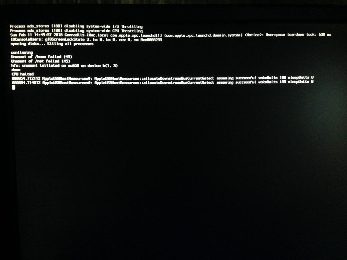

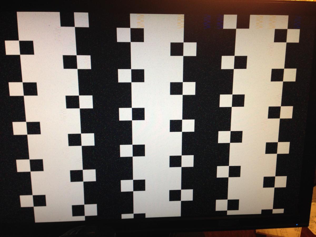

  • OS starts with option "nv_disable=1", without it - loading stuck with vertical black-white lines and artefacts. Tried without "nv_disable=1" and with "npci=0x2000" / "npci=0x2000" - stuck when apple logo and empty progress bar appears;
  • not all USB are working in OS: 1/2 front panel and 3/4 back panel and 1/2 additional panel (connected to additional MB connectors) are working;
  • won't power off on shutdown (shutdown.jpg);
  • won't go sleep, no reaction after clicking in menu "Sleep".
Attached "/EFI/CLOVER/ACPI/origin" from installation flash drive, after booting from it and pressing F4 in Clover ("F4.zip") and RunMe result "Send me Gennadiis-iMac.zip" (don't know should I remove some serials or something else there).

Got same situation with requirement in "nv_disable=1".

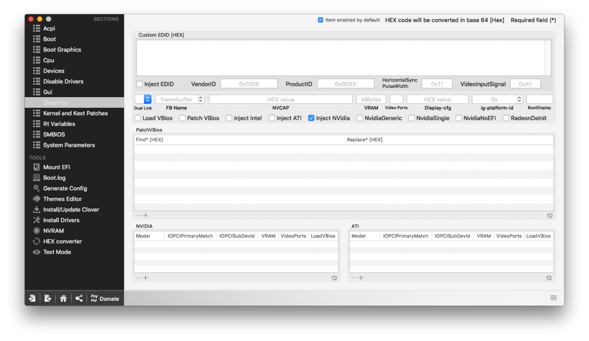

1- u dont need usbinjectall, ur usb work native with a simple patches
2- try dont apply video patch in DSDT, try with a InjectNvidia
2- let the clover generate P and C States, dont need add it in tables

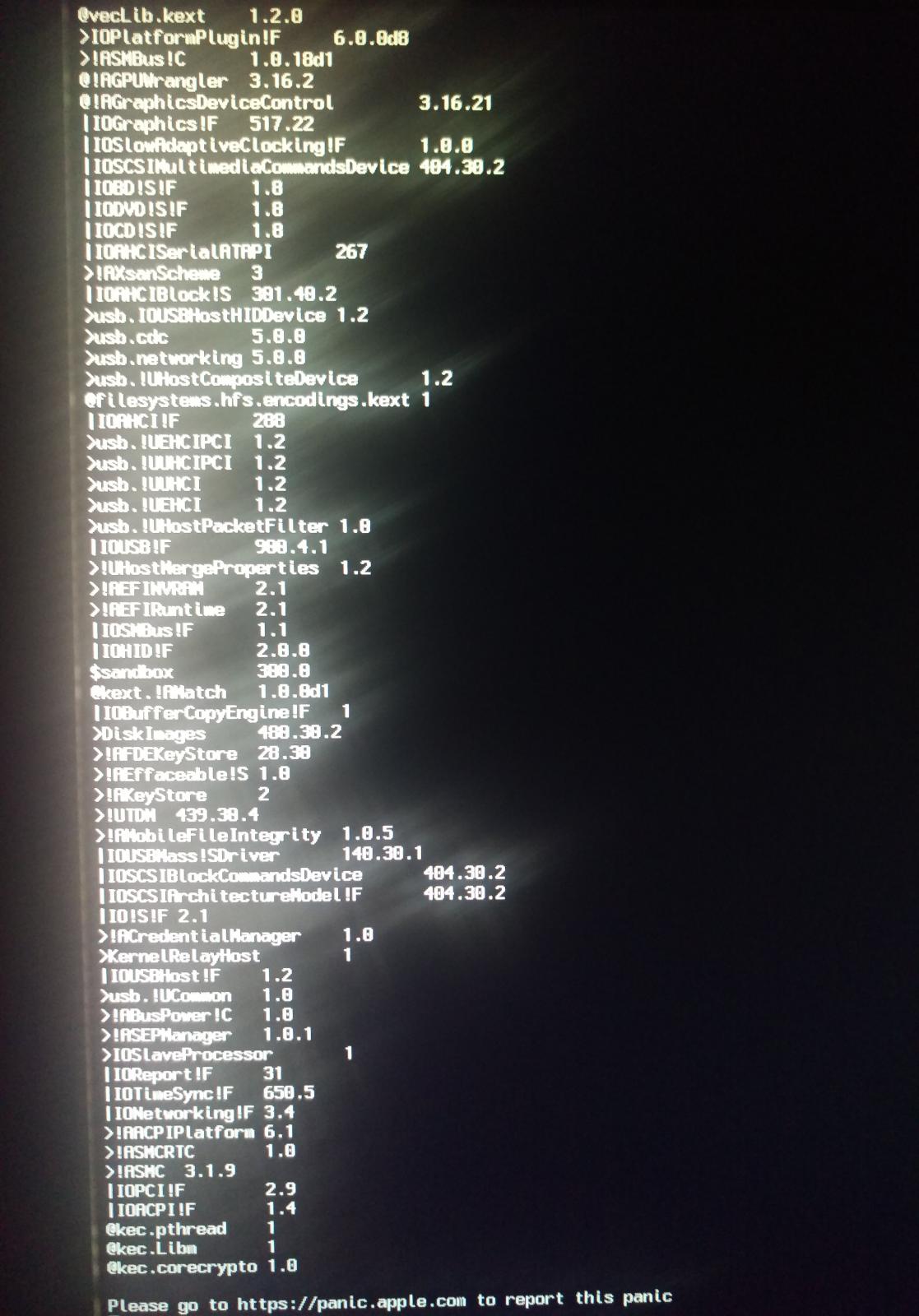

I just tried and I get a weird kp.
lat clover version?

@MaLd0n I downloaded your post clover, updated it to latest clover and tried almost every patches combinations, it's impossible to boot without dsdt, I get the same weird kp.
I don't know what patch I did to DSDT to fix this, it was few months ago, or maybe it was already included, I downloaded the dsdt from the internet and patched it a lot to make everything work correctly.
is a HPET fix
Use NullCpuPM kext to avoid it
