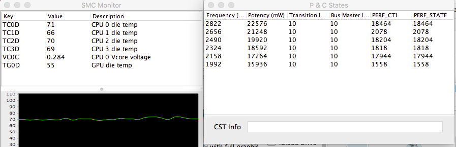

...temps are quite high for cpu...powermanagement version shows blank in smc monitor app
...edit: got it cooled down now... removed your patch for AppleIntelCPUPM....added my own lpc  injector...

...ok...testing now....removed LPC injector...temps are high again...20 degrees C higher...the injector seems to do the job, albeit not as clean as dsdt, but it works...gives me
AICPMVers number 0x1240105 under IOService:/AppleACPIPlatformExpert/CPU0@0/AppleACPICPU/ACPI_SMC_PlatformPlugin in ioregistryexplorer...your dsdt does not...
edit: I'll reinject LPC again my way ...just to sure...brb
