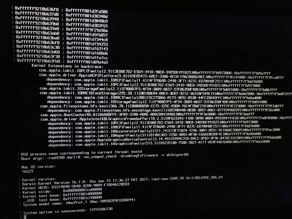

telepati Posted May 1, 2018 Share Posted May 1, 2018 Hi @MaLd0n I need a new DSDT. I made couple of Hardware and Bios update. After this changes, I am starting to get NVME kernel Panic; Anonymous UUID: 9E064598-53F3-B729-3D5B-907138F44679 Tue May 1 20:37:32 2018 *** Panic Report *** panic(cpu 0 caller 0xffffff7f839e9f7b): nvme: " NVMe: Command timed-out and request found in the completion queue \n"@/BuildRoot/Library/Caches/com.apple.xbs/Sources/IONVMeFamily/IONVMeFamily-356.50.26/IONVMeController.cpp:5188 Backtrace (CPU 0), Frame : Return Address 0xffffff874a5a3b50 : 0xffffff800046e166 0xffffff874a5a3ba0 : 0xffffff8000596714 0xffffff874a5a3be0 : 0xffffff8000588a00 0xffffff874a5a3c60 : 0xffffff8000420180 0xffffff874a5a3c80 : 0xffffff800046dbdc 0xffffff874a5a3db0 : 0xffffff800046d99c 0xffffff874a5a3e10 : 0xffffff7f839e9f7b 0xffffff874a5a3e30 : 0xffffff8000a9f71c 0xffffff874a5a3ea0 : 0xffffff8000a9f646 0xffffff874a5a3ed0 : 0xffffff80004a77e4 0xffffff874a5a3f40 : 0xffffff80004a7345 0xffffff874a5a3fa0 : 0xffffff800041f4f7 Kernel Extensions in backtrace: com.apple.iokit.IONVMeFamily(2.1)[AAD9E232-4F00-3702-9310-C5ABB53A5B6F]@0xffffff7f839d6000->0xffffff7f83a14fff dependency: com.apple.driver.AppleMobileFileIntegrity(1.0.5)[E56BF7DF-B38F-3193-9A02-9DB0BAC70D7A]@0xffffff7f813f7000 dependency: com.apple.iokit.IOPCIFamily(2.9)[580E0204-B37A-32BA-AC27-E8DBCA519B1F]@0xffffff7f80c94000 dependency: com.apple.driver.AppleEFINVRAM(2.1)[F35A52E2-CF80-3BA9-92B5-25EFE216094F]@0xffffff7f8127a000 dependency: com.apple.iokit.IOStorageFamily(2.1)[F27A8A2A-6662-3608-83BD-415037509E01]@0xffffff7f80e46000 dependency: com.apple.iokit.IOReportFamily(31)[D2F2FBDF-4EE4-38BA-99F5-B699F886F413]@0xffffff7f81ac0000 BSD process name corresponding to current thread: kernel_task Boot args: uia_exclude=HS03;HS04;HS07;HS08;HS11;HS12;HS13;SS03;SS04;SS07;SS08;SS09;SS10; Mac OS version: 17E202 Kernel version: Darwin Kernel Version 17.5.0: Fri Apr 13 19:32:32 PDT 2018; root:xnu-4570.51.2~1/RELEASE_X86_64 Kernel UUID: 7134F18E-AAC2-3C5B-B2C4-ABB799B4B9DF Kernel slide: 0x0000000000200000 Kernel text base: 0xffffff8000400000 __HIB text base: 0xffffff8000300000 System model name: iMac17,1 (Mac-65CE76090165799A) System uptime in nanoseconds: 46705598003 last loaded kext at 12363600817: com.apple.driver.AppleUpstreamUserClient 3.6.5 (addr 0xffffff7f83893000, size 36864) loaded kexts: com.insanelymac.IntelMausiEthernet 2.4.0d0 org.netkas.driver.FakeSMC 1787 as.vit9696.AppleALC 1.2.6 as.vit9696.Lilu 1.2.3 com.rehabman.driver.USBInjectAll 0.6.5 com.apple.driver.AppleUpstreamUserClient 3.6.5 com.apple.kext.AMDFramebuffer 1.6.6 com.apple.driver.AppleHDAHardwareConfigDriver 281.51 com.apple.driver.AppleHDA 281.51 com.apple.driver.AGPM 110.23.33 com.apple.driver.ApplePlatformEnabler 2.7.0d0 com.apple.driver.X86PlatformShim 1.0.0 com.apple.kext.AMDRadeonX4000 1.6.6 com.apple.driver.AppleGraphicsDevicePolicy 3.18.48 com.apple.AGDCPluginDisplayMetrics 3.18.48 com.apple.driver.AppleHV 1 com.apple.iokit.IOUserEthernet 1.0.1 com.apple.iokit.IOBluetoothSerialManager 6.0.5f3 com.apple.driver.pmtelemetry 1 com.apple.Dont_Steal_Mac_OS_X 7.0.0 com.apple.driver.AppleIntelPCHPMC 2.0.1 com.apple.driver.AppleOSXWatchdog 1 com.apple.kext.AMD9500Controller 1.6.6 com.apple.driver.AppleSMCLMU 211 com.apple.driver.ACPI_SMC_PlatformPlugin 1.0.0 com.apple.driver.AppleFIVRDriver 4.1.0 com.apple.driver.AppleIntelSlowAdaptiveClocking 4.0.0 com.apple.driver.AGDCBacklightControl 3.18.48 com.apple.driver.AppleBacklight 170.12.6 com.apple.driver.AppleMCCSControl 1.5.4 com.apple.iokit.IOBluetoothUSBDFU 6.0.5f3 com.apple.driver.AppleFileSystemDriver 3.0.1 com.apple.filesystems.hfs.kext 407.50.6 com.apple.AppleFSCompression.AppleFSCompressionTypeDataless 1.0.0d1 com.apple.BootCache 40 com.apple.AppleFSCompression.AppleFSCompressionTypeZlib 1.0.0 com.apple.filesystems.apfs 748.51.0 com.apple.driver.AirPort.BrcmNIC 1240.29.1a7 com.apple.driver.AppleAHCIPort 329.50.2 com.apple.driver.AppleRTC 2.0 com.apple.driver.AppleHPET 1.8 com.apple.driver.AppleACPIButtons 6.1 com.apple.driver.AppleSMBIOS 2.1 com.apple.driver.AppleAPIC 1.7 com.apple.nke.applicationfirewall 183 com.apple.security.TMSafetyNet 8 com.apple.security.quarantine 3 com.apple.driver.DspFuncLib 281.51 com.apple.kext.OSvKernDSPLib 526 com.apple.kext.AMDRadeonX4000HWLibs 1.0 com.apple.iokit.IOAcceleratorFamily2 378.18.1 com.apple.kext.AMDRadeonX4000HWServices 1.6.6 com.apple.driver.AppleGraphicsControl 3.18.48 com.apple.iokit.IOAVBFamily 675.6 com.apple.plugin.IOgPTPPlugin 675.12 com.apple.iokit.IOEthernetAVBController 1.1.0 com.apple.driver.AppleSSE 1.0 com.apple.iokit.IOSurface 211.12 com.apple.iokit.IOSerialFamily 11 com.apple.driver.AppleHDAController 281.51 com.apple.iokit.IOHDAFamily 281.51 com.apple.iokit.IOAudioFamily 206.5 com.apple.vecLib.kext 1.2.0 com.apple.driver.IOPlatformPluginLegacy 1.0.0 com.apple.driver.X86PlatformPlugin 1.0.0 com.apple.driver.IOPlatformPluginFamily 6.0.0d8 com.apple.AppleGPUWrangler 3.18.48 com.apple.iokit.IOSlowAdaptiveClockingFamily 1.0.0 com.apple.kext.AMDSupport 1.6.6 com.apple.driver.AppleSMBusPCI 1.0.14d1 com.apple.AppleGraphicsDeviceControl 3.18.48 com.apple.driver.AppleBacklightExpert 1.1.0 com.apple.iokit.IONDRVSupport 519.15 com.apple.driver.AppleSMBusController 1.0.18d1 com.apple.iokit.IOSMBusFamily 1.1 com.apple.iokit.IOGraphicsFamily 519.15 com.apple.iokit.IOAHCIBlockStorage 301.40.2 com.apple.driver.AppleHIDKeyboard 205 com.apple.driver.usb.IOUSBHostHIDDevice 1.2 com.apple.iokit.BroadcomBluetoothHostControllerUSBTransport 6.0.5f3 com.apple.iokit.IOBluetoothHostControllerUSBTransport 6.0.5f3 com.apple.iokit.IOBluetoothHostControllerTransport 6.0.5f3 com.apple.iokit.IOBluetoothFamily 6.0.5f3 com.apple.driver.usb.cdc 5.0.0 com.apple.driver.usb.networking 5.0.0 com.apple.driver.usb.AppleUSBHostCompositeDevice 1.2 com.apple.driver.AppleUSBHostMergeProperties 1.2 com.apple.driver.usb.AppleUSBHub 1.2 com.apple.filesystems.hfs.encodings.kext 1 com.apple.driver.AppleXsanScheme 3 com.apple.iokit.IONVMeFamily 2.1.0 com.apple.iokit.IO80211Family 1200.12.2 com.apple.driver.mDNSOffloadUserClient 1.0.1b8 com.apple.driver.corecapture 1.0.4 com.apple.driver.AppleIntelLpssGspi 3.0.60 com.apple.driver.AppleIntelLpssI2C 3.0.60 com.apple.iokit.IOAHCIFamily 288 com.apple.driver.usb.AppleUSBXHCIPCI 1.2 com.apple.driver.usb.AppleUSBXHCI 1.2 com.apple.driver.usb.AppleUSBHostPacketFilter 1.0 com.apple.iokit.IOUSBFamily 900.4.1 com.apple.driver.AppleEFINVRAM 2.1 com.apple.driver.AppleEFIRuntime 2.1 com.apple.iokit.IOHIDFamily 2.0.0 com.apple.security.sandbox 300.0 com.apple.kext.AppleMatch 1.0.0d1 com.apple.driver.DiskImages 480.50.10 com.apple.driver.AppleFDEKeyStore 28.30 com.apple.driver.AppleEffaceableStorage 1.0 com.apple.driver.AppleKeyStore 2 com.apple.driver.AppleUSBTDM 439.50.6 com.apple.driver.AppleMobileFileIntegrity 1.0.5 com.apple.iokit.IOUSBMassStorageDriver 140.50.3 com.apple.iokit.IOSCSIBlockCommandsDevice 404.30.2 com.apple.iokit.IOSCSIArchitectureModelFamily 404.30.2 com.apple.iokit.IOStorageFamily 2.1 com.apple.driver.AppleCredentialManager 1.0 com.apple.driver.KernelRelayHost 1 com.apple.iokit.IOUSBHostFamily 1.2 com.apple.driver.usb.AppleUSBCommon 1.0 com.apple.driver.AppleBusPowerController 1.0 com.apple.driver.AppleSEPManager 1.0.1 com.apple.driver.IOSlaveProcessor 1 com.apple.iokit.IOReportFamily 31 com.apple.iokit.IOTimeSyncFamily 675.12 com.apple.iokit.IONetworkingFamily 3.4 com.apple.driver.AppleACPIPlatform 6.1 com.apple.driver.AppleSMC 3.1.9 com.apple.iokit.IOPCIFamily 2.9 com.apple.iokit.IOACPIFamily 1.4 com.apple.kec.pthread 1 com.apple.kec.Libm 1 com.apple.kec.corecrypto 1.0 EOF Model: iMac17,1, BootROM IM171.0151.B00, 4 processors, Intel Core i7, 4,01 GHz, 64 GB, SMC 2.33f10 Graphics: Radeon RX 560, Radeon RX 560, PCIe Memory Module: BANK 0/DIMM0, 16 GB, DDR4, 2400 MHz, Crucial Technology, BLS16G4D240FSB.16FAD Memory Module: BANK 1/DIMM0, 16 GB, DDR4, 2400 MHz, Crucial Technology, BLS16G4D240FSB.16FAD Memory Module: BANK 0/DIMM1, 16 GB, DDR4, 2400 MHz, Crucial Technology, BLS16G4D240FSB.16FAD Memory Module: BANK 1/DIMM1, 16 GB, DDR4, 2400 MHz, Crucial Technology, BLS16G4D240FSB.16FAD AirPort: spairport_wireless_card_type_airport_extreme (0x14E4, 0x111), Broadcom BCM43xx 1.0 (7.77.37.29.1a7) Bluetooth: Version 6.0.5f3, 3 services, 27 devices, 1 incoming serial ports Network Service: Wi-Fi, AirPort, en1 PCI Card: Intel Corporation, Series Chipset USB xHCI Host Controller, USB Controller, Built In PCI Card: Intel Corporation, Series Chipset MEI Controller, IMEI Controller, Built In PCI Card: Intel Corporation, Series Chipset SATA Controller, AHCI Controller, Built In PCI Card: Radeon RX 560, Display Controller, PCI Slot 0 PCI Card: Apple HDMI Audio Controller, HDMI Controller, Built In PCI Card: Intel Corporation, Series Chipset PCHPMC Controller, PCHPMC Controller, Built In PCI Card: Apple High Definition Audio Controller, Audio Controller, Built In PCI Card: Intel I219V2 PCI Express Gigabit Ethernet, Ethernet Controller, Built In PCI Card: ASMedia USB 3.1 eXtensible Host Controller #2, USB Controller, Built In PCI Card: ASMedia USB 3.1 eXtensible Host Controller #1, USB Controller, Built In PCI Card: Apple NVMe M2 Flash Drive, Storage Controller, Built In PCI Card: Broadcom BCM43xx Wireless Network Adapter, AirPort Extreme, Built In Serial ATA Device: WDC WD20EARS-00MVWB0, 2 TB Serial ATA Device: Samsung SSD 840 EVO 250GB, 250,06 GB Serial ATA Device: WDC WD10EZRX-00A8LB0, 1 TB Serial ATA Device: WDC WD20EARS-00MVWB0, 2 TB USB Device: USB 3.0 Bus USB Device: BRCM20702 Hub USB Device: Bluetooth USB Host Controller USB Device: USB2.0 Hub USB Device: Keyboard Hub USB Device: Apple Keyboard USB Device: USB 3.0 Bus USB Device: USB 3.1 Bus Thunderbolt Bus: I asked Rehabman and he is give this answer; Your ACPI/patched/DSDT.aml is not in sync with native ACPI.Note different SystemMemory addresses: NUC6i7KYK:patched rehabman$ diff ../origin/ ../patched/|grep SystemMemory < OperationRegion (GNVS, SystemMemory, 0x8F045000, 0x06B3) > OperationRegion (GNVS, SystemMemory, 0x8A868000, 0x06B3) < OperationRegion (CPSB, SystemMemory, 0x8E7B3F98, 0x10) > OperationRegion (CPSB, SystemMemory, 0x89FE7F98, 0x10) < OperationRegion (XMIO, SystemMemory, Local0, 0x9000) Very bad idea to run with incorrect SystemMemory addresses...Note that config.plist/ACPI/DSDT/Fixes/FixRegions cannot be relied upon. It is too buggy to use. I am not capable of the making DSDT. Could you please help me? Here is my Send_me files. Thank you. https://www.dropbox.com/s/tx6sp2dki5y16ur/Send me Murats-Mac.zip?dl=0 1 Link to comment https://www.insanelymac.com/forum/topic/321872-guide-catalina-bigsur-monterey-on-mobos-serie-100-200-300-400-500-600-skylake-kabylake-coffeelake-cometlake-rocketlake-alderlake-dsdt/page/114/#findComment-2612211 Share on other sites More sharing options...

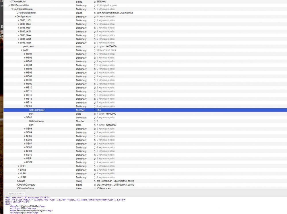

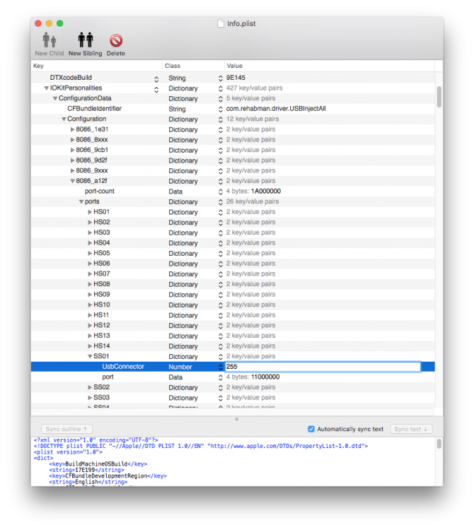

rob88v Posted May 1, 2018 Share Posted May 1, 2018 (edited) Hey @MaLd0n I wanted to know if it was possible to make an internal SD card reader work properly in High Sierra I have a Sabrent CR-UIN3 reader which works fine on boot, but when I put the computer to sleep and proceed to wake it up, the card loses functionality. Would it be possible to redo my DSDT to make the card reader be fully functional in macOS High Sierra? If not, I can do without it, but it would be a nice added feature to this machine. Thank you in advance! https://www.dropbox.com/s/5m5srk2k5mz8hg4/Send me Seans-Hack-Pro.zip?dl=0 Edited May 1, 2018 by rob88v 1 Link to comment https://www.insanelymac.com/forum/topic/321872-guide-catalina-bigsur-monterey-on-mobos-serie-100-200-300-400-500-600-skylake-kabylake-coffeelake-cometlake-rocketlake-alderlake-dsdt/page/114/#findComment-2612229 Share on other sites More sharing options...
MaLd0n Posted May 1, 2018 Author Share Posted May 1, 2018 3 hours ago, telepati said: Hi @MaLd0n I need a new DSDT. I made couple of Hardware and Bios update. After this changes, I am starting to get NVME kernel Panic; Anonymous UUID: 9E064598-53F3-B729-3D5B-907138F44679 Tue May 1 20:37:32 2018 *** Panic Report *** panic(cpu 0 caller 0xffffff7f839e9f7b): nvme: " NVMe: Command timed-out and request found in the completion queue \n"@/BuildRoot/Library/Caches/com.apple.xbs/Sources/IONVMeFamily/IONVMeFamily-356.50.26/IONVMeController.cpp:5188 Backtrace (CPU 0), Frame : Return Address 0xffffff874a5a3b50 : 0xffffff800046e166 0xffffff874a5a3ba0 : 0xffffff8000596714 0xffffff874a5a3be0 : 0xffffff8000588a00 0xffffff874a5a3c60 : 0xffffff8000420180 0xffffff874a5a3c80 : 0xffffff800046dbdc 0xffffff874a5a3db0 : 0xffffff800046d99c 0xffffff874a5a3e10 : 0xffffff7f839e9f7b 0xffffff874a5a3e30 : 0xffffff8000a9f71c 0xffffff874a5a3ea0 : 0xffffff8000a9f646 0xffffff874a5a3ed0 : 0xffffff80004a77e4 0xffffff874a5a3f40 : 0xffffff80004a7345 0xffffff874a5a3fa0 : 0xffffff800041f4f7 Kernel Extensions in backtrace: com.apple.iokit.IONVMeFamily(2.1)[AAD9E232-4F00-3702-9310-C5ABB53A5B6F]@0xffffff7f839d6000->0xffffff7f83a14fff dependency: com.apple.driver.AppleMobileFileIntegrity(1.0.5)[E56BF7DF-B38F-3193-9A02-9DB0BAC70D7A]@0xffffff7f813f7000 dependency: com.apple.iokit.IOPCIFamily(2.9)[580E0204-B37A-32BA-AC27-E8DBCA519B1F]@0xffffff7f80c94000 dependency: com.apple.driver.AppleEFINVRAM(2.1)[F35A52E2-CF80-3BA9-92B5-25EFE216094F]@0xffffff7f8127a000 dependency: com.apple.iokit.IOStorageFamily(2.1)[F27A8A2A-6662-3608-83BD-415037509E01]@0xffffff7f80e46000 dependency: com.apple.iokit.IOReportFamily(31)[D2F2FBDF-4EE4-38BA-99F5-B699F886F413]@0xffffff7f81ac0000 BSD process name corresponding to current thread: kernel_task Boot args: uia_exclude=HS03;HS04;HS07;HS08;HS11;HS12;HS13;SS03;SS04;SS07;SS08;SS09;SS10; Mac OS version: 17E202 Kernel version: Darwin Kernel Version 17.5.0: Fri Apr 13 19:32:32 PDT 2018; root:xnu-4570.51.2~1/RELEASE_X86_64 Kernel UUID: 7134F18E-AAC2-3C5B-B2C4-ABB799B4B9DF Kernel slide: 0x0000000000200000 Kernel text base: 0xffffff8000400000 __HIB text base: 0xffffff8000300000 System model name: iMac17,1 (Mac-65CE76090165799A) System uptime in nanoseconds: 46705598003 last loaded kext at 12363600817: com.apple.driver.AppleUpstreamUserClient 3.6.5 (addr 0xffffff7f83893000, size 36864) loaded kexts: com.insanelymac.IntelMausiEthernet 2.4.0d0 org.netkas.driver.FakeSMC 1787 as.vit9696.AppleALC 1.2.6 as.vit9696.Lilu 1.2.3 com.rehabman.driver.USBInjectAll 0.6.5 com.apple.driver.AppleUpstreamUserClient 3.6.5 com.apple.kext.AMDFramebuffer 1.6.6 com.apple.driver.AppleHDAHardwareConfigDriver 281.51 com.apple.driver.AppleHDA 281.51 com.apple.driver.AGPM 110.23.33 com.apple.driver.ApplePlatformEnabler 2.7.0d0 com.apple.driver.X86PlatformShim 1.0.0 com.apple.kext.AMDRadeonX4000 1.6.6 com.apple.driver.AppleGraphicsDevicePolicy 3.18.48 com.apple.AGDCPluginDisplayMetrics 3.18.48 com.apple.driver.AppleHV 1 com.apple.iokit.IOUserEthernet 1.0.1 com.apple.iokit.IOBluetoothSerialManager 6.0.5f3 com.apple.driver.pmtelemetry 1 com.apple.Dont_Steal_Mac_OS_X 7.0.0 com.apple.driver.AppleIntelPCHPMC 2.0.1 com.apple.driver.AppleOSXWatchdog 1 com.apple.kext.AMD9500Controller 1.6.6 com.apple.driver.AppleSMCLMU 211 com.apple.driver.ACPI_SMC_PlatformPlugin 1.0.0 com.apple.driver.AppleFIVRDriver 4.1.0 com.apple.driver.AppleIntelSlowAdaptiveClocking 4.0.0 com.apple.driver.AGDCBacklightControl 3.18.48 com.apple.driver.AppleBacklight 170.12.6 com.apple.driver.AppleMCCSControl 1.5.4 com.apple.iokit.IOBluetoothUSBDFU 6.0.5f3 com.apple.driver.AppleFileSystemDriver 3.0.1 com.apple.filesystems.hfs.kext 407.50.6 com.apple.AppleFSCompression.AppleFSCompressionTypeDataless 1.0.0d1 com.apple.BootCache 40 com.apple.AppleFSCompression.AppleFSCompressionTypeZlib 1.0.0 com.apple.filesystems.apfs 748.51.0 com.apple.driver.AirPort.BrcmNIC 1240.29.1a7 com.apple.driver.AppleAHCIPort 329.50.2 com.apple.driver.AppleRTC 2.0 com.apple.driver.AppleHPET 1.8 com.apple.driver.AppleACPIButtons 6.1 com.apple.driver.AppleSMBIOS 2.1 com.apple.driver.AppleAPIC 1.7 com.apple.nke.applicationfirewall 183 com.apple.security.TMSafetyNet 8 com.apple.security.quarantine 3 com.apple.driver.DspFuncLib 281.51 com.apple.kext.OSvKernDSPLib 526 com.apple.kext.AMDRadeonX4000HWLibs 1.0 com.apple.iokit.IOAcceleratorFamily2 378.18.1 com.apple.kext.AMDRadeonX4000HWServices 1.6.6 com.apple.driver.AppleGraphicsControl 3.18.48 com.apple.iokit.IOAVBFamily 675.6 com.apple.plugin.IOgPTPPlugin 675.12 com.apple.iokit.IOEthernetAVBController 1.1.0 com.apple.driver.AppleSSE 1.0 com.apple.iokit.IOSurface 211.12 com.apple.iokit.IOSerialFamily 11 com.apple.driver.AppleHDAController 281.51 com.apple.iokit.IOHDAFamily 281.51 com.apple.iokit.IOAudioFamily 206.5 com.apple.vecLib.kext 1.2.0 com.apple.driver.IOPlatformPluginLegacy 1.0.0 com.apple.driver.X86PlatformPlugin 1.0.0 com.apple.driver.IOPlatformPluginFamily 6.0.0d8 com.apple.AppleGPUWrangler 3.18.48 com.apple.iokit.IOSlowAdaptiveClockingFamily 1.0.0 com.apple.kext.AMDSupport 1.6.6 com.apple.driver.AppleSMBusPCI 1.0.14d1 com.apple.AppleGraphicsDeviceControl 3.18.48 com.apple.driver.AppleBacklightExpert 1.1.0 com.apple.iokit.IONDRVSupport 519.15 com.apple.driver.AppleSMBusController 1.0.18d1 com.apple.iokit.IOSMBusFamily 1.1 com.apple.iokit.IOGraphicsFamily 519.15 com.apple.iokit.IOAHCIBlockStorage 301.40.2 com.apple.driver.AppleHIDKeyboard 205 com.apple.driver.usb.IOUSBHostHIDDevice 1.2 com.apple.iokit.BroadcomBluetoothHostControllerUSBTransport 6.0.5f3 com.apple.iokit.IOBluetoothHostControllerUSBTransport 6.0.5f3 com.apple.iokit.IOBluetoothHostControllerTransport 6.0.5f3 com.apple.iokit.IOBluetoothFamily 6.0.5f3 com.apple.driver.usb.cdc 5.0.0 com.apple.driver.usb.networking 5.0.0 com.apple.driver.usb.AppleUSBHostCompositeDevice 1.2 com.apple.driver.AppleUSBHostMergeProperties 1.2 com.apple.driver.usb.AppleUSBHub 1.2 com.apple.filesystems.hfs.encodings.kext 1 com.apple.driver.AppleXsanScheme 3 com.apple.iokit.IONVMeFamily 2.1.0 com.apple.iokit.IO80211Family 1200.12.2 com.apple.driver.mDNSOffloadUserClient 1.0.1b8 com.apple.driver.corecapture 1.0.4 com.apple.driver.AppleIntelLpssGspi 3.0.60 com.apple.driver.AppleIntelLpssI2C 3.0.60 com.apple.iokit.IOAHCIFamily 288 com.apple.driver.usb.AppleUSBXHCIPCI 1.2 com.apple.driver.usb.AppleUSBXHCI 1.2 com.apple.driver.usb.AppleUSBHostPacketFilter 1.0 com.apple.iokit.IOUSBFamily 900.4.1 com.apple.driver.AppleEFINVRAM 2.1 com.apple.driver.AppleEFIRuntime 2.1 com.apple.iokit.IOHIDFamily 2.0.0 com.apple.security.sandbox 300.0 com.apple.kext.AppleMatch 1.0.0d1 com.apple.driver.DiskImages 480.50.10 com.apple.driver.AppleFDEKeyStore 28.30 com.apple.driver.AppleEffaceableStorage 1.0 com.apple.driver.AppleKeyStore 2 com.apple.driver.AppleUSBTDM 439.50.6 com.apple.driver.AppleMobileFileIntegrity 1.0.5 com.apple.iokit.IOUSBMassStorageDriver 140.50.3 com.apple.iokit.IOSCSIBlockCommandsDevice 404.30.2 com.apple.iokit.IOSCSIArchitectureModelFamily 404.30.2 com.apple.iokit.IOStorageFamily 2.1 com.apple.driver.AppleCredentialManager 1.0 com.apple.driver.KernelRelayHost 1 com.apple.iokit.IOUSBHostFamily 1.2 com.apple.driver.usb.AppleUSBCommon 1.0 com.apple.driver.AppleBusPowerController 1.0 com.apple.driver.AppleSEPManager 1.0.1 com.apple.driver.IOSlaveProcessor 1 com.apple.iokit.IOReportFamily 31 com.apple.iokit.IOTimeSyncFamily 675.12 com.apple.iokit.IONetworkingFamily 3.4 com.apple.driver.AppleACPIPlatform 6.1 com.apple.driver.AppleSMC 3.1.9 com.apple.iokit.IOPCIFamily 2.9 com.apple.iokit.IOACPIFamily 1.4 com.apple.kec.pthread 1 com.apple.kec.Libm 1 com.apple.kec.corecrypto 1.0 EOF Model: iMac17,1, BootROM IM171.0151.B00, 4 processors, Intel Core i7, 4,01 GHz, 64 GB, SMC 2.33f10 Graphics: Radeon RX 560, Radeon RX 560, PCIe Memory Module: BANK 0/DIMM0, 16 GB, DDR4, 2400 MHz, Crucial Technology, BLS16G4D240FSB.16FAD Memory Module: BANK 1/DIMM0, 16 GB, DDR4, 2400 MHz, Crucial Technology, BLS16G4D240FSB.16FAD Memory Module: BANK 0/DIMM1, 16 GB, DDR4, 2400 MHz, Crucial Technology, BLS16G4D240FSB.16FAD Memory Module: BANK 1/DIMM1, 16 GB, DDR4, 2400 MHz, Crucial Technology, BLS16G4D240FSB.16FAD AirPort: spairport_wireless_card_type_airport_extreme (0x14E4, 0x111), Broadcom BCM43xx 1.0 (7.77.37.29.1a7) Bluetooth: Version 6.0.5f3, 3 services, 27 devices, 1 incoming serial ports Network Service: Wi-Fi, AirPort, en1 PCI Card: Intel Corporation, Series Chipset USB xHCI Host Controller, USB Controller, Built In PCI Card: Intel Corporation, Series Chipset MEI Controller, IMEI Controller, Built In PCI Card: Intel Corporation, Series Chipset SATA Controller, AHCI Controller, Built In PCI Card: Radeon RX 560, Display Controller, PCI Slot 0 PCI Card: Apple HDMI Audio Controller, HDMI Controller, Built In PCI Card: Intel Corporation, Series Chipset PCHPMC Controller, PCHPMC Controller, Built In PCI Card: Apple High Definition Audio Controller, Audio Controller, Built In PCI Card: Intel I219V2 PCI Express Gigabit Ethernet, Ethernet Controller, Built In PCI Card: ASMedia USB 3.1 eXtensible Host Controller #2, USB Controller, Built In PCI Card: ASMedia USB 3.1 eXtensible Host Controller #1, USB Controller, Built In PCI Card: Apple NVMe M2 Flash Drive, Storage Controller, Built In PCI Card: Broadcom BCM43xx Wireless Network Adapter, AirPort Extreme, Built In Serial ATA Device: WDC WD20EARS-00MVWB0, 2 TB Serial ATA Device: Samsung SSD 840 EVO 250GB, 250,06 GB Serial ATA Device: WDC WD10EZRX-00A8LB0, 1 TB Serial ATA Device: WDC WD20EARS-00MVWB0, 2 TB USB Device: USB 3.0 Bus USB Device: BRCM20702 Hub USB Device: Bluetooth USB Host Controller USB Device: USB2.0 Hub USB Device: Keyboard Hub USB Device: Apple Keyboard USB Device: USB 3.0 Bus USB Device: USB 3.1 Bus Thunderbolt Bus: I asked Rehabman and he is give this answer; Your ACPI/patched/DSDT.aml is not in sync with native ACPI.Note different SystemMemory addresses: NUC6i7KYK:patched rehabman$ diff ../origin/ ../patched/|grep SystemMemory < OperationRegion (GNVS, SystemMemory, 0x8F045000, 0x06B3) > OperationRegion (GNVS, SystemMemory, 0x8A868000, 0x06B3) < OperationRegion (CPSB, SystemMemory, 0x8E7B3F98, 0x10) > OperationRegion (CPSB, SystemMemory, 0x89FE7F98, 0x10) < OperationRegion (XMIO, SystemMemory, Local0, 0x9000) Very bad idea to run with incorrect SystemMemory addresses...Note that config.plist/ACPI/DSDT/Fixes/FixRegions cannot be relied upon. It is too buggy to use. I am not capable of the making DSDT. Could you please help me? Here is my Send_me files. Thank you. https://www.dropbox.com/s/tx6sp2dki5y16ur/Send me Murats-Mac.zip?dl=0 not wrong, is a very old problem with Operations regions i'll check later 10 minutes ago, rob88v said: Hey @MaLd0n I wanted to know if it was possible to make an internal SD card reader work properly in High Sierra I have a Sabrent CR-UIN3 reader which works fine on boot, but when I put the computer to sleep and proceed to wake it up, the card loses functionality. Would it be possible to redo my DSDT to make the card reader be fully functional in macOS High Sierra? If not, I can do without it, but it would be a nice added feature to this machine. https://www.dropbox.com/s/5m5srk2k5mz8hg4/Send me Seans-Hack-Pro.zip?dl=0 try edit usbinjectall in SS01, use 255 instead 3, set to internal 1 Link to comment https://www.insanelymac.com/forum/topic/321872-guide-catalina-bigsur-monterey-on-mobos-serie-100-200-300-400-500-600-skylake-kabylake-coffeelake-cometlake-rocketlake-alderlake-dsdt/page/114/#findComment-2612230 Share on other sites More sharing options...
rob88v Posted May 1, 2018 Share Posted May 1, 2018 31 minutes ago, MaLd0n said: try edit usbinjectall in SS01, use 255 instead 3, set to internal Do I change this in the Info.plist of USBInjectAll ? I'm not sure how to set the port type to internal properly. Link to comment https://www.insanelymac.com/forum/topic/321872-guide-catalina-bigsur-monterey-on-mobos-serie-100-200-300-400-500-600-skylake-kabylake-coffeelake-cometlake-rocketlake-alderlake-dsdt/page/114/#findComment-2612233 Share on other sites More sharing options...
MaLd0n Posted May 2, 2018 Author Share Posted May 2, 2018 8 minutes ago, rob88v said: Do I change this in the Info.plist of USBInjectAll ? I'm not sure how to set the port type to internal properly. check ur XHC id, in my case i inject a12f via DSDT, just to avoid xhci200/300 injectors 1 Link to comment https://www.insanelymac.com/forum/topic/321872-guide-catalina-bigsur-monterey-on-mobos-serie-100-200-300-400-500-600-skylake-kabylake-coffeelake-cometlake-rocketlake-alderlake-dsdt/page/114/#findComment-2612234 Share on other sites More sharing options...

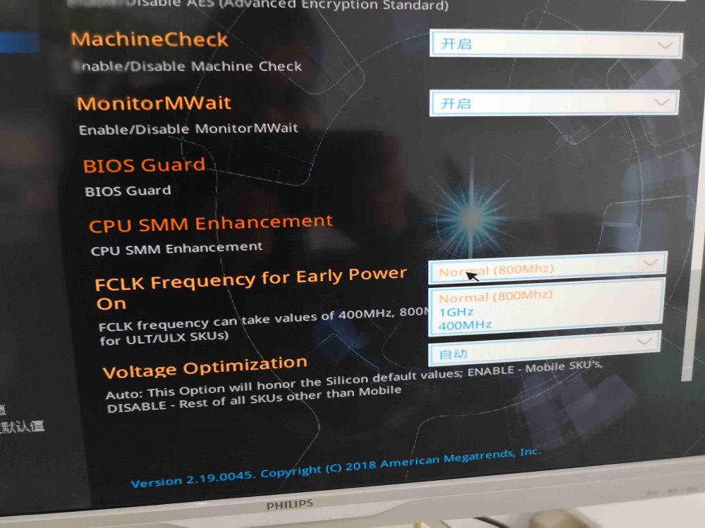

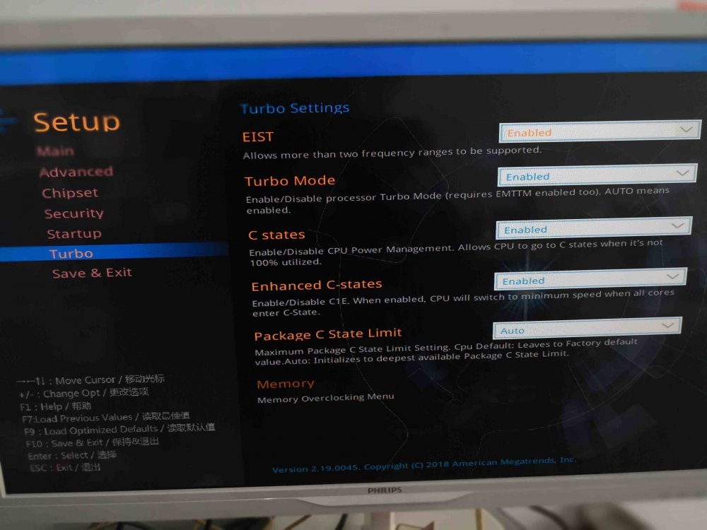

visin Posted May 2, 2018 Share Posted May 2, 2018 On 4/30/2018 at 7:41 AM, visin said: I used the clover you provided and found the following questions: 1. Look at DSDT. There is a mistake. 2, PCI devices are only EMI Controller and UHD 630. 3, There are problems to turn off and restart. (1) no power is cut off, the machine is still running, but there is no image on the monitor. (2) the restart state is the same as the shutdown, and the monitor has no image. 4, Audio still do not work, I injected 5, 7, 11, 12, 13, no effect, I checked the information, some solution is in the DSDT Patch, I put it below, you see if there is any use. (1)HDEF_Patch #Automatically adjusted by AppleHDA Patcher.app # original by RehabMan # Inject Audio info into method label _DSM parent_label HDEF remove_entry; into device label HDEF insert begin Method (_DSM, 4, NotSerialized)\n {\n If (LEqual (Arg2, Zero)) { Return (Buffer() { 0x03 } ) }\n Return (Package()\n {\n "AAPL,slot-name", Buffer() { "Built in" },\n "layout-id", Buffer() { 0x05, 0x00, 0x00, 0x00 },\n "device_type", Buffer() { "Audio Controller" },\n "built-in", Buffer() { 0x00 },\n "PinConfigurations", Buffer() { },\n "hda-gfx", Buffer() { "onboard-1" }\n })\n }\n end (2)IRQ_Fix {\rtf1\ansi\ansicpg936\cocoartf1561\cocoasubrtf200 {\fonttbl\f0\fswiss\fcharset0 Helvetica;} {\colortbl;\red255\green255\blue255;} {\*\expandedcolortbl;;} \paperw11900\paperh16840\margl1440\margr1440\vieww10800\viewh8400\viewkind0 \pard\tx566\tx1133\tx1700\tx2267\tx2834\tx3401\tx3968\tx4535\tx5102\tx5669\tx6236\tx6803\pardirnatural\partightenfactor0 \f0\fs24 \cf0 #Maintained by: RehabMan for: Laptop Patches\ #system_IRQ.txt\ \ # This can fix non-working audio and also has an affect on HPET.\ #\ # Use this if you have issues with patched AppleHDA (required on almost all laptops)\ # or if you have issues with HPET (restart after wake).\ \ # IRQ fix\ into device name_hid PNP0000 code_regex IRQNoFlags\\s\\(\\)\\n\\s+\\\{(\\d+)\\\} remove_matched;\ into device name_hid PNP0100 code_regex IRQNoFlags\\s\\(\\)\\n\\s+\\\{(\\d+)\\\} remove_matched;\ into device name_hid PNP0B00 code_regex IRQNoFlags\\s\\(\\)\\n\\s+\\\{(\\d+)\\\} remove_matched;\ into device name_hid PNP0103 code_regex IRQNoFlags\\s\\(\\)\\n\\s+\\\{.*\\\} removeall_matched;\ into device name_hid PNP0103 code_regex Name\\s\\(([^,]+),\\sResourceTemplate\\s\\(\\).*\\n\\s+\\\{((?:.|\\n)*)\\\}\\) replace_matched\ begin\ Name (%1, ResourceTemplate()\\n\ \{\\n\ IRQNoFlags() \{ 0, 8, 11, 15 \}\\n\ %2\ \})\\n\ end;} I got the Codec#0 of the audio, but I didn't compile AppleALC. codec#0 Verbs from Linux Codec Dump File: codec#0 Codec: Realtek ALC662 rev3 Address: 0 DevID: 283903586 (0x10ec0662) Jack Color Description Node PinDefault Original Verbs -------------------------------------------------------------------------------------------------------- 1/8 Black Speaker at Ext Rear 18 0x12 0x411111f0 01271cf0 01271d11 01271e11 01271f41 1/8 Green Line Out at Ext Rear 20 0x14 0x01014010 01471c10 01471d40 01471e01 01471f01 Analog UNKNOWN Speaker at Ext N/A 21 0x15 0x4017c040 01571c40 01571dc0 01571e17 01571f40 1/8 Black Speaker at Ext Rear 22 0x16 0x411111f0 01671cf0 01671d11 01671e11 01671f41 Mic at Ext Rear 0x18 0x18 27365408 01871c20 01871d90 01871ea1 01871f01 Mic at Ext Front 0x19 0x19 44142625 01971c21 01971d90 01971ea1 01971f02 Line In at Ext Rear 0x1a 0x1a 25243695 01a71c2f 01a71d30 01a71e81 01a71f01 HP Out at Ext Front 0x1b 0x1b 35733535 01b71c1f 01b71d40 01b71e21 01b71f02 1/8 Black Speaker at Ext Rear 28 0x1c 0x411111f0 01c71cf0 01c71d11 01c71e11 01c71f41 Optical UNKNOWN Mic at Ext N/A 29 0x1d 0x40a5c641 01d71c41 01d71dc6 01d71ea5 01d71f40 1/8 Black Speaker at Ext Rear 30 0x1e 0x411111f0 01e71cf0 01e71d11 01e71e11 01e71f41 -------------------------------------------------------------------------------------------------------- Jack Color Description Node PinDefault Modified Verbs -------------------------------------------------------------------------------------------------------- 1/8 Green Line Out at Ext Rear 20 0x14 0x01014010 01471c10 01471d40 01471e01 01471f01 Analog UNKNOWN Speaker at Ext N/A 21 0x15 0x4017c040 01571c40 01571dc0 01571e17 01571f40 Mic at Ext Rear 0x18 0x18 27365408 01871c20 01871d90 01871ea1 01871f01 Mic at Ext Front 0x19 0x19 44142625 01971c30 01971d90 01971ea1 01971f01 Line In at Ext Rear 0x1a 0x1a 25243695 01a71c50 01a71d30 01a71e81 01a71f01 HP Out at Ext Front 0x1b 0x1b 35733535 01b71c60 01b71d40 01b71e21 01b71f01 Optical UNKNOWN Mic at Ext N/A 29 0x1d 0x40a5c641 01d71c70 01d71dc0 01d71ea5 01d71f40 -------------------------------------------------------------------------------------------------------- I re run send_Me https://drive.google.com/open?id=16LHBuWvxh-HYT3gT1HqxRtw-WnqoTsaH Dear MaLd0n: My B360M-M2 motherboard still doesn't solve the problem. I have followed the clover boot system provided by you, and F4 has extracted ACPI to run Run Me.app again. Please repair the DSDT. Now restart is not normal, restart the screen after the black screen, but the CPU fan runs. The shutdown is not normal. After shutdown, the CPU fan runs. I'm sorry to trouble you. I hope to solve these problems. https://drive.google.com/open?id=16LHBuWvxh-HYT3gT1HqxRtw-WnqoTsaH Link to comment https://www.insanelymac.com/forum/topic/321872-guide-catalina-bigsur-monterey-on-mobos-serie-100-200-300-400-500-600-skylake-kabylake-coffeelake-cometlake-rocketlake-alderlake-dsdt/page/114/#findComment-2612235 Share on other sites More sharing options...
MaLd0n Posted May 2, 2018 Author Share Posted May 2, 2018 17 minutes ago, visin said: Dear MaLd0n: My B360M-M2 motherboard still doesn't solve the problem. I have followed the clover boot system provided by you, and F4 has extracted ACPI to run Run Me.app again. Please repair the DSDT. Now restart is not normal, restart the screen after the black screen, but the CPU fan runs. The shutdown is not normal. After shutdown, the CPU fan runs. I'm sorry to trouble you. I hope to solve these problems. https://drive.google.com/open?id=16LHBuWvxh-HYT3gT1HqxRtw-WnqoTsaH VERY WRONG THINGS THERE CLOVER.zip send me new files after reboot Link to comment https://www.insanelymac.com/forum/topic/321872-guide-catalina-bigsur-monterey-on-mobos-serie-100-200-300-400-500-600-skylake-kabylake-coffeelake-cometlake-rocketlake-alderlake-dsdt/page/114/#findComment-2612237 Share on other sites More sharing options...
rob88v Posted May 2, 2018 Share Posted May 2, 2018 28 minutes ago, MaLd0n said: check ur XHC id, in my case i inject a12f via DSDT, just to avoid xhci200/300 injectors This is the edit I made on ss01 according to my xhc id. The internal reader will sometimes work coming back from sleep and remounting my sd cards, but every other time it still shuts off on wake and if I try to sleep/wake again the reader auto wakes the system and the device stays on preventing sleep from occurring. Link to comment https://www.insanelymac.com/forum/topic/321872-guide-catalina-bigsur-monterey-on-mobos-serie-100-200-300-400-500-600-skylake-kabylake-coffeelake-cometlake-rocketlake-alderlake-dsdt/page/114/#findComment-2612238 Share on other sites More sharing options...
visin Posted May 2, 2018 Share Posted May 2, 2018 13 minutes ago, MaLd0n said: VERY WRONG THINGS THERE CLOVER.zip send me new files after reboot The problem is not resolved. After shutdown or restart, the CPU fan runs. This is the new RUN ME. App file. https://drive.google.com/open?id=1f0b_KukfqwWjOKe_ORX1ta3mRVfb0A0X Link to comment https://www.insanelymac.com/forum/topic/321872-guide-catalina-bigsur-monterey-on-mobos-serie-100-200-300-400-500-600-skylake-kabylake-coffeelake-cometlake-rocketlake-alderlake-dsdt/page/114/#findComment-2612239 Share on other sites More sharing options...
MaLd0n Posted May 2, 2018 Author Share Posted May 2, 2018 51 minutes ago, visin said: The problem is not resolved. After shutdown or restart, the CPU fan runs. This is the new RUN ME. App file. https://drive.google.com/open?id=1f0b_KukfqwWjOKe_ORX1ta3mRVfb0A0X ye, the bios b360 is very diff, i create all patches now, we need some tests, use this DSDT, reboot and send me new run_me DSDT.test1.zip 54 minutes ago, rob88v said: This is the edit I made on ss01 according to my xhc id. The internal reader will sometimes work coming back from sleep and remounting my sd cards, but every other time it still shuts off on wake and if I try to sleep/wake again the reader auto wakes the system and the device stays on preventing sleep from occurring. we need check it, i dont have any idea Link to comment https://www.insanelymac.com/forum/topic/321872-guide-catalina-bigsur-monterey-on-mobos-serie-100-200-300-400-500-600-skylake-kabylake-coffeelake-cometlake-rocketlake-alderlake-dsdt/page/114/#findComment-2612243 Share on other sites More sharing options...
visin Posted May 2, 2018 Share Posted May 2, 2018 9 minutes ago, MaLd0n said: ye, the bios b360 is very diff, i create all patches now, we need some tests, use this DSDT, reboot and send me new run_me DSDT.test1.zip OK, I'd like to help you with any test. I replaced DSDT and restarted, and the problem did not improve. New run_me. https://drive.google.com/open?id=1DWr70nXjMzt2oANi8RIEP90Q7zRq2JiD Link to comment https://www.insanelymac.com/forum/topic/321872-guide-catalina-bigsur-monterey-on-mobos-serie-100-200-300-400-500-600-skylake-kabylake-coffeelake-cometlake-rocketlake-alderlake-dsdt/page/114/#findComment-2612244 Share on other sites More sharing options...

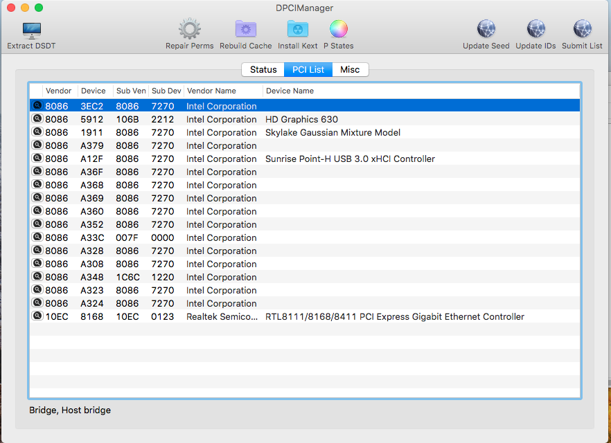

MaLd0n Posted May 2, 2018 Author Share Posted May 2, 2018 35 minutes ago, visin said: OK, I'd like to help you with any test. I replaced DSDT and restarted, and the problem did not improve. New run_me. https://drive.google.com/open?id=1DWr70nXjMzt2oANi8RIEP90Q7zRq2JiD Start work now, correct devices DSDT.aml.zip send me one Screenshot with DCPIManager, tab PCI List DPCIManager.app.zip Link to comment https://www.insanelymac.com/forum/topic/321872-guide-catalina-bigsur-monterey-on-mobos-serie-100-200-300-400-500-600-skylake-kabylake-coffeelake-cometlake-rocketlake-alderlake-dsdt/page/114/#findComment-2612245 Share on other sites More sharing options...
visin Posted May 2, 2018 Share Posted May 2, 2018 10 minutes ago, MaLd0n said: Start work now, correct devices DSDT.aml.zip send me one Screenshot with DCPIManager, tab PCI List DPCIManager.app.zip OK New run me.app files https://drive.google.com/open?id=1bJldqpy969J2i-5Vo7IAcySmbuioHCtb Link to comment https://www.insanelymac.com/forum/topic/321872-guide-catalina-bigsur-monterey-on-mobos-serie-100-200-300-400-500-600-skylake-kabylake-coffeelake-cometlake-rocketlake-alderlake-dsdt/page/114/#findComment-2612247 Share on other sites More sharing options...

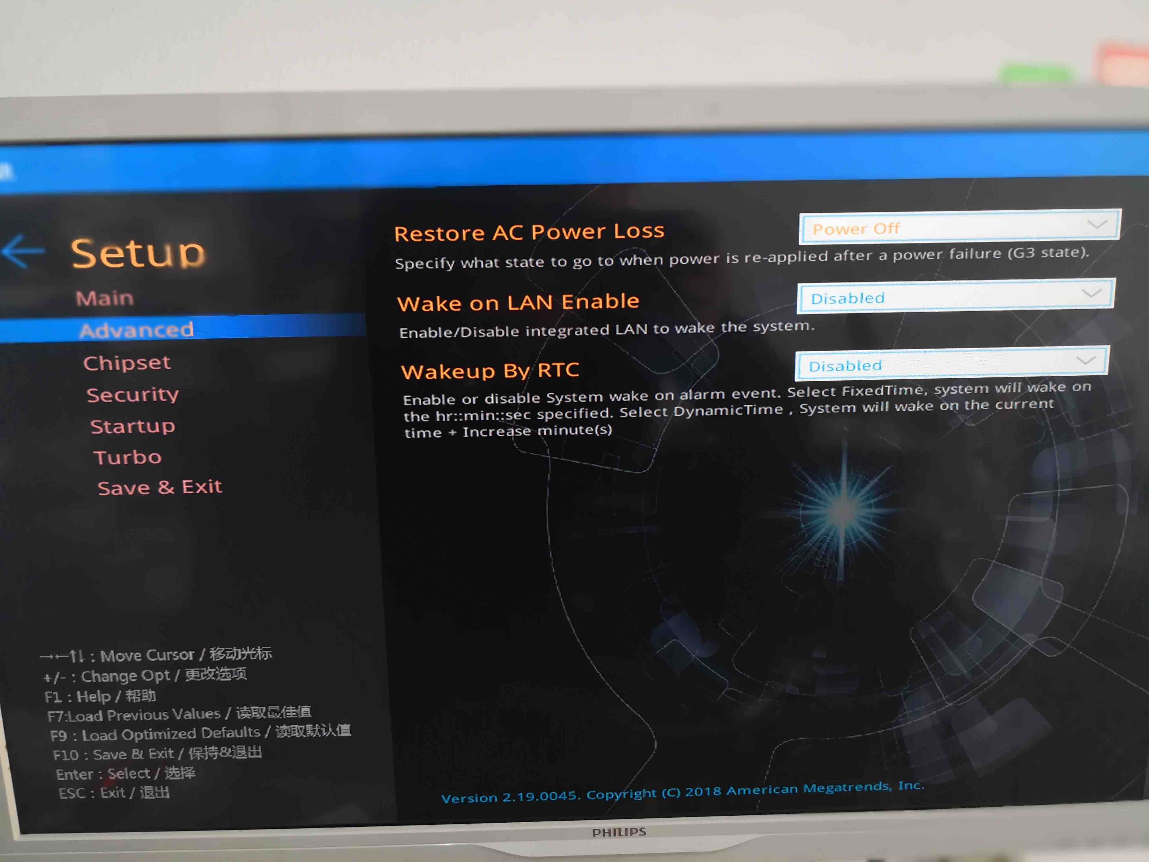

MaLd0n Posted May 2, 2018 Author Share Posted May 2, 2018 9 minutes ago, visin said: OK New run me.app files https://drive.google.com/open?id=1bJldqpy969J2i-5Vo7IAcySmbuioHCtb Arquivo Comprimido.zip for shutdown, check ERP option in bios Link to comment https://www.insanelymac.com/forum/topic/321872-guide-catalina-bigsur-monterey-on-mobos-serie-100-200-300-400-500-600-skylake-kabylake-coffeelake-cometlake-rocketlake-alderlake-dsdt/page/114/#findComment-2612248 Share on other sites More sharing options...
visin Posted May 2, 2018 Share Posted May 2, 2018 (edited) 5 hours ago, MaLd0n said: Arquivo Comprimido.zip for shutdown, check ERP option in bios I didn't find an option on ERP in BIOS. I called GALAXY Technology Department to check if they had the Erp Support function, and they told me that there was no Erp Support.Overlay the DSDT and USB drivers that you provide. New run me file https://drive.google.com/open?id=1OefYXVBlSZIwCj6rr6UxYmW2hAlaTHWv I got the list of PCI devices in Windows, I wonder if I can help you. Report-PCI.htm Edited May 2, 2018 by visin Link to comment https://www.insanelymac.com/forum/topic/321872-guide-catalina-bigsur-monterey-on-mobos-serie-100-200-300-400-500-600-skylake-kabylake-coffeelake-cometlake-rocketlake-alderlake-dsdt/page/114/#findComment-2612249 Share on other sites More sharing options...

telepati Posted May 2, 2018 Share Posted May 2, 2018 20 hours ago, MaLd0n said: not wrong, is a very old problem with Operations regions i'll check later Thank you. This kernel panic so annoying. Hope I can solve this problem. Link to comment https://www.insanelymac.com/forum/topic/321872-guide-catalina-bigsur-monterey-on-mobos-serie-100-200-300-400-500-600-skylake-kabylake-coffeelake-cometlake-rocketlake-alderlake-dsdt/page/114/#findComment-2612355 Share on other sites More sharing options...

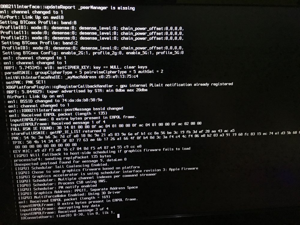

Handzo85 Posted May 3, 2018 Share Posted May 3, 2018 On 5/2/2018 at 12:58 AM, Handzo85 said: I just take what you suggest.. but unfortunately my system won't boot by using your clover folder until I little edit untick acpi FixRegions & FixMutex, meanwhile my wifi suddenly not working like in my screen capture below. *addition info I use iogear bluetooth 4.0 usb (gbu-521) + TP link Archer T6E to activate Airdrop feature on my Hackintosh Sierra 10.12.6 these file that you asking me I hope u can solved these problem this link files dump https://www68.zippyshare.com/v/EW30dJHv/file.html dear MaLd0n.. what should I do after sent these troubleshoot hv u fixed my dsdt problems? thx for ur help Link to comment https://www.insanelymac.com/forum/topic/321872-guide-catalina-bigsur-monterey-on-mobos-serie-100-200-300-400-500-600-skylake-kabylake-coffeelake-cometlake-rocketlake-alderlake-dsdt/page/114/#findComment-2612366 Share on other sites More sharing options...
MaLd0n Posted May 3, 2018 Author Share Posted May 3, 2018 39 minutes ago, Handzo85 said: dear MaLd0n.. what should I do after sent these troubleshoot hv u fixed my dsdt problems? thx for ur help try CLOVER.zip Link to comment https://www.insanelymac.com/forum/topic/321872-guide-catalina-bigsur-monterey-on-mobos-serie-100-200-300-400-500-600-skylake-kabylake-coffeelake-cometlake-rocketlake-alderlake-dsdt/page/114/#findComment-2612369 Share on other sites More sharing options...
MaLd0n Posted May 3, 2018 Author Share Posted May 3, 2018 On 5/1/2018 at 5:19 PM, telepati said: Hi @MaLd0n I need a new DSDT. I made couple of Hardware and Bios update. After this changes, I am starting to get NVME kernel Panic; Anonymous UUID: 9E064598-53F3-B729-3D5B-907138F44679 Tue May 1 20:37:32 2018 *** Panic Report *** panic(cpu 0 caller 0xffffff7f839e9f7b): nvme: " NVMe: Command timed-out and request found in the completion queue \n"@/BuildRoot/Library/Caches/com.apple.xbs/Sources/IONVMeFamily/IONVMeFamily-356.50.26/IONVMeController.cpp:5188 Backtrace (CPU 0), Frame : Return Address 0xffffff874a5a3b50 : 0xffffff800046e166 0xffffff874a5a3ba0 : 0xffffff8000596714 0xffffff874a5a3be0 : 0xffffff8000588a00 0xffffff874a5a3c60 : 0xffffff8000420180 0xffffff874a5a3c80 : 0xffffff800046dbdc 0xffffff874a5a3db0 : 0xffffff800046d99c 0xffffff874a5a3e10 : 0xffffff7f839e9f7b 0xffffff874a5a3e30 : 0xffffff8000a9f71c 0xffffff874a5a3ea0 : 0xffffff8000a9f646 0xffffff874a5a3ed0 : 0xffffff80004a77e4 0xffffff874a5a3f40 : 0xffffff80004a7345 0xffffff874a5a3fa0 : 0xffffff800041f4f7 Kernel Extensions in backtrace: com.apple.iokit.IONVMeFamily(2.1)[AAD9E232-4F00-3702-9310-C5ABB53A5B6F]@0xffffff7f839d6000->0xffffff7f83a14fff dependency: com.apple.driver.AppleMobileFileIntegrity(1.0.5)[E56BF7DF-B38F-3193-9A02-9DB0BAC70D7A]@0xffffff7f813f7000 dependency: com.apple.iokit.IOPCIFamily(2.9)[580E0204-B37A-32BA-AC27-E8DBCA519B1F]@0xffffff7f80c94000 dependency: com.apple.driver.AppleEFINVRAM(2.1)[F35A52E2-CF80-3BA9-92B5-25EFE216094F]@0xffffff7f8127a000 dependency: com.apple.iokit.IOStorageFamily(2.1)[F27A8A2A-6662-3608-83BD-415037509E01]@0xffffff7f80e46000 dependency: com.apple.iokit.IOReportFamily(31)[D2F2FBDF-4EE4-38BA-99F5-B699F886F413]@0xffffff7f81ac0000 BSD process name corresponding to current thread: kernel_task Boot args: uia_exclude=HS03;HS04;HS07;HS08;HS11;HS12;HS13;SS03;SS04;SS07;SS08;SS09;SS10; Mac OS version: 17E202 Kernel version: Darwin Kernel Version 17.5.0: Fri Apr 13 19:32:32 PDT 2018; root:xnu-4570.51.2~1/RELEASE_X86_64 Kernel UUID: 7134F18E-AAC2-3C5B-B2C4-ABB799B4B9DF Kernel slide: 0x0000000000200000 Kernel text base: 0xffffff8000400000 __HIB text base: 0xffffff8000300000 System model name: iMac17,1 (Mac-65CE76090165799A) System uptime in nanoseconds: 46705598003 last loaded kext at 12363600817: com.apple.driver.AppleUpstreamUserClient 3.6.5 (addr 0xffffff7f83893000, size 36864) loaded kexts: com.insanelymac.IntelMausiEthernet 2.4.0d0 org.netkas.driver.FakeSMC 1787 as.vit9696.AppleALC 1.2.6 as.vit9696.Lilu 1.2.3 com.rehabman.driver.USBInjectAll 0.6.5 com.apple.driver.AppleUpstreamUserClient 3.6.5 com.apple.kext.AMDFramebuffer 1.6.6 com.apple.driver.AppleHDAHardwareConfigDriver 281.51 com.apple.driver.AppleHDA 281.51 com.apple.driver.AGPM 110.23.33 com.apple.driver.ApplePlatformEnabler 2.7.0d0 com.apple.driver.X86PlatformShim 1.0.0 com.apple.kext.AMDRadeonX4000 1.6.6 com.apple.driver.AppleGraphicsDevicePolicy 3.18.48 com.apple.AGDCPluginDisplayMetrics 3.18.48 com.apple.driver.AppleHV 1 com.apple.iokit.IOUserEthernet 1.0.1 com.apple.iokit.IOBluetoothSerialManager 6.0.5f3 com.apple.driver.pmtelemetry 1 com.apple.Dont_Steal_Mac_OS_X 7.0.0 com.apple.driver.AppleIntelPCHPMC 2.0.1 com.apple.driver.AppleOSXWatchdog 1 com.apple.kext.AMD9500Controller 1.6.6 com.apple.driver.AppleSMCLMU 211 com.apple.driver.ACPI_SMC_PlatformPlugin 1.0.0 com.apple.driver.AppleFIVRDriver 4.1.0 com.apple.driver.AppleIntelSlowAdaptiveClocking 4.0.0 com.apple.driver.AGDCBacklightControl 3.18.48 com.apple.driver.AppleBacklight 170.12.6 com.apple.driver.AppleMCCSControl 1.5.4 com.apple.iokit.IOBluetoothUSBDFU 6.0.5f3 com.apple.driver.AppleFileSystemDriver 3.0.1 com.apple.filesystems.hfs.kext 407.50.6 com.apple.AppleFSCompression.AppleFSCompressionTypeDataless 1.0.0d1 com.apple.BootCache 40 com.apple.AppleFSCompression.AppleFSCompressionTypeZlib 1.0.0 com.apple.filesystems.apfs 748.51.0 com.apple.driver.AirPort.BrcmNIC 1240.29.1a7 com.apple.driver.AppleAHCIPort 329.50.2 com.apple.driver.AppleRTC 2.0 com.apple.driver.AppleHPET 1.8 com.apple.driver.AppleACPIButtons 6.1 com.apple.driver.AppleSMBIOS 2.1 com.apple.driver.AppleAPIC 1.7 com.apple.nke.applicationfirewall 183 com.apple.security.TMSafetyNet 8 com.apple.security.quarantine 3 com.apple.driver.DspFuncLib 281.51 com.apple.kext.OSvKernDSPLib 526 com.apple.kext.AMDRadeonX4000HWLibs 1.0 com.apple.iokit.IOAcceleratorFamily2 378.18.1 com.apple.kext.AMDRadeonX4000HWServices 1.6.6 com.apple.driver.AppleGraphicsControl 3.18.48 com.apple.iokit.IOAVBFamily 675.6 com.apple.plugin.IOgPTPPlugin 675.12 com.apple.iokit.IOEthernetAVBController 1.1.0 com.apple.driver.AppleSSE 1.0 com.apple.iokit.IOSurface 211.12 com.apple.iokit.IOSerialFamily 11 com.apple.driver.AppleHDAController 281.51 com.apple.iokit.IOHDAFamily 281.51 com.apple.iokit.IOAudioFamily 206.5 com.apple.vecLib.kext 1.2.0 com.apple.driver.IOPlatformPluginLegacy 1.0.0 com.apple.driver.X86PlatformPlugin 1.0.0 com.apple.driver.IOPlatformPluginFamily 6.0.0d8 com.apple.AppleGPUWrangler 3.18.48 com.apple.iokit.IOSlowAdaptiveClockingFamily 1.0.0 com.apple.kext.AMDSupport 1.6.6 com.apple.driver.AppleSMBusPCI 1.0.14d1 com.apple.AppleGraphicsDeviceControl 3.18.48 com.apple.driver.AppleBacklightExpert 1.1.0 com.apple.iokit.IONDRVSupport 519.15 com.apple.driver.AppleSMBusController 1.0.18d1 com.apple.iokit.IOSMBusFamily 1.1 com.apple.iokit.IOGraphicsFamily 519.15 com.apple.iokit.IOAHCIBlockStorage 301.40.2 com.apple.driver.AppleHIDKeyboard 205 com.apple.driver.usb.IOUSBHostHIDDevice 1.2 com.apple.iokit.BroadcomBluetoothHostControllerUSBTransport 6.0.5f3 com.apple.iokit.IOBluetoothHostControllerUSBTransport 6.0.5f3 com.apple.iokit.IOBluetoothHostControllerTransport 6.0.5f3 com.apple.iokit.IOBluetoothFamily 6.0.5f3 com.apple.driver.usb.cdc 5.0.0 com.apple.driver.usb.networking 5.0.0 com.apple.driver.usb.AppleUSBHostCompositeDevice 1.2 com.apple.driver.AppleUSBHostMergeProperties 1.2 com.apple.driver.usb.AppleUSBHub 1.2 com.apple.filesystems.hfs.encodings.kext 1 com.apple.driver.AppleXsanScheme 3 com.apple.iokit.IONVMeFamily 2.1.0 com.apple.iokit.IO80211Family 1200.12.2 com.apple.driver.mDNSOffloadUserClient 1.0.1b8 com.apple.driver.corecapture 1.0.4 com.apple.driver.AppleIntelLpssGspi 3.0.60 com.apple.driver.AppleIntelLpssI2C 3.0.60 com.apple.iokit.IOAHCIFamily 288 com.apple.driver.usb.AppleUSBXHCIPCI 1.2 com.apple.driver.usb.AppleUSBXHCI 1.2 com.apple.driver.usb.AppleUSBHostPacketFilter 1.0 com.apple.iokit.IOUSBFamily 900.4.1 com.apple.driver.AppleEFINVRAM 2.1 com.apple.driver.AppleEFIRuntime 2.1 com.apple.iokit.IOHIDFamily 2.0.0 com.apple.security.sandbox 300.0 com.apple.kext.AppleMatch 1.0.0d1 com.apple.driver.DiskImages 480.50.10 com.apple.driver.AppleFDEKeyStore 28.30 com.apple.driver.AppleEffaceableStorage 1.0 com.apple.driver.AppleKeyStore 2 com.apple.driver.AppleUSBTDM 439.50.6 com.apple.driver.AppleMobileFileIntegrity 1.0.5 com.apple.iokit.IOUSBMassStorageDriver 140.50.3 com.apple.iokit.IOSCSIBlockCommandsDevice 404.30.2 com.apple.iokit.IOSCSIArchitectureModelFamily 404.30.2 com.apple.iokit.IOStorageFamily 2.1 com.apple.driver.AppleCredentialManager 1.0 com.apple.driver.KernelRelayHost 1 com.apple.iokit.IOUSBHostFamily 1.2 com.apple.driver.usb.AppleUSBCommon 1.0 com.apple.driver.AppleBusPowerController 1.0 com.apple.driver.AppleSEPManager 1.0.1 com.apple.driver.IOSlaveProcessor 1 com.apple.iokit.IOReportFamily 31 com.apple.iokit.IOTimeSyncFamily 675.12 com.apple.iokit.IONetworkingFamily 3.4 com.apple.driver.AppleACPIPlatform 6.1 com.apple.driver.AppleSMC 3.1.9 com.apple.iokit.IOPCIFamily 2.9 com.apple.iokit.IOACPIFamily 1.4 com.apple.kec.pthread 1 com.apple.kec.Libm 1 com.apple.kec.corecrypto 1.0 EOF Model: iMac17,1, BootROM IM171.0151.B00, 4 processors, Intel Core i7, 4,01 GHz, 64 GB, SMC 2.33f10 Graphics: Radeon RX 560, Radeon RX 560, PCIe Memory Module: BANK 0/DIMM0, 16 GB, DDR4, 2400 MHz, Crucial Technology, BLS16G4D240FSB.16FAD Memory Module: BANK 1/DIMM0, 16 GB, DDR4, 2400 MHz, Crucial Technology, BLS16G4D240FSB.16FAD Memory Module: BANK 0/DIMM1, 16 GB, DDR4, 2400 MHz, Crucial Technology, BLS16G4D240FSB.16FAD Memory Module: BANK 1/DIMM1, 16 GB, DDR4, 2400 MHz, Crucial Technology, BLS16G4D240FSB.16FAD AirPort: spairport_wireless_card_type_airport_extreme (0x14E4, 0x111), Broadcom BCM43xx 1.0 (7.77.37.29.1a7) Bluetooth: Version 6.0.5f3, 3 services, 27 devices, 1 incoming serial ports Network Service: Wi-Fi, AirPort, en1 PCI Card: Intel Corporation, Series Chipset USB xHCI Host Controller, USB Controller, Built In PCI Card: Intel Corporation, Series Chipset MEI Controller, IMEI Controller, Built In PCI Card: Intel Corporation, Series Chipset SATA Controller, AHCI Controller, Built In PCI Card: Radeon RX 560, Display Controller, PCI Slot 0 PCI Card: Apple HDMI Audio Controller, HDMI Controller, Built In PCI Card: Intel Corporation, Series Chipset PCHPMC Controller, PCHPMC Controller, Built In PCI Card: Apple High Definition Audio Controller, Audio Controller, Built In PCI Card: Intel I219V2 PCI Express Gigabit Ethernet, Ethernet Controller, Built In PCI Card: ASMedia USB 3.1 eXtensible Host Controller #2, USB Controller, Built In PCI Card: ASMedia USB 3.1 eXtensible Host Controller #1, USB Controller, Built In PCI Card: Apple NVMe M2 Flash Drive, Storage Controller, Built In PCI Card: Broadcom BCM43xx Wireless Network Adapter, AirPort Extreme, Built In Serial ATA Device: WDC WD20EARS-00MVWB0, 2 TB Serial ATA Device: Samsung SSD 840 EVO 250GB, 250,06 GB Serial ATA Device: WDC WD10EZRX-00A8LB0, 1 TB Serial ATA Device: WDC WD20EARS-00MVWB0, 2 TB USB Device: USB 3.0 Bus USB Device: BRCM20702 Hub USB Device: Bluetooth USB Host Controller USB Device: USB2.0 Hub USB Device: Keyboard Hub USB Device: Apple Keyboard USB Device: USB 3.0 Bus USB Device: USB 3.1 Bus Thunderbolt Bus: I asked Rehabman and he is give this answer; Your ACPI/patched/DSDT.aml is not in sync with native ACPI.Note different SystemMemory addresses: NUC6i7KYK:patched rehabman$ diff ../origin/ ../patched/|grep SystemMemory < OperationRegion (GNVS, SystemMemory, 0x8F045000, 0x06B3) > OperationRegion (GNVS, SystemMemory, 0x8A868000, 0x06B3) < OperationRegion (CPSB, SystemMemory, 0x8E7B3F98, 0x10) > OperationRegion (CPSB, SystemMemory, 0x89FE7F98, 0x10) < OperationRegion (XMIO, SystemMemory, Local0, 0x9000) Very bad idea to run with incorrect SystemMemory addresses...Note that config.plist/ACPI/DSDT/Fixes/FixRegions cannot be relied upon. It is too buggy to use. I am not capable of the making DSDT. Could you please help me? Here is my Send_me files. Thank you. https://www.dropbox.com/s/tx6sp2dki5y16ur/Send me Murats-Mac.zip?dl=0 CLOVER.zip 19 hours ago, TheXpert said: Hey Guys, I'm running an Intel i7 8700K processor among with the Z370 Asus Maximus X Hero motherboard and the AMD Radeon RX 580 8GB. I cannot seem to get the USB installer to show up the macOS installer. Tried literally everything. This is the original post that I've been working together with Cyberdevs to figure out what's going wrong - This thread seems relevant to my setup, hence why I posted this here. Any help would be greatly appreciated. Thanks, Daniel u boot from usb and all installation steps? 1 Link to comment https://www.insanelymac.com/forum/topic/321872-guide-catalina-bigsur-monterey-on-mobos-serie-100-200-300-400-500-600-skylake-kabylake-coffeelake-cometlake-rocketlake-alderlake-dsdt/page/114/#findComment-2612370 Share on other sites More sharing options...
