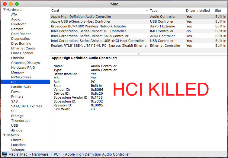

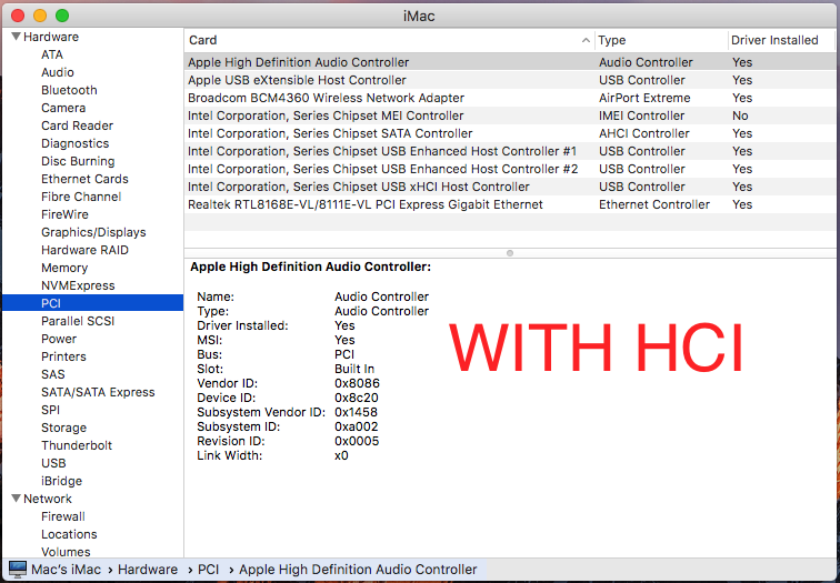

RandomTech Posted May 6, 2018 Share Posted May 6, 2018 4 hours ago, MaLd0n said: take a shots and let me know what file work USB 3 non intel, work native some new asmedia and FL1100, the others u need a genericxhci, but kext in el capo+ cause some problems send me new files with tests above Tested both files and usb 2/3 are working fine Thanks Mald0n Link to comment https://www.insanelymac.com/forum/topic/321872-guide-catalina-bigsur-monterey-on-mobos-serie-100-200-300-400-500-600-skylake-kabylake-coffeelake-cometlake-rocketlake-alderlake-dsdt/page/117/#findComment-2612754 Share on other sites More sharing options...

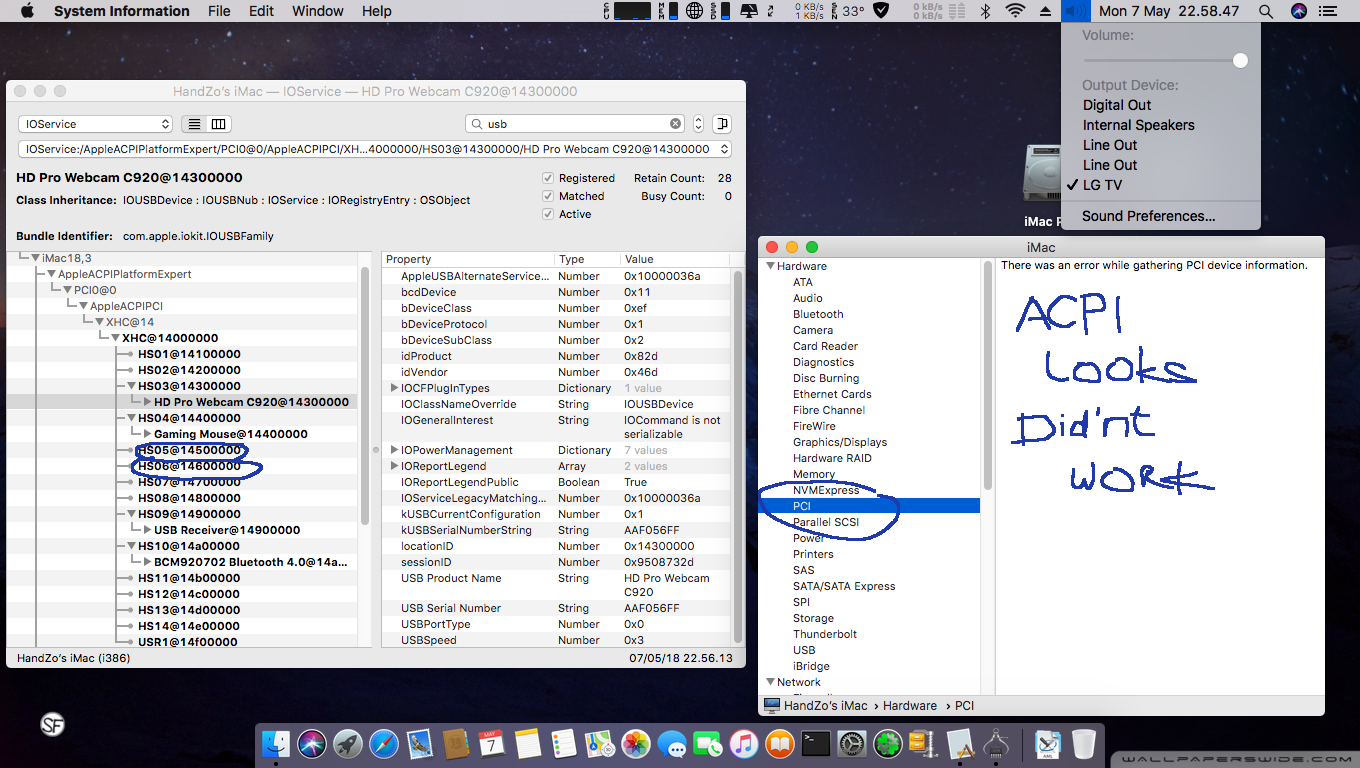

Handzo85 Posted May 6, 2018 Share Posted May 6, 2018 5 hours ago, MaLd0n said: u need a correct config in bios, for me is intelhd enable and csm disable i hv tried everything to get uefi boot recognized it.. but at the end i getting bootloop like these.. https://www84.zippyshare.com/v/SyxkvgmH/file.html don't know if it related clover config or something else Link to comment https://www.insanelymac.com/forum/topic/321872-guide-catalina-bigsur-monterey-on-mobos-serie-100-200-300-400-500-600-skylake-kabylake-coffeelake-cometlake-rocketlake-alderlake-dsdt/page/117/#findComment-2612758 Share on other sites More sharing options...
MaLd0n Posted May 7, 2018 Author Share Posted May 7, 2018 2 hours ago, RandomTech said: Tested both files and usb 2/3 are working fine Thanks Mald0n use EHCI KILLED, is a correct way and correct usb properties u see all USBs into USB 3 BUS test sleep etc, let me know 1 hour ago, Handzo85 said: i hv tried everything to get uefi boot recognized it.. but at the end i getting bootloop like these.. https://www84.zippyshare.com/v/SyxkvgmH/file.html don't know if it related clover config or something else idk, need a tests Link to comment https://www.insanelymac.com/forum/topic/321872-guide-catalina-bigsur-monterey-on-mobos-serie-100-200-300-400-500-600-skylake-kabylake-coffeelake-cometlake-rocketlake-alderlake-dsdt/page/117/#findComment-2612760 Share on other sites More sharing options...

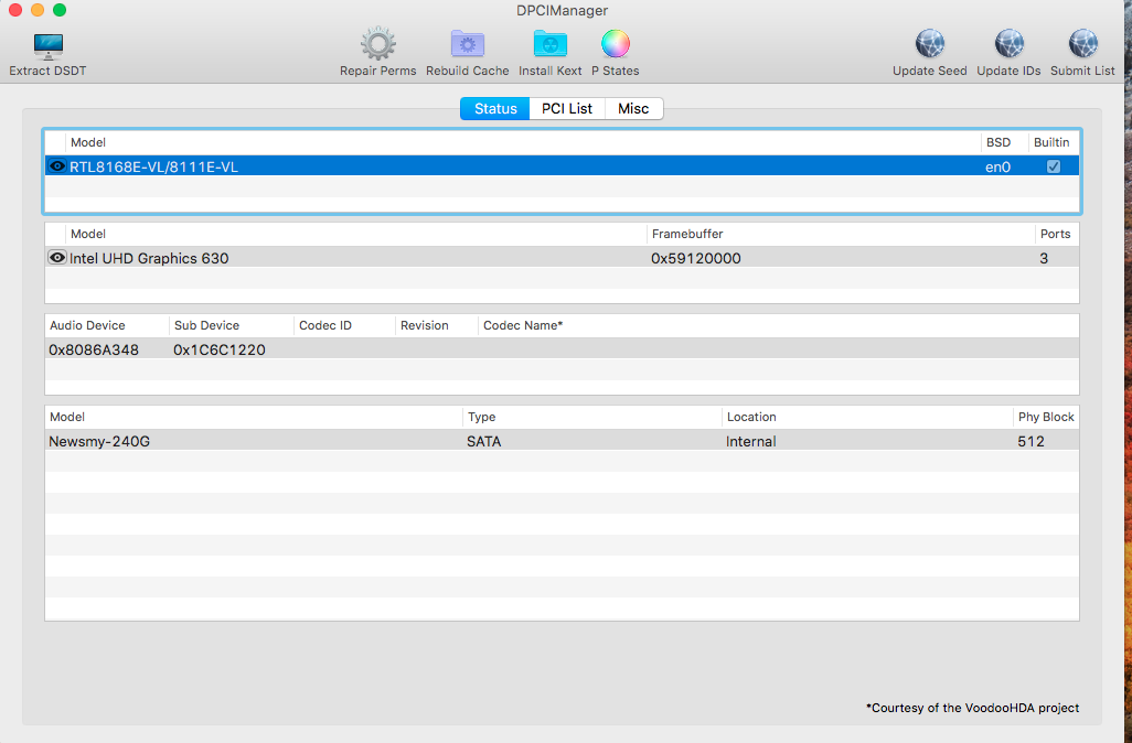

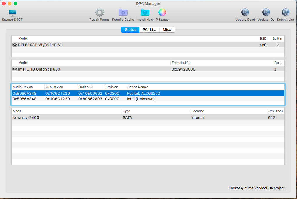

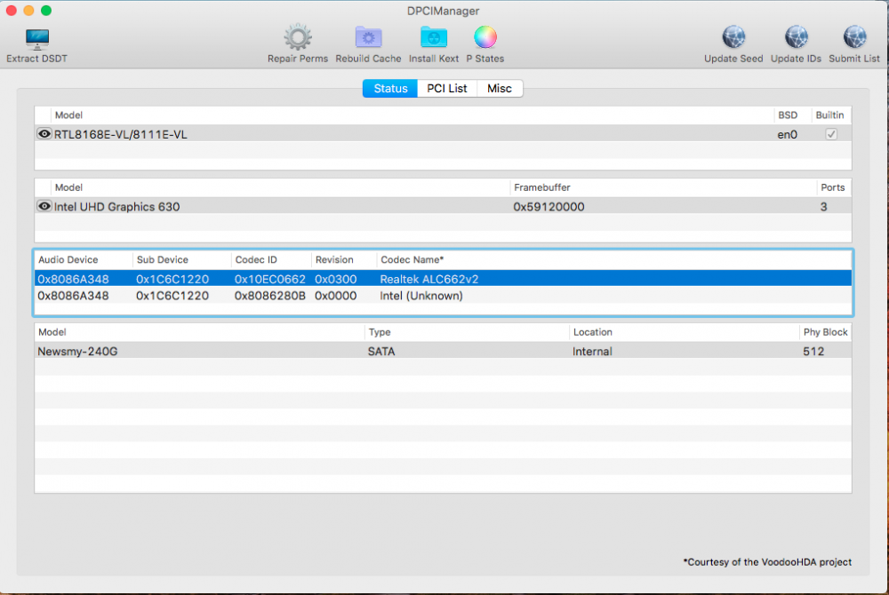

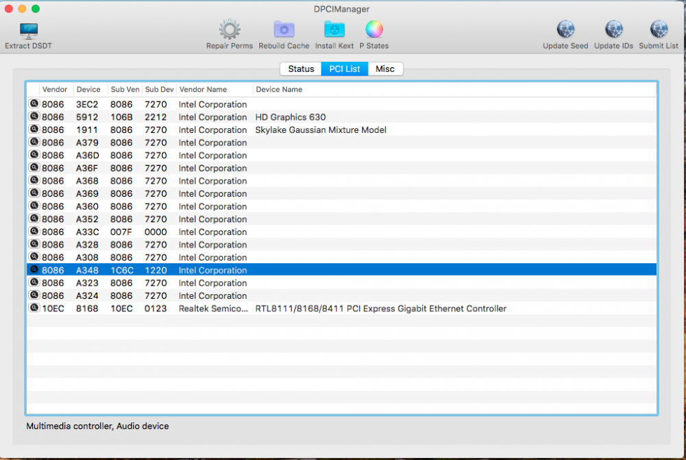

visin Posted May 7, 2018 Share Posted May 7, 2018 (edited) Hello, MaLd0n: I received the replacement B360M and did not load the DSDT. First talk about configuration: CPU:i5-8400 MB:colorful B360M-F RAM:DDR4 2133 8G Audio:ALC662 NetWork:RTL8168E-V USB:A36D The current situation of work: 1. Audio work 2. Network work 3, USB work, and correctly identify A36D 4, Video work 5, shut down does not power off, CPU fan runs 6, can not be restarted, symptoms similar to shutdown CPU Fan operation, no power failure 7,after sleep can not wake up Unfortunately, there is still no Erp in the new motherboard Bios. I wonder if I can repair the restart and Shut down problem in DSDT. Re run Run_me.app https://drive.google.com/open?id=1yQafy5he8DW2XoEHoeFKvJkPZE9kfool Edited May 7, 2018 by visin Link to comment https://www.insanelymac.com/forum/topic/321872-guide-catalina-bigsur-monterey-on-mobos-serie-100-200-300-400-500-600-skylake-kabylake-coffeelake-cometlake-rocketlake-alderlake-dsdt/page/117/#findComment-2612776 Share on other sites More sharing options...

MaLd0n Posted May 7, 2018 Author Share Posted May 7, 2018 6 hours ago, visin said: Hello, MaLd0n: I received the replacement B360M and did not load the DSDT. First talk about configuration: CPU:i5-8400 MB:colorful B360M-F RAM:DDR4 2133 8G Audio:ALC662 NetWork:RTL8168E-V USB:A36D The current situation of work: 1. Audio work 2. Network work 3, USB work, and correctly identify A36D 4, Video work 5, shut down does not power off, CPU fan runs 6, can not be restarted, symptoms similar to shutdown CPU Fan operation, no power failure 7,after sleep can not wake up Unfortunately, there is still no Erp in the new motherboard Bios. I wonder if I can repair the restart and Shut down problem in DSDT. Re run Run_me.app https://drive.google.com/open?id=1yQafy5he8DW2XoEHoeFKvJkPZE9kfool restart is not in DSDT, shutdown yes, _PTS(prepare to sleep) or _GTS(going to sleep) Arquivo Comprimido.zip take a shot, send me new files, if dont work, we need a debug shutdown Link to comment https://www.insanelymac.com/forum/topic/321872-guide-catalina-bigsur-monterey-on-mobos-serie-100-200-300-400-500-600-skylake-kabylake-coffeelake-cometlake-rocketlake-alderlake-dsdt/page/117/#findComment-2612800 Share on other sites More sharing options...

Handzo85 Posted May 7, 2018 Share Posted May 7, 2018 1 hour ago, MaLd0n said: no idea, u need test, read Shiki wiki about first attempt Im getting bootloop.. still try hard Link to comment https://www.insanelymac.com/forum/topic/321872-guide-catalina-bigsur-monterey-on-mobos-serie-100-200-300-400-500-600-skylake-kabylake-coffeelake-cometlake-rocketlake-alderlake-dsdt/page/117/#findComment-2612805 Share on other sites More sharing options...
MaLd0n Posted May 7, 2018 Author Share Posted May 7, 2018 9 minutes ago, Handzo85 said: first attempt Im getting bootloop.. still try hard disable intelhd in bios, test dsdt above and send me new files, after we try solve intel quick sync Link to comment https://www.insanelymac.com/forum/topic/321872-guide-catalina-bigsur-monterey-on-mobos-serie-100-200-300-400-500-600-skylake-kabylake-coffeelake-cometlake-rocketlake-alderlake-dsdt/page/117/#findComment-2612807 Share on other sites More sharing options...
Handzo85 Posted May 7, 2018 Share Posted May 7, 2018 50 minutes ago, MaLd0n said: disable intelhd in bios, test dsdt above and send me new files, after we try solve intel quick sync I hv tried disable cpudisplay & setup to egpu as default but still getting bootloop. after that I hv tried to changing clover config.plist with new file over windows.. but right now don't know my USB port didnt detect like before looks at SS05/SS06 or HS05/HS06 port didn't show anything while I trying this port. don't know what clover usb patch is wrong. maybe u can correct my config.plist again. this my system dump with last dsdt files u gv me. https://www68.zippyshare.com/v/oj5mVG27/file.html hope u don't get tired of me Link to comment https://www.insanelymac.com/forum/topic/321872-guide-catalina-bigsur-monterey-on-mobos-serie-100-200-300-400-500-600-skylake-kabylake-coffeelake-cometlake-rocketlake-alderlake-dsdt/page/117/#findComment-2612809 Share on other sites More sharing options...
MaLd0n Posted May 7, 2018 Author Share Posted May 7, 2018 13 minutes ago, Handzo85 said: I hv tried disable cpudisplay & setup to egpu as default but still getting bootloop. after that I hv tried to changing clover config.plist with new file over windows.. but right now don't know my USB port didnt detect like before looks at SS05/SS06 or HS05/HS06 port didn't show anything while I trying this port. don't know what clover usb patch is wrong. maybe u can correct my config.plist again. this my system dump with last dsdt files u gv me. https://www68.zippyshare.com/v/oj5mVG27/file.html hope u don't get tired of me the patch just remove limit port, some ports dont work, u need test all ports with devices and check if all work if u connect and mount device...ok Link to comment https://www.insanelymac.com/forum/topic/321872-guide-catalina-bigsur-monterey-on-mobos-serie-100-200-300-400-500-600-skylake-kabylake-coffeelake-cometlake-rocketlake-alderlake-dsdt/page/117/#findComment-2612811 Share on other sites More sharing options...
MaLd0n Posted May 7, 2018 Author Share Posted May 7, 2018 56 minutes ago, Handzo85 said: I hv tried disable cpudisplay & setup to egpu as default but still getting bootloop. after that I hv tried to changing clover config.plist with new file over windows.. but right now don't know my USB port didnt detect like before looks at SS05/SS06 or HS05/HS06 port didn't show anything while I trying this port. don't know what clover usb patch is wrong. maybe u can correct my config.plist again. this my system dump with last dsdt files u gv me. https://www68.zippyshare.com/v/oj5mVG27/file.html hope u don't get tired of me take a shot with DSDT DSDT.id SKL.zip Link to comment https://www.insanelymac.com/forum/topic/321872-guide-catalina-bigsur-monterey-on-mobos-serie-100-200-300-400-500-600-skylake-kabylake-coffeelake-cometlake-rocketlake-alderlake-dsdt/page/117/#findComment-2612816 Share on other sites More sharing options...

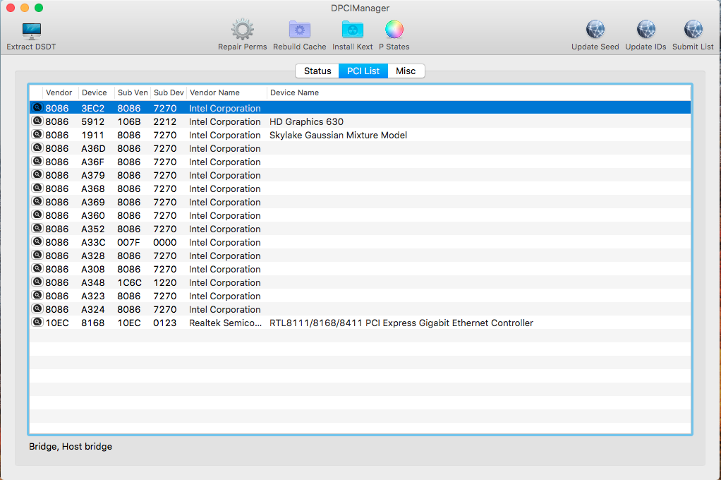

Gymnae Posted May 7, 2018 Share Posted May 7, 2018 22 hours ago, MaLd0n said: CLOVER.zip Dear @MaLd0n, thank you for the assistance. I tried the new clover folder now. The system now thinks it's an iMac Pro - possible you changed the SMBIOS? The internal sound device (ALC887) is gone from the Sound settings Setting it to Sleep turns off screen and USBs peripherals but keeps fans running and dGPU turns on its fans. After rebooting via pressing the reset button, MacOS appears to think it was resumed from sleep I re-extracted ACPI files via F4 with your Clover folder in place and re-ran 'RunMe': https://www15.zippyshare.com/v/m8cMITHn/file.html Link to comment https://www.insanelymac.com/forum/topic/321872-guide-catalina-bigsur-monterey-on-mobos-serie-100-200-300-400-500-600-skylake-kabylake-coffeelake-cometlake-rocketlake-alderlake-dsdt/page/117/#findComment-2612818 Share on other sites More sharing options...
MaLd0n Posted May 7, 2018 Author Share Posted May 7, 2018 27 minutes ago, Gymnae said: Dear @MaLd0n, thank you for the assistance. I tried the new clover folder now. The system now thinks it's an iMac Pro - possible you changed the SMBIOS? The internal sound device (ALC887) is gone from the Sound settings Setting it to Sleep turns off screen and USBs peripherals but keeps fans running and dGPU turns on its fans. After rebooting via pressing the reset button, MacOS appears to think it was resumed from sleep I re-extracted ACPI files via F4 with your Clover folder in place and re-ran 'RunMe': https://www15.zippyshare.com/v/m8cMITHn/file.html u remove applehda? i dont see this kext load disable hibernation disablehibernate.command.zip Link to comment https://www.insanelymac.com/forum/topic/321872-guide-catalina-bigsur-monterey-on-mobos-serie-100-200-300-400-500-600-skylake-kabylake-coffeelake-cometlake-rocketlake-alderlake-dsdt/page/117/#findComment-2612823 Share on other sites More sharing options...
Gymnae Posted May 7, 2018 Share Posted May 7, 2018 (edited) Just now, MaLd0n said: u remove applehda? i dont see this kext load disable hibernation disablehibernate.command.zip Nah, didn't delete any native kext. Sound was working with FakePCIID, following info from rehabman's post: Quote The 300 Series/Coffee Lake HD Audio Controller is currently not supported in released versions of macOS (developer builds, excepted). Symptoms are audio devices present, iTunes not playing and no sound. Fix: Patch the Skylake Audio Controller (0xa170) for 300 series motherboards (0xa348). Supports: H370, H310, Q370 and B360 Series motherboards Z370 Series motherboards, see Quick Fix: 200/Z370/X299/ Series Kaby Lake Audio This fix is temporary; required until macOS/AppleHDA.kext natively supports 300 Series/Coffee Lake audio. EDIT: I ran the nothibernationscript and rebooted, effect for sleep is still the same. Only that it seems I can "wake up" via clicking the mouse - the login screen appears, but no USB peripheral works. The system still didn't sleep properly before waking up to the login screen, though. Reboot works fine now, though. EDIT 2: Attempting a Shutdown via Apple menu leads to a reboot Edited May 7, 2018 by Gymnae Link to comment https://www.insanelymac.com/forum/topic/321872-guide-catalina-bigsur-monterey-on-mobos-serie-100-200-300-400-500-600-skylake-kabylake-coffeelake-cometlake-rocketlake-alderlake-dsdt/page/117/#findComment-2612826 Share on other sites More sharing options...
MaLd0n Posted May 7, 2018 Author Share Posted May 7, 2018 15 minutes ago, Gymnae said: Nah, didn't delete any native kext. Sound was working with FakePCIID, following info from rehabman's post: EDIT: I ran the nothibernationscript and rebooted, effect for sleep is still the same. Only that it seems I can "wake up" via clicking the mouse - the login screen appears, but no USB peripheral works. The system still didn't sleep properly before waking up to the login screen, though. Reboot works fine now, though. ur 3xx mobo have a new ids, the other ids, like my mobo, dont need a "gambiarra" but in x299 i change via dsdt, this mobos x299 have a pc00 instead pci0 after sleep any USB work? Link to comment https://www.insanelymac.com/forum/topic/321872-guide-catalina-bigsur-monterey-on-mobos-serie-100-200-300-400-500-600-skylake-kabylake-coffeelake-cometlake-rocketlake-alderlake-dsdt/page/117/#findComment-2612829 Share on other sites More sharing options...
Gymnae Posted May 7, 2018 Share Posted May 7, 2018 2 minutes ago, MaLd0n said: ur 3xx mobo have a new ids, the other ids, like my mobo, dont need a "gambiarra" but in x299 i change via dsdt, this mobos x299 have a pc00 instead pci0 after sleep any USB work? After sleep, no usb port worked, hence i needed to reset What do you mean with the IDs? What should o adjust? Link to comment https://www.insanelymac.com/forum/topic/321872-guide-catalina-bigsur-monterey-on-mobos-serie-100-200-300-400-500-600-skylake-kabylake-coffeelake-cometlake-rocketlake-alderlake-dsdt/page/117/#findComment-2612830 Share on other sites More sharing options...
MaLd0n Posted May 7, 2018 Author Share Posted May 7, 2018 13 minutes ago, Gymnae said: After sleep, no usb port worked, hence i needed to reset What do you mean with the IDs? What should o adjust? DSDT.aml.zip test it and check if usb work this new mobos have all diff now, need change some patches, injectors, etc send me new files after reboot Link to comment https://www.insanelymac.com/forum/topic/321872-guide-catalina-bigsur-monterey-on-mobos-serie-100-200-300-400-500-600-skylake-kabylake-coffeelake-cometlake-rocketlake-alderlake-dsdt/page/117/#findComment-2612832 Share on other sites More sharing options...
Gymnae Posted May 7, 2018 Share Posted May 7, 2018 (edited) 1 hour ago, MaLd0n said: DSDT.aml.zip test it and check if usb work this new mobos have all diff now, need change some patches, injectors, etc send me new files after reboot Here's the fresh batch: https://www30.zippyshare.com/v/CIq5ihAT/file.html Thank you for your support Tested sleep, same behavior, but now even USB won't fall asleep. Sounds is also still missing (but I guess a DSDT doesn't help there anyway) Edited May 7, 2018 by Gymnae Link to comment https://www.insanelymac.com/forum/topic/321872-guide-catalina-bigsur-monterey-on-mobos-serie-100-200-300-400-500-600-skylake-kabylake-coffeelake-cometlake-rocketlake-alderlake-dsdt/page/117/#findComment-2612838 Share on other sites More sharing options...
visin Posted May 7, 2018 Share Posted May 7, 2018 (edited) 9 hours ago, MaLd0n said: restart is not in DSDT, shutdown yes, _PTS(prepare to sleep) or _GTS(going to sleep) Arquivo Comprimido.zip take a shot, send me new files, if dont work, we need a debug shutdown I load the DSDT and kext that you provide. Restart and shutdown and sleep tests were carried out. The problem remains unsolved: 1, shutdown:CPU Fan operation, USB power, power indicator light. 2, Restart: the state is the same as shutdown. 3, sleep: can't wake up, screen black screen. 4, Audio: do not work, use your DSDT later. I don't know if you can see the log. Maybe I didn't explain it in detail. ----------------------------------------------------------------------------------------------------------------------------------------------------------------------------------------------------------------------------------------------------------------------- The following is the PCI message that does not load DSDT, and Audio works at this time. New run_me.app files https://www71.zippyshare.com/v/qMzt8f1Z/file.html Edited May 7, 2018 by visin Link to comment https://www.insanelymac.com/forum/topic/321872-guide-catalina-bigsur-monterey-on-mobos-serie-100-200-300-400-500-600-skylake-kabylake-coffeelake-cometlake-rocketlake-alderlake-dsdt/page/117/#findComment-2612853 Share on other sites More sharing options...
MaLd0n Posted May 7, 2018 Author Share Posted May 7, 2018 4 hours ago, Gymnae said: Here's the fresh batch: https://www30.zippyshare.com/v/CIq5ihAT/file.html Thank you for your support Tested sleep, same behavior, but now even USB won't fall asleep. Sounds is also still missing (but I guess a DSDT doesn't help there anyway) need check device id with same codec in kabylake or skylake and inject via DSDT, i think work 23 minutes ago, visin said: I load the DSDT and kext that you provide. Restart and shutdown and sleep tests were carried out. The problem remains unsolved: 1, shutdown:CPU Fan operation, USB power, power indicator light. 2, Restart: the state is the same as shutdown. 3, sleep: can't wake up, screen black screen. 4, Audio: do not work, use your DSDT later. I don't know if you can see the log. Maybe I didn't explain it in detail. ----------------------------------------------------------------------------------------------------------------------------------------------------------------------------------------------------------------------------------------------------------------------- The following is the PCI message that does not load DSDT, and Audio works at this time. New run_me.app files https://www71.zippyshare.com/v/qMzt8f1Z/file.html update ur bios and extract untoched files with F4 key Link to comment https://www.insanelymac.com/forum/topic/321872-guide-catalina-bigsur-monterey-on-mobos-serie-100-200-300-400-500-600-skylake-kabylake-coffeelake-cometlake-rocketlake-alderlake-dsdt/page/117/#findComment-2612855 Share on other sites More sharing options...
visin Posted May 8, 2018 Share Posted May 8, 2018 15 minutes ago, MaLd0n said: need check device id with same codec in kabylake or skylake and inject via DSDT, i think work update ur bios and extract untoched files with F4 key The current version of BIOS is the latest. https://www26.zippyshare.com/v/YJ9XF3dK/file.html Link to comment https://www.insanelymac.com/forum/topic/321872-guide-catalina-bigsur-monterey-on-mobos-serie-100-200-300-400-500-600-skylake-kabylake-coffeelake-cometlake-rocketlake-alderlake-dsdt/page/117/#findComment-2612856 Share on other sites More sharing options...
