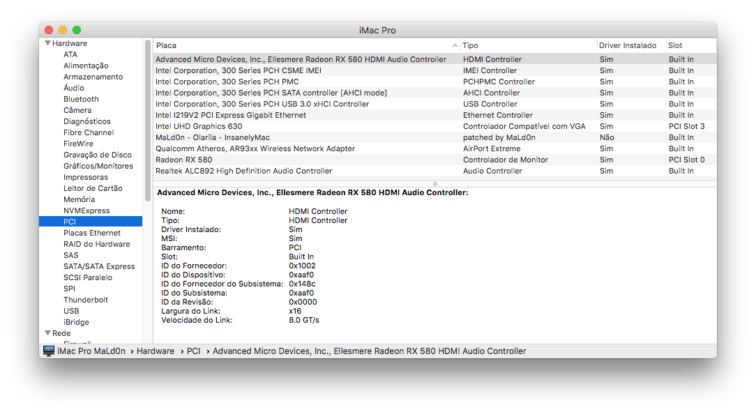

Hi, MaLd0n, I want to add my PCI cards to "PCI" section in System Information.
So I need to add _SUN property.
I found the PCI address, and added the _SUN property.
But I don't know how to make it compilable.
That's what I have right now:
Device (PEG0)
    Name (_ADR, 0x00010000)  // _ADR: Address
    Name(_SUN, ONE)
    Method (_PRT, 0, NotSerialized)  // _PRT: PCI Routing Table
        If (PICM)
            Return (AR01)
        Return (PR01)
    Device (PEGP)
        Name (_ADR, Zero)  // _ADR: Address
What else do I need to do?

for example
Device (PEG0)
                    If (PICM)
                        Return (AR01)
                    Return (PR01)
                Device (PEGP)
                    Name (_SUN, One)  // _SUN: Slot User Number
                Device (HDAU)
                    Name (_ADR, One)  // _ADR: Address
                    Method (_DSM, 4, NotSerialized)  // _DSM: Device-Specific Method
                        If (LEqual (Arg2, Zero))
                            Return (Buffer (One)
                                 0x03
                        Return (Package (0x0A)
                            "AAPL,slot-name",
                            "Built In",
                            "name",
                            "HDMI Controller",
                            "built-in",
                            Buffer (One)
                                 0x00
                            "model",
                            Buffer (0x4C)
                                "Advanced Micro Devices, Inc., Ellesmere Radeon RX 580 HDMI Audio Controller"
                            "device_type",
                            Buffer (0x10)
                                "HDMI Controller"
Device (PEG0)
                    If (PICM)
                        Return (AR01)
                    Return (PR01)
                Device (PEGP)
                Device (HDAU)
                                 0x03
                            "AAPL,slot-name",
                            "Built In",
                            "name",
                            "HDMI Controller",
                            "built-in",
                            Buffer (One)
                                 0x00
                            "model",
                            Buffer (0x4C)
                            "device_type",
                            Buffer (0x10)
                                "HDMI Controller"
How do I make this into a tiny DSDT file?

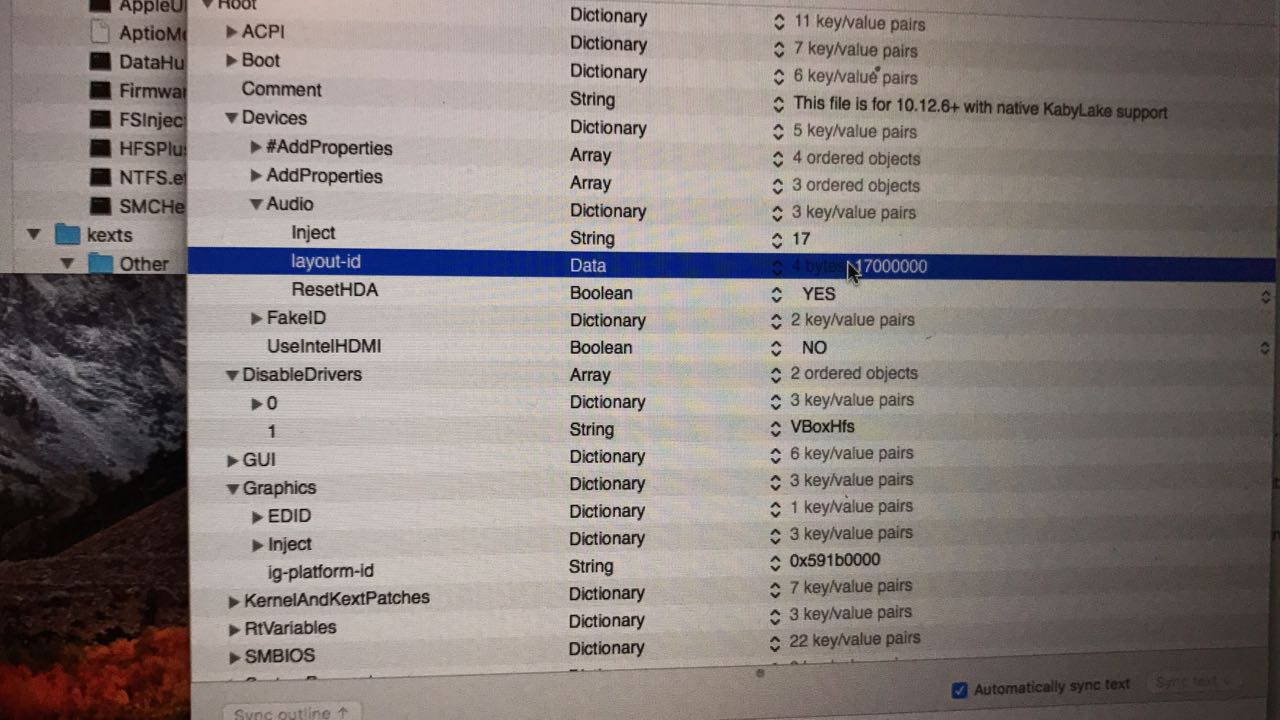

tryin sound layout id via clover configurator.
 do I need turn on add DTGP and fixHDA fixes on acpi clover configurator.
i see the plist editor you are using layout-id data.
the clover using inject string
I use both ? see the picture.
