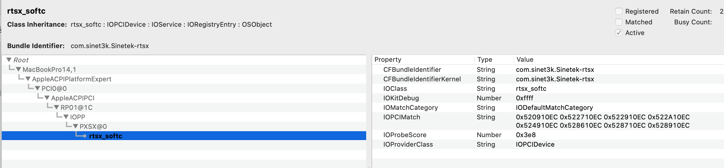

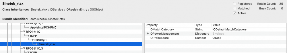

What's strange, is that in the IOREG tree, I see TWO occurrence of rtsx_softc:
Any suggestions ?
What can I do to debug this kext further ?

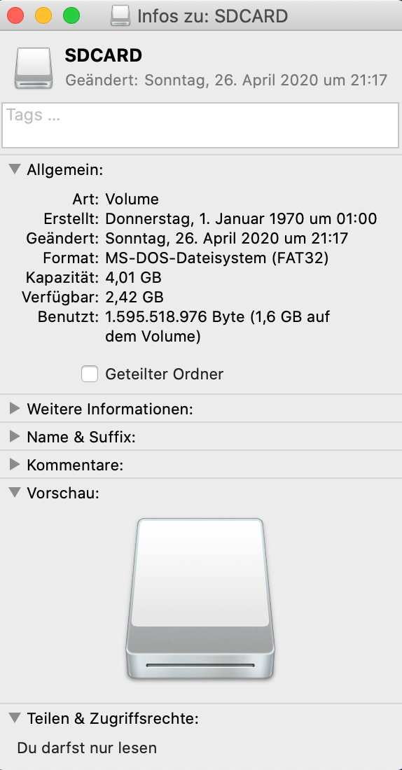

Good evening
Thanks for this kext.
I also see an SDCard on Catalina's desk for the first time.
Unfortunately I only have reading rights.
But in a USB-CardReader the SDCard is writable.
Sorry for my english.
Edited by windowless31
6 hours ago, windowless31 said:
Good evening
Which device? Which kext?

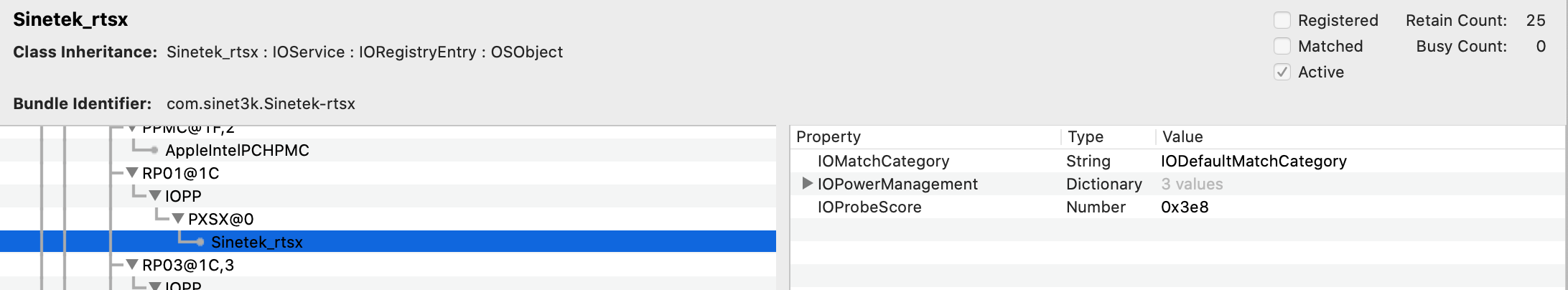

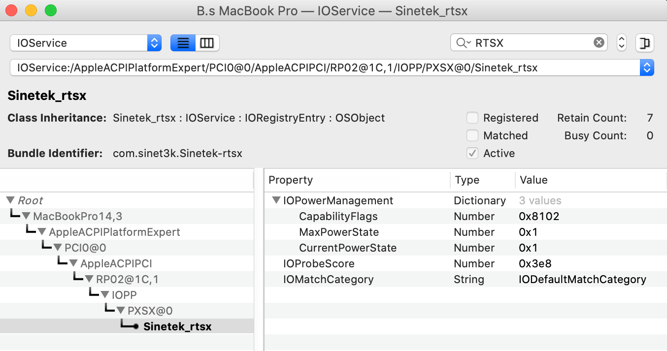

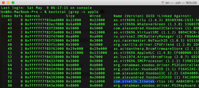

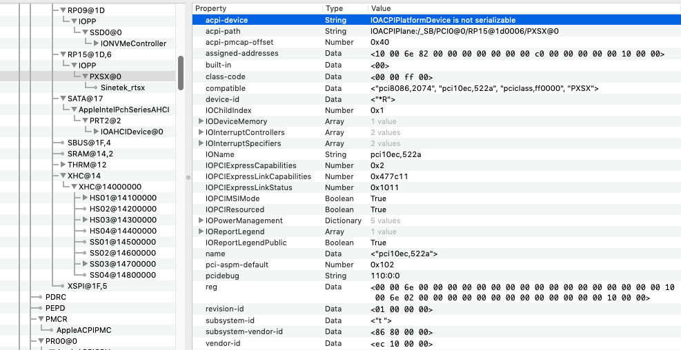

Tried compiling the cholonam version with latest xcode con catalina 10.15.4
Installed on C/K/O, nothing happens, not loading
INstalled on /L/E
Kext loaded.
Logs:
Sinetek_rtsx::probe(PXSX)
(Sinetek-rtsx) <Sinetek-rtsx`Sinetek_rtsx::start(IOService*) (Sinetek_rtsx.cpp:130)> rtsx:    Sinetek_rtsx::start                 : Driver started (version 2.2.0 release build)
Ioreg
With the original sinetek kext:
Kext loaded in L/E.
ioreg
Logs:

Device 522A
Any clue?

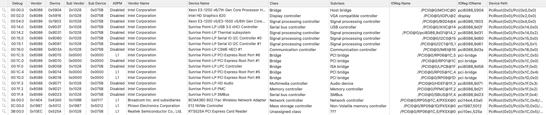

Sorry for the scarce information.
It's the RTS525A PCI Express Card Reader in the Dell XPS15-9560.
macOS-Version is 10.15.4.
The kext is from here and lies in Clover/kexts/Other.
Kext is loaded.
Thanks a lot
Edit: the kext in L/E brings the same result.
It may seem silly, but.. are you sure the read-only switch on the card is not on the LOCK position? Another reason I can think of is that you are passing -rtsx_ro as kernel parameter. The next option would be to try to format the card using DiskUtility just to check that there is nothing weird with the card format itself.
On 5/9/2020 at 8:05 AM, juanjullian said:
2020-05-08 22:36:26.951083-0400  localhost kernel[0]: (Sinetek-rtsx) <Sinetek-rtsx`sdmmc_card_attach(rtsx_softc*)> rtsx: can't enable card
Device 522A
Any clue?
That log is pretty self-explanatory :) Unfortunately my version of the kext only supports RTS525A, which is my chip and the only one I can test. Other chip variants are quite similar and may "kind-of-work", but will not be stable enough for daily use until someone takes on the work of porting the Linux driver which is the one that actually supports a wide range of Realtek chips.
Thanks for the response.
The card switch is not in the LOCK position. :D
As boot-arg I have only given -rtsx_mimic_linux.
I didn't find anything about rtsx... in the system.log.
The card cannot be formatted with the DiskUtility.
Thank you anyway.

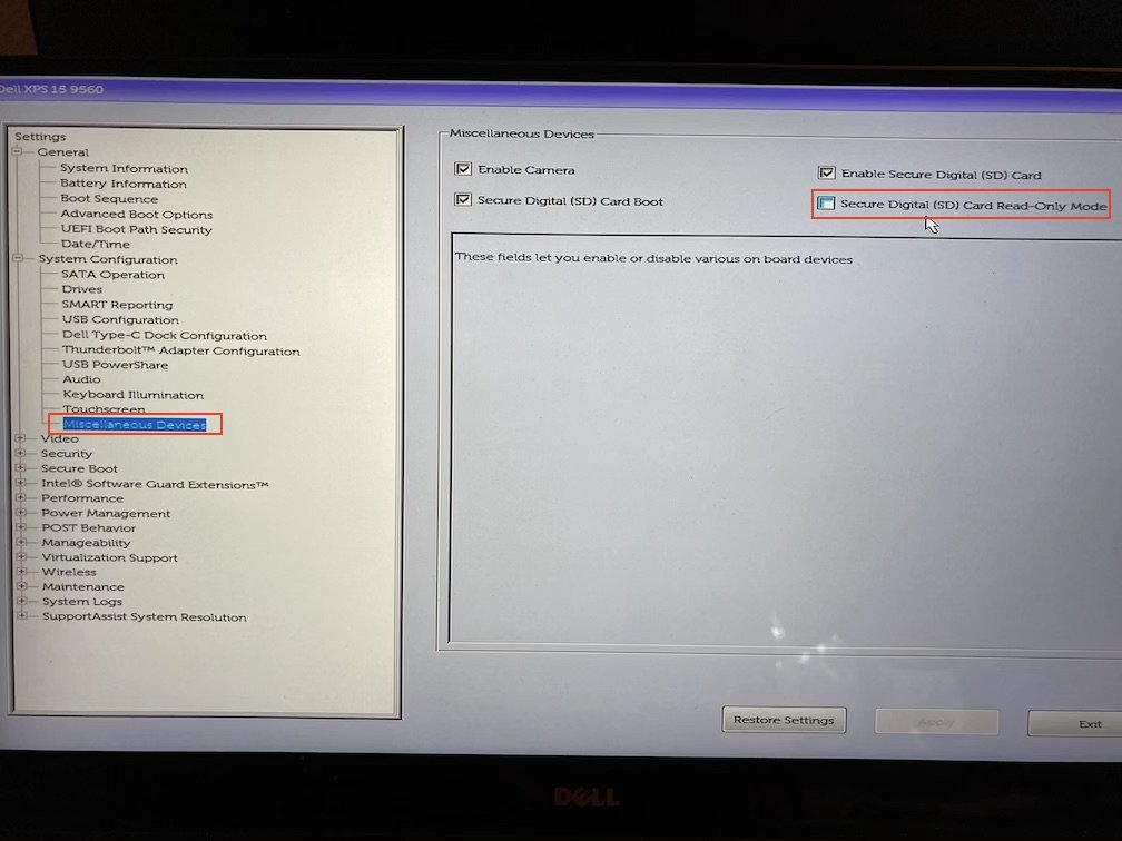

Thank you anyway.
Another possibility is that you have set the SD Card reader as read-only mode in the BIOS. My Dell XPS has that option and when I set it the card will always mount as read-only too. I can't think of anything else, maybe your chip is slightly different from mine (there are several RTS525A too). The debug version of the kext will give more details, if you send me the logs generated by the debug version maybe I can find the problem.

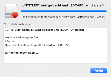

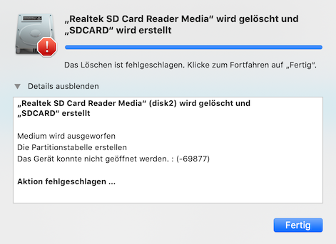

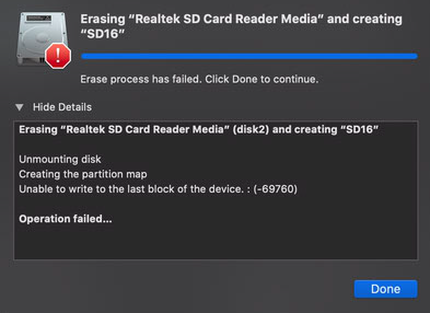

Dear all, I am about to issue a new release of the Sinetek-kext, but I would like to get some feedback first. This new release should be much softer on CPU and memory usage. It will use the MSI interrupt instead of the shared INTx, and most importantly, it will make use of ADMA. Using ADMA allows to request non-contiguous DMA memory, which makes allocation faster and more likely to succeed (since we no longer need a large contiguous block of physical memory in the lower 4GB area).
Now, I would like to ask you for some feedback on a couple of issues I have received from users (particularly #10 and #11):
  1. Issue #10 (I/O error while formatting card, by @bavariancake): The problem is actually that the user is getting IO errors when performing large transfers of data (dd of the whole card). I have not been able to reproduce this problem and I think it's due to the fact that release 2.2 was requesting blocks of contiguous DMA memory because ADMA was not supported. If the lower memory becomes fragmented, the system may start to give IO errors. This problem should be solved by release 2.3. I would like to know if anyone has been experiencing this problem too, and if so, whether it's solved or not by release 2.3. This may happen more often in systems with lower memory (8 GB of ram or less).
  2. Issue #11 (Breaks wake from sleep occasionally, by @bozma88): The user is getting random wakes and also panics on wake and he believes it's due to this kext. I decided to disable sleep on my system because of disk corruption issues, so I won't be able to test/fix this issue. I would like to know if anyone is having this same issue. Or putting another way, is anyone using this kext having a stable sleep/wake up?
More than release 2.2 (which now is history), I'm interested on the results from the new release, particularly for issue #10 (PM code has not changed, so issue #11 will probably not be solved, unless it was an problem with INTx).
Please find attached the beta version of the new release and test it as thoroughly as you can. I'm looking forward to your comments :)
Sinetek-rtsx-2.3-beta.zip

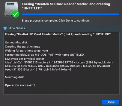

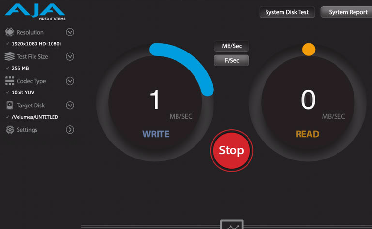

first attempt 235176940_ScreenShot2020-06-18at09_27_26.png.e7f4124ff51d4f9cd6960ff6d0815731.png
second attempt 1753712830_ScreenShot2020-06-18at09_30_20.png.fd106311a9efb7fcb698a7ec7114cdf7.png
for speed, i cant help my self to wait writing to finish

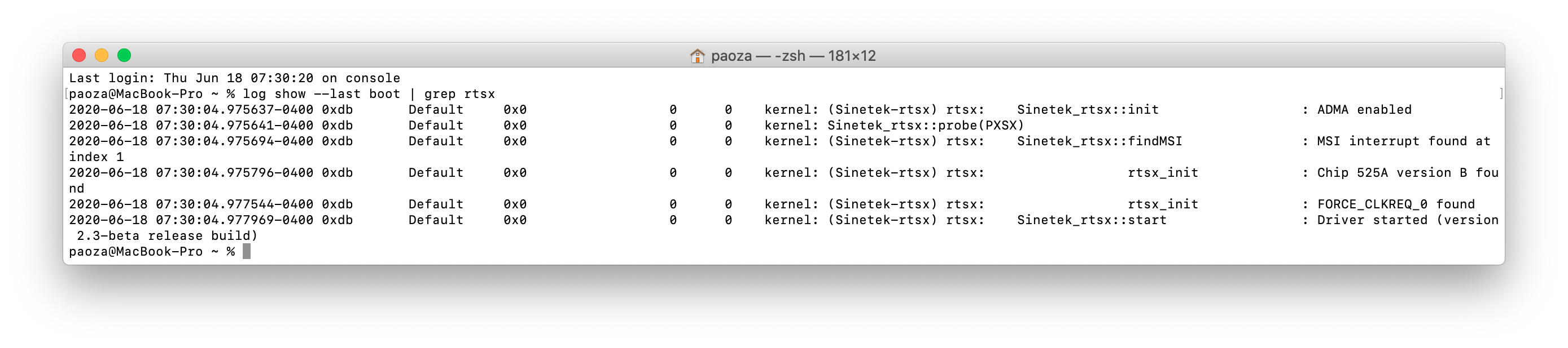

2020-06-18 09:21:59.270367+0700  localhost kernel[0]: Sinetek_rtsx::probe(PXSX)
2020-06-18 09:21:59.271409+0700  localhost kernel[0]: (Sinetek-rtsx) rtsx:               rtsx_init             : FORCE_CLKREQ_0 found
2020-06-18 09:21:59.271508+0700  localhost kernel[0]: (Sinetek-rtsx) rtsx: Sinetek_rtsx::start                 : Driver started (version 2.2.0 release build)
2020-06-18 09:25:05.246096+0700  localhost kernel[0]: (Sinetek-rtsx) rtsx: Sinetek_rtsx::init                  : ADMA enabled
2020-06-18 09:25:05.246103+0700  localhost kernel[0]: Sinetek_rtsx::probe(PXSX)
as for sleep, i never encounter problem related to sleep before with the previous release
Thank you for the feedback @Regi Yassin. From your logs, I see you have chip RTS525A vesion A, while mine is version B. I did move the initialization linux does for version A too, so I should work just as well. For some reason you are getting an IO error when reading sector 0, and after that, all you get basically are timeout errors for many (probably all) commands. This is probably because the OpenBSD driver hasn't done error recovery from the timeout error properly and the chip is just not responding. For the second try, did you reboot the system or just eject/reinsert the card?
About the speed, little can be done apart from porting the whole Linux driver or wait until the OpenBSD driver is fully implemented.

1 hour ago, bozma88 said:
I will try your new release and report back. I still think it's something related to ASPM, as the card reader is reported to have L1 ASPM enabled (despite not showing any kind of power saving during idle).
Hello @bozma88, thanks for the feedback. Do you know that ASPM is enabled just from the log message, or from some other source? I would have to review the code because at this point some initialization regarding ASPM is being done from the Linux initialization code, but it's only initialized. Probably not fully functional. If it's causing trouble, I think the best would be to remove any initialization to it.
PS: SSD corruption is not an issue anymore since long time [...]
I'll send you a PM regarding this not to mix topics on this thread :)
See attached image from IOReg from Hackintool.
Meanwhile, testing the 2.3 beta and will report back in a few days about sleep behaviour.

146    0 0xffffff7f8363b000 0x30000    0x30000    com.sinet3k.Sinetek-rtsx (5) 6F5BE4E9-94C3-34AE-91C8-FEE1F9477DAB <32 13 8 6 5 3 1>
IORegistryExplorer: Device found and driver attached as expected. The only thing I am not getting is the card-reader icon on the top-menu bar, is this normal? Is anybody else getting that icon in Mojave?
