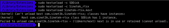

carlinyos Posted April 15, 2020 Share Posted April 15, 2020 @cholonamTried your ku script, but I'm still getting the same error: sudo kextunload -c Sinetek-rtsx sudo kextunload Sinetek-rtsx.kext (kernel) Can't unload kext com.sinet3k.Sinetek-rtsx; classes have instances: (kernel) Kext com.sinet3k.Sinetek-rtsx class SDDisk has 1 instance. Failed to unload com.sinet3k.Sinetek-rtsx - (libkern/kext) kext is in use or retained (cannot unload). Link to comment https://www.insanelymac.com/forum/topic/321080-sineteks-driver-for-realtek-rtsx-sdhc-card-readers/page/12/#findComment-2717611 Share on other sites More sharing options...
cholonam Posted April 16, 2020 Share Posted April 16, 2020 7 hours ago, carlinyos said: @cholonamTried your ku script, but I'm still getting the same error: sudo kextunload -c Sinetek-rtsx sudo kextunload Sinetek-rtsx.kext (kernel) Can't unload kext com.sinet3k.Sinetek-rtsx; classes have instances: (kernel) Kext com.sinet3k.Sinetek-rtsx class SDDisk has 1 instance. Failed to unload com.sinet3k.Sinetek-rtsx - (libkern/kext) kext is in use or retained (cannot unload). First, the class name is Sinetek_rtsx, not Sinetek-rtsx. Second, since it's telling you the SDDisk has 1 instance (did you eject the disk?), you can try unloading that class too: sudo kextunload -c SDDisk sudo kextunload -c Sinetek_rtsx [ <-- note the underscore here ] sudo kextunload Sinetek-rtsx.kext [ to use this, the kext has to be in the test directory (copy it with ./c or ./kl) ] Link to comment https://www.insanelymac.com/forum/topic/321080-sineteks-driver-for-realtek-rtsx-sdhc-card-readers/page/12/#findComment-2717641 Share on other sites More sharing options...
carlinyos Posted April 16, 2020 Share Posted April 16, 2020 15 hours ago, cholonam said: First, the class name is Sinetek_rtsx, not Sinetek-rtsx. Second, since it's telling you the SDDisk has 1 instance (did you eject the disk?), you can try unloading that class too: sudo kextunload -c SDDisk sudo kextunload -c Sinetek_rtsx [ <-- note the underscore here ] sudo kextunload Sinetek-rtsx.kext [ to use this, the kext has to be in the test directory (copy it with ./c or ./kl) ] I'm trying to unload it without ejecting the disk. Not sure if that would be possible Also, following your steps (and having ejected the disk). Link to comment https://www.insanelymac.com/forum/topic/321080-sineteks-driver-for-realtek-rtsx-sdhc-card-readers/page/12/#findComment-2717723 Share on other sites More sharing options...
cholonam Posted April 17, 2020 Share Posted April 17, 2020 9 hours ago, carlinyos said: I'm trying to unload it without ejecting the disk. Not sure if that would be possible Also, following your steps (and having ejected the disk). In my case (latest Catalina), I can unload the kext even with the card inserted and attached, just unloading the Sinetek_rtsx class before. In fact, if I unload SDDisk before Sinetek_rtsx, I get a kernel panic when unloading Sinetek_rtsx. No doubt more debugging is needed to get this kext stable enough for production.. Link to comment https://www.insanelymac.com/forum/topic/321080-sineteks-driver-for-realtek-rtsx-sdhc-card-readers/page/12/#findComment-2717766 Share on other sites More sharing options...

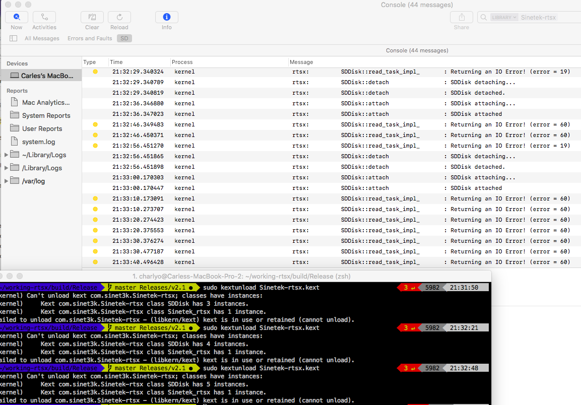

cholonam Posted April 19, 2020 Share Posted April 19, 2020 4 hours ago, carlinyos said: Dear @cholonam Having build your latest version (v2.1) from source in master and taking a look a the counter that the "kext unload" command provides (having slept the laptop), it seems that an instance a new SDDisk class is created after each attach / eject cycle. Not sure if that's the intended behaviour of the kext or not! Let me know! best! That's interesting.. My understanding is an SDDisk should be created on attach and destroyed on detach, but it seems you have found some leak. I'll try to check the code again if I get some spare time. Thanks for the testing! Link to comment https://www.insanelymac.com/forum/topic/321080-sineteks-driver-for-realtek-rtsx-sdhc-card-readers/page/12/#findComment-2718322 Share on other sites More sharing options...

cholonam Posted April 20, 2020 Share Posted April 20, 2020 8 hours ago, carlinyos said: I'm not able to load your built kexts in High Sierra. I always build them based on the release tag. I'll remove that call, since the thread name is not used anyway. Also, regarding the multiple instances you are getting, are you using IOJones or IORegistryExplorer or similar? I can only reproduce that problem if one of those apps is open. Link to comment https://www.insanelymac.com/forum/topic/321080-sineteks-driver-for-realtek-rtsx-sdhc-card-readers/page/12/#findComment-2718360 Share on other sites More sharing options...
carlinyos Posted April 20, 2020 Share Posted April 20, 2020 9 hours ago, cholonam said: I'll remove that call, since the thread name is not used anyway. Also, regarding the multiple instances you are getting, are you using IOJones or IORegistryExplorer or similar? I can only reproduce that problem if one of those apps is open. No, I have no apps opened during the testing. I updated to 10.15.4 and the issue still persists. Link to comment https://www.insanelymac.com/forum/topic/321080-sineteks-driver-for-realtek-rtsx-sdhc-card-readers/page/12/#findComment-2718436 Share on other sites More sharing options...
cholonam Posted April 20, 2020 Share Posted April 20, 2020 5 hours ago, Hervé said: One other thing I've noticed is the poor performance provided by the driver. Here's a sample of several Black Magic read/write tests I made with several cards. No matter the card, access hardly reaches 5MB/s. Better than nothing but very very poor. Here is the results with a Class10 16GB SanDisk Ultra microSDHC advertised up to 100MB/s. In Windows, the card returns a near 90/20 MB/s Read/Write performance: Similar tests on my Latitude E6230 Hackintosh with the same card in an SD adapter gives this: Other standard 2GB microSD cards I had lying around (from old cell phones) give the same 5MB/s test results. So, performance is somehow capped by the driver which could obviously benefit from further tuning on that front. Nevertheless, it works and that's the main thing for me. Performance may improve after enabling ADMA, which is disabled now because it needs some changes in the compatibility layer. I won't be implementing it now because of lack of time, sorry. Also regarding the card being not accessible before sleep. Since you are booting from it, I suspect your BIOS (or whatever system you are using to boot from it) is initializing the reader, but the driver code (from OpenBSD) assumes the reader starts in an uninitialized state. After sleep/wake up, since the reader is turned off, then on, then initialized, it works (could you update tue github issue to mention the fact that you boot from the card? I think that's important). Link to comment https://www.insanelymac.com/forum/topic/321080-sineteks-driver-for-realtek-rtsx-sdhc-card-readers/page/12/#findComment-2718467 Share on other sites More sharing options...
cholonam Posted April 20, 2020 Share Posted April 20, 2020 2 hours ago, carlinyos said: No, I have no apps opened during the testing. I updated to 10.15.4 and the issue still persists. That's weird.. without IOreg or IORE I never get any leak and SDDisk is always freed on detach. In the SDDisk class there are some commented-out functions (taggedRetain/taggedRelease) that may help you debug the problem, but I'm afraid fixing that is not going to be easy. Basically, something (we don't know yet what) is retaining SDDisk and not releasing it. In my case it's IOreg/IORE. In your case it must be something your setup has and mine does not. Link to comment https://www.insanelymac.com/forum/topic/321080-sineteks-driver-for-realtek-rtsx-sdhc-card-readers/page/12/#findComment-2718468 Share on other sites More sharing options...
