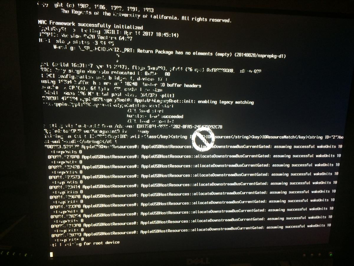

Matthww Posted May 20, 2017 Share Posted May 20, 2017 Hello, I have a OptiPlex 755 with an E8500 and a Nvdia 9300M. If I want to boot macOS I get a big stop sign in the middle of my screen. I tried to several USB's that worked with booting other OS's but still no luck. Edit:in verbose it gives me an AppleUSBHostResources::allocateDownstreamBusCurrentGated: assuming successful wakeUnits... Link to comment Share on other sites More sharing options...
Guest ricoc90 Posted May 20, 2017 Share Posted May 20, 2017 Hello, I have a OptiPlex 755 with an E8500 and a Nvdia 9300M. If I want to boot macOS I get a big stop sign in the middle of my screen. I tried to several USB's that worked with booting other OS's but still no luck. Edit: in verbose it gives me an AppleUSBHostResources::allocateDownstreamBusCurrentGated: assuming successful wakeUnits... That is not a problem, it's just a notice and won't prevent your system from booting (I get the same message on my NEC and my Optiplex, both are booting fine). Are you booting the OS itself, or are you trying to install it? I'd suggest you record the whole booting process on video, since I guess that message keeps spamming which makes it hard to see anything else. Also, 9300M is a mobile GPU chip for laptops, right? Link to comment Share on other sites More sharing options...

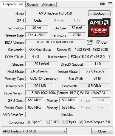

MacPeet Posted May 20, 2017 Author Share Posted May 20, 2017 @family1232009 post#1 read? SMBIOS iMac10,1 for Sierra? @for all A small report: @BerliMan has a 780 SFF and a newer XFX HD5450 As you can see even a UEFI-GPU bios. This worked not with and also not without the Vanilla patch. And now? He made downgrade with my GPU-ROM (older XFX one HD5450) with: atiflash 4.17 under DOS flashed atiflash -p -f 0 xxxx.rom Now the HD5450 works without problems! !!! The latest bios versions do not work, no matter which manufacturer !!! 3 Link to comment Share on other sites More sharing options...
Matthww Posted May 20, 2017 Share Posted May 20, 2017 That is not a problem, it's just a notice and won't prevent your system from booting (I get the same message on my NEC and my Optiplex, both are booting fine). Are you booting the OS itself, or are you trying to install it? I'd suggest you record the whole booting process on video, since I guess that message keeps spamming which makes it hard to see anything else. Also, 9300M is a mobile GPU chip for laptops, right? I'm trying to install Sierra but I'm not able to boot into the installer also it's an Nvidia Geforce 9300 GE Also here is the boot video: https://youtu.be/QPKBwrkHPD4 (Needed to upload it to youtube because it was 40Mb) Link to comment Share on other sites More sharing options...
polyzargone Posted May 20, 2017 Share Posted May 20, 2017 I'm trying to install Sierra but I'm not able to boot into the installer also it's an Nvidia Geforce 9300 GE You need the set of kexts 10.12.zip provided in #1 and especially the USB_Injector.kext You'll also need DSDT.aml_755_for_other_graphics_cards.zip in CLOVER/ACPI/patched and set Inject NVidia instead of Inject ATI in config.plist Link to comment Share on other sites More sharing options...
Matthww Posted May 20, 2017 Share Posted May 20, 2017 You need the set of kexts 10.12.zip provided in #1 and especially the USB_Injector.kext You'll also need DSDT.aml_755_for_other_graphics_cards.zip in CLOVER/ACPI/patched and set Inject NVidia instead of Inject ATI in config.plist Still getting the same error, I also uploaded my config, and the files you said to use. configs macos.zip Link to comment Share on other sites More sharing options...
polyzargone Posted May 20, 2017 Share Posted May 20, 2017 Have you tried every USB ports ? Link to comment Share on other sites More sharing options...
MaLd0n Posted May 20, 2017 Share Posted May 20, 2017 Still getting the same error, I also uploaded my config, and the files you said to use. check fakesmc Link to comment Share on other sites More sharing options...
Matthww Posted May 21, 2017 Share Posted May 21, 2017 Edit: it's installing at the moment Link to comment Share on other sites More sharing options...
MacPeet Posted May 21, 2017 Author Share Posted May 21, 2017 try this: config.plist.zip Link to comment Share on other sites More sharing options...
Matthww Posted May 21, 2017 Share Posted May 21, 2017 (edited) try this: config.plist.zip Already got it working! What did you change exactly? Also my sound is not working I used the .kext provided in post #1 for Optiplex 755 EDIT: Seems like macOS really hates many ports the back headphone jack doesn't work. But the one in the front does work. Edited May 21, 2017 by Matthww Link to comment Share on other sites More sharing options...
