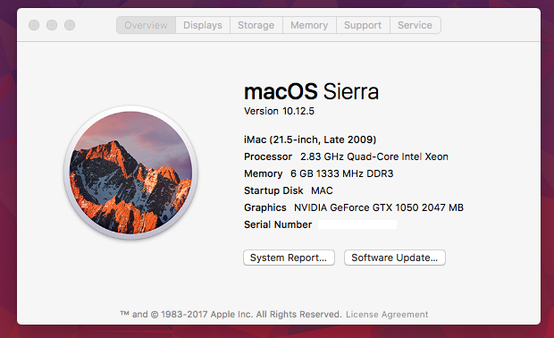

mno1984 Posted May 17, 2017 Share Posted May 17, 2017 GT 710 sleep after updating to 10.12.4. Change Imac 14,1 to 10,1 Change graphic card to GTX 1050.using web driver and CUDA in Optiplex 780 Update to 10.12.5 without problem. Night Shift work flawlessly.. Link to comment Share on other sites More sharing options...
