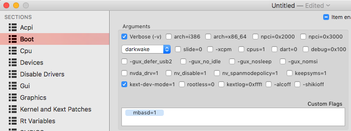

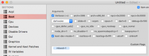

Any ideas if the standard fix for enabling a superdrive will mess up this system. Editing the plist? I've done it before on an older system, I'm nervous to try on this one.
I just installed the TP-Link TL-WN851ND into my system as well. Works great!
USB Superdrive works with .plist edit.
Instructions for all users for plist edit?
If you want to use a usb superdrive with Sierra it will not function when plugged in. Here is the fix.
Open a terminal. At the prompt type    sudo nano /Library/Preferences/SystemConfiguration/com.apple.Boot.plist
You will need to make your plist match this. Basically add "mbasd=1"
<!DOCTYPE plist PUBLIC "-//Apple//DTD PLIST 1.0//EN" "http://www.apple.com/DTDs$
<plist version="1.0">
<dict>
        <key>Kernel Flags</key>
        <string>mbasd=1</string>
</dict>
</plist>
After editing press "control X" to exit, press "Y" for Yes, then press enter. Reboot
The reason I chose to run the superdrive is because I run 2 SSD Drives and a Hot swap drive tray in the DVD slot.
This system runs Windows/Linux/OSX and can swap in and out drives for Storage.
Hope this helps.
