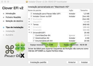

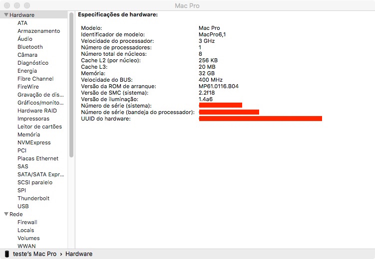

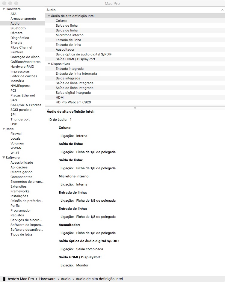

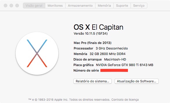

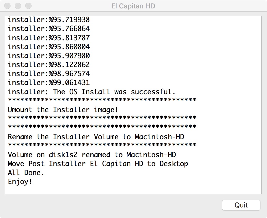

augustopaulo Posted May 28, 2016 Share Posted May 28, 2016 (edited) Hello everyone, I bring you today an easy installation of the latest El Capitan (10.11.5) with the CPU 5960X (16 cores) installed on ASUS X99 Deluxe U3.1 motherboard with a Nvidia GTX 908 Ti !! (Versão em Português aqui) Once installed, the following features are 100% operational: 1 x Ethernet adapter + Wlan @ 5Ghz adapter All USB3.0 ports available Nvidia 980ti working with 3 monitors and sound AppleHDA + functional HDMI CPU energy management operation from 1.2Ghz to 4.5GHz Bluetooth, AirDrop, Facetime, iMessage all workin and much faster than in 10.10.5 (Yosemite) !! Without NullCPUPowerManagement.kext the VoodooTSCSync.kext the IOPCIFamily.kext (modified) and without a modified kernel - The case of Yosemite in 5960X ... Requirements: "Install OS X El Capitan.app" downloaded and installed in the Applications folder Get the app "El Capitan HD.zip" here Access to a Mac/Hackintosh already with El Capitan installed and with SIP turned off, as described here An EMPTY SSD/hard disk on SATA/USB - If not empty, the "El Capitan HD" will format it completely !! Access to the Serial Number, ROM and MLB on a real mac Thanks: Brumbaer, stinga11, chris1111, the Clover team, onmybikedrunk, jamiethemorris, pokenguyen and many, many more ... Installation: 1 - Download the file "Comprimido.zip", which contains the Kexts, tools and EFI folder already pre-configured here and decompress on your downloads folder of your Mac/Hackintosh. Then configure the BIOS 3101 of the ASUS X99 Deluxe as per the screen snapshots stored here. 2 - Run the application "El Capitan HD.app" to install the basic configuration of El Capitan into an EMPTY SSD/hard disk: 2.1 - Enter your password at about 4% 2.2 - Wait for the end, such as: 3 - Use the "Clover Configurator.app" application to mount the EFI partition. 3.1 - "Mount EFI" 3.2 - "Check Partition" 3.3 - Search by type identifier "/dev/diskX" disk that contains the partition "Macintosh-HD" 3.4 - "Mount EFI partition/diskXs1" 4 - Install the latest CLOVER v2.3: 4.1 - Run CLOVER v2.3 application and install it on to the disk "Macintosh HD," with the following options: 4.2 - Use the "Finder" file manager to copy the files: 4.2.1 - <ZIP directory>/EFI/CLOVER/ACPI/*.* to the folder EFICLOVER/ACPI/ 4.2.2 - <ZIP directory>/EFI/CLOVER/config.plist to the folder EFI/CLOVER/ 4.2.3 - <ZIP directory>/EFI/CLOVER/kexts/10.11/FakeSMC.kext to the folder EFI/CLOVER/kexts/10.11/ 4.2.4 - <ZIP directory>/EFI/CLOVER/drivers64UEFI/OsxAptioFix2Drv-free2000.efi to the folder /EFI/CLOVER/drivers64UEFI/ 5 - Use the application "KCPM Pro.app Utility" to install the Kexts onto the "Macintosh HD" disk and then repair its file permissions and rebuild the kext Caches: AppleGraphicsControl.kext (changed already to SMBIOS 6.1) AppleIntelE1000e.kext BrcmFirmwareRepo.kext BrcmPatchRAM2.kext FakeSMC.kext X99_Injector.kext 6 - Start the PC with the new 10.11.5 installed, by selecting UEFI OS (P1:xxxxxx) 6.1 - In CLOVER boot menu, select "Boot Mac OS X from Macintost-HD" 6.2 - Setup the country and don't setup yet your AppleID 6.3 - Setup a new user 6.4 - Login and then run the application "Kext utility.app" and wait for the end of its operations: 6.5 Drag and drop the "LegacyUSBHub.kext" (for USB3.0) and "AppleHDA.kext" (changed to ALC1150) onto the window of "Kext utility" and wait for it to end its operations: 6.6 - Re-start the PC 9 - Install Nvidia Driver Web - http: //us.download.n...46.03.10f02.pkg 9.1 - Install the Nvidia CUDA - http: //www.nvidia.co....29-driver.html 9.2 - Re-start the PC 10 - To configure iMessage/FaceTime its necessary to extract various data from a real Mac: 10.1 - Check that the Ethernet network card is set to "en0" by running the "DPCIManager.app" application: 10.2 - Re-do step 3 again to mount the EFI partition 10.3 - Navigate to and follow the steps to extract (from a true Mac) the following data: Serial Number, SmUUID and Board Serial Number - used for "Clover Configurator.app" application in the "SMBIOS" section ROM & MLB identifier - used for "Clover Configurator.app" application in the "Rt Variables" section (Using the "iMessageDebug" in a terminal window) 10.4 - Re-start the PC Boa sorte, Paulo End results: Tests: Information sources: iCloud / iMessage / FaceTime - http: //www.insanelym...h/#entry2020598 http: //www.insanelym...ative-work-thru http: //www.insanelym...-capitan-10113/ http: //www.insanelym...-hotspot-patch/ http: //www.insanelym...hda-hdmi-audio/ http: //www.insanelym...da-audio/page-1 http: //www.insanelym...edstep-working/ https: //sourceforge..../Snow_or_Above/ https://nickwoodhams.com/x99-hackintosh-solving-osxaptiofixdrv-allocaterelocblock-can-not-allocate-relocation-block/ Edited May 29, 2016 by augustopaulo 7 Link to comment https://www.insanelymac.com/forum/topic/312373-easy-installation-of-el-capitan-10115-in-5960x-cpu/ Share on other sites More sharing options...

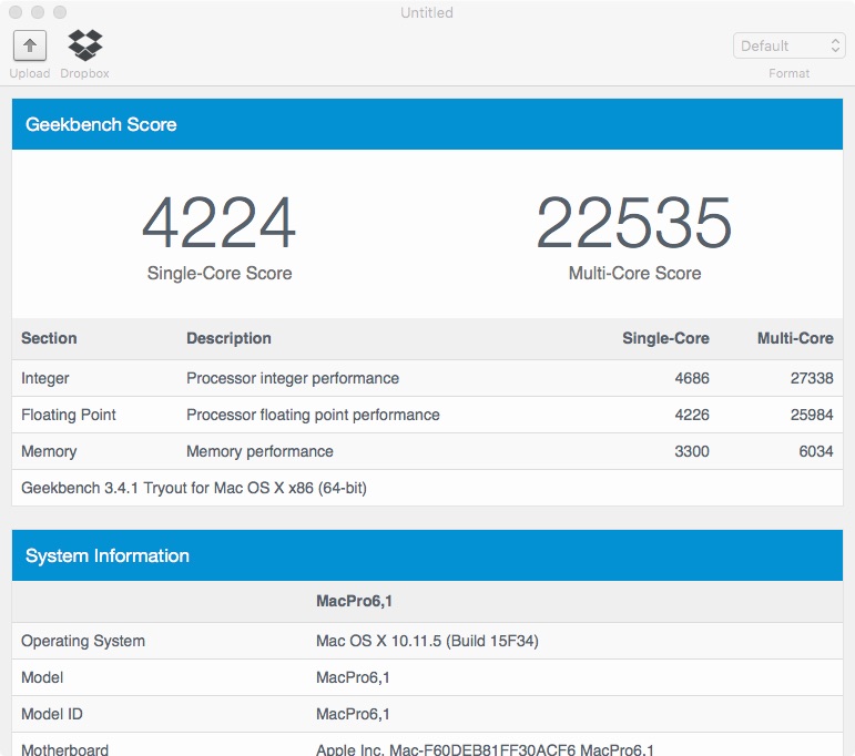

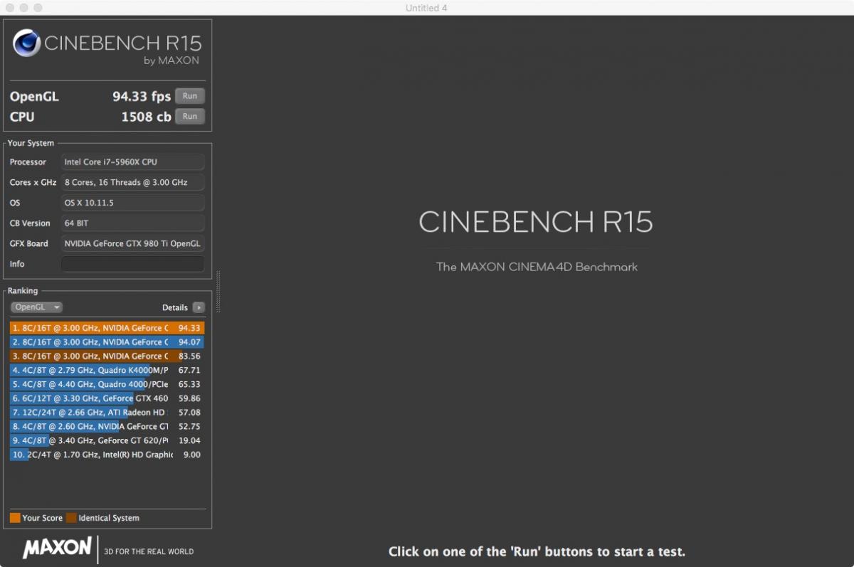

MMido Posted May 28, 2016 Share Posted May 28, 2016 THANK YOU VERY MUCH FOR YOUR EFFORT. One more Thing I just wondering about the clock of the CPU. I mean in your previous install on Yosemite the score was on Geekbench Almost 32000 you didn't overclock the system ?? Why its decreased that much ???? Link to comment https://www.insanelymac.com/forum/topic/312373-easy-installation-of-el-capitan-10115-in-5960x-cpu/#findComment-2240857 Share on other sites More sharing options...

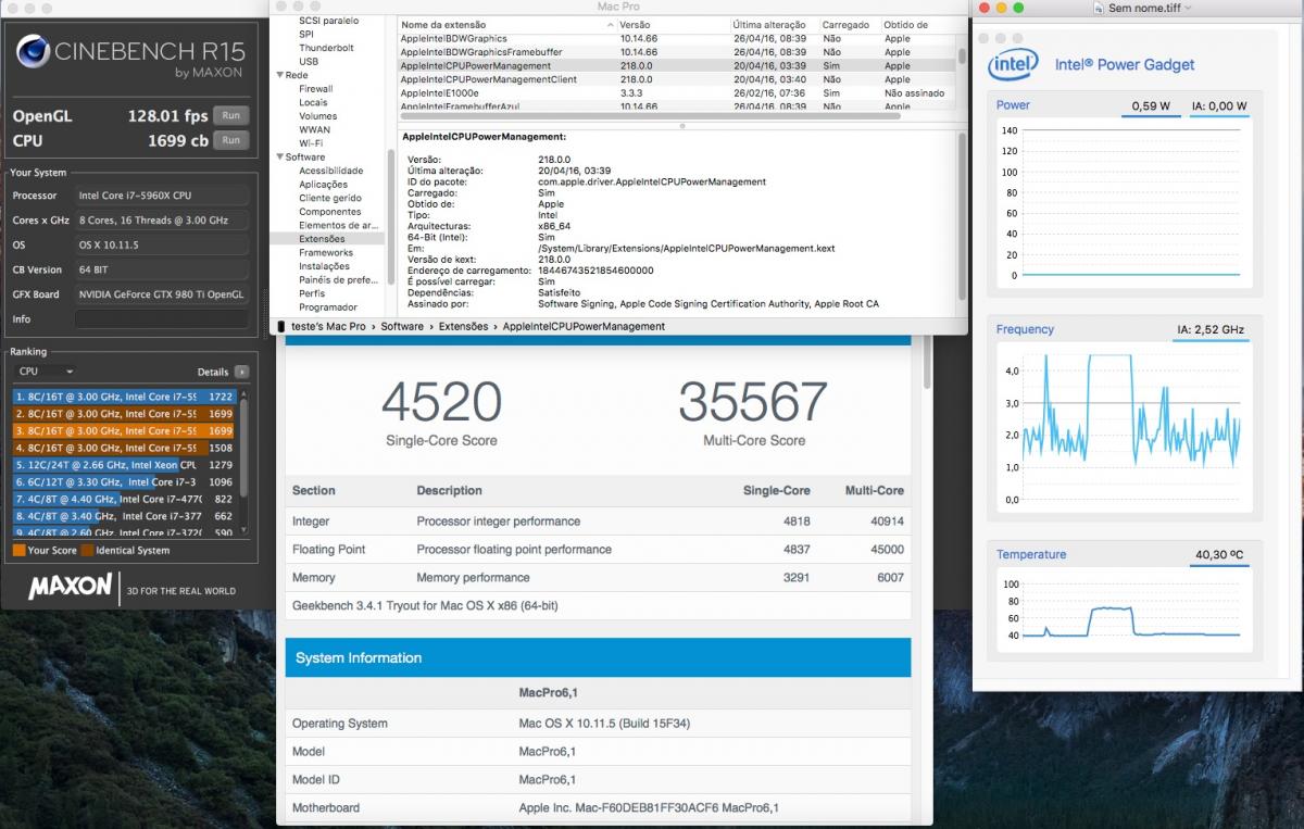

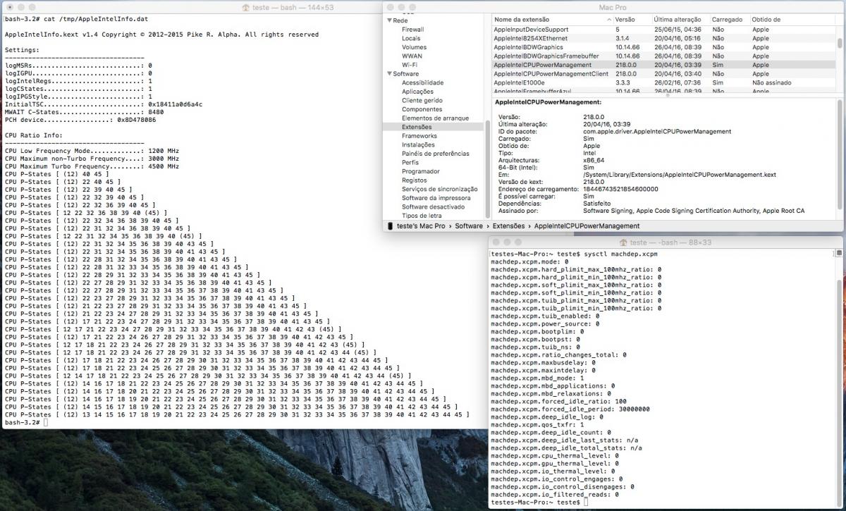

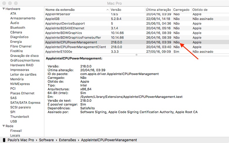

nmano Posted May 29, 2016 Share Posted May 29, 2016 Thank you so much x99 nice guide. augustopaulo Top. Can you confirm AppleIntelCPUPowerManagement.kext loaded or not? Link to comment https://www.insanelymac.com/forum/topic/312373-easy-installation-of-el-capitan-10115-in-5960x-cpu/#findComment-2240906 Share on other sites More sharing options...

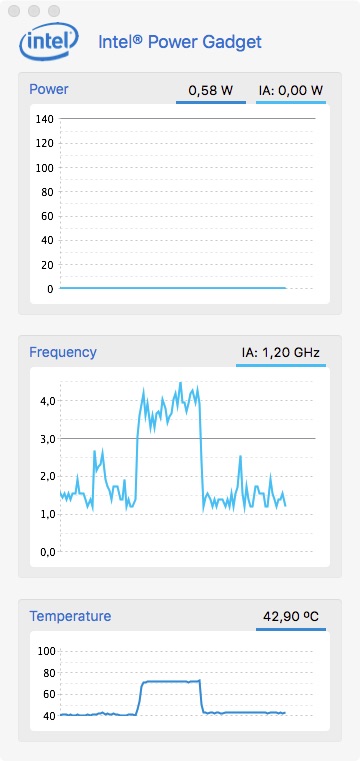

nmano Posted May 29, 2016 Share Posted May 29, 2016 Hi MMido, My hack is always overclocked to 4.5Ghz - want to get out the most "juice" from this monster On Yosemite, I hasn't using the "-xcpm" power management clover flag and AppleIntelCPUPowerManagement.kext was being loaded, not the the case now... Sem nome.jpg This is my first attempt with El Capitan (10.1.5) on this hack, so I'm currently looking at other methods and experimenting a lot of BIOS/power management settings to try get close, or even improve, on my best performance scores achieved so far. Feel free to contribute and I'll add it to the main post. It still need to improve a lot things: Improve power management Getting second ethernet to work Airdrop works, but not as fast as on my Mac or iphone Add proper CPU description in "About my Mac" section Add all PCI boards in the PCI section of System Info Try to get all my motherboards Fans (& other info) properly detected in HWMonitor more... Boa sorte, Paulo Hi nmano, Answered on previous post. Boa sorte, Paulo If You Try this with out XCPM with nullcpupowermanagement.kext KernelAndKextPatches FakeCPUID=0x0306E4 Its worked for me. Link to comment https://www.insanelymac.com/forum/topic/312373-easy-installation-of-el-capitan-10115-in-5960x-cpu/#findComment-2240976 Share on other sites More sharing options...

augustopaulo Posted May 29, 2016 Author Share Posted May 29, 2016 If You Try this with out XCPM with nullcpupowermanagement.kext KernelAndKextPatches FakeCPUID=0x0306E4 Its worked for me. Hi nmano, Great, great advice, thank you!! My CPU scores have jumped high, have a look below: AppleCPUPowerManagement.kext is loaded and all CPUs flatline at 4.5Ghz under full load! I'll keep trying a bit more on BIOS settings... Boa sorte, Paulo Hey, i followed your instructions but my "PC" didn't start the Setup. I added -v to the bootflags and got only "++++++++++++++++++++++++++++++++++++++++" and then everything stucks. Got a i7 5820k and an ASUS X99-A/U3.1 Mainboard. The BIOS Settings are quite the same as yours, except this overclocking. Any ideas why it won't work for me? Hi eSportler, I think the fact that you've got a different CPU is of great impact! Unfortunately, I don't have one 5820k to try... Try to remove the SSDT.aml from "EFI/CLOVER/ACPI/patched", since this has been generated specifically for a 5960X... Boa sorte, Paulo 2 Link to comment https://www.insanelymac.com/forum/topic/312373-easy-installation-of-el-capitan-10115-in-5960x-cpu/#findComment-2241028 Share on other sites More sharing options...
jamiethemorris Posted May 29, 2016 Share Posted May 29, 2016 Hi nmano, Great, great advice, thank you!! My CPU scores have jumped high, have a look below: Sem nome 2.jpg AppleCPUPowerManagement.kext is loaded and all CPUs flatline at 4.5Ghz under full load! I'll keep trying a bit more on BIOS settings... Boa sorte, Paulo Hi eSportler, I think the fact that you've got a different CPU is of great impact! Unfortunately, I don't have one 5820k to try... Try to remove the SSDT.aml from "EFI/CLOVER/ACPI/patched", since this has been generated specifically for a 5960X... Boa sorte, Paulo Wait, you're saying aicpm is loaded even though you're using nullcpu? I'm pretty sure you can get the same performance with xcpm but you have to modify x86platformplugin or make an injector kext for it. I don't know the details but I saw some discussion of it in the 5820k/5930k installation thread. Link to comment https://www.insanelymac.com/forum/topic/312373-easy-installation-of-el-capitan-10115-in-5960x-cpu/#findComment-2241036 Share on other sites More sharing options...
nmano Posted May 29, 2016 Share Posted May 29, 2016 Hi nmano, Great, great advice, thank you!! My CPU scores have jumped high, have a look below: Sem nome 2.jpg AppleCPUPowerManagement.kext is loaded and all CPUs flatline at 4.5Ghz under full load! Enjoy Link to comment https://www.insanelymac.com/forum/topic/312373-easy-installation-of-el-capitan-10115-in-5960x-cpu/#findComment-2241062 Share on other sites More sharing options...

augustopaulo Posted May 30, 2016 Author Share Posted May 30, 2016 Wait, you're saying aicpm is loaded even though you're using nullcpu? I'm pretty sure you can get the same performance with xcpm but you have to modify x86platformplugin or make an injector kext for it. I don't know the details but I saw some discussion of it in the 5820k/5930k installation thread. Hi jamiethemorris, Yes, aicpm is getting loaded (and generating p-states from 12 to 45) and xcpm is not active, see below: I'm just worried that I haven't got any c-states... Boa sorte, Paulo 2 Link to comment https://www.insanelymac.com/forum/topic/312373-easy-installation-of-el-capitan-10115-in-5960x-cpu/#findComment-2241240 Share on other sites More sharing options...

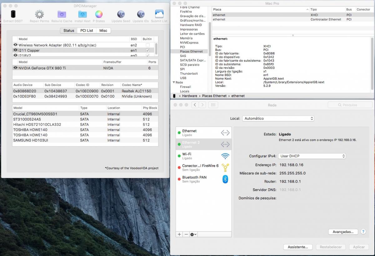

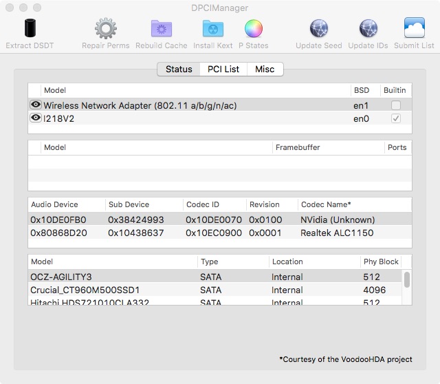

augustopaulo Posted May 30, 2016 Author Share Posted May 30, 2016 Hi all, Another small success Just managed to get the AppleIGB.kext (2nd ethernet card that wasn't working) loading by inserting its IOPCIMatch string/ID=0x12428086 (taken from DPCIManager), into the Info.plist inside the "Contents" folder of this kext, see below: Now, all Asus X99 Deluxe network devices work: Wlan (en2), Ethernet (en0) & Ethernet 2 (en1) Also, as mentioned in above post, the Power Management scores have increase significantly with the help of nmano and by selecting new BIOS settings I was able to lower the average temperature by 5 degrees centigrate, so I'll update the main post in the near future. Boa sorte, Paulo 1 Link to comment https://www.insanelymac.com/forum/topic/312373-easy-installation-of-el-capitan-10115-in-5960x-cpu/#findComment-2241278 Share on other sites More sharing options...
Brumbaer Posted May 31, 2016 Share Posted May 31, 2016 Wait, you're saying aicpm is loaded even though you're using nullcpu? I'm pretty sure you can get the same performance with xcpm but you have to modify x86platformplugin or make an injector kext for it. I don't know the details but I saw some discussion of it in the 5820k/5930k installation thread. @jamiethemorris NullCPUPowerManagement does not prevent aicpm from loading - is in fact only loaded, if aicpm is loaded first -, but changes the "hooks" so aicpm doesn't do anything. On the same note AppleIntelInfo prints the contents of the P-state tables only, most likely it does not know whether they are used. So both printouts show only what is loaded, not what's in use. 1 Link to comment https://www.insanelymac.com/forum/topic/312373-easy-installation-of-el-capitan-10115-in-5960x-cpu/#findComment-2241393 Share on other sites More sharing options...
augustopaulo Posted June 1, 2016 Author Share Posted June 1, 2016 @jamiethemorris NullCPUPowerManagement does not prevent aicpm from loading - is in fact only loaded, if aicpm is loaded first -, but changes the "hooks" so aicpm doesn't do anything. On the same note AppleIntelInfo prints the contents of the P-state tables only, most likely it does not know whether they are used. So both printouts show only what is loaded, not what's in use. Hi Brumbaer, First of all, let me take this opportunity to give you a BIG THANKYOU for your fantastic work in getting the IOPCIFamily.kext to correctly load the 5960x CPU - Myself (& a few thousand more) were getting desperate to get El Capitan running on our rigs!! Secondly, if I understood correctly your statements regarding the CPU power management, even though AICPM is loaded, its actually the NullCPUPowerManagement who is in charge of "apparently" controlling the CPU throttling, right ? So my question is: how can we know effectively which one is controlling (not just loading) the CPU power/sleep states (which tools/methods)? Because, yesterday I did a small Cinebench/Geekbench comparison test with Windows10 64bits (same BIOS settings) and the Intel Power Gadget showed the CPU with only 2 frequencies: 1.2Ghz & 4.5Ghz... This brought me back to the discussion I saw on this thread, where doubts were raised regarding if AppleIntelInfo.kext was actually print our the states without knowing of its use... Boa sorte, Paulo Link to comment https://www.insanelymac.com/forum/topic/312373-easy-installation-of-el-capitan-10115-in-5960x-cpu/#findComment-2241583 Share on other sites More sharing options...
Brumbaer Posted June 1, 2016 Share Posted June 1, 2016 Before Skylake P-States have been exclusively handled by the OS . This means there is some program running that watches CPU usage and sets P-States accordingly. But there is no official on/off switch etc. We know some "programs" tasked with setting P-States and what tables they use, so if they are running we conclude that P-States are used. If xcpm is running, than we conclude that P-States are used. If aicpm is running, we conclude P-States are used. If aicpm or xcpm are running, we assume they use the ACPI P-State tables. There are other symptoms for active P-States If the Frequency in Intel Power Gadget varies, we conclude P-States are working. But these conclusions do not have to be right. I.e. if NullCPUPowerManagement is loaded aicpm will not "work" despite the fact that aicpm got loaded. Frequency variation in IPG can result from C-States or Turbo State, and averaged over cores look like P-State effects. AppleIntelInfo.kext is a debugging tool. It has been written to control the values of certain tables. So it outputs those tables (probably just the ACPI P-State tables) whether they are used or not, and if what they are used for it neither knows nor cares. If you really want to know whether P-States are active, you would continuously have to watch the P-State related MSRs for changes. Link to comment https://www.insanelymac.com/forum/topic/312373-easy-installation-of-el-capitan-10115-in-5960x-cpu/#findComment-2241605 Share on other sites More sharing options...
