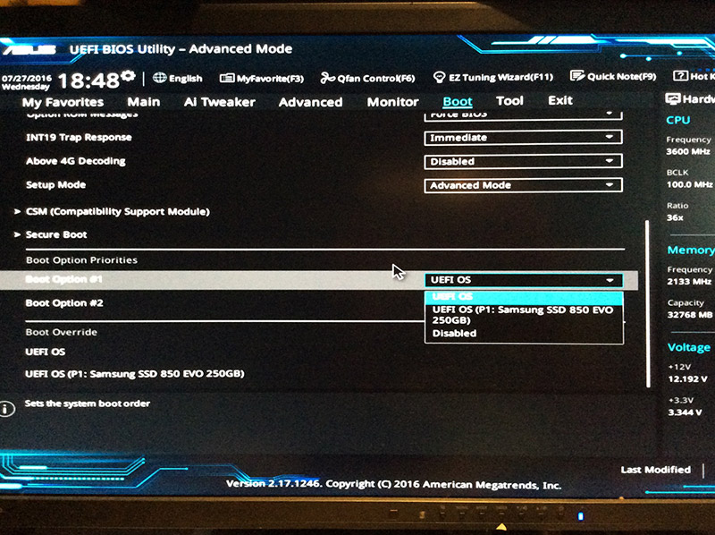

thenightflyer Posted August 1, 2016 Share Posted August 1, 2016 @jamiethemorris it's something related to AppleIntelCPUPowerManagement... maybe windows changes something in bios settings. Did you install AI Suite in windows? Did you check the correct ssd/hd boot sequence in Boot menu? PS a new bios for X99 Deluxe 3.1 has been released, versione 3301 Link to comment Share on other sites More sharing options...
jamiethemorris Posted August 1, 2016 Share Posted August 1, 2016 @jamiethemorris it's something related to AppleIntelCPUPowerManagement... maybe windows changes something in bios settings. Did you install AI Suite in windows? Did you check the correct ssd/hd boot sequence in Boot menu? PS a new bios for X99 Deluxe 3.1 has been released, versione 3301 I'll check the boot sequence tommorrow. What would I be looking for exactly? I know the primary boot drive has never changed as it has always booted into Clover as expected. None of this ever happened before when I was on Yosemite, I'm wondering if Windows is writing something to the UEFI's NVRAM that El Capitan in particular doesn't like. I have an EVGA board so I don't use AI Suite. Link to comment Share on other sites More sharing options...
Brumbaer Posted August 1, 2016 Share Posted August 1, 2016 If the cold boot works, it will not be the nvram, which contents survives a cold boot. On my system on a restart from OS X the power supply will be switched off automatically, in fact performing a cold boot. A restart from Windows 10 doesn't do that. If it is the same with your system, I assume that some registers are not reset, which OS X expects to be in their "initial" state. I'd try to tell your system (BIOS and Windows) to not fast boot. Hopefully forcing Windows to do a proper restart. Link to comment Share on other sites More sharing options...
jamiethemorris Posted August 1, 2016 Share Posted August 1, 2016 If the cold boot works, it will not be the nvram, which contents survives a cold boot. On my system on a restart from OS X the power supply will be switched off automatically, in fact performing a cold boot. A restart from Windows 10 doesn't do that. If it is the same with your system, I assume that some registers are not reset, which OS X expects to be in their "initial" state. I'd try to tell your system (BIOS and Windows) to not fast boot. Hopefully forcing Windows to do a proper restart. i just checked and I don't have a fast boot option in Windows, unless they moved the option for it recently . I'm pretty sure I disabled the hibernation file so that's probably why. Fast boot was already disabled in the BIOS, when I had that enabled it would get stuck on boot when the aptiofix driver loads. I don't know if this is relevant at all, but I have probably a total of 8 or 9 internal drives which is abnormal for most setups - not sure if that has anything to do with it or not. Link to comment Share on other sites More sharing options...
thenightflyer Posted August 2, 2016 Share Posted August 2, 2016 i just checked and I don't have a fast boot option in Windows, unless they moved the option for it recently . I'm pretty sure I disabled the hibernation file so that's probably why. Fast boot was already disabled in the BIOS, when I had that enabled it would get stuck on boot when the aptiofix driver loads. I don't know if this is relevant at all, but I have probably a total of 8 or 9 internal drives which is abnormal for most setups - not sure if that has anything to do with it or not. Check in bios the proper hdd boot sequence...set the primary (with osx and clover) as first in Hard Disk BBS Priority menu too. Try this way and let me know Link to comment Share on other sites More sharing options...
jamiethemorris Posted August 2, 2016 Share Posted August 2, 2016 Check in bios the proper hdd boot sequence...set the primary (with osx and clover) as first in Hard Disk BBS Priority menu too. Try this way and let me know thanks, I double checked that and it's set as it should be. I'm going to take a look at the acpi tables tonight and see if I can find anything weird. Link to comment Share on other sites More sharing options...
