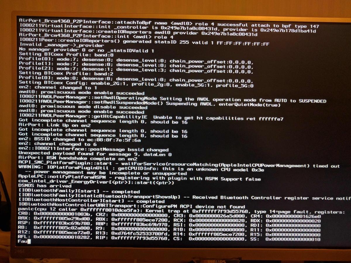

ergot Posted July 10, 2016 Share Posted July 10, 2016 re do all over again -disable SIP from a macbook pro, followed carefully again but it seems that my IOBT kext are causing Kpanic all the time ONLY when removing them I can boot up the system. Is that related to the string that the patch using? perhaps I need different ones...? Link to comment https://www.insanelymac.com/forum/topic/312373-easy-installation-of-el-capitan-10115-in-5960x-cpu/page/4/#findComment-2250432 Share on other sites More sharing options...

ergot Posted July 10, 2016 Share Posted July 10, 2016 Hi augustopaulo, please see attached. followed your task cannot boot with no cache. A little comfort my sleep is working now but no sound when returning from sleep...tried to install CodecCommander.kext (google) with kext utility restart and check...still no sound after sleep. need to use the correct kext (1150 for me) - USB that connected to front will be eject out after sleep...hey google can you give me an answer for this as well? Any other possible fix? Link to comment https://www.insanelymac.com/forum/topic/312373-easy-installation-of-el-capitan-10115-in-5960x-cpu/page/4/#findComment-2250475 Share on other sites More sharing options...

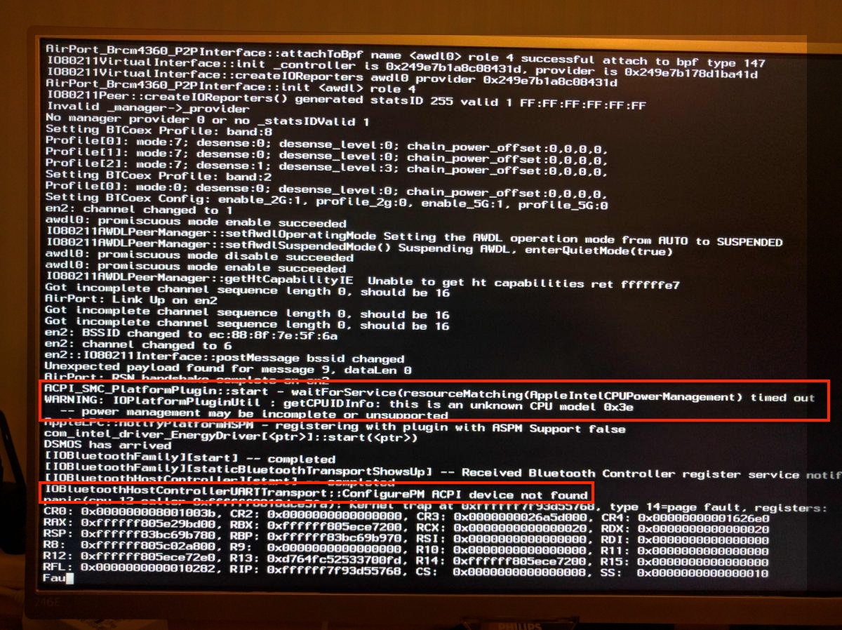

ergot Posted July 11, 2016 Share Posted July 11, 2016 Hi ergot, Your boot picture shows that OSX cannot properly identify your CPU, hence no CPU Power Management is loaded and that makes one of the bluetooth kext crash your system... See your highlighted picture below: No ACPI powerManagement.png Since your CPU is not a 5960X, you may need to google around for a compatible model to put in the FakeCPUID section of Clover config.plist! Try this link to start: https://clover-wiki.zetam.org/Configuration/KernelAndKextPatches#kernelandkextpatches_fakecpuid Boa sorte, Paulo Thanks! nothing helped...i tried many fake ID's also w/out cannot...funny thing it was working before without any problems...have to try some more Link to comment https://www.insanelymac.com/forum/topic/312373-easy-installation-of-el-capitan-10115-in-5960x-cpu/page/4/#findComment-2250814 Share on other sites More sharing options...
