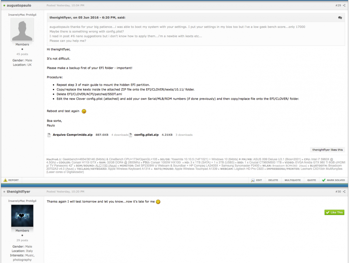

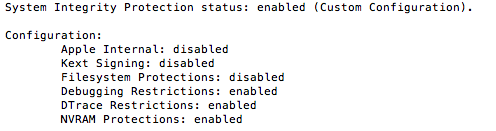

jamiethemorris Posted June 27, 2016 Share Posted June 27, 2016 still in misery. this my boot args: kext-dev-mode=1 rootless=0 -xcpm npci=0x2000 nvda_drv=1 (tried with and without -xcpm) appleintelpowermanagment not loaded (?) in bios settings my boot/secureboot/key managment got all the values on loaded...this means something? how can i clean all the values? is it safe? plz help did you use the fakecpuid? My scores were really low without that. Link to comment https://www.insanelymac.com/forum/topic/312373-easy-installation-of-el-capitan-10115-in-5960x-cpu/page/3/#findComment-2246073 Share on other sites More sharing options...

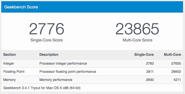

algida Posted June 27, 2016 Share Posted June 27, 2016 did you use the fakecpuid? My scores were really low without that. yes, as advised FakeCPUID=0x0306E4 Link to comment https://www.insanelymac.com/forum/topic/312373-easy-installation-of-el-capitan-10115-in-5960x-cpu/page/3/#findComment-2246076 Share on other sites More sharing options...

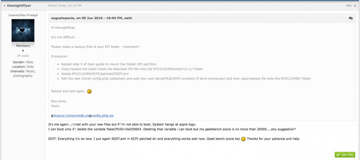

thenightflyer Posted June 27, 2016 Share Posted June 27, 2016 still in misery. this my boot args: kext-dev-mode=1 rootless=0 -xcpm npci=0x2000 nvda_drv=1 (tried with and without -xcpm) appleintelpowermanagment not loaded (?) in bios settings my boot/secureboot/key managment got all the values on loaded...this means something? how can i clean all the values? is it safe? plz help To remove keys go to boot/secure boot/key management and click/press enter on delete pk, delete db etc. Press enter on every voice with delete word. Hi Nightflyer. It's good seeing you over here as well. It would be nice if you can post those files that augustopaulo suggested.... if you even recall the necessary files and procedures. Thanks in advance The guide is complete as posted by augustopaulo...there is nothing else to add. I just added those 3 Kexts in clover, set fakecpuid as suggested by nmano, disabled xcpupm in clover and everything changed to high geekbench value Link to comment https://www.insanelymac.com/forum/topic/312373-easy-installation-of-el-capitan-10115-in-5960x-cpu/page/3/#findComment-2246089 Share on other sites More sharing options...
algida Posted June 27, 2016 Share Posted June 27, 2016 To remove keys go to boot/secure boot/key management and click/press enter on delete pk, delete db etc. Press enter on every voice with delete word. The guide is complete as posted by augustopaulo...there is nothing else to add. I just added those 3 Kexts in clover, set fakecpuid as suggested by nmano, disabled xcpupm in clover and everything changed to high geekbench value nothing to do. still slow. who knows the reason at this point Link to comment https://www.insanelymac.com/forum/topic/312373-easy-installation-of-el-capitan-10115-in-5960x-cpu/page/3/#findComment-2246098 Share on other sites More sharing options...

thenightflyer Posted June 28, 2016 Share Posted June 28, 2016 It's not provided with augustopaulo's files...maybe you mean NullCPUPowerManagement.kext, it's available in zip file Link to comment https://www.insanelymac.com/forum/topic/312373-easy-installation-of-el-capitan-10115-in-5960x-cpu/page/3/#findComment-2246197 Share on other sites More sharing options...
Saijohn Posted June 28, 2016 Share Posted June 28, 2016 I use same augustopaulo's bios settings, same config.plist (except i removed DDR4 infos) and kexts. Try putting AppleIntelCPUPowerManagement in clover ef kexts dir and check again...i repeat i had the same problem and after augustopaulo's post where he suggested me to use those files (unfortunately the message was deleted by fourm's fault of 2 weeks ago!) i was able to have an high score on geekbench. Not sure, I just saw you mention it in one of your posts. that's why I was asking. Anyways, thanks for all the help and will report back if there's any issues. Cheers. 1 Link to comment https://www.insanelymac.com/forum/topic/312373-easy-installation-of-el-capitan-10115-in-5960x-cpu/page/3/#findComment-2246205 Share on other sites More sharing options...
algida Posted June 28, 2016 Share Posted June 28, 2016 Do you have SSDT.aml in EFI\CLOVER\ACPI\patched dir? Try with my config.plist attached here and let me know did it. and it works!!! you are the man. thanx 1000 1 Link to comment https://www.insanelymac.com/forum/topic/312373-easy-installation-of-el-capitan-10115-in-5960x-cpu/page/3/#findComment-2246220 Share on other sites More sharing options...

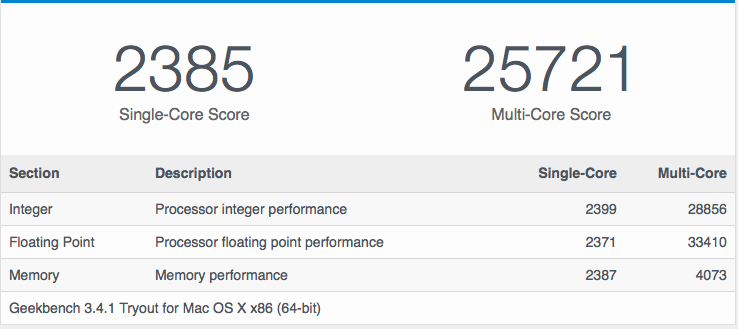

ergot Posted June 29, 2016 Share Posted June 29, 2016 (edited) Hello, I did another method installation (installing on SSD from my rMBP) after some troubleshooting my GPU is working, nvme SSD working but not bootable (?) CPU working however have low score for 32bit around 20,000, WIFI looks working OK need more testing , BT recognized but cannot find any device (searching circle), USB 3 not working (ASMedia), any chance for USB 3.1? I am writing here because another member advised me to install fakecpuid and nullcpu kexts however I cannot find them for X99 can someone please zip them and share it with me? As for the BT and USB3 I will use your kexts to try out. Thanks! One more thing: No sleep (only black screen) restart and shutdown someway look slow to me... I deleted from S/L/E stock BT drivers IOXXXX something for BT that cause my system to stuck on PCI configuration is that recommended ? Also my RAM banks show only 2 when I have 4 banks... Edited June 29, 2016 by ergot Link to comment https://www.insanelymac.com/forum/topic/312373-easy-installation-of-el-capitan-10115-in-5960x-cpu/page/3/#findComment-2246406 Share on other sites More sharing options...

thenightflyer Posted June 29, 2016 Share Posted June 29, 2016 I want to correct one thing: fakecpuid now I understand what it is, what is the number for xeon CPU? should I use the same as I7 or according to this site: https://software.intel.com/en-us/articles/intel-architecture-and-processor-identification-with-cpuid-model-and-family-numbers IOCPUNumber depends how many cores have your cpu, so for example: 16 core = 31 12 core = 23 8 core = 15 6 core = 11 4 core = 7 Set it editing VoodooTSCSync info.plist and set it according to your cpu model, in your case a xeon. 3 Link to comment https://www.insanelymac.com/forum/topic/312373-easy-installation-of-el-capitan-10115-in-5960x-cpu/page/3/#findComment-2246449 Share on other sites More sharing options...

augustopaulo Posted July 2, 2016 Author Share Posted July 2, 2016 Hi Everyone, Apologies Been away from this thread, but now I'm back and will try to answer/help in all posts First things first, let me try to recover some of the posts that were lost when Insanelymac crashed (a few weeks back): For "Sem nome 6.png" files mentioned, I've recreated them and are attached below: Arquivo Comprimido.zipconfig.plist.zip Boa sorte, Paulo 1 Link to comment https://www.insanelymac.com/forum/topic/312373-easy-installation-of-el-capitan-10115-in-5960x-cpu/page/3/#findComment-2247178 Share on other sites More sharing options...

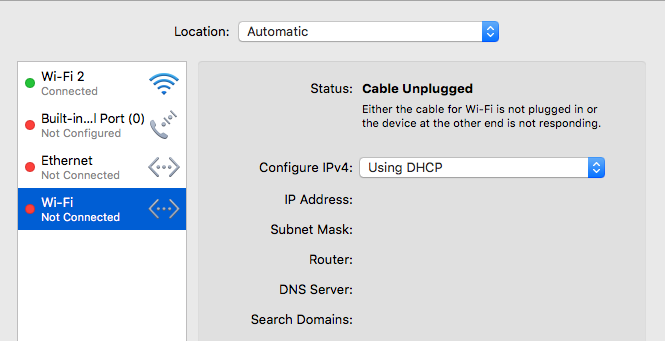

ergot Posted July 9, 2016 Share Posted July 9, 2016 Hi Augustopaulo thank you for this nice guide! i am having some issues after following your guide - At the beginning BT was working, however after few restarts i am having boot problem and it getting stuck in IOBLXXXXX messages, when removing the 2 BT kexts (apple kexts) i can boot the hack... WIFI is working however under network pref i see 2 WIFI and one ethernet...should be 2 ethernet and 1 WIFI...minor issue for now Speed test - multi core on 64bit is around 23000 which i think is too low - what idid: remove DSDT (probably set for your CPU) adding Nullcpu and VoodooTSCSync changing number to 23 (my CPU have 12 cores) nothing helps. Sleep - well...after bed time story it go to sleep but wake up right away. USB 3 - we have similar MB I am guessing the same controller (maybe not the same amount of ports) is not seems to work...work as USB 2 update for USB - connecting external USB shows correct speed... (am i right?) Can you please help me to figure out where is my problem? Which file do you need from my hack? By the way, is that OK? Gain some more score.... ADD FakeCPUID to plist, remove P states... Anything else to tweak? Link to comment https://www.insanelymac.com/forum/topic/312373-easy-installation-of-el-capitan-10115-in-5960x-cpu/page/3/#findComment-2249674 Share on other sites More sharing options...
