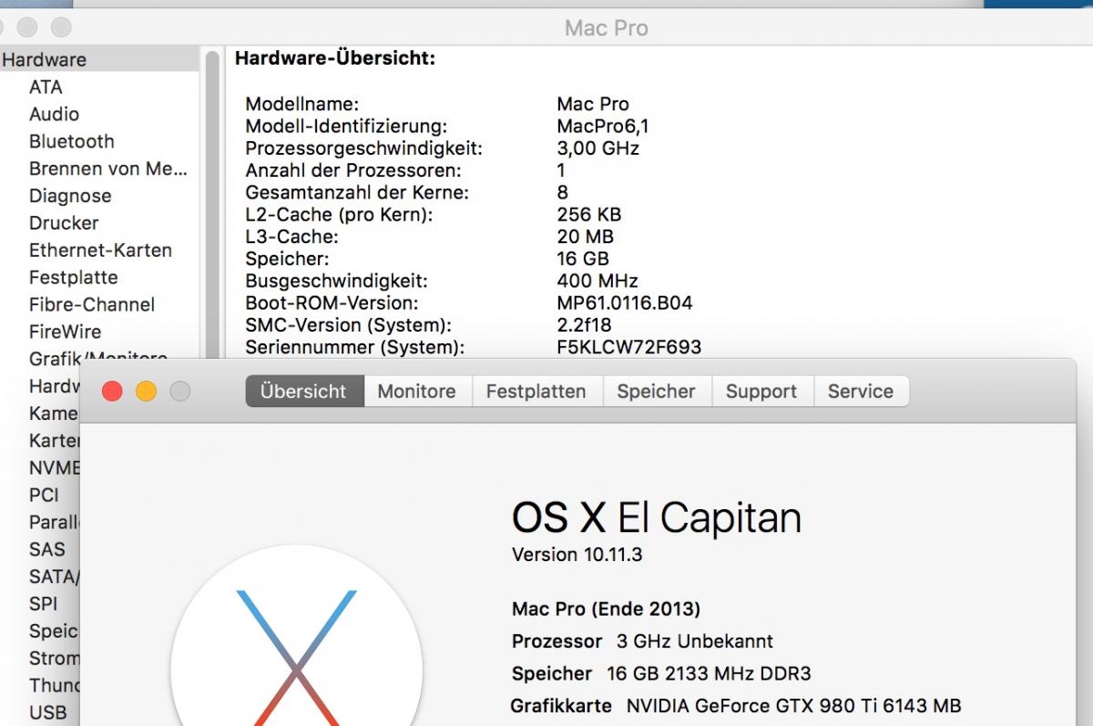

5960x successfully installed under El Capitan 10.11.3
138 posts in this topic
Brumbaer
Good job.
More like 5 or 6 users  :)
It's the 10.11.2 Kext from Apples Open Source Website.

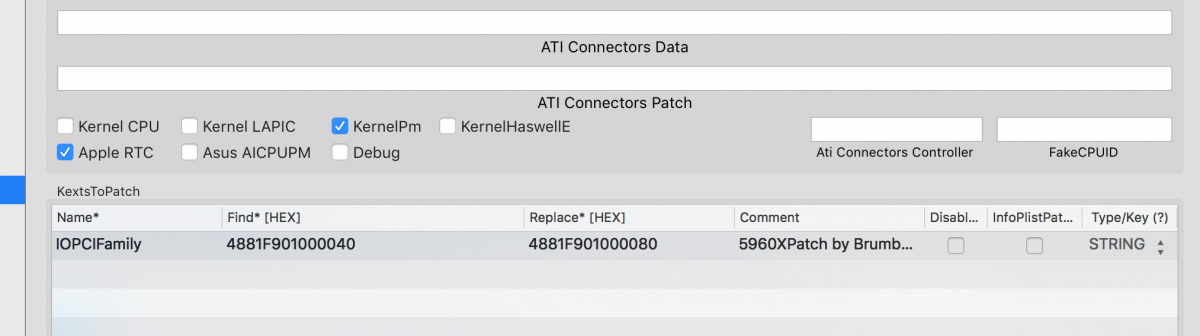

Instead of replacing the kext, you can use the patch as described in the first post.
As so often with patches, I can't anticipate, how long it will stay valid.
I give some info what the patch/kext change does  later.

About the Kext
When configuring the IOPCIFamily kext enumerates the PCI Devices and creates an array of memory ranges for each device.
This is done by iterating over the BaseAdressRegisters of each device and determining start-address and size of the area represented by the BAR.
If the size exceeds MAX_BAR_SIZE it tries again and again, seemingly interpreting the result as a "not ready" or "busy".
MAX_BAR_SIZE is set to 1GB. The 5960x has a device (Power Control Device) with a BAR reporting a larger size. The size is read from the chip not from any ACPI table.
The Kext increases MAX_BAR_SIZE to 32 GB, which is larger than the size reported.
The device 2fc08086 is a power control chip used by the i7 Haswell-E,  E5v3 and E7v3. So it should solve the "PCI configuration begin hang" for those as well.
Might be interesting to check what that BAR points to. If the value indeed marks an "not ready" or "busy", the Kext might not be needed, when the device would be configured correctly.
About the Patch
The Patch basically sets MAX_BAR_SIZE to 2GB, which wouldn't be enough, but because of the command used the value is sign extended which results in a larger value.
In theory that might cause a problem with some board in which case you will have to fall back to the modified kext. There might also be the possibility to replace the command, but I haven't checked that, I will cross that bridge and so on.
