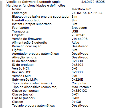

RehabMan Posted June 22, 2015 Share Posted June 22, 2015 I created a handoff patch based on DoktorDok's patch in CAT. Comment: 10.11.dp BT4LE-Handoff-Hotspot, credit RehabMan based on Dokterdok patch Name: IOBluetoothFamily Find: <4885ff74 47488b07> Replace: <41be0f00 0000eb44> Not really tested yet, just verified that handoff/hotspot shows in System Information. Note: Specific to Broadcom (DoktorDok's patch for 10.10.x may be more generic)... 4 Link to comment https://www.insanelymac.com/forum/topic/306783-handoff-hotspot-patch/ Share on other sites More sharing options...
lisai9093 Posted June 22, 2015 Share Posted June 22, 2015 Cheers! I came up with the same binary patch as yours. And it works on my machine. Link to comment https://www.insanelymac.com/forum/topic/306783-handoff-hotspot-patch/#findComment-2147319 Share on other sites More sharing options...
RehabMan Posted June 23, 2015 Author Share Posted June 23, 2015 Cheers! I came up with the same binary patch as yours. And it works on my machine. Yes, someone else pointed that out (in PM). It would have been nice had google found it for me. I could have had an hour of my life back :-) Since both of us came up with the same, confirmation it must be close to Dokterdok's intention. 1 Link to comment https://www.insanelymac.com/forum/topic/306783-handoff-hotspot-patch/#findComment-2147322 Share on other sites More sharing options...
