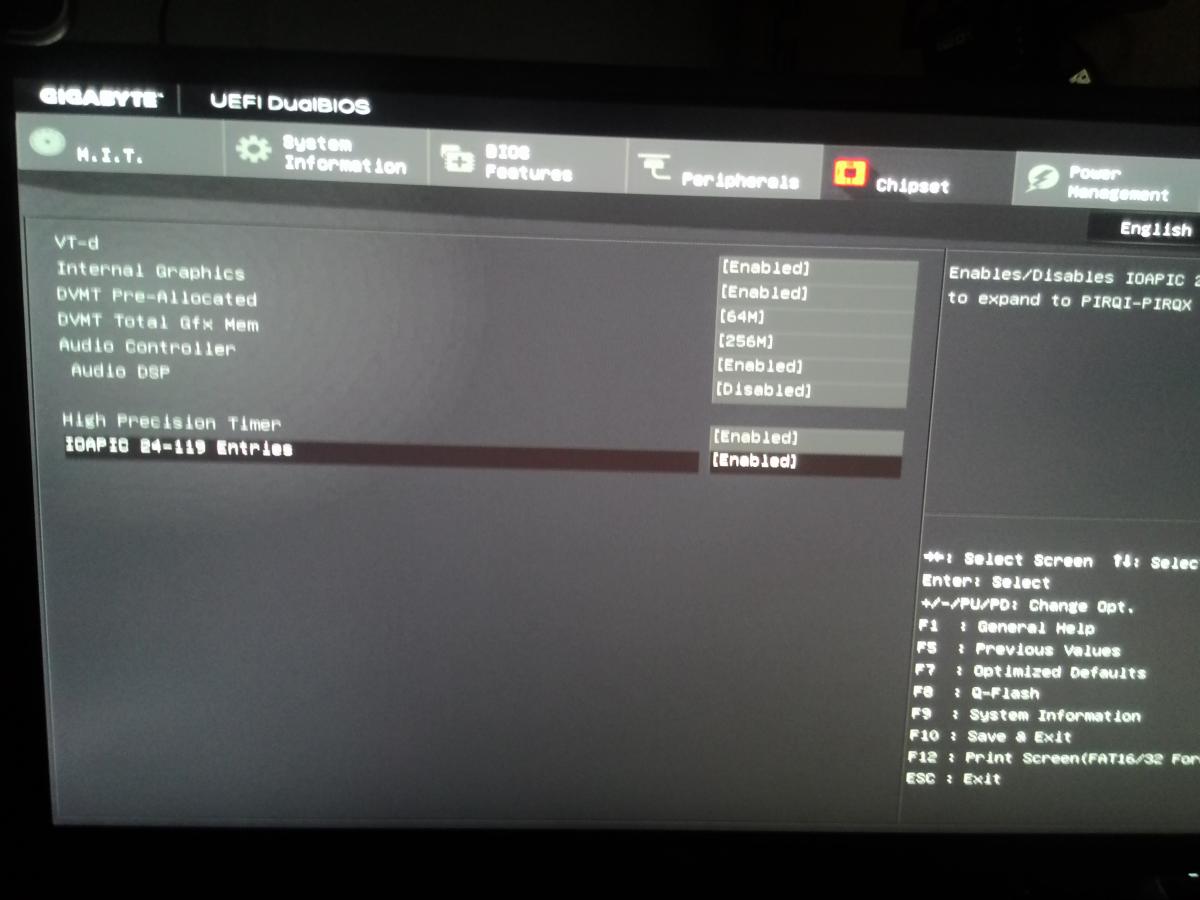

Passmore Posted November 5, 2015 Share Posted November 5, 2015 Great ! I've successfully flashed my GA-Z170X Gaming 5 with the mooded bios (the latest F4) and the EFIFLASH (Old version you linked), Now, USB and Sata are Working oob, I have a BCM94360CD WIFI+BT => oob Thabks vonmolk. Thank you Pike.R, you guys are great Hey Yassinex, Can you confirm that now that you've done this, EVERYTHING is working? I.e Lan, graphics, & no weird glitches? If so I'm going to buy this board tomorrow... Also, guys, thank you so much for all your work, incredible stuff, what a find. You've achieved something everyone thought wasn't going to be possible till 2016... D EDIT: Hey Pike, could you clarify the steps needed to do this? "To the rest of the clan. Just add a search/replace pattern in Clover and you are done" Link to comment https://www.insanelymac.com/forum/topic/308707-fresh-install-from-usb-installer-el-capitan-10111-beta-build-15b38b-on-skylake-i7-6700-gigabyte-z170-hd3/page/9/#findComment-2185509 Share on other sites More sharing options...

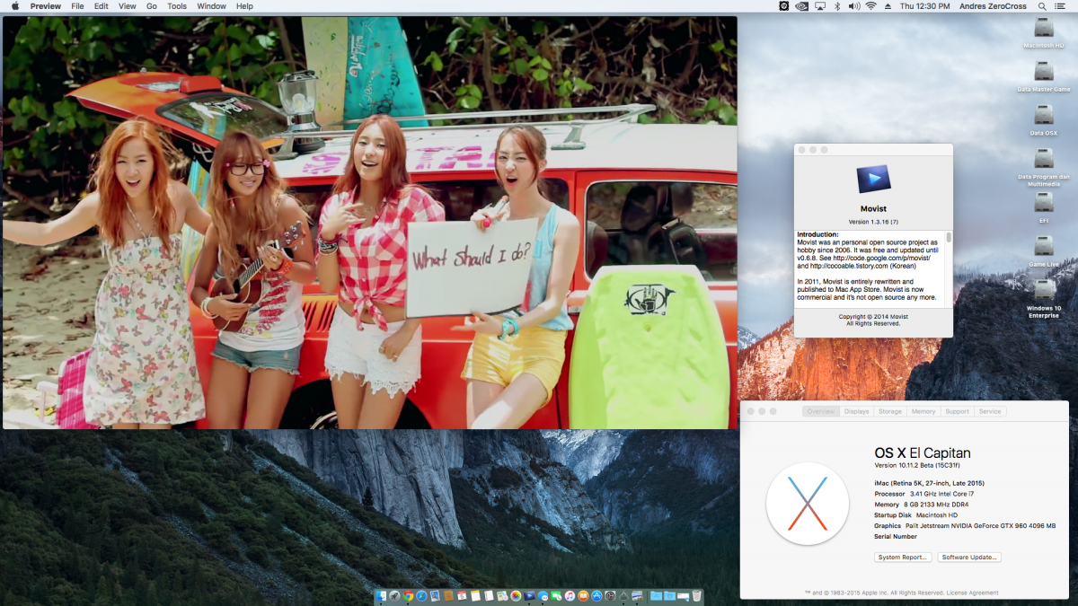

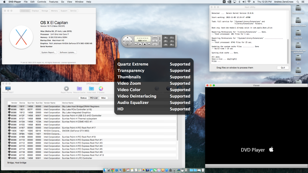

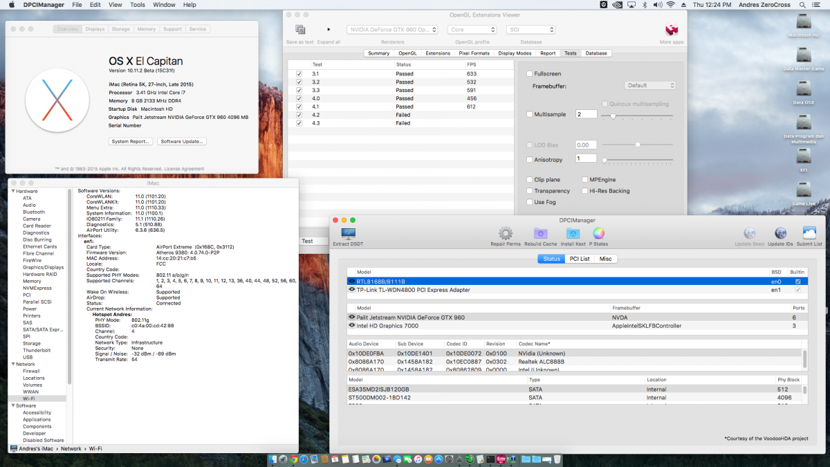

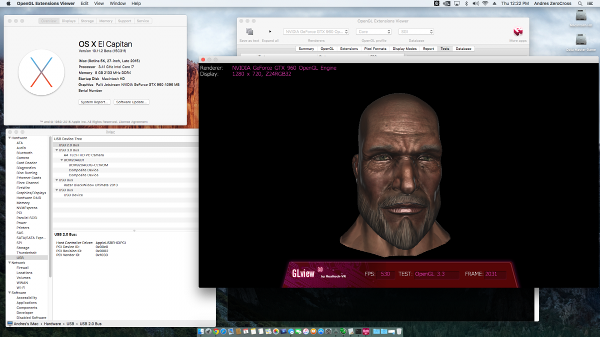

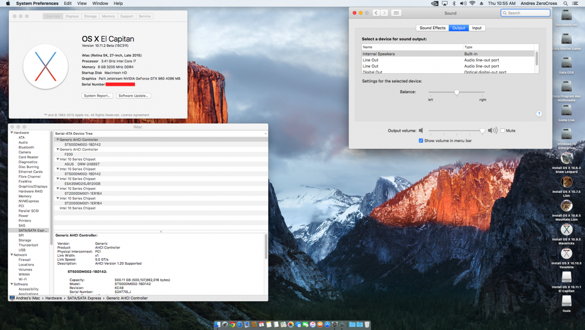

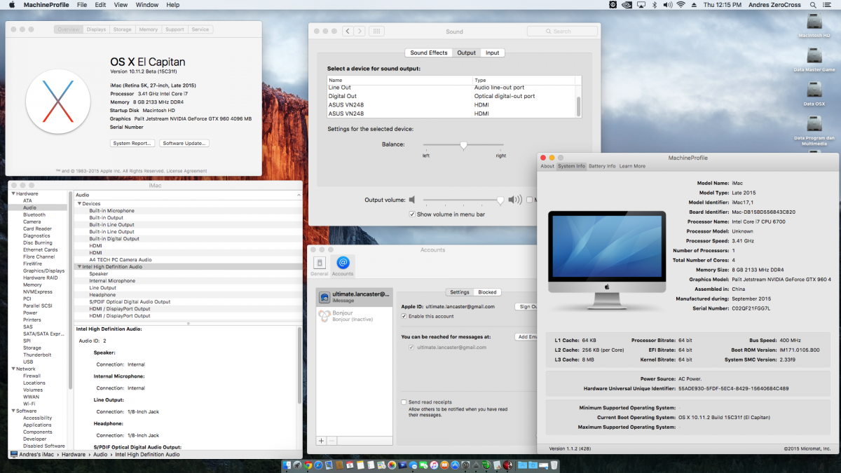

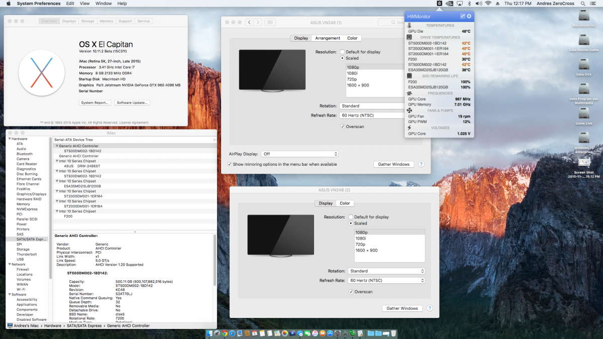

Andres ZeroCross Posted November 5, 2015 Author Share Posted November 5, 2015 Motherboard : Gigabyte Z170-HD3Processor : i7 6700VGA : GTX960 Palit JetsreamAll Full Working Thanks allI flash my mod bios via Efi Flash I will update this thread soon Link to comment https://www.insanelymac.com/forum/topic/308707-fresh-install-from-usb-installer-el-capitan-10111-beta-build-15b38b-on-skylake-i7-6700-gigabyte-z170-hd3/page/9/#findComment-2185515 Share on other sites More sharing options...
matey82 Posted November 5, 2015 Share Posted November 5, 2015 Can anyone confirm that I can install el capitan on 950 Pro SSD With NVMe (not AHCI) on Z170 mainboard? Link to comment https://www.insanelymac.com/forum/topic/308707-fresh-install-from-usb-installer-el-capitan-10111-beta-build-15b38b-on-skylake-i7-6700-gigabyte-z170-hd3/page/9/#findComment-2185527 Share on other sites More sharing options...
Andres ZeroCross Posted November 5, 2015 Author Share Posted November 5, 2015 There is no kernel panic, good performance i thought. 1 Link to comment https://www.insanelymac.com/forum/topic/308707-fresh-install-from-usb-installer-el-capitan-10111-beta-build-15b38b-on-skylake-i7-6700-gigabyte-z170-hd3/page/9/#findComment-2185529 Share on other sites More sharing options...

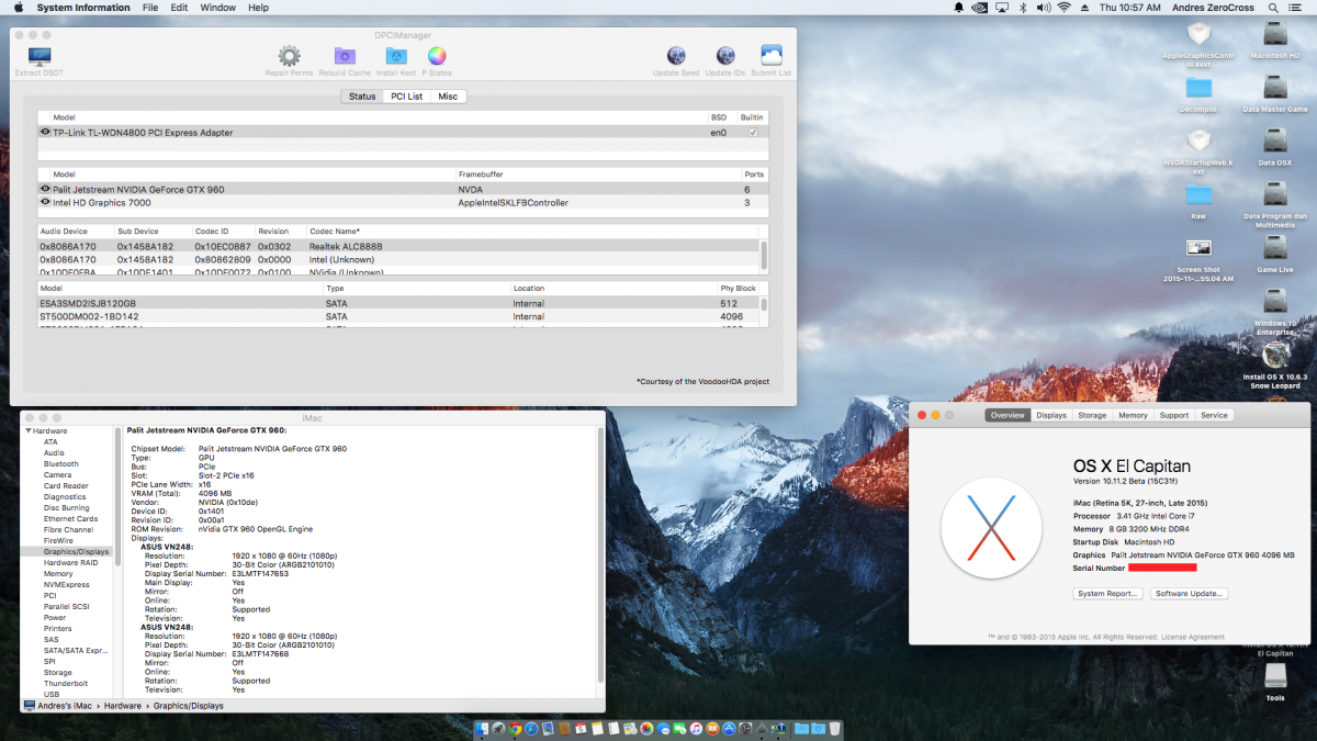

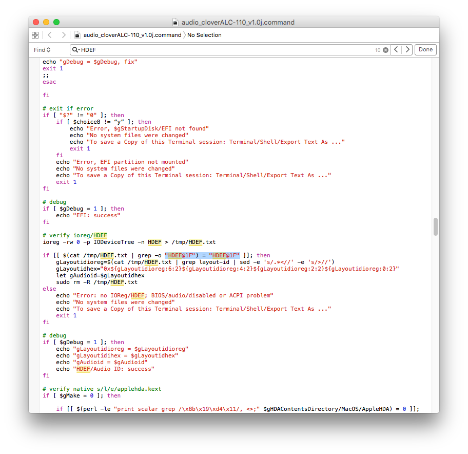

Andres ZeroCross Posted November 5, 2015 Author Share Posted November 5, 2015 How about your audio?? Did you use voodoo?? I only need to edit Toleda ALC Injection Script and great performance AHDA at my System 1 Link to comment https://www.insanelymac.com/forum/topic/308707-fresh-install-from-usb-installer-el-capitan-10111-beta-build-15b38b-on-skylake-i7-6700-gigabyte-z170-hd3/page/9/#findComment-2185537 Share on other sites More sharing options...
Luke//power Posted November 5, 2015 Share Posted November 5, 2015 How about your audio?? Did you use voodoo?? I only need to edit Toleda ALC Injection Script and great performance AHDA at my System My audio does (should) work with the toleda script but it was giving me hastle, so I impatiently insalled voodoohda. My proper install on SSD im going for applehda. What did you edit in the script? Link to comment https://www.insanelymac.com/forum/topic/308707-fresh-install-from-usb-installer-el-capitan-10111-beta-build-15b38b-on-skylake-i7-6700-gigabyte-z170-hd3/page/9/#findComment-2185538 Share on other sites More sharing options...

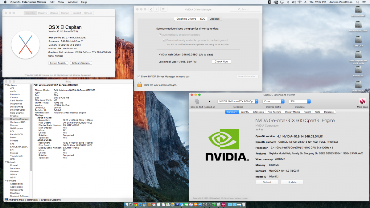

Nasco Posted November 5, 2015 Share Posted November 5, 2015 There is no kernel panic, good performance i thought. How did you fix the video? Just the new driver? Link to comment https://www.insanelymac.com/forum/topic/308707-fresh-install-from-usb-installer-el-capitan-10111-beta-build-15b38b-on-skylake-i7-6700-gigabyte-z170-hd3/page/9/#findComment-2185542 Share on other sites More sharing options...
bomerr Posted November 5, 2015 Share Posted November 5, 2015 Ok guys. I have had a very, very, busy day and that basically delayed everything, but here it is.This is what I have come up with. In/System/Library/Extensions/AppleAPIC.kext/Contents/AppleAPICYou search for: C1 E8 10 0F B6 F0 and replace it with: BE 11 00 00 00 90That gets me to the single user prompt without delays. Also boots the installer on USB thumb drive and El Capitan on a SATA SSD.Please confirm. can confirm this works. Woah, I finally came across an actual bug: EDIT: All of a sudden, im getting incorrect ram values in about this mac (only 8gb with wrong ram speed) This was fine for me before, I'm not sure what's changed... EDIT 2: After rebooting, it's back to normal, bizarre... I have the same memory issue. 16GB of ram installed but only 8GB shown and activity manger reports incorrect pressure. Also my ethernet is not working. Are you guys using a .kext to enable ethernet? To recap I have an ASrock Z170 ITX motherboard. bootflags are nvda_drv=1 and kext.. boot drive is a samsung pcie AHCI ssd. Link to comment https://www.insanelymac.com/forum/topic/308707-fresh-install-from-usb-installer-el-capitan-10111-beta-build-15b38b-on-skylake-i7-6700-gigabyte-z170-hd3/page/9/#findComment-2185545 Share on other sites More sharing options...

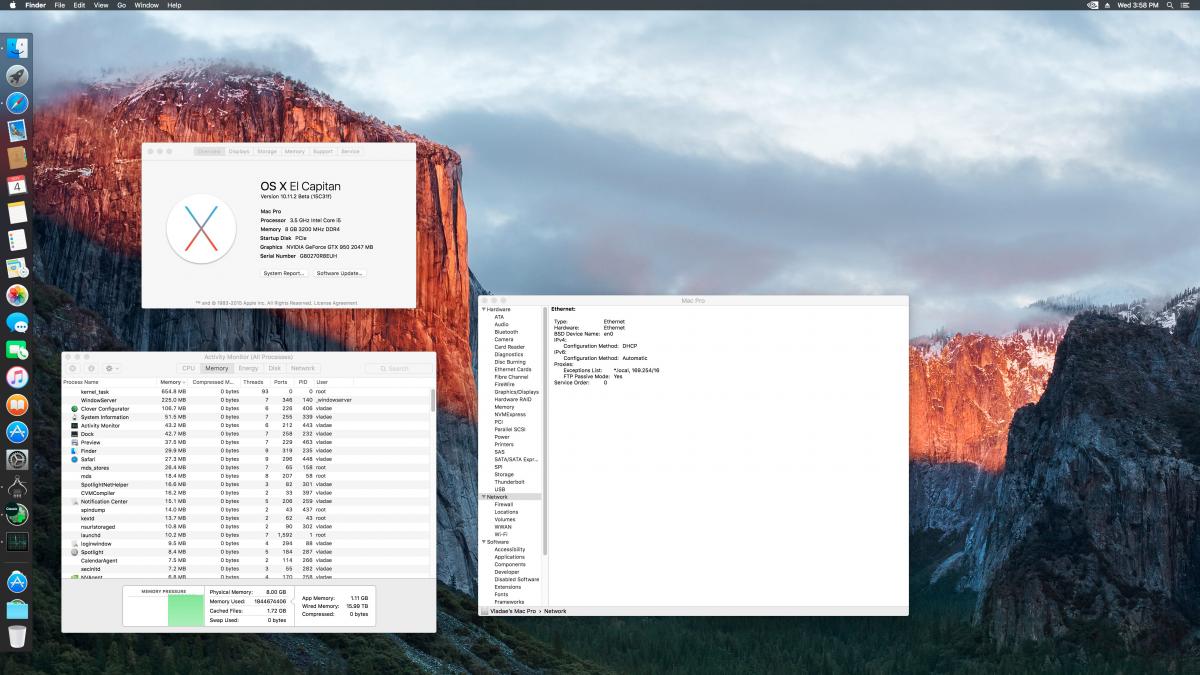

Luke//power Posted November 5, 2015 Share Posted November 5, 2015 How did you fix the video? Just the new driver? It's my understanding that the graphics issues were also caused by the IOAPIC thing. can confirm this works. I have the same memory issue. 16GB of ram installed but only 8GB shown and activity manger reports incorrect pressure. Also my ethernet is not working. Are you guys using a .kext to enable ethernet? To recap I have an ASrock Z170 ITX motherboard. bootflags are nvda_drv=1 and kext.. boot drive is a samsung pcie AHCI ssd. I know it sounds weird, but you might try rebooting and pressing f8 to select clover instead of letting the system boot naturally. It's been working fine for me but every time i was using f8 to select clover. The one time I let the system boot naturally I had this issue. Link to comment https://www.insanelymac.com/forum/topic/308707-fresh-install-from-usb-installer-el-capitan-10111-beta-build-15b38b-on-skylake-i7-6700-gigabyte-z170-hd3/page/9/#findComment-2185548 Share on other sites More sharing options...

Andres ZeroCross Posted November 5, 2015 Author Share Posted November 5, 2015 My audio does (should) work with the toleda script but it was giving me hastle, so I impatiently insalled voodoohda. My proper install on SSD im going for applehda. What did you edit in the script? Luke,, you need to change this line. See the screenshot. Default is HDEF@1B then you need to change to "HDEF@1F" (address of HDEF at SkyLake) 1 Link to comment https://www.insanelymac.com/forum/topic/308707-fresh-install-from-usb-installer-el-capitan-10111-beta-build-15b38b-on-skylake-i7-6700-gigabyte-z170-hd3/page/9/#findComment-2185602 Share on other sites More sharing options...

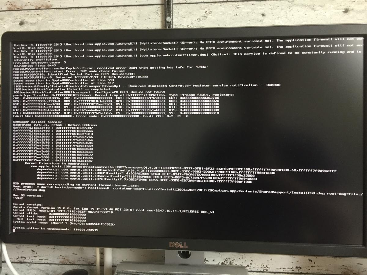

Xavorithre Posted November 5, 2015 Share Posted November 5, 2015 Using Pike's patch in Clover I've been trying to get into the installer, but I keep getting kernel panics on: IOBluetoothHostControllerUARTTransport::ConfigurePM ACPI device not found At first i thought it was due to graphics, because the bluetooth error is a common thing when your graphics stop working. I've tried everything graphics and bluetooth related AFAIK. My HD6850, Internal graphics, removing my GPU, but no success. The photo shown below uses -v dart=0 kext-dev-mode=1 rootless=0 but I've used several combinations of these even though I highly doubt these boot args have anything to do with it. Booting into single user mode (-s) doesn't work either. I do get up to the console, but not short after it freezes with the following error in the console: -sh-3.2# **** [iOBluetoothFamily][searchForTransportEventTimeOutHandler] -- Missing Bluetooth Controller Transport! Does anyone have any clue as to what I can do? Link to comment https://www.insanelymac.com/forum/topic/308707-fresh-install-from-usb-installer-el-capitan-10111-beta-build-15b38b-on-skylake-i7-6700-gigabyte-z170-hd3/page/9/#findComment-2185622 Share on other sites More sharing options...
yassinex Posted November 5, 2015 Share Posted November 5, 2015 Hey Yassinex, Can you confirm that now that you've done this, EVERYTHING is working? I.e Lan, graphics, & no weird glitches? If so I'm going to buy this board tomorrow... My report for GA-Z170X Gaming 5 : Bios F4 Patched. Make sure the Serial IO and CSM option are Disabled. Windows 8/10 UEFI boot only. >>> BUT to be in the safe side, you should use Pike .R AppleAPIC patch in clover Working oob : USB 3 is OK SATA is OK Wifi + BT PCI-E card (BCM94360CD) is OK. Works with patches/Drivers : - Ethernet the Killer E2201 chip : Ok (with the AtherosE2200Ethernet injectecd from Clover). - NVIDIA 970 GTX ( lates web drivers from Nvidia ) + Sleep Patch ( I did't test if still useful with the BIOS/ACPI Patch ) Not Working : - USB 2.0 /1.1 not Working. I must confessn I did not have time de search why. ( As I have 8 USB 3.0 working ports atm ). - Intel i219 Ethernet Not yet tested (I'll edit this section later) : - Sleep/Shutdows/Reboot : seems OK but I'll test this more deeply tonight. - Audio, the ALC1150 should be OK with audio_CloverALC + Clover ACPI Patch ( replace HDAS by HDEF ). But not yet tested. - HDMI audio from NVIDIA, needs a patch not yet tested - HandsOff ( With BCM94360CD ). should be working. but lets see tonight. So it's perfectly working solution Link to comment https://www.insanelymac.com/forum/topic/308707-fresh-install-from-usb-installer-el-capitan-10111-beta-build-15b38b-on-skylake-i7-6700-gigabyte-z170-hd3/page/9/#findComment-2185627 Share on other sites More sharing options...
