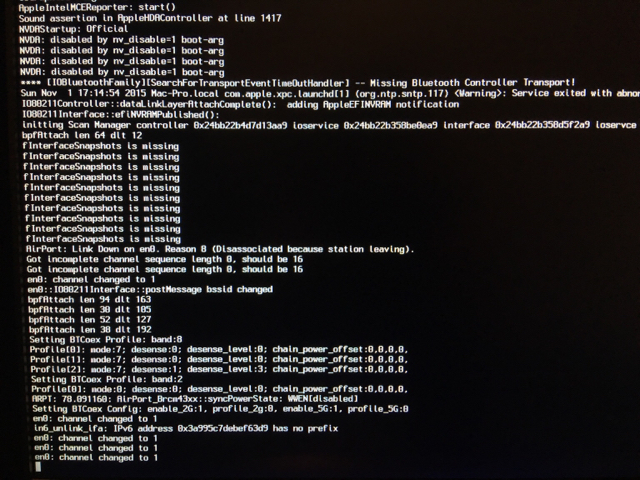

yassinex Posted November 1, 2015 Share Posted November 1, 2015 Hi there, this is my hardware : A Skylake i7 6700K on a Gigabyte GA-Z170X Gaming 5. I have an HDD connected to a PCIe to Sata (ASMedia 1061) I have a BCM94360CD Wifi/BT card on a PCI-E adapter. Normally detected oob. For the Software part, I've followed the first post. I'm using my MBP to Install in the first partition of the HDD a copy of 10.11.1 Installer, and Clover 3320 in the hidden EFI partition. I put a config.plist with the first post configuration as described (Without the FakeCPUID). Then when done, I've connected the HDD to the PCIE/SATA controller. Now, I can see partitions of the HDD are loading OK. But after the BT and network and ntp sequence, the screen hangs and nothing more. I've restarted many times, nothings happends. Fyi, I do not have any PCI to USB 2 card, so no extra USB card connected. Do you think that the boot process is stopped because of this ? Thanks for your help, and if it's not clear just tell me. Cheers EDIT: Got it, it was the FakeSMC and 3rd_party_sata.kext missing in the /EFI/CLOVER/kext/10.11 folder. Now it boots correctly, and I've ordered a (cheap) PCIE to USB3 card with FL1000 chipset to bypass the USB problem...until Pthe master coder Pike.R fix this issues Link to comment https://www.insanelymac.com/forum/topic/308707-fresh-install-from-usb-installer-el-capitan-10111-beta-build-15b38b-on-skylake-i7-6700-gigabyte-z170-hd3/page/5/#findComment-2184359 Share on other sites More sharing options...

Luke//power Posted November 2, 2015 Share Posted November 2, 2015 ImageUploadedByTapatalk1446423560.742034.jpg Yeah, this is what happens when it can't find the drive after booting the kernel (because the drivers aren't "working") The only reason some are able to boot directly from HDD is via 3rd party sata like ASM1061 Link to comment https://www.insanelymac.com/forum/topic/308707-fresh-install-from-usb-installer-el-capitan-10111-beta-build-15b38b-on-skylake-i7-6700-gigabyte-z170-hd3/page/5/#findComment-2184606 Share on other sites More sharing options...

yassinex Posted November 2, 2015 Share Posted November 2, 2015 Thanks Luke//power, but this is exactly what I'm using. I m booting my HDD from ASM1061, and I can notice that it detect partition name correctly....at that point I'm really confused... Do I need to patch something like the ASM1061 ? Link to comment https://www.insanelymac.com/forum/topic/308707-fresh-install-from-usb-installer-el-capitan-10111-beta-build-15b38b-on-skylake-i7-6700-gigabyte-z170-hd3/page/5/#findComment-2184621 Share on other sites More sharing options...
Luke//power Posted November 2, 2015 Share Posted November 2, 2015 Thanks Luke//power, but this is exactly what I'm using. I m booting my HDD from ASM1061, and I can notice that it detect partition name correctly....at that point I'm really confused... Do I need to patch something like the ASM1061 ? Yes, the hardware is natively supported but the device ID is missing. You need to use something like 3rd_party_sata.kext to inject the IDs. Also, make sure you have the clover DSDT settings correct, see OP about this. What Andres suggests worked well for me. Specifically: "tick FixHpet, AddDTGP, FixHDA, New Way, Delete Unused, AddHDMI, Drop OEM_DSM of HDA and SATA" I had to fiddle around a bit with the clover DSDT settings before it booted properly. 1 Link to comment https://www.insanelymac.com/forum/topic/308707-fresh-install-from-usb-installer-el-capitan-10111-beta-build-15b38b-on-skylake-i7-6700-gigabyte-z170-hd3/page/5/#findComment-2184635 Share on other sites More sharing options...

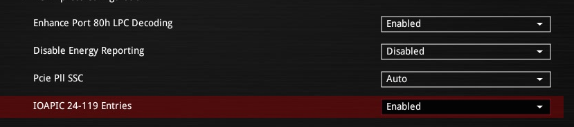

doseone Posted November 2, 2015 Share Posted November 2, 2015 1203 z170-deluxe bios seems to make no difference for me. With or without XHCI hand-off or clover fix ownership. Getting the same results (USB not working) after doing the update for ASUS Maximus VIII HERO BIOS version 1001. Link to comment https://www.insanelymac.com/forum/topic/308707-fresh-install-from-usb-installer-el-capitan-10111-beta-build-15b38b-on-skylake-i7-6700-gigabyte-z170-hd3/page/5/#findComment-2184836 Share on other sites More sharing options...
Pike R. Alpha Posted November 2, 2015 Share Posted November 2, 2015 Earlier BIOS versions of Asus had some special settings in the Advanced section, that were later removed. 2 Link to comment https://www.insanelymac.com/forum/topic/308707-fresh-install-from-usb-installer-el-capitan-10111-beta-build-15b38b-on-skylake-i7-6700-gigabyte-z170-hd3/page/5/#findComment-2184841 Share on other sites More sharing options...
doseone Posted November 3, 2015 Share Posted November 3, 2015 Earlier BIOS versions of Asus had some special settings in the Advanced section, that were later removed. Can confirm, disabling IOAPIC 24-119 Entries in the Earlier Bios version (MAXIMUS VIII HERO BIOS 0214) has enabled USB for me. I using a SSD drive that was created on a different working system. Will try with a fresh install and report back. Many thanks to Pike! 3 Link to comment https://www.insanelymac.com/forum/topic/308707-fresh-install-from-usb-installer-el-capitan-10111-beta-build-15b38b-on-skylake-i7-6700-gigabyte-z170-hd3/page/5/#findComment-2184868 Share on other sites More sharing options...
Luke//power Posted November 3, 2015 Share Posted November 3, 2015 Oh man, now I wish I didnt update. Is it safe/possible to downgrade? Or is it possible to disable this through other means? Back in my day new versions added things instead of removing them. I miss those days. Link to comment https://www.insanelymac.com/forum/topic/308707-fresh-install-from-usb-installer-el-capitan-10111-beta-build-15b38b-on-skylake-i7-6700-gigabyte-z170-hd3/page/5/#findComment-2184873 Share on other sites More sharing options...
Pike R. Alpha Posted November 3, 2015 Share Posted November 3, 2015 Can confirm, disabling IOAPIC 24-119 Entries in the Earlier Bios version (MAXIMUS VIII HERO BIOS 0214) has enabled USB for me. I using a SSD drive that was created on a different working system. Will try with a fresh install and report back. Many thanks to Pike! If you, or anybody else here, with a BIOS with that setting is willing to download and compile RevoBoot, and put it on a USB flash drive with Base System restored on it, then we can go hunting (off list) for a solution for everyone. Clover. Chameleon, Chimera will be updated after that. Edit: Let's make it even easier for you. You only have to setup a bootable flash drive – with boot0 and boot1h on it – and a specially prepared version of RevoBoot. You won't even need to restore the Base System DMG anymore. We're only after some values that are displayed long before it will try to boot. How's that? PM me if you have that BIOS and are ready for testing! Also. You may want to use UEFITool of the magnificent Nikolaj Schlej aka CodeRush and go hunt for this value: 0x770020 in your BIOS ROM files. 2 Link to comment https://www.insanelymac.com/forum/topic/308707-fresh-install-from-usb-installer-el-capitan-10111-beta-build-15b38b-on-skylake-i7-6700-gigabyte-z170-hd3/page/5/#findComment-2184885 Share on other sites More sharing options...

yassinex Posted November 3, 2015 Share Posted November 3, 2015 If you, or anybody else here, with a BIOS with that setting is willing to download and compile RevoBoot, and put it on a USB flash drive with Base System restored on it, then we can go hunting (off list) for a solution for everyone. Clover. Chameleon, Chimera will be updated after that. man I wish I had that setting on my bios. My main MB a Gigabyte Z170X Gaming 5 do not have this setting Good luck Link to comment https://www.insanelymac.com/forum/topic/308707-fresh-install-from-usb-installer-el-capitan-10111-beta-build-15b38b-on-skylake-i7-6700-gigabyte-z170-hd3/page/5/#findComment-2184944 Share on other sites More sharing options...

natsu98k Posted November 3, 2015 Share Posted November 3, 2015 I have an ASrock Z170 Extreme4 motherboard and couldn't find any option to disable the APIC 24-119. So , If I can be useful ,tell me. Link to comment https://www.insanelymac.com/forum/topic/308707-fresh-install-from-usb-installer-el-capitan-10111-beta-build-15b38b-on-skylake-i7-6700-gigabyte-z170-hd3/page/5/#findComment-2184973 Share on other sites More sharing options...
Pike R. Alpha Posted November 3, 2015 Share Posted November 3, 2015 Update: Good news! Tony from the other side just confirmed it per e-mail (using my test version of RevoBoot). I was right. All we need now is a patch... 4 Link to comment https://www.insanelymac.com/forum/topic/308707-fresh-install-from-usb-installer-el-capitan-10111-beta-build-15b38b-on-skylake-i7-6700-gigabyte-z170-hd3/page/5/#findComment-2184997 Share on other sites More sharing options...
RehabMan Posted November 3, 2015 Share Posted November 3, 2015 ... All we need now is a patch... Maybe the option, when not present in the BIOS UI, can be changed via UEFI shell (setup_var)? Because the register is R/WO, it cannot be changed after set by BIOS. Link to comment https://www.insanelymac.com/forum/topic/308707-fresh-install-from-usb-installer-el-capitan-10111-beta-build-15b38b-on-skylake-i7-6700-gigabyte-z170-hd3/page/5/#findComment-2185017 Share on other sites More sharing options...
