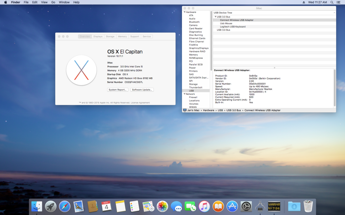

So, almost everything working but my usb wifi adapter (Belkin F7D2101 v1) It worked fine back in Yosemite but it doesn't work in el capitan, can somebody help me with it? Also my ram is only showing four Gb it should be eight I have only one stick by the way... really weird, and the last thing is audio, which is a common thing, i appreciate any help guys, thanks in advance.

Jancarlos, for general post install help, I suggest you open a new topic for the subject in this forum. So many advances were made in this topic, let's keep it clean!
