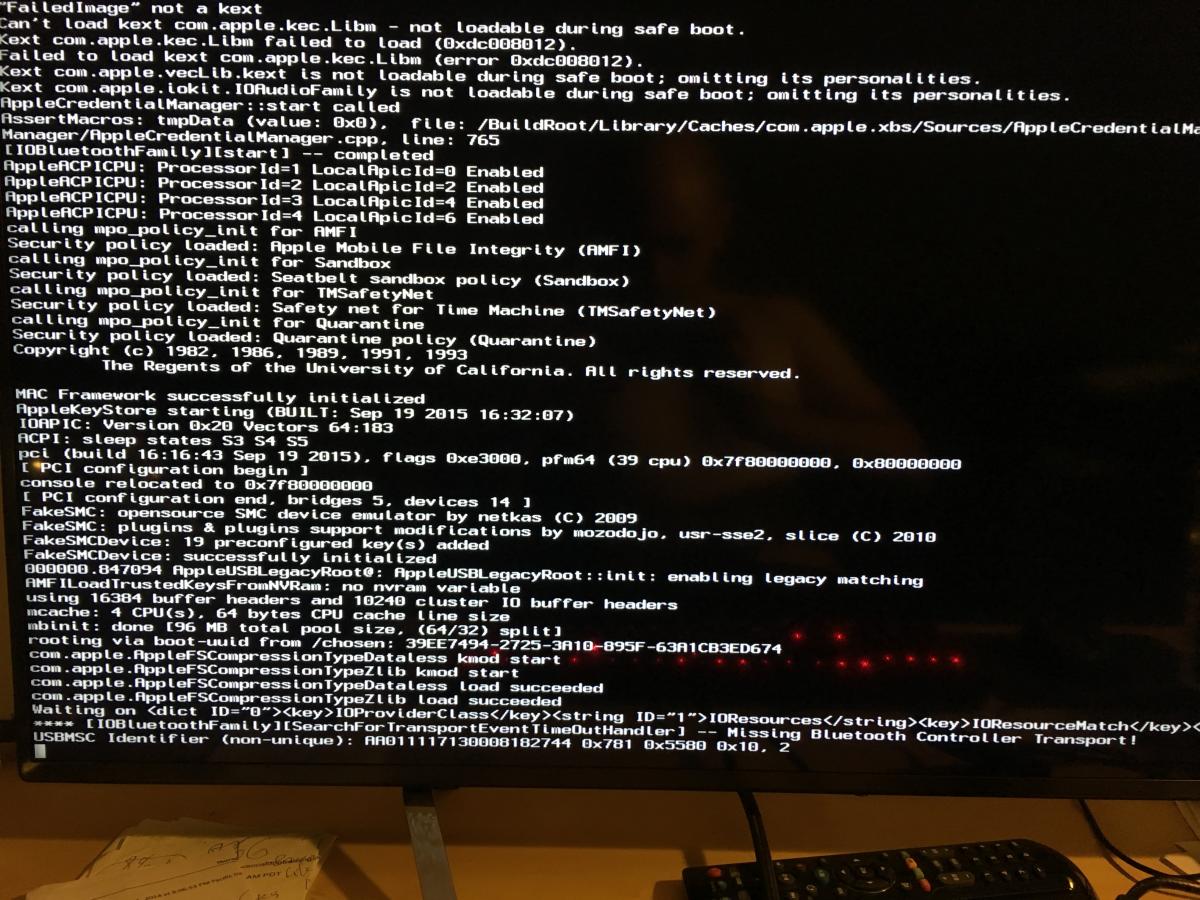

bomerr Posted November 4, 2015 Share Posted November 4, 2015 Getting this error, any help? Specs: ASRock Z170 itx/ac, i5-6600k, GTX 950. I modded my BIOS with AMIBCP and flashed it with AFUDOS but I am still getting the same error. Link to comment https://www.insanelymac.com/forum/topic/308707-fresh-install-from-usb-installer-el-capitan-10111-beta-build-15b38b-on-skylake-i7-6700-gigabyte-z170-hd3/page/7/#findComment-2185261 Share on other sites More sharing options...

nexx892 Posted November 4, 2015 Share Posted November 4, 2015 Anybody try using these AFUDOS commands on a gigabyte board. One of the force commands might work? If not I will solder wires on one of my bios chips and flash with my raspberry pi this weekend. This tool also exists http://forum.techinferno.com/general-notebook-discussions/2403-flash-modified-bios-uefi-digitally-signed-circumvent-secure-flash.html I think this tool is preferable because you can extract the bios part with UEFITool and then flash it directly. Link to comment https://www.insanelymac.com/forum/topic/308707-fresh-install-from-usb-installer-el-capitan-10111-beta-build-15b38b-on-skylake-i7-6700-gigabyte-z170-hd3/page/7/#findComment-2185265 Share on other sites More sharing options...

Xavorithre Posted November 4, 2015 Share Posted November 4, 2015 Tony from the other side just confirmed that Gigabyte is aware of the issue and will be issuing an official BIOS update to disable the IOAPIC setting. I'm waiting for that rather then messing up my motherboards BIOS. Link to comment https://www.insanelymac.com/forum/topic/308707-fresh-install-from-usb-installer-el-capitan-10111-beta-build-15b38b-on-skylake-i7-6700-gigabyte-z170-hd3/page/7/#findComment-2185270 Share on other sites More sharing options...

vonmolk Posted November 4, 2015 Share Posted November 4, 2015 Try dumping the BIOS on your mobo with the /o command, mod that and see if it will flash. I did try to dump the BIOS with afudos and it wouldn't even do that. I am going to try my hand at manually modifying with UEFITool or wait for the bios as mentioned earlier in this thread. Link to comment https://www.insanelymac.com/forum/topic/308707-fresh-install-from-usb-installer-el-capitan-10111-beta-build-15b38b-on-skylake-i7-6700-gigabyte-z170-hd3/page/7/#findComment-2185280 Share on other sites More sharing options...
