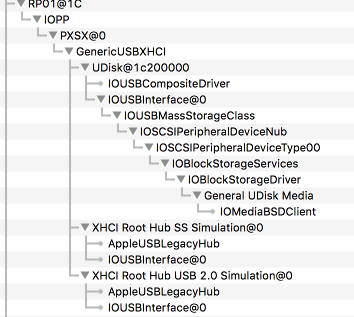

Im trying to map all the ports on my motherboard (Asus Z170 Premium) to make patch.
Currently i loaded USBInjectAll and enabled following patches in clover: change EHC1 to EH01, change EHC2 to EH02, change 15 port limit to 30, Skylake APIC fix. SMBIOS is iMac17,1.
All USB2 ports are working fine.
All USB3 ports are working fine both in USB2 and USB3 mode.
Unfortunately remaining two USB3.1 type 2 ports are not working at all - not even in USB2 mode.
Ive tried loading GenericUSBXHCI and doesnt make any difference.
Any advice?
[edit]
Actually i just found that one of them works in USB2 mode only but it's identifier is RP01
