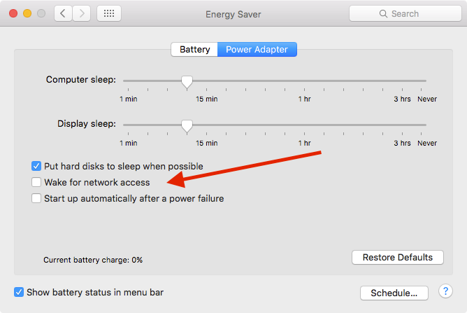

Micky1979 Posted October 30, 2015 Share Posted October 30, 2015 seem exactly the same problem described here for NVidia cards some time ago. Apparently a temporary remedy was to uncheck "Wake on LAN": ..a stupid remedy. I cannot try, no ATI cards here... 1 Link to comment https://www.insanelymac.com/forum/topic/308025-no-graphics-usb-audio-after-wake/page/8/#findComment-2183603 Share on other sites More sharing options...
Slice Posted October 30, 2015 Share Posted October 30, 2015 seem exactly the same problem described here for NVidia cards some time ago. Apparently a temporary remedy was to uncheck "Wake on LAN": stupid.png ..a stupid remedy. I cannot try, no ATI cards here... same messages. Apple again did this? Link to comment https://www.insanelymac.com/forum/topic/308025-no-graphics-usb-audio-after-wake/page/8/#findComment-2183612 Share on other sites More sharing options...
Micky1979 Posted October 30, 2015 Share Posted October 30, 2015 (edited) Apple never fix it, NVidia do it.... ATI ...was abandoned Just think the bug comes from OSX or not, NVidia did some warkaround or conform to some specification? Edited October 30, 2015 by Micky1979 Link to comment https://www.insanelymac.com/forum/topic/308025-no-graphics-usb-audio-after-wake/page/8/#findComment-2183613 Share on other sites More sharing options...
banini_jeque Posted October 30, 2015 Share Posted October 30, 2015 I already have Wake for network access unchecked, and it doesn't help me. I'm on X58 with an XFX 6870. Link to comment https://www.insanelymac.com/forum/topic/308025-no-graphics-usb-audio-after-wake/page/8/#findComment-2183619 Share on other sites More sharing options...
cecekpawon Posted October 30, 2015 Share Posted October 30, 2015 Confirmed by WarDoctorWho Link to comment https://www.insanelymac.com/forum/topic/308025-no-graphics-usb-audio-after-wake/page/8/#findComment-2183650 Share on other sites More sharing options...
big_bob Posted October 30, 2015 Share Posted October 30, 2015 I tested different configurations and want to report back on this. for me, switching off the wake for network in the power settings did not change the wake behaviour, still black screen. However, I noticed that when disabling the wol in the settings, I get the full wake request with my 7770: kernel[0]: full wake request (reason 1) 6378 ms When testing the sleep with the HD4000 w/o the 7770, I see the full wake request as well in the log and wake is working. Wheras when leaving the wol in settings enabled, I don't have the full wake request in my logs. But I'm not sure if this is connected to that issue. Also while testing with the HD4000 I have the missing sleep image in my logs as well, but wake is working. This entry can be found in all logs of my tested configurations so I doubt that it is connected to the wake problem. WindowServer[153]: no sleep images for WillPowerOffWithImages For reference I've attached the logs on my 3 tested configurations. sleep_1_hd_4000 sleep working sleep_2_7770 sleep not working sleep_3_7770_software_wol_disabled sleep not working sleep_1_hd_4000.rtf sleep_2_7770.rtf sleep_3_7770_software_wol_disabled.rtf Link to comment https://www.insanelymac.com/forum/topic/308025-no-graphics-usb-audio-after-wake/page/8/#findComment-2183668 Share on other sites More sharing options...

Micky1979 Posted October 30, 2015 Share Posted October 30, 2015 I already have Wake for network access unchecked, and it doesn't help me. I'm on X58 with an XFX 6870. I did not say it was definitely the problem, was a "spot on", just try wake depend by some protocols, perhaps the time out happens because another process is not completed successfully, not it is necessarily the video card itself.. PS, check also the bios settings about WOL (LAN, wifi etc..), just to be sure.. Confirmed by WarDoctorWho AMD is returned (some new Macs have AMD onboard), 10.10.2 maybe has new updates drivers, no surprise Link to comment https://www.insanelymac.com/forum/topic/308025-no-graphics-usb-audio-after-wake/page/8/#findComment-2183716 Share on other sites More sharing options...

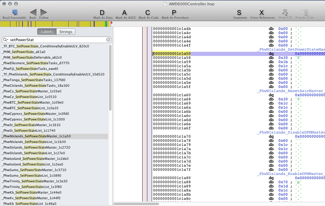

Slice Posted November 5, 2015 Share Posted November 5, 2015 I keep an idea that ElCapitan more careful testing the card and doesn't create a procedure for PowerManagement. Just a question. Is there anybody knows where is "ATIFramebufferNI::setPowerState" located? I have not find a kext with such strings. (searching with disassembler). It means OSX knows that my Radeon is not Mac card. It is Hackintosh. I am still not testing FakePCIID by rehabman. May be this is a key. Link to comment https://www.insanelymac.com/forum/topic/308025-no-graphics-usb-audio-after-wake/page/8/#findComment-2185551 Share on other sites More sharing options...
Monq Posted November 5, 2015 Share Posted November 5, 2015 Are there "Mac cards"? I thought you could plug any normal card... Link to comment https://www.insanelymac.com/forum/topic/308025-no-graphics-usb-audio-after-wake/page/8/#findComment-2185552 Share on other sites More sharing options...
Monq Posted November 5, 2015 Share Posted November 5, 2015 By the way, ATIFramebufferNI::setPowerState is in AMD6000Controller.kext Link to comment https://www.insanelymac.com/forum/topic/308025-no-graphics-usb-audio-after-wake/page/8/#findComment-2185558 Share on other sites More sharing options...
Slice Posted November 5, 2015 Share Posted November 5, 2015 By the way, ATIFramebufferNI::setPowerState is in AMD6000Controller.kext I was looking into Can you show me details? Link to comment https://www.insanelymac.com/forum/topic/308025-no-graphics-usb-audio-after-wake/page/8/#findComment-2185565 Share on other sites More sharing options...
Monq Posted November 5, 2015 Share Posted November 5, 2015 I'm sorry! I just did... $ grep -r ATIFramebufferNI /System/Library/Extensions/ Binary file /System/Library/Extensions/AMD6000Controller.kext/Contents/MacOS/AMD6000Controller matches /System/Library/Extensions/AppleGraphicsControl.kext/Contents/PlugIns/AppleMuxControl.kext/Contents/Info.plist: <string>ATIFramebufferNI</string> $ grep -r setPowerState /System/Library/Extensions/AMD6000Controller.kext/Contents/MacOS/AMD6000Controller Binary file /System/Library/Extensions/AMD6000Controller.kext/Contents/MacOS/AMD6000Controller matches Link to comment https://www.insanelymac.com/forum/topic/308025-no-graphics-usb-audio-after-wake/page/8/#findComment-2185571 Share on other sites More sharing options...
