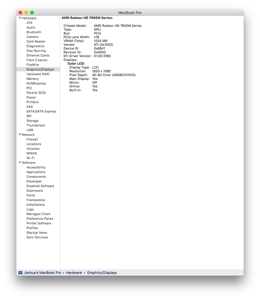

passmaster16 Posted November 21, 2015 Share Posted November 21, 2015 Hi guys. I have a Sony Vaio E Series SVE1712BCXB laptop with a AMD Radeon 7650M video card. The 7650M is basically a rebranded AMD 6000 series GPU. OpenGL viewer shows the chip as a Radeon Thames Pro Prototype (attached). I'm experiencing similar issues with waking from sleep under 10.11 that I was not experiencing under 10.9. I'm using the same modified Pondweed frame buffer, loading the Vbios, injecting EDID, and injecting ATI in Clover config.plist on 10.11 that I was using in 10.9 -- no changes whatsoever. I am using MacBookPro9,2 SMBIOS since I have an Intel Core i5 3210M (Ivy Bridge) CPU. I get proper video on initial boot of 10.11 and the GPU appears to be recognized the same way it was on 10.9. However when I put the machine to sleep and attempt to wake up, I get a black screen both on the built-in laptop display and also no output on HDMI. When this happens I cannot VNC to the machine but can SSH to it, so the network and OS is responsive. I believe I'm seeing similar events in the system.log as others. I've attached the full log from the time I put the system to sleep, to wakeup attempt, and finally after the system times out and reboots itself. Machine put to sleep Nov 21 13:39:14 Joshuas-MBP WindowServer[145]: no sleep images for WillPowerOffWithImages Attempt to wake up Nov 21 13:39:56 Joshuas-MBP kernel[0]: Opened file /var/log/SleepWakeStacks.bin, size 172032, extents 1, maxio 2000000 ssd 1Nov 21 13:39:56 Joshuas-MBP kernel[0]: polled file major 1, minor 0, blocksize 4096, pollers 5Nov 21 13:41:17 Joshuas-MBP kernel[0]: Wake reason: power-button (User) Nov 21 13:41:17 Joshuas-MBP kernel[0]: No interval found for . Using 8000000 Nov 21 13:41:17 Joshuas-MBP CommCenter[322]: Telling CSI to exit low power. Nov 21 13:41:17 Joshuas-MBP kernel[0]: Previous sleep cause: 5 ATI timeout Nov 21 13:42:02 Joshuas-MBP kernel[0]: ATIFramebufferNI::setPowerState(0xeb3f53b2a9df5289, 0 -> 2) timed out after 45613 ms After a while it just gives up and reboots the machine Nov 21 13:46:18 Joshuas-MBP kernel[0]: Restarting to collect Sleep wake debug logs I'm a bit of a novice but let me know if there is anything else I can do to help. Archive 3.zip Link to comment https://www.insanelymac.com/forum/topic/308025-no-graphics-usb-audio-after-wake/page/11/#findComment-2190528 Share on other sites More sharing options...

passmaster16 Posted November 22, 2015 Share Posted November 22, 2015 I know that others have already mentioned this but you can see from the attached screen cap that there is no IGPU recognized on this Vaio laptop and it still has the wake issue. Link to comment https://www.insanelymac.com/forum/topic/308025-no-graphics-usb-audio-after-wake/page/11/#findComment-2190674 Share on other sites More sharing options...

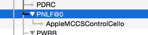

Mieze Posted November 22, 2015 Share Posted November 22, 2015 What is the role of AppleMCCSControl kext? It is loaded and it has dependency on SMC in ElCapitan unlike Yosemite. I think it is for backlight control because it binds to device PNLF: Device (PNLF) { Name (_ADR, 0x00) // _ADR: Address Name (_HID, EisaId ("APP0002")) // _HID: Hardware ID Name (_CID, "backlight") // _CID: Compatible ID Name (_UID, 0x0A) // _UID: Unique ID Name (_STA, 0x0B) // _STA: Status Method (_DSM, 4, NotSerialized) // _DSM: Device-Specific Method { Store (Package (0x04) { "refnum", 0x00, "type", 0x49324300 }, Local0) DTGP (Arg0, Arg1, Arg2, Arg3, RefOf (Local0)) Return (Local0) } } Adding these lines of code to your DSDT the backlight control can be faked, at least in a way to make the kext load, but of course it won't be functional. Mieze 1 Link to comment https://www.insanelymac.com/forum/topic/308025-no-graphics-usb-audio-after-wake/page/11/#findComment-2190722 Share on other sites More sharing options...
