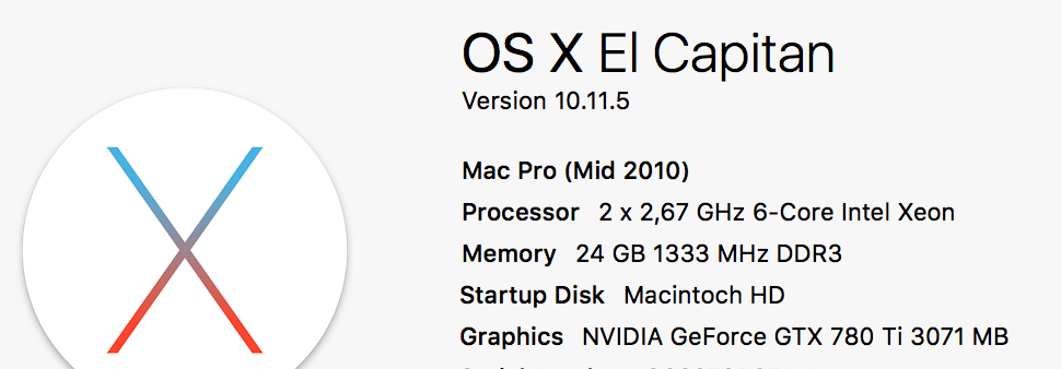

I just finished my installation guid for Z800 with BIOS 3.60 thanks to Rockey12
Feel free to test and validate if working for you.
My El Capitan installation procedure for Z800 with BIOS 3.60
HW Specification :
HP Z800  with BIOS version : 3.60
CPU: x2 6-core X5650 @ 2.67 GHz
RAM: 24 GB
GFX:  EVGA GeForce GTX 780 Ti, 3GB, 3072MB,GDDR5 384bit
SSD: 256 GB  SSD: CrosAir Force GT
Monitor: Samsung 4K, 3840 x 2160 Resolution (UHD)

  • Boot on USB, Install El Capitan, Reboot using the USB but this time choose the HDD with newly installed El Capitan
  • Install Clover to your HDD El Capitan partition, same as before
  • Mount USB 10.11 INSTALLER’s EFI partition and copy the EFI folder to your desktop, un-mount when done
  • Now mount the HDD El Capitan EFI partition and copy the EFI folder from your desktop to mounted EFI partition "EFI/"
  • Install this Kexts using Kext Utility "AppleHDA  & CodecCommander.kext"
  • Install nVidia drivers
  • Reboot without the USB and all should be working except for graphics and the wrong amount of RAM
  • Start Clover configurator and first go to "BOOT"  and uncheck “nv_disable=1” and check “nvda_drv=1” next go to "SMBIOS" and manually add the memory setup of your RAM by adding each slot and memory HW spec.
  • Reboot and now all should be working…

It's working now :) , and it seams much better, I would say the sound is perfect.
Reason it did not work before is simply becous I placed the Kexts in the EFI partition.
Thanks again, I'll continue testing and improving the installation, and I probably will be back with more questions :-)

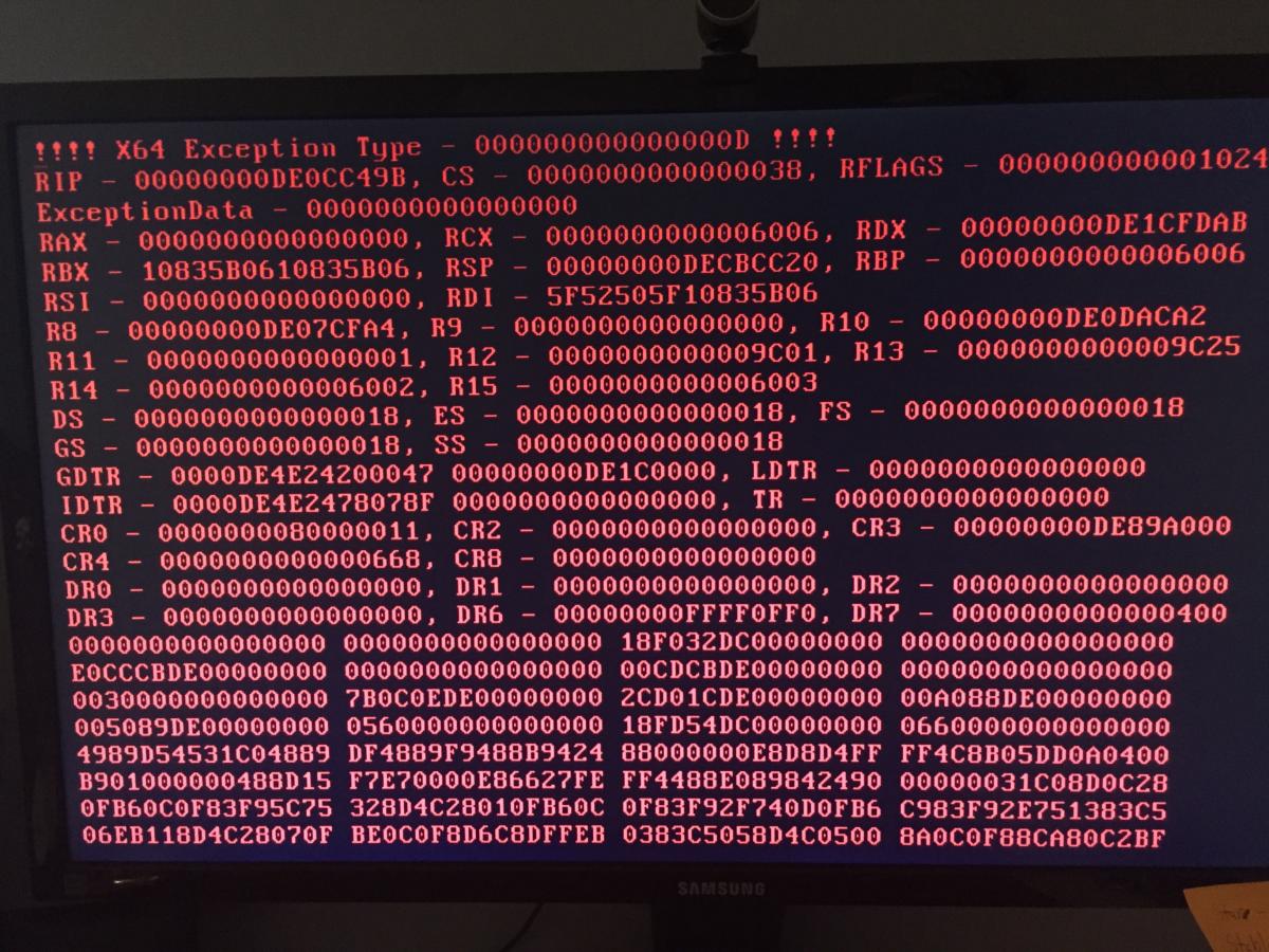

Will someone take a look at this log and let me know why my installation always fails under my Z400. This is the second Z400, the one i purchased a few weeks back at a thrift store for $25.
Try trust  no smbios
<key>SMBIOS</key>
<dict>
<key>Trust</key>
<false/>
</dict>
