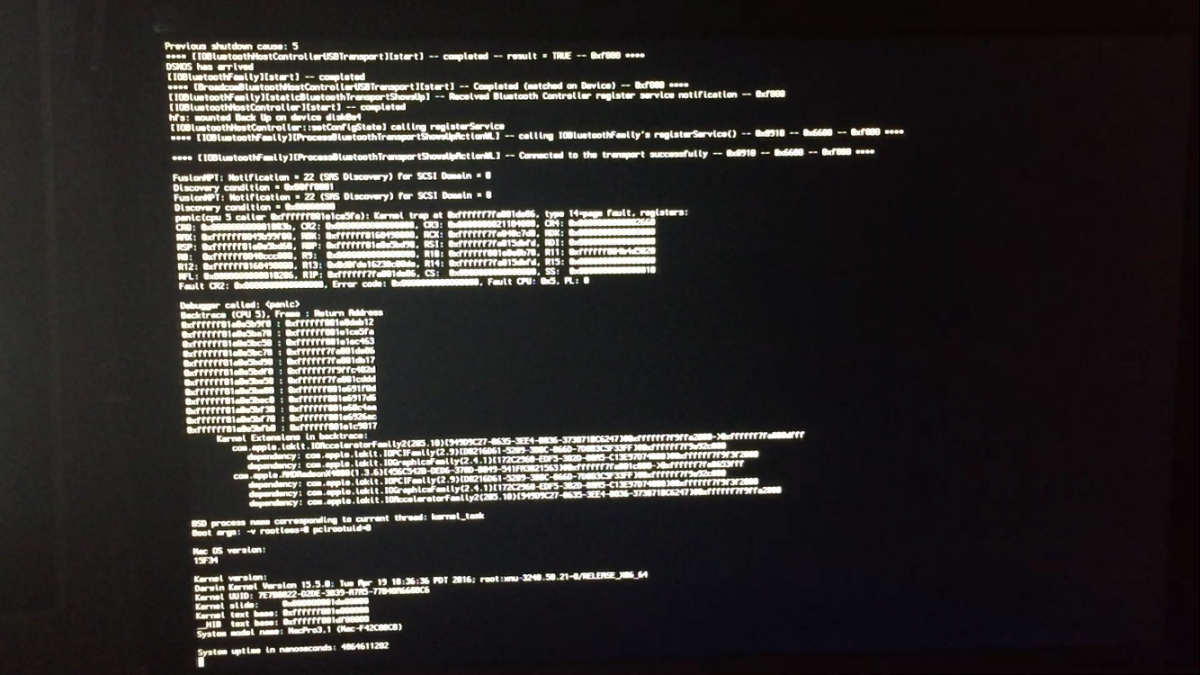

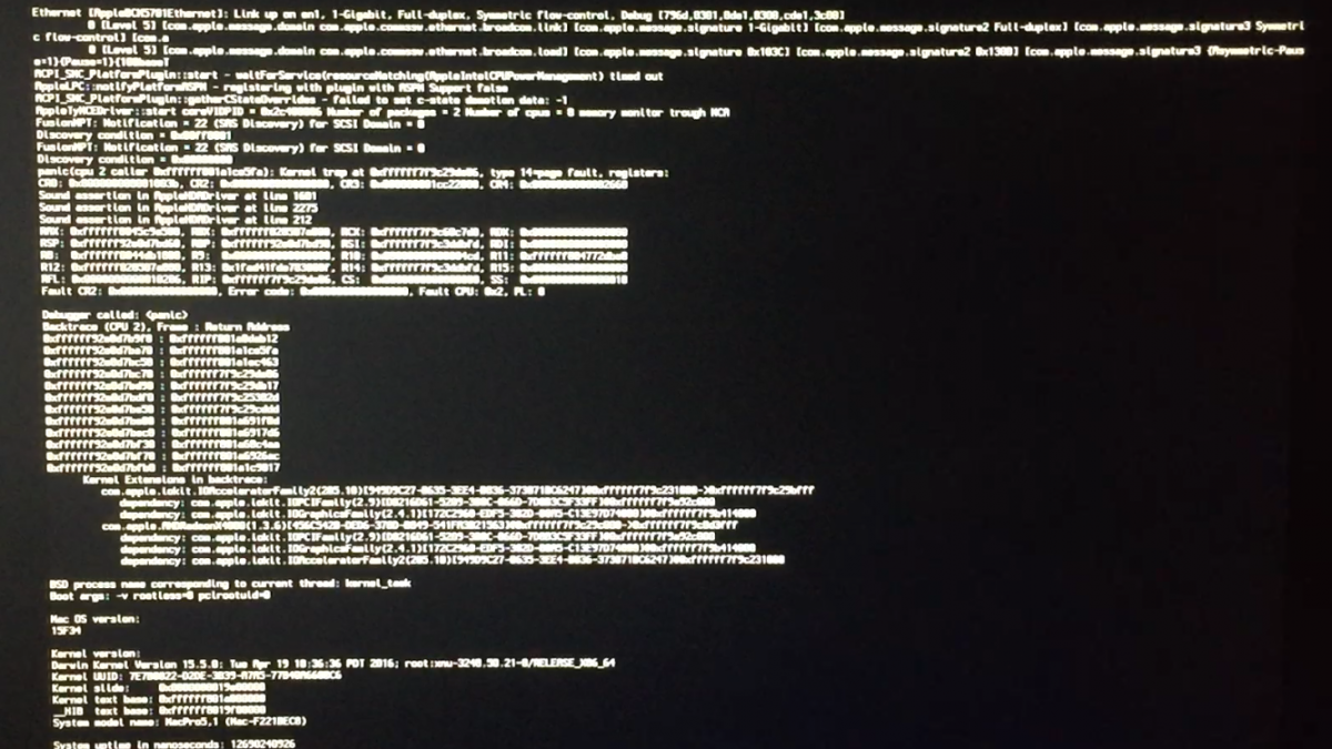

New dsdt and config.plist kext panic.

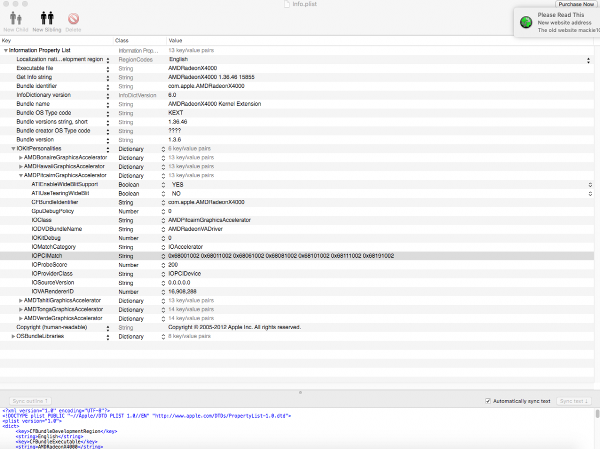

if i don't patch AMDRadeonX4000, I can boot OS X but Video Card still 6mb VRAM~ otherwise I have to use safe mode to boot into OS X  (same video not working correct).

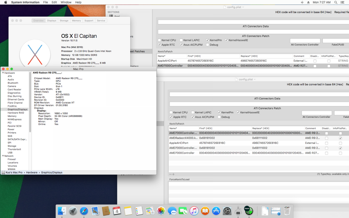

Test1: Still the same.
(new dsdt, config.plist, AMD7000Controller,AMDRadeonX4000 + 0x68111002)
Test2: Stock at apple loading screen not moving (wait 30m still not load anything), safe mode boot into OS X but video card still show 5mb VRAM.
(new dsdt, config.plist, AMD5000Controller, AMDRadeonX3000)

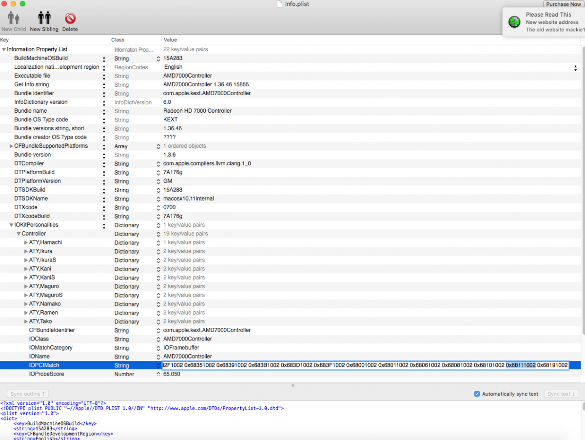

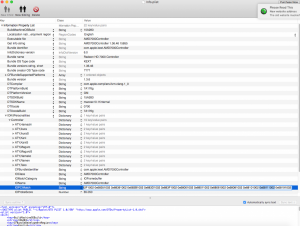

this app just patch the AMD7000Controller you have to manually add the dsdt patch

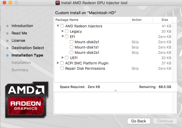

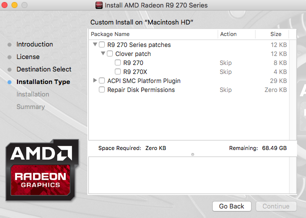

I guess I'm lost..... So I have to
use your dsdt and config.plist also v1.1 pkg + manually insert device id number 0x68111002
or Just dsdt, config.plist and insert device id to amd7000controller + AMDRadeonX4000 ?
http://www.insanelymac.com/forum/topic/294315-radeon-r9-270x-framebuffer-issue/
Here say "for those who prefer to use DSDT injector" which those dsdt your send to me follower by this one~
so only need insert device id
otherwise, I will need run the pkg and insert device id.

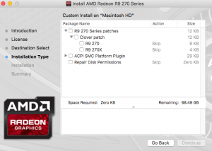

I try the pkg first before you help me edit dsdt and it has white screen.

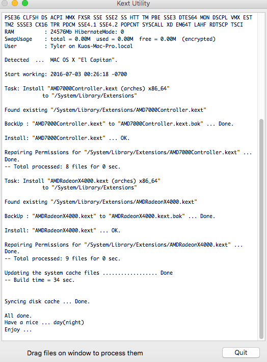

this app patch the Radeon R9 270 framebuffer first you have to run the app to patch framebuffer
after patching copy the both of kext to your Desktop and add the dveice id into both kext reinstall that,s all

Boot into OS X ~ Video car still 6mb
:) at less no more panic on X4000.kext.
By the way~ the V1.1 pkg patch very different code then the one you have in there on config.plist file
