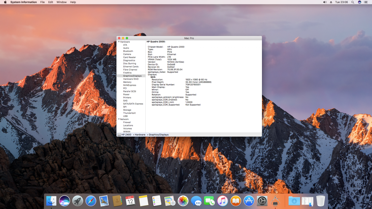

THEOLDSHARK Posted July 13, 2016 Share Posted July 13, 2016 Well, this is my config.plist at the moment; it works with El Capitan 10.11.5 and macOS Sierra DP1 ... I think it supports the Nvidia Quadro 2000 quite well. I use also patched DSDT and SSDT, stepping and sleep seem to be OK (not sure about turbo boost) but still some usual ;-) minor USB issues. config.plist.zip 2 Link to comment https://www.insanelymac.com/forum/topic/307064-hp-z400z600z800-workstations-os-x-1010x1011x-installation/page/21/#findComment-2252293 Share on other sites More sharing options...

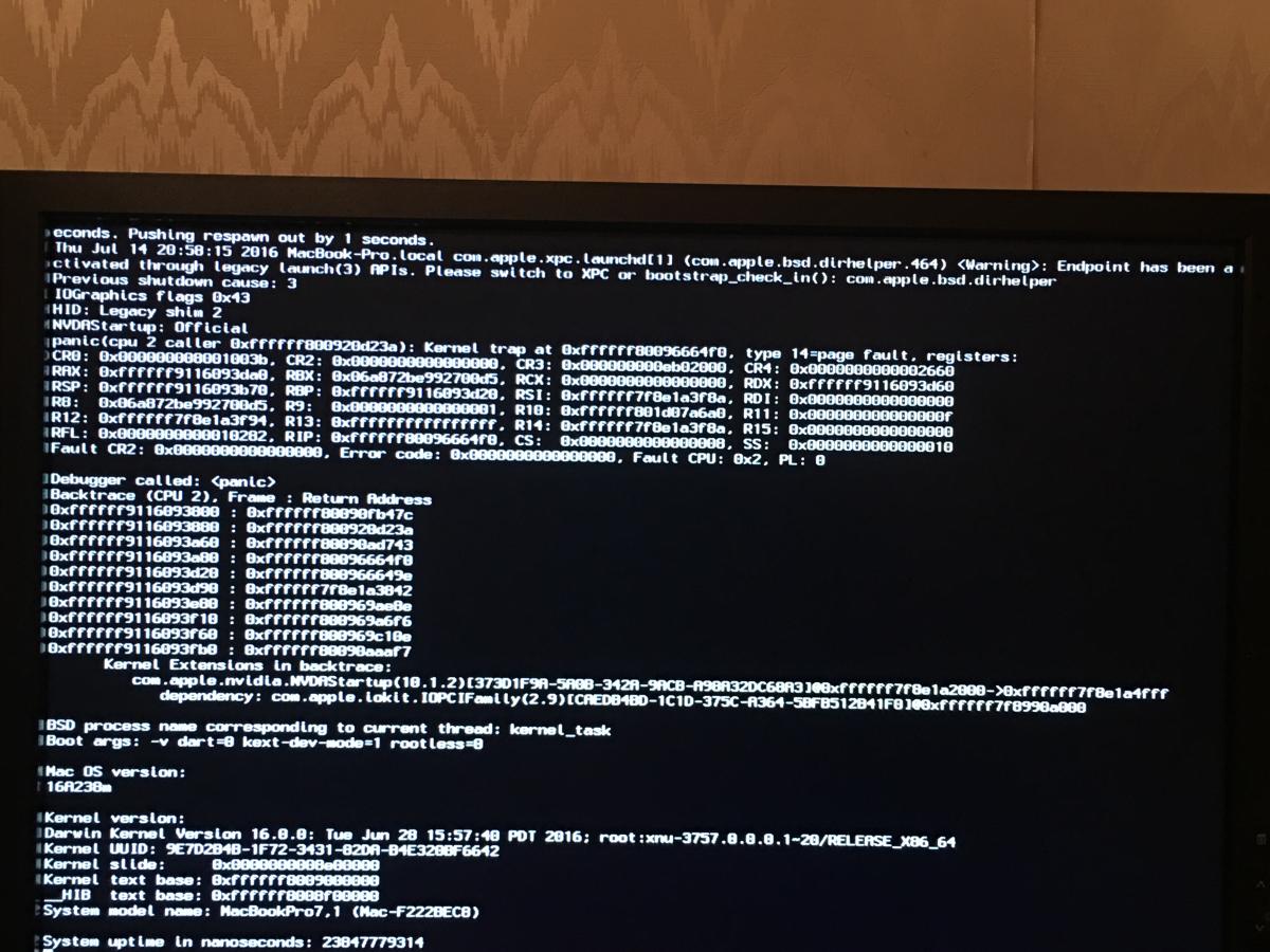

Blaggah Posted July 15, 2016 Share Posted July 15, 2016 This is my kp on the z400 even after changing the smbios to Macbook Pro 7,1 las suggested. 1 Link to comment https://www.insanelymac.com/forum/topic/307064-hp-z400z600z800-workstations-os-x-1010x1011x-installation/page/21/#findComment-2252938 Share on other sites More sharing options...
jaymack Posted July 15, 2016 Share Posted July 15, 2016 Your kp is graphics related try with different gpu,s I agree try a graphics card that is fully compatible. There are many. 1 Link to comment https://www.insanelymac.com/forum/topic/307064-hp-z400z600z800-workstations-os-x-1010x1011x-installation/page/21/#findComment-2253084 Share on other sites More sharing options...
Blaggah Posted July 15, 2016 Share Posted July 15, 2016 OK great to meet know. Will an older model nvidia work for instance GT210, 420, 610, 640 etc..? Link to comment https://www.insanelymac.com/forum/topic/307064-hp-z400z600z800-workstations-os-x-1010x1011x-installation/page/21/#findComment-2253106 Share on other sites More sharing options...

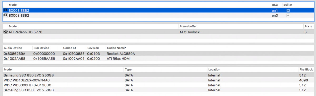

MacPeet Posted July 17, 2016 Share Posted July 17, 2016 Just for comparison of my original HD5770 (miniDP/miniDP/DDVI) in real MacPro. Perhaps some entries help for your DSDT. propertiesHD5770.plist.zip 1 Link to comment https://www.insanelymac.com/forum/topic/307064-hp-z400z600z800-workstations-os-x-1010x1011x-installation/page/21/#findComment-2253711 Share on other sites More sharing options...
MacPeet Posted July 17, 2016 Share Posted July 17, 2016 even on the real Mac Pro with HD 5770 operates HDMI not natively HDMI audio works on the Pro with: HDMIAudio.kext.zip 1 Link to comment https://www.insanelymac.com/forum/topic/307064-hp-z400z600z800-workstations-os-x-1010x1011x-installation/page/21/#findComment-2253858 Share on other sites More sharing options...
MacPeet Posted July 18, 2016 Share Posted July 18, 2016 Example for you: Device (PEGP) //or PEG0 { Name (_ADR, 0x00010000) //or 20000 or 30000 Name (_PRW, Package (0x02) { 0x09, 0x05 }) Device (GFX0) { Name (_ADR, Zero) Name (_SUN, One) Method (_DSM, 4, NotSerialized) { Store (Package (0x0C) { "@0,name", Buffer (0x0B) { "ATY,Vervet" }, //Your other items "@1,name", Buffer (0x0B) { "ATY,Vervet" }, //Your other items "@2,name", Buffer (0x0B) { "ATY,Vervet" }, //Your other items "@3,name", Buffer (0x0B) { "ATY,Vervet" }, //Your other items "model", Buffer (0x13) { "ATI Radeon HD 5770" }, "hda-gfx", Buffer (0x0A) { "onboard-1" } }, Local0) DTGP (Arg0, Arg1, Arg2, Arg3, RefOf (Local0)) Return (Local0) } } Device (HDAU) { Name (_ADR, One) Method (_DSM, 4, NotSerialized) { Store (Package (0x02) { "hda-gfx", Buffer (0x0A) { "onboard-1" } }, Local0) DTGP (Arg0, Arg1, Arg2, Arg3, RefOf (Local0)) Return (Local0) } } } Link to comment https://www.insanelymac.com/forum/topic/307064-hp-z400z600z800-workstations-os-x-1010x1011x-installation/page/21/#findComment-2254203 Share on other sites More sharing options...

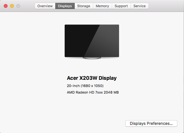

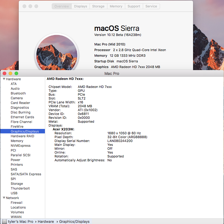

tyler2016 Posted July 18, 2016 Share Posted July 18, 2016 AMD Framebuffer Patching Utility https://www.maoshu.cc/Framebuffer-amd-all.html https://github.com/JogleLew/amd-framebuffer-utility http://bbs.pcbeta.com.espacesuite.com/viewthread-1608818-1-1.html Same as Vlada's guide only they make it utility tool? Link to comment https://www.insanelymac.com/forum/topic/307064-hp-z400z600z800-workstations-os-x-1010x1011x-installation/page/21/#findComment-2254473 Share on other sites More sharing options...

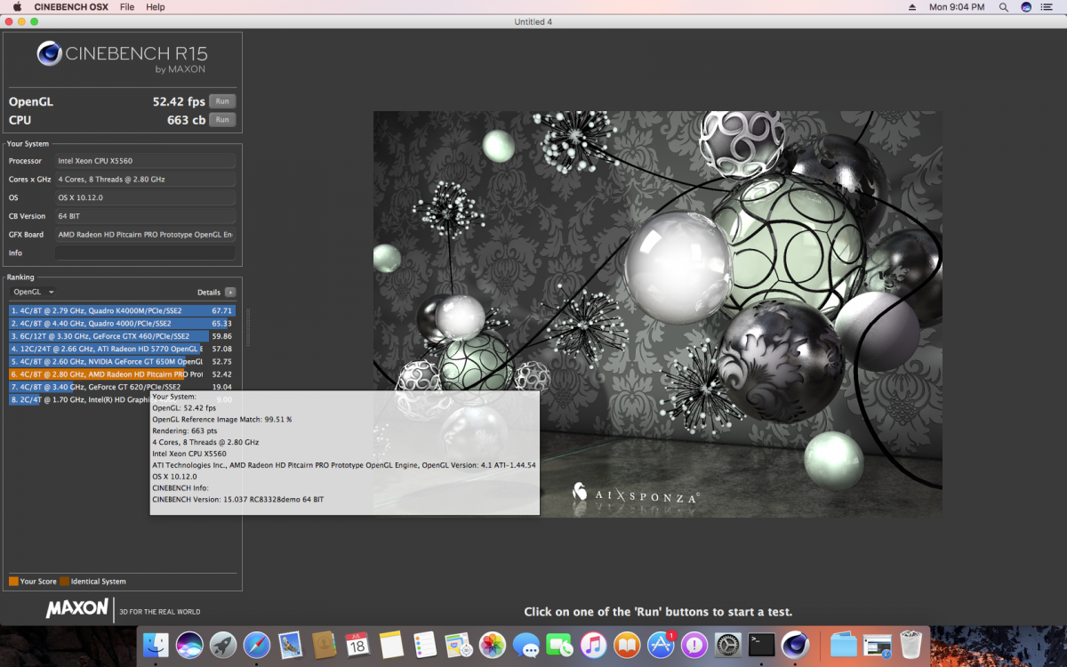

tyler2016 Posted July 19, 2016 Share Posted July 19, 2016 I think I got the r9 270 working.... But don't know how lol Let me run some test and see if it's fully working or not So it did work (one time)~ after reboot i can't get it back to work again...... testing show that openGL run lower then HD 5770 ~ lol Link to comment https://www.insanelymac.com/forum/topic/307064-hp-z400z600z800-workstations-os-x-1010x1011x-installation/page/21/#findComment-2254527 Share on other sites More sharing options...
MacPeet Posted July 19, 2016 Share Posted July 19, 2016 @tyler2016 incorrect settings? incorrect framebuffer? @Rockey12 You need not change the DSDT when the HD 5770 performs well. The data are for information purposes only. if then here, I think: Device (SLT2) { Name (_ADR, Zero) // _ADR: Address Name (_SUN, 0x02) // _SUN: Slot User Number Method (_DSM, 4, NotSerialized) { Store (Package (0x0C) { "@0,name", Buffer (0x0B) { "ATY,Vervet" }, //Your other items "@1,name", Buffer (0x0B) { "ATY,Vervet" }, //Your other items "@2,name", Buffer (0x0B) { "ATY,Vervet" }, //Your other items "@3,name", Buffer (0x0B) { "ATY,Vervet" }, //Your other items "model", Buffer (0x13) { "ATI Radeon HD 5770" }, "hda-gfx", Buffer (0x0A) { "onboard-1" } }, Local0) DTGP (Arg0, Arg1, Arg2, Arg3, RefOf (Local0)) Return (Local0) } } Device (HDAU) { Name (_ADR, One) Method (_DSM, 4, NotSerialized) { Store (Package (0x02) { "hda-gfx", Buffer (0x0A) { "onboard-1" } }, Local0) DTGP (Arg0, Arg1, Arg2, Arg3, RefOf (Local0)) Return (Local0) } } 1 Link to comment https://www.insanelymac.com/forum/topic/307064-hp-z400z600z800-workstations-os-x-1010x1011x-installation/page/21/#findComment-2254795 Share on other sites More sharing options...
