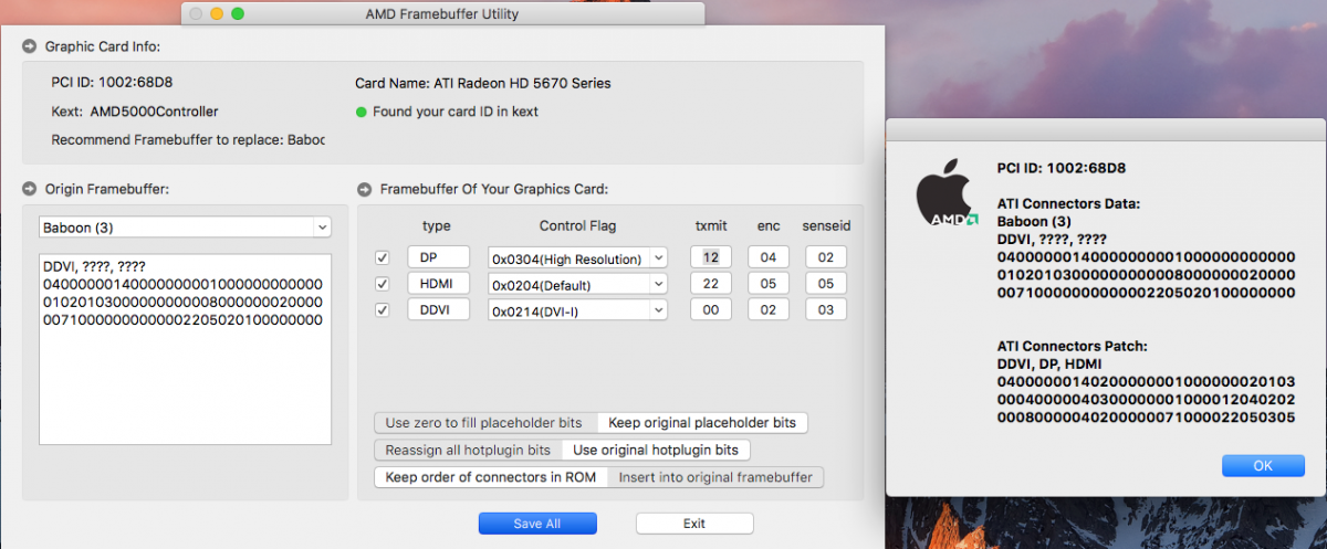

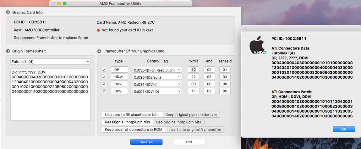

ok run this AMD Framebuffer Utility on your both Graphics Card and make 2 different Screen Shots where the AMD Framebuffer Utility show you the orignal Framebuffer and the patched and then atteched the both imeges and your Config.plist
Rockey: Here is all the files. Thank you.
On the R9 270 ~ I did add 0x68111002 to both AMD7000/4000kext for test and it didn't work.
even try 0x68101002 as FakeID still the same.

Update
What I found out was.........
Sapphire Radeon R9 270 Dual-x OC 2GB
1. Connector is 5 not 4 (even only 4 on the video card and AMD Framebuffer Utility show 4 too)
2. Framebuffer (need start testing all other 5 connector Framebuffer?)
3. Both DVI and HDMI must be connect in order to pass the flick white screen
4. InjectEDID=no InjectATI=no LoadVideoBios=no FakeID=0x0 (Support out the box?)
5. Add 0x68111002 to both AMD7000Controller and AMDRadeonX4000
This does not work on El Capitan! only Sierra.........

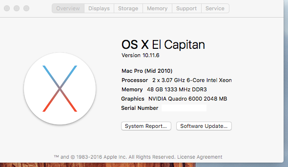

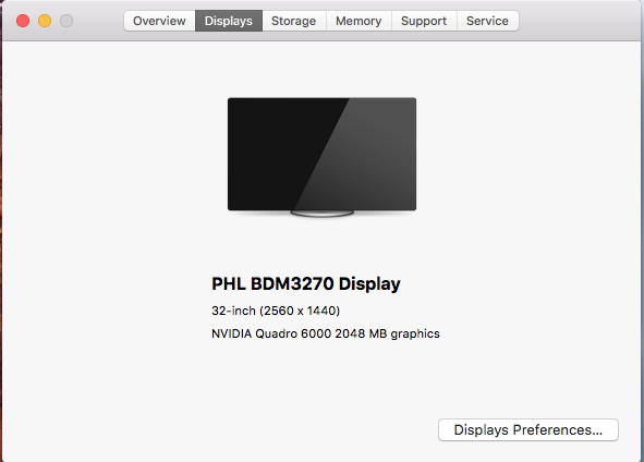

Video Card Fun (6 hours of my life gone):
1. I installed the latest web drivers, removed the nv_diable=1 flag and rebooted back into ElCap with Gt710 card. Still glitchy, but I will figure it out.
2. Not working with the nvda_drv=1 with Quadro 6000 with Webdrivers or CUDA 10.11.6 version, (works with other Nvidia cards I have).
3. Inject EDID, Inject Nvidia, working with the nvda_drv=1 with Quadro 6000 on CUDA 10.11.6 version driver :)
mmm 2560x1440 is back! :P
Probably still need to used Clover config etc to make it all work and I will need my DSDT file to be tweaked to suit my machines spec as only showing 48GB ram etc
(maybe if i ask Rockey12 nicely he can help me with that? :thumbsup_anim:  )
