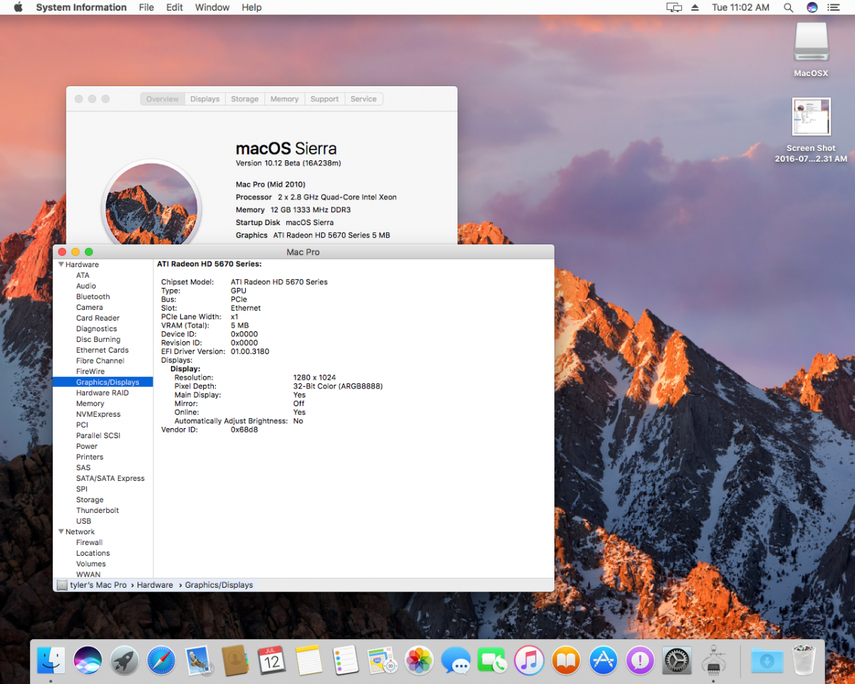

tyler2016 Posted July 10, 2016 Share Posted July 10, 2016 Updated mac OS Sierra DP2 But this time the winner is ATI Radeon HD 5770 any of my nvidia card are not working with dp2 but I can say with ATI the system is very stable and fast Does ATI card support out of box? Maybe will be easy for me just move on to sierra to get my R9 270 work right Link to comment https://www.insanelymac.com/forum/topic/307064-hp-z400z600z800-workstations-os-x-1010x1011x-installation/page/20/#findComment-2250768 Share on other sites More sharing options...

tyler2016 Posted July 12, 2016 Share Posted July 12, 2016 XFX ATI Radeon HD 5670 has better chance to work you can give a try The AppleHDA is working 2 with Sierra dp2 just for info i'm using all the same kext which i always used for el capitan i have only injected the ATI to config.plist. only -v as Boot args use the latest clover version otherwise it will not working v2.3k r3602 Try install sierra dp2 today~ video still 5mb @@ lol. Maybe the dsdt has issue ? Same kext, config.plist and dsdt clover v2.3k r3607 ----------------------------------------------------------------- Update: XFX 5670 have to boot with safe mode otherwise will stop at apple screen( Graphics still 5mb VRM only). R9 270 can boot in without safe mode~ ( Graphics still 5mb VRM only) Boot flag : -v BIOS:3.6 ( default @@ work lol) Clover:v2.3k r3607 2 Link to comment https://www.insanelymac.com/forum/topic/307064-hp-z400z600z800-workstations-os-x-1010x1011x-installation/page/20/#findComment-2251716 Share on other sites More sharing options...
