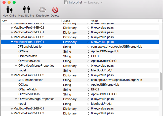

Did you remove the port restriction for your smbios in info.plist? Send me your kext. What is your smbios?

Your USB device in DSDT is named XHC, so there is no port restriction, because by default Apple uses IONameMatch XHC1. However, Apple limits number of ports to 15, so only some first ports are recognized. You have to enable port restriction by renaming XHC in DSDT to XHC1 OR change IONameMatch in the dummy kext to XHC (Why do you change IONameMatch to 8C31 is out of my understanding), then add only valid ports to the dummy kext.

I also removed the port restriction in the info.plist ( IOProviderMergeProperties is empty)
 Ok i have misunderstood something. I will try to change change XHC1 to XHC in the dummy.

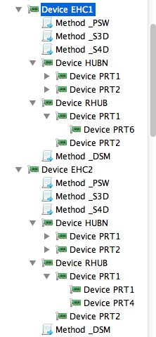

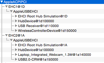

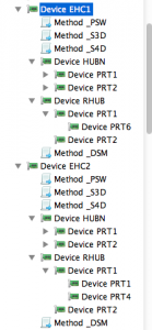

Based on your Ioreg, El Capitan couldn't detect PRT1 and PRT2 from your DSDT. I think the problem is that you have both HUBN and RHUB in EHC1/EHC2 (My DSDT only has RHUB).
On your Yosemite ioreg, your USB is: EHC1/2 (1d000000) > HUB (1d100000) > port (1d160000)
Try adding HUBN, UsbConnector=0, port = 01000000 to your EHC1/EHC2 device, and post ioreg again.

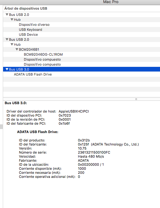

When I originally tried booting El Cap on my Samsung laptop (with 7-series USB) it kernel panicked with USB errors. So after doing some reading earlier I removed all the USB-related DSDT edits and tried again. This time it worked perfectly.
All ports work (2x 2.0 and 2x 3.0) however everything gets listed in System Profiler under the USB 3.0 bus. I'm not sure if this is right. There is a USB 2.0 entry (2 in fact although the other is for the internal stuff like webcam and card reader). Looking at the IORegistry when connecting devices, everything happens under XHC and the devices connect to HSPx or SSPx depending on whether they're 2.0 or 3.0. I didn't pay this much attention to how USB worked when I ran Yosemite with the multiplex patch so I'm curious if this sounds like correct behaviour? Either way, I'm happy to have all ports working with no (apparent) need for the multiplex patch.
however everything gets listed in System Profiler under the USB 3.0 bus.... Looking at the IORegistry when connecting devices, everything happens under XHC and the devices connect to HSPx or SSPx depending on whether they're 2.0 or 3.0.
That seems to be the new way, at least on the hacks I've tried. Seems no more multiplexing from XHC->EHC1 (although it can be forced).
There is nothing wrong with it since the XHC controller can handle both USB2(HS) and USB3(SS).

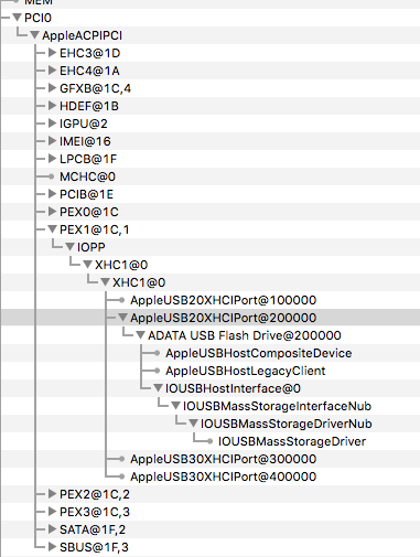

I can't make my Etron "EJ168" USB 3 ports work, everything looks fine on ioreg and system profile, any plugged device is recognized but they just don't work (USB3 pen drive isn't mounted, webcam isn't detected by FaceTime).
I've renamed the device XHC1 in my DSDT and have the USB 3 patches on KextsToPatch which worked fine in 10.10. Perhaps the patch needs to be updated?
It would be interesting if someone could post results (ioreg, System Information -> USB) from a real MacBookPro9,x which I think normally uses XCH->EHC1 multiplexing/passthru.

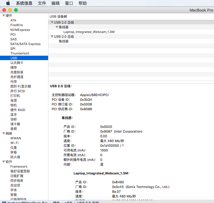

Thank you, I just remove the multiplex patch, and it does work on both 10.10 and 10.11. However I have to edit _PRW of EHC1, EHC2, XHC, LANC to get sleep work (similar to 8-series).
So what is the meaning of multiplex patch, is it used for 10.8?
