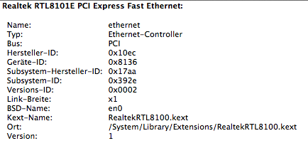

verleihnix Posted April 2, 2014 Share Posted April 2, 2014 Hello Mieze, great work so far. Looking a long time for a working driver. It's a Lenovo Lappy Z560 from my daughter running 10.9.2. The link is not coming up. See log. Last three lines will const. repeated. Ethernet [RealtekRTL8100]: Warning: PCIe ASPM enabled. Ethernet [RealtekRTL8100]: EEE support enabled. Ethernet [RealtekRTL8100]: TCP/IPv4 segmentation offload enabled. Ethernet [RealtekRTL8100]: TCP/IPv6 checksum offload enabled. Ethernet [RealtekRTL8100]: Using interrupt mitigate value 0x0. Ethernet [RealtekRTL8100]: RTL8103E: (Chipset 7) at 0xffffff807b336000, xx:xx:xx:xx:xx:xx Ethernet [RealtekRTL8100]: Link up on en0, 100-Megabit, Full-duplex, flow-control Ethernet [RealtekRTL8100]: Tx timeout. Lost interrupt? Ethernet [RealtekRTL8100]: Tx stalled? Resetting chipset. ISR=0xffff, IMR=0xffff. Ethernet [RealtekRTL8100]: Link up on en0, 100-Megabit, Full-duplex, flow-control Ethernet [RealtekRTL8100]: Tx timeout. Lost interrupt? Ethernet [RealtekRTL8100]: Tx stalled? Resetting chipset. ISR=0xffff, IMR=0xffff. Link to comment https://www.insanelymac.com/forum/topic/296190-driver-for-realteks-rtl810x-fast-ethernet-series/page/3/#findComment-2009291 Share on other sites More sharing options...
Mieze Posted April 2, 2014 Author Share Posted April 2, 2014 Hello Mieze, great work so far. Looking a long time for a working driver. It's a Lenovo Lappy Z560 from my daughter running 10.9.2. The link is not coming up. See log. Last three lines will const. repeated. Ethernet [RealtekRTL8100]: Warning: PCIe ASPM enabled. Ethernet [RealtekRTL8100]: EEE support enabled. Ethernet [RealtekRTL8100]: TCP/IPv4 segmentation offload enabled. Ethernet [RealtekRTL8100]: TCP/IPv6 checksum offload enabled. Ethernet [RealtekRTL8100]: Using interrupt mitigate value 0x0. Ethernet [RealtekRTL8100]: RTL8103E: (Chipset 7) at 0xffffff807b336000, xx:xx:xx:xx:xx:xx Ethernet [RealtekRTL8100]: Link up on en0, 100-Megabit, Full-duplex, flow-control Ethernet [RealtekRTL8100]: Tx timeout. Lost interrupt? Ethernet [RealtekRTL8100]: Tx stalled? Resetting chipset. ISR=0xffff, IMR=0xffff. Ethernet [RealtekRTL8100]: Link up on en0, 100-Megabit, Full-duplex, flow-control Ethernet [RealtekRTL8100]: Tx timeout. Lost interrupt? Ethernet [RealtekRTL8100]: Tx stalled? Resetting chipset. ISR=0xffff, IMR=0xffff. The link is up but the transmitter hangs, but this doesn't seem to be the reason which is causing the trouble. Please take a look at the line in the logs identifying the chipset and compare it with System Profiler's screenshoot. It says RTL8103E while the screenshot shows an RTL8101E. There must be something which is interfering. Have you removed any other driver for the NIC which you installed previously? Or have you modified the source in any way? Mieze Link to comment https://www.insanelymac.com/forum/topic/296190-driver-for-realteks-rtl810x-fast-ethernet-series/page/3/#findComment-2009294 Share on other sites More sharing options...

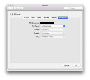

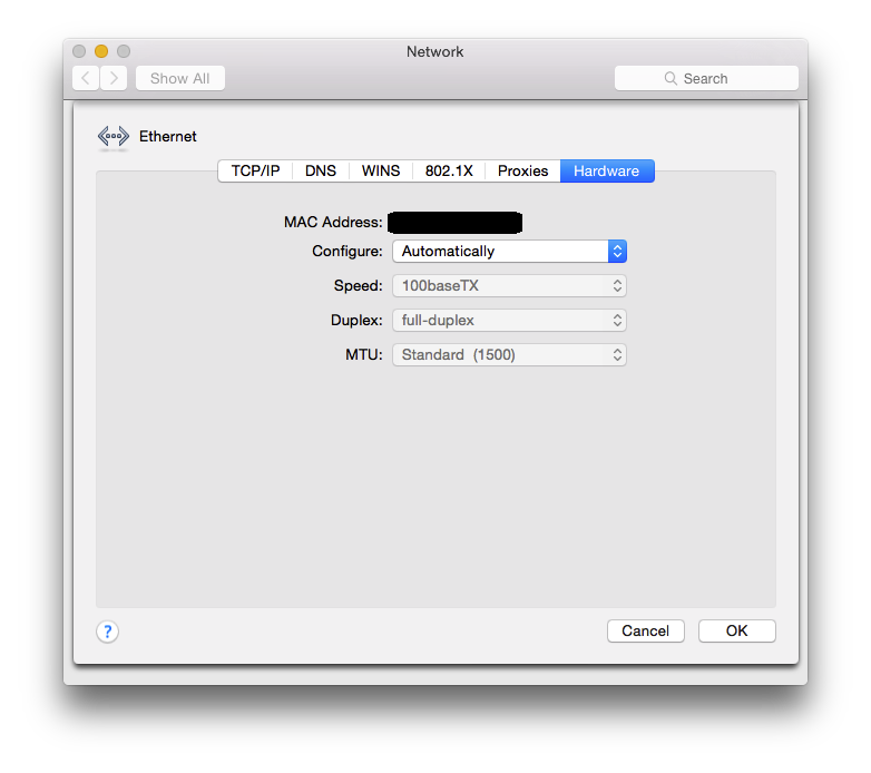

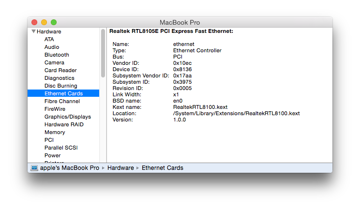

verleihnix Posted April 3, 2014 Share Posted April 3, 2014 The link is up but the transmitter hangs, but this doesn't seem to be the reason which is causing the trouble. Please take a look at the line in the logs identifying the chipset and compare it with System Profiler's screenshoot. It says RTL8103E while the screenshot shows an RTL8101E. There must be something which is interfering. Have you removed any other driver for the NIC which you installed previously? Or have you modified the source in any way? Mieze I had a not working kext installed to have an ethernet0. Removed that and installed yours a second time and deleted network.plist. Now it works! Great job! Thanks verleihnix Link to comment https://www.insanelymac.com/forum/topic/296190-driver-for-realteks-rtl810x-fast-ethernet-series/page/3/#findComment-2009623 Share on other sites More sharing options...
Mieze Posted April 3, 2014 Author Share Posted April 3, 2014 I had a not working kext installed to have an ethernet0. Removed that and installed yours a second time and deleted network.plist. Now it works! Great job! Thanks verleihnix Thanks for the information. Have fun! Mieze Link to comment https://www.insanelymac.com/forum/topic/296190-driver-for-realteks-rtl810x-fast-ethernet-series/page/3/#findComment-2009655 Share on other sites More sharing options...
