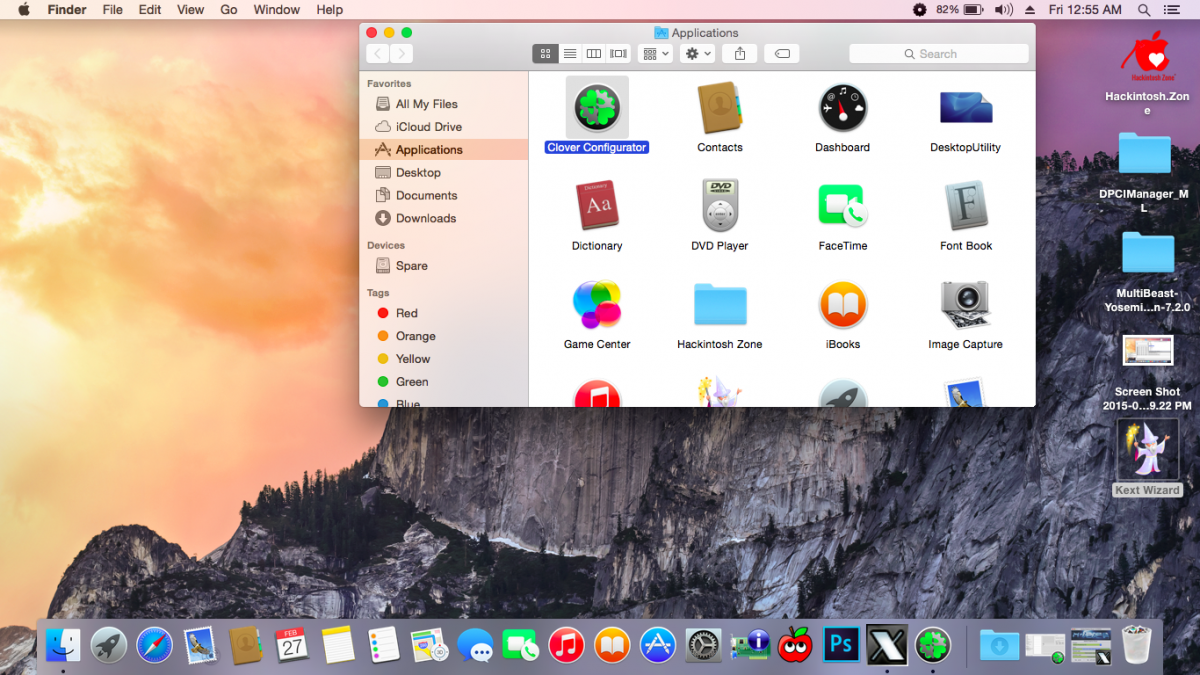

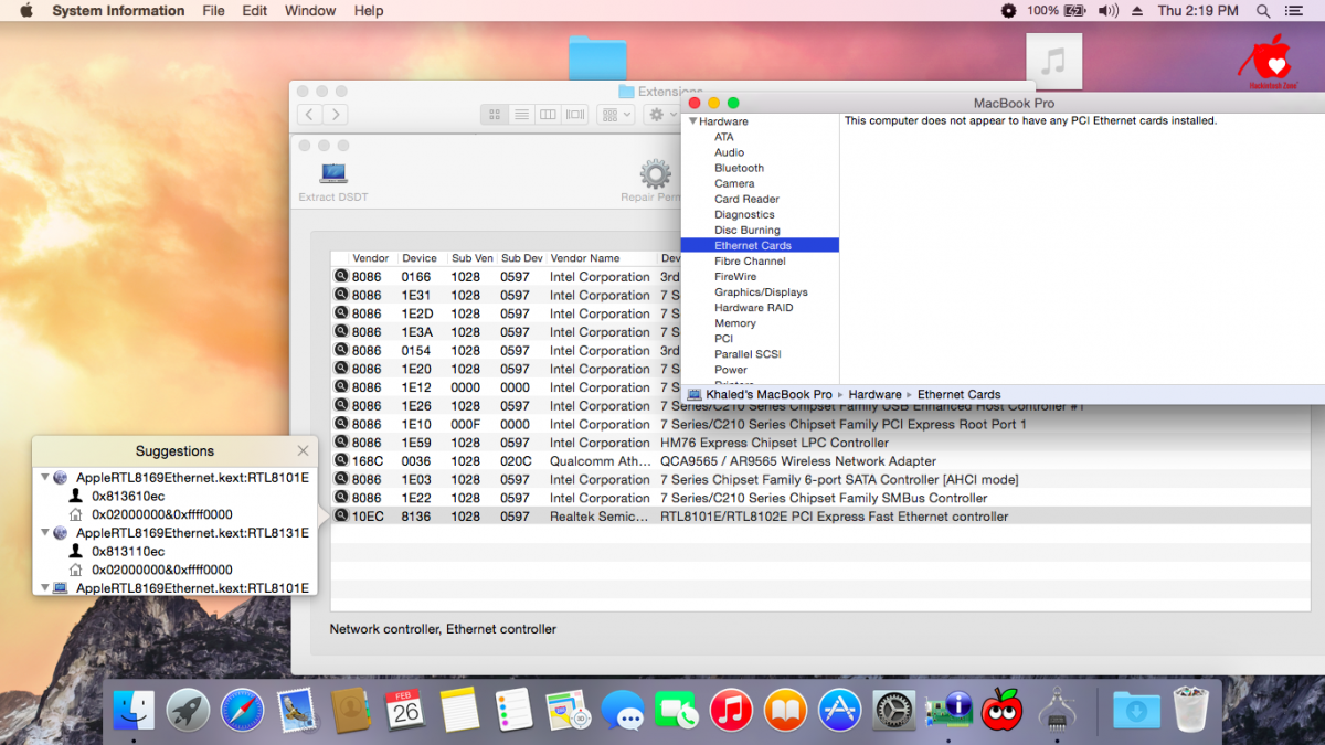

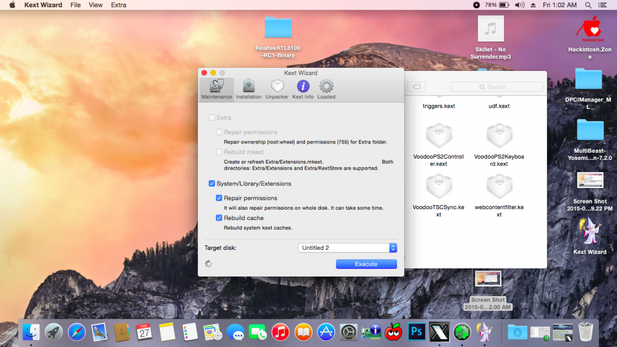

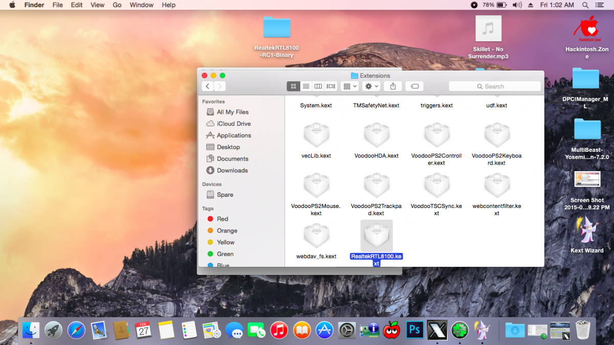

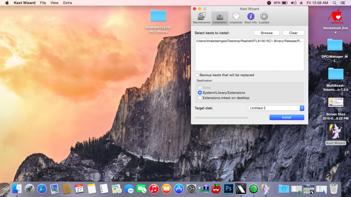

tifa621 Posted February 27, 2015 Share Posted February 27, 2015 please help ..idk why i'm the only one in this world still can't make my ethernet card works at all... check out my screen shot... also idk what to delete before i setup it and i use Kext Wizard tool to install it please help me Link to comment https://www.insanelymac.com/forum/topic/296190-driver-for-realteks-rtl810x-fast-ethernet-series/page/4/#findComment-2115893 Share on other sites More sharing options...
polyzargone Posted February 27, 2015 Share Posted February 27, 2015 What's your bootloader ? Where is installed the kext ? Check you don't have duplicate kexts in different places (ie. in S/L/E and E/E or EFI/Clover/kexts/10.10) To make sure the kext is correctly loaded, move it in S/L/E and delete all others instances in your setup. Make sure you use kext-dev-mode=1 boot-flag, rebuild kernelcache and reboot. Link to comment https://www.insanelymac.com/forum/topic/296190-driver-for-realteks-rtl810x-fast-ethernet-series/page/4/#findComment-2115900 Share on other sites More sharing options...
tifa621 Posted February 28, 2015 Share Posted February 28, 2015 my bootloader is Clover Configurator as it shows at the 1st picture and i setup the .kext file by Kext Wizard as it at the 2nd picture and i only delete the file which at S/ L/ E/ selected and reinstall it as it shown at the 3rd picture ...idk if there is anything else i should delete or not and i do repair permissions and Rebuild cache after i finish seting up the driver....or i have to do this before i setup it? sry if i'm talking too much because that's my 1st time ever with Mac system so idk ALOT about how to configure it. Link to comment https://www.insanelymac.com/forum/topic/296190-driver-for-realteks-rtl810x-fast-ethernet-series/page/4/#findComment-2116012 Share on other sites More sharing options...
