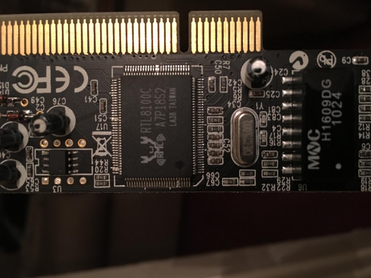

Blaggah Posted January 30, 2017 Share Posted January 30, 2017 I've been having a hard time getting this card to work. I installed the lnx2mac driver v 0.90 and nothing is showing under ethernet. Link to comment https://www.insanelymac.com/forum/topic/296190-driver-for-realteks-rtl810x-fast-ethernet-series/page/5/#findComment-2359802 Share on other sites More sharing options...
Mieze Posted February 1, 2017 Author Share Posted February 1, 2017 I've been having a hard time getting this card to work. I installed the lnx2mac driver v 0.90 and nothing is showing under ethernet. Unfortunately I can't help you as this is a PCI card but the driver only supports PCIe devices. Sorry! Mieze Link to comment https://www.insanelymac.com/forum/topic/296190-driver-for-realteks-rtl810x-fast-ethernet-series/page/5/#findComment-2360763 Share on other sites More sharing options...
