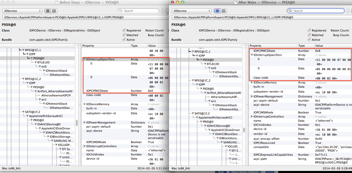

Mieze Posted February 28, 2014 Author Share Posted February 28, 2014 @lisai9093: I tried to find some background information about IOPCIPMCSState but found nothing. Therefore I checked this property of en0 on my 2011 iMac and it shows a similar behavior. IOPCIPMCSState changed from 0x0 before sleep to 0x2108 after wakeup. Mieze Link to comment https://www.insanelymac.com/forum/topic/296190-driver-for-realteks-rtl810x-fast-ethernet-series/page/2/#findComment-1998670 Share on other sites More sharing options...
lisai9093 Posted March 1, 2014 Share Posted March 1, 2014 @lisai9093: I tried to find some background information about IOPCIPMCSState but found nothing. Therefore I checked this property of en0 on my 2011 iMac and it shows a similar behavior. IOPCIPMCSState changed from 0x0 before sleep to 0x2108 after wakeup. Mieze uhmm that's strange. i also did some other test on ethernet setting that might be useful to you: i tried to play with DHCP in ethernet setting. Test after wakeup, if DHCP is enabled, the ethernet card cannot get IP address from my router, there is only self-assigned IP instead. Then I double checked my router site (192.168.0.1), under "device table" section where all devices and their IP listed. My machine's ethernet port is not in the list. So I disabled DHCP and assigned IP address myself in Setting. I put 192.168.0.14 as my IP because it is not used to prevent IP conflict. Then I saw this IP showing up in the "Device List". And the MAC address matches with my ethernet card's MAC address. Here is some log lines for one plug-in and out cycle: Feb 28 17:15:13 Mac kernel[0]: Ethernet [RealtekRTL8100]: Link up on en0, 100-Megabit, Full-duplex, No flow-control Feb 28 17:15:16 Mac.local configd[19]: network changed: v4(en0+:192.168.0.14, en1) DNS! Proxy! SMB Feb 28 17:15:18 Mac.local racoon[320]: failed to bind to address fd00::a9e:1ff:fe2b:b425[500] (Can't assign requested address). Feb 28 17:15:18 Mac.local racoon[320]: failed to bind to address fd00::a9e:1ff:fe2b:b425[500]: because interface address is/was not ready (flags 42). Feb 28 17:15:18 Mac.local racoon[320]: failed to bind to address fd00::a9e:1ff:fe2b:b425[4500] (Can't assign requested address). Feb 28 17:15:18 Mac.local racoon[320]: failed to bind to address fd00::a9e:1ff:fe2b:b425[4500]: because interface address is/was not ready (flags 42). Feb 28 17:15:18 Mac.local racoon[320]: failed to bind to address fd00::a9e:1ff:fe2b:b425[500] (Can't assign requested address). Feb 28 17:15:18 Mac.local racoon[320]: failed to bind to address fd00::a9e:1ff:fe2b:b425[500]: because interface address is/was not ready (flags 42). Feb 28 17:15:18 Mac.local racoon[320]: failed to bind to address fd00::a9e:1ff:fe2b:b425[4500] (Can't assign requested address). Feb 28 17:15:18 Mac.local racoon[320]: failed to bind to address fd00::a9e:1ff:fe2b:b425[4500]: because interface address is/was not ready (flags 42). Feb 28 17:15:18 Mac.local configd[19]: network changed: v4(en0:192.168.0.14, en1) DNS* Proxy SMB Feb 28 17:15:18 Mac.local racoon[320]: failed to bind to address fd00::a9e:1ff:fe2b:b425[500] (Can't assign requested address). Feb 28 17:15:18 Mac.local racoon[320]: failed to bind to address fd00::a9e:1ff:fe2b:b425[500]: because interface address is/was not ready (flags 42). Feb 28 17:15:18 Mac.local racoon[320]: failed to bind to address fd00::a9e:1ff:fe2b:b425[4500] (Can't assign requested address). Feb 28 17:15:18 Mac.local racoon[320]: failed to bind to address fd00::a9e:1ff:fe2b:b425[4500]: because interface address is/was not ready (flags 42). Feb 28 17:15:19 Mac.local configd[19]: network changed. Feb 28 17:15:23 Mac.local AirPlayUIAgent[876]: 2014-02-28 05:15:23.988534 PM [AirPlayUIAgent] Changed PIN pairing: no Feb 28 17:15:24 Mac.local AirPlayUIAgent[876]: 2014-02-28 05:15:24.038392 PM [AirPlayUIAgent] Changed PIN pairing: no Feb 28 17:15:24 Mac.local com.apple.WebKit.Networking[934]: tcp_connection_destination_prepare_complete 5769 connectx to 192.168.0.1#80 failed: 64 - Host is down Feb 28 17:15:24 Mac.local com.apple.WebKit.Networking[934]: tcp_connection_handle_destination_prepare_complete 5769 failed to connect Feb 28 17:15:24 Mac.local com.apple.WebKit.Networking[934]: tcp_connection_destination_prepare_complete 5769 connectx to 192.168.0.1#80 failed: 64 - Host is down Feb 28 17:15:24 Mac.local com.apple.WebKit.Networking[934]: tcp_connection_handle_destination_prepare_complete 5769 failed to connect Feb 28 17:15:40 Mac kernel[0]: Ethernet [RealtekRTL8100]: Link down on en0 Link to comment https://www.insanelymac.com/forum/topic/296190-driver-for-realteks-rtl810x-fast-ethernet-series/page/2/#findComment-1998680 Share on other sites More sharing options...
Mieze Posted March 1, 2014 Author Share Posted March 1, 2014 i tried to play with DHCP in ethernet setting. Test after wakeup, if DHCP is enabled, the ethernet card cannot get IP address from my router, there is only self-assigned IP instead. Then I double checked my router site (192.168.0.1), under "device table" section where all devices and their IP listed. My machine's ethernet port is not in the list. So I disabled DHCP and assigned IP address myself in Setting. I put 192.168.0.14 as my IP because it is not used to prevent IP conflict. Then I saw this IP showing up in the "Device List". And the MAC address matches with my ethernet card's MAC address. In the device table on the router? This would mean that after a wakeup packets are going out, i.e. the transmitter is working but the receiver isn't. Maybe I should check the receiver config for your chipset again. There might be a hidden error? Mieze Link to comment https://www.insanelymac.com/forum/topic/296190-driver-for-realteks-rtl810x-fast-ethernet-series/page/2/#findComment-1998682 Share on other sites More sharing options...
