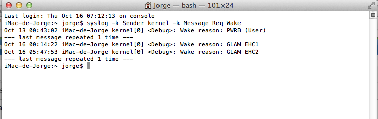

More personal one little problem, the pc keeps calling from nothing during sleep.
I ran this by eating at the terminal I saw on a forum:  "syslog -k Sender kernel -k Message Req Wake"
And he showed me this:
How do I solve this problem "Wake reason: GLAN EHC1" and "Wake reason: GLAN EHC2".
In CloverEFI, did not have this problem. The pc usually sleep without getting all the time calling.
I thank the help of friends.
Do you have External storage connected by USB? Does your bios have a setting for "Dynamic Storage"? If so make sure its checked as some external storage will not allow sleep

Check if you have Wake for Ethernet network Access checked in Energy Saver section of System Preferences and uncheck it.
Both the wake for network access and also bluetooth options are disabled. But still I am with this problem.
Sorry, I edited my post after you replied. EHC1/EHC2 means something connected to the USB controller is waking the system, this can be any device using this controller, USB storage just happens to be the most common factor.
This problem can also be fixed by having proper definitions for EHC* in dsdt.
Yes and in addition of that, with my latest Z87X-UD4H just added a patch for EHC* and xHC* with no kext worked Properly and natively!
You can check my DSDT? This is it: DSDT Jorge.zip
I applied the patch this site: http://pjalm.com/forums/index.php?topic=7.0
