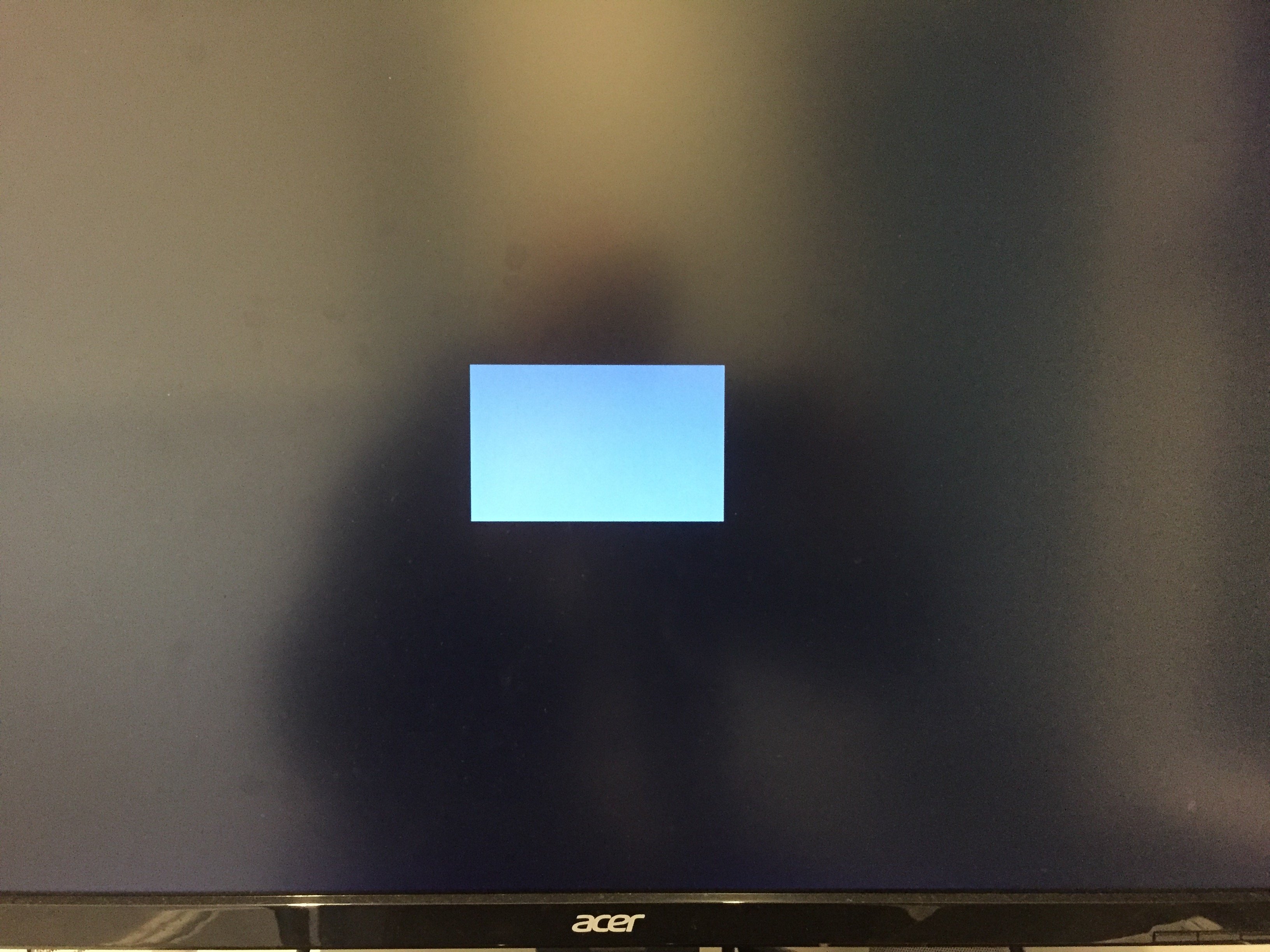

firefly_can_fly Posted May 11, 2018 Share Posted May 11, 2018 (edited) Well, changing the motherboard didn't do much, except I'm using clover as daily driver bootloader, but it's nothing near with Oz. With a new motherboard, I have all same symptoms. Currently using z97x-ud3h (v 1.1). Now I'm definitely out of options, so any ideas? *updt* here's the video of how it works, Oz not even loading: https://drive.google.com/open?id=1DXOqrx_Jmf4abYYbtsUF1aB5U8MZA-IV Edited May 11, 2018 by firefly_can_fly Link to comment Share on other sites More sharing options...

crusher Posted May 11, 2018 Share Posted May 11, 2018 first clean EFI partition and later back files or just boot via shell!!! Link to comment Share on other sites More sharing options...
firefly_can_fly Posted May 11, 2018 Share Posted May 11, 2018 The problem is, that shell ain't loading too. Just black screen and nothing. This is screens of bios settings: https://imgur.com/a/Kau87ck This is last iteration of rom I'm using: https://fex.net/796558355767?fileId=467933622 1 Link to comment Share on other sites More sharing options...

ammoune78 Posted May 11, 2018 Share Posted May 11, 2018 3 hours ago, firefly_can_fly said: This is screens of bios settings: https://imgur.com/a/Kau87ck Use IntelGraphicsFixup and NvidiaGraphicsFixup on common folder, and set all graphics disabling to OzDefaults to yes! Do CMOS reset Flash your mobo from windows, it appear that flash wasn't done 100% Disable CSM! On the third screen from up to down, set Windows features to: Other OS Cross your fingers and see if it work 1 Link to comment Share on other sites More sharing options...

firefly_can_fly Posted May 16, 2018 Share Posted May 16, 2018 (edited) Quote GRIVEN from hackintosh-forum.de gave and advice that I should fully disable IGPU and stick with Nvidia as main and only graphics on the system. So after a flash of BIOS, I neede to load and hit ESC to enter bios, disable IGPU and enable CSM (currently it's working only with ON, but it's only test run and I will tweak and polish this build) and whoop, it's loaded I want to say huge thanks to ammoune78 for mentoring and helping with basically everything, he's the guy who won't let you down and will patiently help understand bling gaps that occur in the process. Griven for this final tricks that were way beyond of understanding while I'm not to close familiar with Oz engine and why it's happening like that. Kynyo for advice about GPU and helping in moments when you f****up the boot system on couple SSD's and need quick kick while only thing to communicate right now is Skype. crusher. for helping to make first baby steps in Oz direction. All the community in this branch of the forum who help, maintain and breath life in Oz through the years. And last, but not least - to that guy who made it possible, TheKing . Years are passing from the moment you first thought about Oz and you with team released it, but, it still works. You have not the biggest but very devoted community. I don't know what kind of voodoo magic you practicing while there is no magic in this world, but this tiny thing you made and effort you put in - made it alive. Even me, I couldn't use another bootloader, because it's just not the same. I was searching used parts just to make it work with Oz. You made hack equal to a real Mac. Hope you would come back some day and give Oz another life. p.s. after config would be fully made to a state of "100%" i will post EFI folder and couple hints that made this build work. Edited May 16, 2018 by firefly_can_fly 1 2 Link to comment Share on other sites More sharing options...
