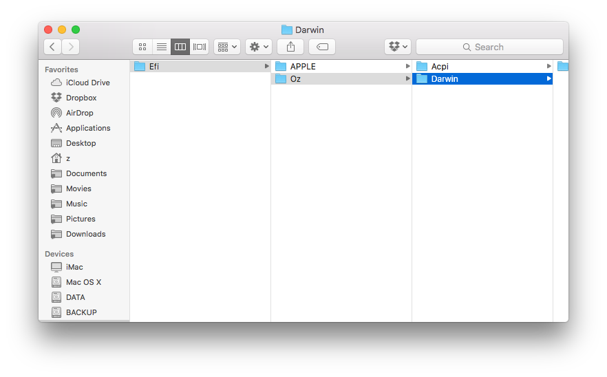

The weird thing is however, I don't have Defaults.plist in the Efi/Oz folder. How is that possible?
Okay, it turned out all the values were in the NVRAM, but no Defaults.plist file. I used a template to assign the values form the NVRAM.
Cheers.
Thank you for the input guys. The problem was with BaseBoardSerial, it was (null), so I fixed it by putting 5 random numbers after the System Serial number, and iMessage is working again :)
sudo nvram 4D1FDA02-38C7-4A6A-9CC6-4BCCA8B30102:BaseBoardSerial=XXXXXXXXXXXX(System Serial)XXXXX(five random numbers)
Cheers.
Lo,
Defaults.plist is in your bios. You can extract with UEFITools. Search for OzmosisDefault -> go into tree -> you'll see raw file -> extract body and save as Defaults.plist.
You can after put it in Oz Directory. and modify as you want to add keys i was talking a few post before.
