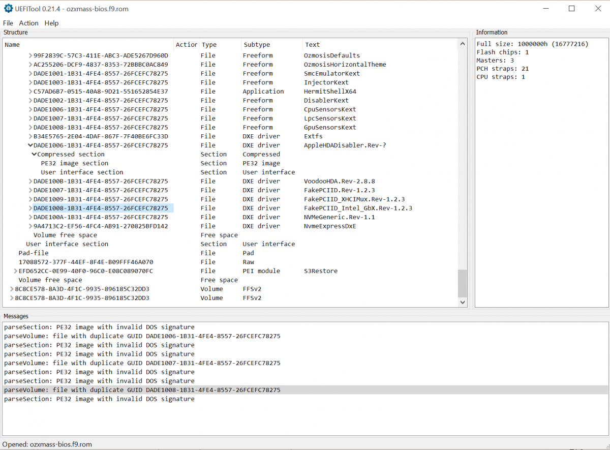

Thank you for the xmass present. I've been playing around with it and need help. Its probably something I did but I never could get the EDK Shell to load by clicking it  in the GUI (even the last oz version). Even with a 4 finger  reset. With  the last Oz release I could  hit 'F8' and get into the boot menu and select it but this time EDK shell selection gets ignored and the default OS loads. Was able to get into the shell on  the last oz release as it was on my other dual bios switch, upon which I hot switched back to new oz  release bios. Gigabyte dual bios lets you switch on the fly and I have 1669 on bios A and xmas Oz on Bios B. So once in a working shell I used BCFG to manually create boot entries to Hermit shell in the efi partition and even to my Ubuntu partition. Seems like xmass Oz  makes boot entries to Linux but selecting it did nothing but give some sort of weird reference ram error message. No problems with Windows or Captitan loading. Though my bcfg reference to the grubx64 file loaded up Ubuntu. Not sure what may be at fault?
Thanks

To all, before starting reporting "bugs" make sure you do your job proper first, and also do not "decide" by yourself what files are required or not.

I'm sorry. Was first attempt at injecting kexts. Thousand pardons. Will not happen again. Thank you King. Appreciate it from the bottom of my heart. Thank you.
Edit: I cleaned up the rom file and deleted all those  extra repeat guid kexts and reflashed. Still can't run Hermitshell. So I ran Darwin Dumper and attached the dump.
Thanks

Way better then before, still looks like you are the "duplicate master":
03:836 00:000 Validated Boot0005 "Built-In EDK Shell"
03:836 00:000  MemoryMapped(0xB,0xCCA2B004,0xCD8E0003)/FvFile(C57AD6B7-0515-40A8-9D21-551652854E37) (0x30)
03:836 00:000 Validated Boot0007 "Hermit Shell"
03:836 00:000  PciRoot(0x0)/Pci(0x1F,0x2)/Sata(0x0,0xFFFF,0x0)/HD(1,GPT,103924D6-0DB0-4FA7-9914-B51F3B59205F,0x28,0x64000)/\EFI\efis\HShell64.efi (0x7C)
If you expect to boot "Hermit Shell" using the UI button, it will not work, that is for the built-in EDK Shell(that is HermitShellX64 you added correctly in firmware), for your custom added boot-entries use motherboard built-in boot-manager F12 or whatever.
Having stuff like this:
12:312 00:000 Injecting AppleHDADisabler.kext "Driver-2B12000" 0x7A4C bytes
12:312 00:000 Injecting VoodooHDA.kext "Driver-2B1A000" 0x320B1 bytes
12:322 00:003 Injecting VoodooHDA "Driver-2BCB000" (0xA7A62000) 207748 bytes
Will cause only trouble, I don't see why you are loading AppleHDADisabler.kext and VoodooHDA.kext from ESP when you inject VoodooHDA from firmware.

To Fred,
Thank you for the new Kext2FFS command file. It worked perfectly and I the GUIDs were each unique and did not conflict with Oz modules. Also didn't get any errors from UEFITool either.
Way to go!

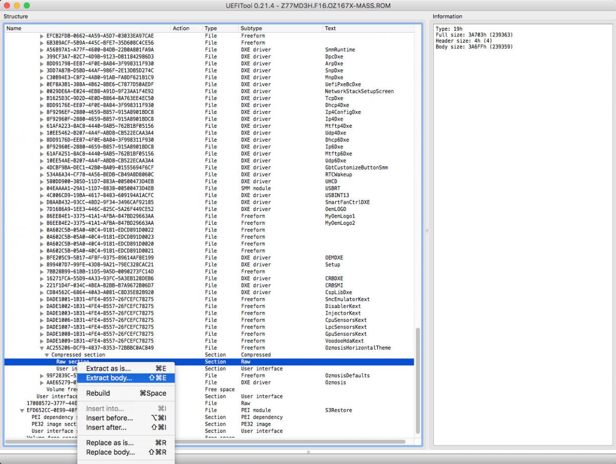

The theme file posted by Kynyo doesn't look right.
Open Z77MD3H.F16.OZ167X-MASS.ROM in Coderush's UEFITool. Locate OzmosisHorizontalTheme, expand the section then right-click on 'Raw section' and select 'Extract body' from the menu. Save as filename Theme.bin then place in EFI System Partition/EFI/Oz/
Thanks, this one worked for me. How to Extract/Load HermitShellX64 from ESP?
