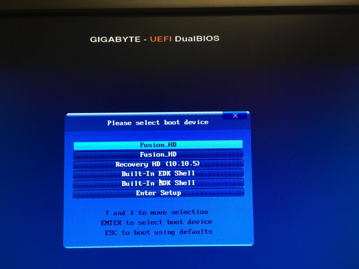

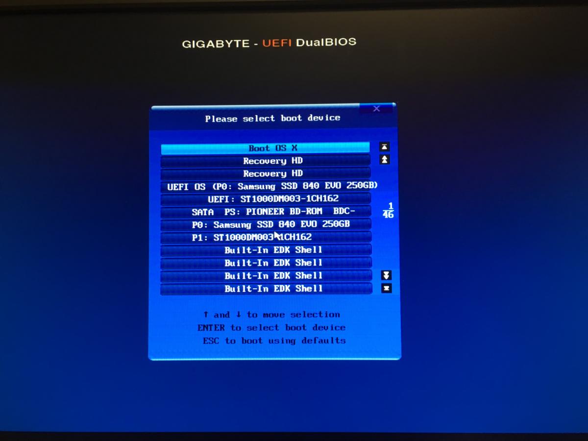

thank you for your input, but there seems to be a misunderstanding as to what I am trying to explain, so I will take 2 pictures to explain it.
IMG_4319 is 894M   ozmosis
IMG_4320 is 1699M ozmosis
As you can see, All the other drives are not visible. no DVD drives, no windows partitions nothing, even though P1 is a windows 7 Pro disk.
It has it's UEFI entry like it's s'posed to right under the P0 device, and with 894M it works correctly with the fusion drive, with 1699M is does not.
this is the BIOS boot list, not the hermit crab guy, so it should include ALL boot options...
HBP
1. In BIOS settings enable Legacy Boot.
2. READ THIS so you know what/how to setup your stuff especial this part:
DisableBootEntriesFilter || BOOLEAN || Disables filtering of firmware generated boot entries
By default Ozmosis remove all useless firmware boot entries c r a p.
