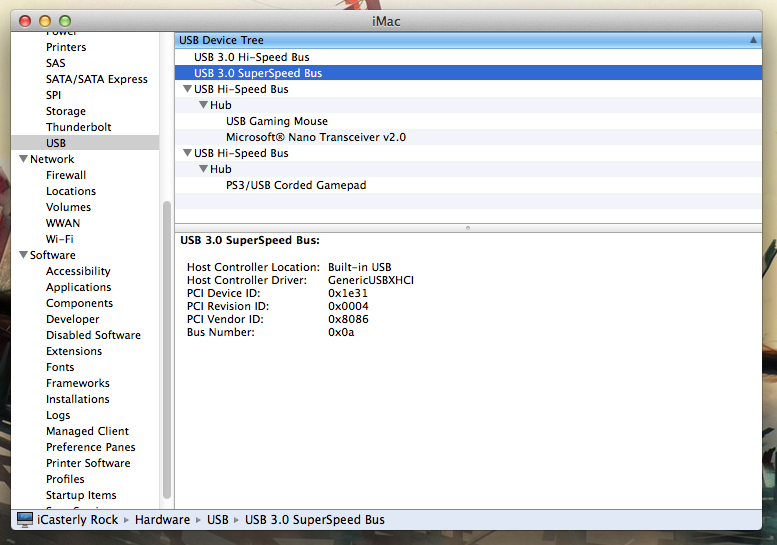

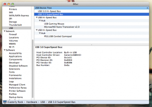

poispois Posted October 22, 2013 Share Posted October 22, 2013 Hi, I get this on my system profiler but the ports don't respond. What can it be? Link to comment https://www.insanelymac.com/forum/topic/286860-genericusbxhci-usb-30-driver-for-os-x-with-source/page/16/#findComment-1956861 Share on other sites More sharing options...

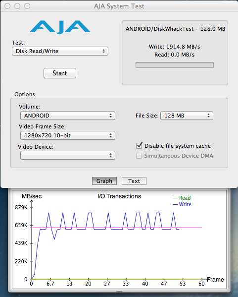

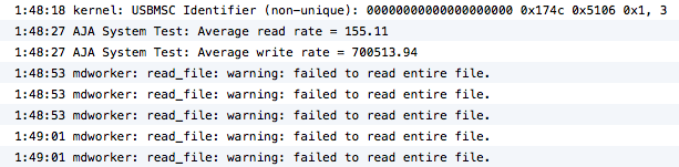

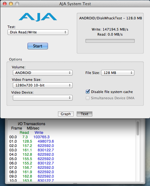

nikk Posted October 22, 2013 Share Posted October 22, 2013 Zenith432, today I tested GenericUSBXHCI.kext 1.2.6 with new ASMedia ASM1042 ExpressCard on MacBook Pro 17 OS X 10.8.5. There is some advantages and bugs between It and Renesas upd720202 one. Strange bug is: I use ASM1051E UAS enclosure with NTFS-formatted drive inside for test. Also, I have Paragon NTFS 10.1 driver installed (and can write to NTFS volumes). It works with both cards, but on USB 2.0 port or on USB 3.0 port on NEC ExpressCard no issues for now. If I connect this to ASM1042 ExpressCard, there is error in syslog and drive mounted readonly (uses Apple ro NTFS driver). So looks like it's GenericUSBXHCI + ASM1042 isssue (It have no error with NEC card). Under spoiler log with HDD attached to a) ASM1042 and NEC upd720202 USB 3.0 port: 23.10.13 1:41:33,000 kernel[0]: USBMSC Identifier (non-unique): 00000000000000000000 0x174c 0x5106 0x1, 3 23.10.13 1:41:37,619 ReportCrash[524]: DebugSymbols was unable to start a spotlight query: spotlight is not responding or disabled. 23.10.13 1:41:37,730 ReportCrash[524]: failed looking up LS service ( scCreateSystemService returned MACH_PORT_NULL, called from SetupCoreApplicationServicesCommunicationPort, so using client-side NULL calls. 23.10.13 1:41:37,730 ReportCrash[524]: LaunchServices/5123589: Unable to lookup coreservices session port for session 0x186a0 uid=0 euid=0 23.10.13 1:41:37,730 ReportCrash[524]: failed looking up LS service ( scCreateSystemService returned MACH_PORT_NULL, called from SetupCoreApplicationServicesCommunicationPort, so using client-side NULL calls. 23.10.13 1:41:37,731 ReportCrash[524]: LaunchServices/5123589: Unable to lookup coreservices session port for session 0x186a0 uid=0 euid=0 23.10.13 1:41:37,731 ReportCrash[524]: failed looking up LS service ( scCreateSystemService returned MACH_PORT_NULL, called from SetupCoreApplicationServicesCommunicationPort, so using client-side NULL calls. 23.10.13 1:41:37,731 ReportCrash[524]: LaunchServices/5123589: Unable to lookup coreservices session port for session 0x186a0 uid=0 euid=0 23.10.13 1:41:37,731 ReportCrash[524]: failed looking up LS service ( scCreateSystemService returned MACH_PORT_NULL, called from SetupCoreApplicationServicesCommunicationPort, so using client-side NULL calls. 23.10.13 1:41:37,731 ReportCrash[524]: LaunchServices/5123589: Unable to lookup coreservices session port for session 0x186a0 uid=0 euid=0 23.10.13 1:41:37,731 ReportCrash[524]: failed looking up LS service ( scCreateSystemService returned MACH_PORT_NULL, called from SetupCoreApplicationServicesCommunicationPort, so using client-side NULL calls. 23.10.13 1:41:37,731 ReportCrash[524]: LaunchServices/5123589: Unable to lookup coreservices session port for session 0x186a0 uid=0 euid=0 23.10.13 1:41:37,737 diskarbitrationd[22]: unable to probe /dev/disk1s1 (status code 0x0000000A). 23.10.13 1:41:37,793 ReportCrash[524]: Saved crash report for ufsd_NTFS.util[521] version ??? to /Library/Logs/DiagnosticReports/ufsd_NTFS.util_2013-10-23-014137_mbp17.crash 23.10.13 1:41:38,000 kernel[0]: NTFS volume name VIDEO-NTFS, version 3.1. 23.10.13 1:42:31,452 CVMServer[85]: Check-in to the service com.apple.cvmsCompAgent_x86_64 failed. This is likely because you have either unloaded the job or the MachService has the ResetAtClose attribute specified in the launchd.plist. If present, this attribute should be removed. 23.10.13 1:42:31,554 CVMServer[85]: Check-in to the service com.apple.cvmsCompAgent_x86_64 failed. This is likely because you have either unloaded the job or the MachService has the ResetAtClose attribute specified in the launchd.plist. If present, this attribute should be removed. 23.10.13 1:43:11,000 kernel[0]: [ PCI configuration begin ] 23.10.13 1:43:11,000 kernel[0]: [ PCI configuration end, bridges 13, devices 18 ] 23.10.13 1:43:22,000 kernel[0]: [ PCI configuration begin ] 23.10.13 1:43:22,000 kernel[0]: [ PCI configuration end, bridges 13, devices 17 ] 23.10.13 1:43:41,000 kernel[0]: [ PCI configuration begin ] 23.10.13 1:43:41,000 kernel[0]: [ PCI configuration end, bridges 13, devices 18 ] 23.10.13 1:43:42,000 kernel[0]: USBMSC Identifier (non-unique): 00000000000000000000 0x174c 0x5106 0x1, 3 23.10.13 1:43:46,337 fseventsd[54]: could not open <</Volumes/VIDEO-NTFS/.fseventsd/fseventsd-uuid>> (No such file or directory) 23.10.13 1:43:46,338 fseventsd[54]: log dir: /Volumes/VIDEO-NTFS/.fseventsd getting new uuid: EF9B7969-153A-4E3A-A4C5-8C21D92C9325 Another issue with ASM1042 it works only if ExpressCard installed on boot / once. If I unmount card from task bar and replug it, there is no card detection (and icon in task bar) so it doesn't work. It also doesn't detected if card inserted on live system. And it works fine after sleep, if card was installed on boot (so detected). Probably, it's as media firmware issue? It's not the same with Nec upd720202 card, which always detected on the fly. The good thing is ASM1042 ExpressCard works fine with another USB 3.0 drive (I mention it in my previous post) when there is external power attached. Nec ExpressCard always stalled with it. P.S. Firmware on ASM1042 was updated to last possible which I find on the net: xHCI_v120816_02_02_6D.bin Also, there is new bug and kernel panic, I can't even boot laptop with GenericUSBXHCI 1.2.7d7 installed and Nec or ASM1042 + UASP drive attached. All OK with last 1.2.6 thou. ASM1042 just disappears from system if I connect the UAS drive to it on live system and working card (without KP). Nec card give me KP with the same situation (works fine with Thumb Drive, KP immediately on UAS drive insert). Dumps attached. p.p.s. The speed on GenericXHCI 1.2.6 + Nec + UAS + SSD on MacBook Pro 2011 is amazing ;-) ufsd_NTFS.util_2013-10-23-014137_mbp17.crash.txt xhcidump-asm1042.txt Kernel_2013-10-23-025237_mbp17.panic.txt Kernel_2013-10-23-030409_mbp17.panic.txt Kernel_2013-10-23-031149_mbp17.panic.txt 1 Link to comment https://www.insanelymac.com/forum/topic/286860-genericusbxhci-usb-30-driver-for-os-x-with-source/page/16/#findComment-1956862 Share on other sites More sharing options...

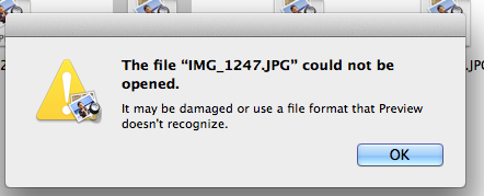

b0rnav Posted October 23, 2013 Share Posted October 23, 2013 Update on my issue with 10.9: ASUS Gene V 2500K Using 7 series port on back Latest GenericUSBXHCI available. 10.8.5 - All works without issues. 10.9 (retail) - USB3 Drive (Seagate 2TB) detected and mounting but reading/writing give errors (as attached). Link to comment https://www.insanelymac.com/forum/topic/286860-genericusbxhci-usb-30-driver-for-os-x-with-source/page/16/#findComment-1956953 Share on other sites More sharing options...
Zenith432 Posted October 23, 2013 Author Share Posted October 23, 2013 poispois, b0rnav: boot with kernel flag -gux_no_idle. nikk: 1.2.7d8. 2 Link to comment https://www.insanelymac.com/forum/topic/286860-genericusbxhci-usb-30-driver-for-os-x-with-source/page/16/#findComment-1957009 Share on other sites More sharing options...
nikk Posted October 23, 2013 Share Posted October 23, 2013 nikk: 1.2.7d8. It works ) No more panic ) Thanks! But only in RO mode with Apple driver in case of ASMedia and in RW mode with Paragon driver in case of NEC. Does it xhci version dependent? Don't you have any info why ASM1042 doesn't detected if inserted after boot? Is it firmware issue? I read this chipset also (as Nec 720202) supports streams, but there is only xhci 0.96 compliance according Windows Driver info, not 1.0, and it works in BOT there. Do I need special fw to enable UAS for it? ufsd_NTFS.util_2013-10-23-143958_mbp17.crash.txt Link to comment https://www.insanelymac.com/forum/topic/286860-genericusbxhci-usb-30-driver-for-os-x-with-source/page/16/#findComment-1957038 Share on other sites More sharing options...
Zenith432 Posted October 23, 2013 Author Share Posted October 23, 2013 nikk, you can disable UAS by adding the following In GenericUSBXHCI.kext/Contents/Info.plist <key>DisableUAS</key> <true/> (this should be inside the personality, e.g. after IOProbeScore). This will disable UAS on all your xhci controllers, so if UAS works with Renesas, but not with ASM1042 - you lose both. It will revert to BOT. I don't know why ASM1042 card is not detected. Look in the ioregistry after connecting the card to see if the device exists. (get IORegistryExplorer from Apple) PCIe hotplug is handled by IOPCIFamily, and driver matching is handed by IOKit, so if device appears, GenericUSBXHCI should be loaded for it automatically (like it is with Renesas chip.) Streams were an official feature of 0.96 - so that should not be a problem. It's probably good to update the 720202 to its latest firmware - but that will not change the 0.96 to 1.00, and will not change the status of streams (other than possible bugfixes...) Anyhow, if UAS works then streams work - as they're a required and mandatory feature for superspeed UAS. Link to comment https://www.insanelymac.com/forum/topic/286860-genericusbxhci-usb-30-driver-for-os-x-with-source/page/16/#findComment-1957044 Share on other sites More sharing options...
nikk Posted October 23, 2013 Share Posted October 23, 2013 Zenith432, UAS (streams) work perfectly with 720202 (and it's xhci 1.0, 720200 is xhci 0.96). It doesn't work in Windows 8 on ASM1042, so I'm trying to understand why and how turn it on there also ;-) No thoughts why ufsd_NTFS crashed on 1042 and works perfectly on NEC with ASM1051E enclosure? I tested NTFS volume on flash disk. It works in RW mode on both cards... But that flash disk (Sandisk Extreme USB 3.0) doesn't support streams, maybe that's the difference... Link to comment https://www.insanelymac.com/forum/topic/286860-genericusbxhci-usb-30-driver-for-os-x-with-source/page/16/#findComment-1957051 Share on other sites More sharing options...
Zenith432 Posted October 23, 2013 Author Share Posted October 23, 2013 Has it occurred to you that streams may be broken on ASM1042, which is why ASMedia's own Windows driver disables it and why you're getting the failure in ufsd_NTFS? That's why I ask that you please disable UAS manually with property I showed above - to see if ASM1042 continues to fail with ASM1051E. There's no convenient way for me to disable UAS on a xhci model-specific basis except to hardcode it. It's hardcoded for Etron because I know those are broken. I don't know which other chips have broken streams. FreeBSD disables UAS on all chips just to be safe. This means UAS extra performance is lost even on chips that support streams. So it's on by default. If UAS doesn't work with ASM1042, I'll add a quirk to disable it. 1 Link to comment https://www.insanelymac.com/forum/topic/286860-genericusbxhci-usb-30-driver-for-os-x-with-source/page/16/#findComment-1957058 Share on other sites More sharing options...
nikk Posted October 23, 2013 Share Posted October 23, 2013 If UAS doesn't work with ASM1042, I'll add a quirk to disable it. How to check It works? I can access NTFS Volume in RO mode. It's an issue of third party driver. I bet with HFS+ all will be fine... I hear UAS enabled on ASUS motherboards with ASM1042 and they have their driver also. It's better to have possibility to disable it in Info.plist by user side (in case of some weird behaviour). There are not much difference in running configs as I see. Also, can't we define personalities ant their options in that plist file by chipset ID? I saw options per device can be defined in arrays inside IOKitPersonalities (in Info.plist). SATSMARTDriver as example. Can't this be defined like this: <key>GenericUSBXHCI</key> <dict> <key>CFBundleIdentifier</key> <string>net.osx86.kexts.GenericUSBXHCI</string> <key>IOClass</key> <string>GenericUSBXHCI</string> <key>IOPCIClassMatch</key> <string>0x0c033000</string> <key>IOPCIPauseCompatible</key> <true/> <key>IOPCITunnelCompatible</key> <true/> <key>IOProbeScore</key> <integer>100</integer> <key>IOProviderClass</key> <string>IOPCIDevice</string> <key>IOUserClientClass</key> <string>IOUSBControllerUserClient</string> </dict> <key>GenericUSBXHCI_ASM1042</key> <dict> <key>CFBundleIdentifier</key> <string>net.osx86.kexts.GenericUSBXHCI</string> <key>IOClass</key> <string>GenericUSBXHCI</string> <key>IOPCIClassMatch</key> <string>0x0c033000</string> <key>IOPCIPauseCompatible</key> <true/> <key>IOPCITunnelCompatible</key> <true/> <key>IOProbeScore</key> <integer>200</integer> <key>IOProviderClass</key> <string>IOPCIDevice</string> <key>IOUserClientClass</key> <string>IOUSBControllerUserClient</string> <key>Product Identification</key> <string>0x1042</string> <key>Vendor Identification</key> <string>0x1b21</string> <key>DisableUAS</key> <true/> </dict> P.S. Disabling UAS by <key>DisableUAS</key> <true/> fixes Paragon driver incompatibility with ASM1042. So it can be a workaround for some users with the same hardware combinations. I'll try newer firmware to check the difference (can't flash it because it have DOS flasher, and I don't have dos on MacBookPro). Can't see any difference in xhcidump caps / running except MFIndex 965 <> MFIndex 5784 and # Configured Endpoints 5 <> # Configured Endpoints 3 between them. P.P.S. I have no issues with ASM1051E connected to ASM1042 without disabled UAS, if HDD have HFS+ filesystem. It works as expected. No issues or errors at all. dump-asm1042-asm1051e-ERROR.txt dump-asm1042-sandisk-OK.txt dump-nec-asm1051e-OK.txt dump-nec-sandisk-OK.txt dump-asm1042-asm1051e-noUAS-OK.txt Link to comment https://www.insanelymac.com/forum/topic/286860-genericusbxhci-usb-30-driver-for-os-x-with-source/page/16/#findComment-1957064 Share on other sites More sharing options...
Gringo Vermelho Posted October 23, 2013 Share Posted October 23, 2013 Has it occurred to you that streams may be broken on ASM1042, which is why ASMedia's own Windows driver disables it and why you're getting the failure in ufsd_NTFS? That's why I ask that you please disable UAS manually with property I showed above - to see if ASM1042 continues to fail with ASM1051E. If UAS doesn't work with ASM1042, I'll add a quirk to disable it. There are firmware updates for the ASM1042: http://www.station-drivers.com/index.php/10-drivers/40-asmedia I updated mine (Asus P8Z77-V Pro) but my USB 3.0 flash drive was stolen..so I can't say if anything has improved. 1 Link to comment https://www.insanelymac.com/forum/topic/286860-genericusbxhci-usb-30-driver-for-os-x-with-source/page/16/#findComment-1957148 Share on other sites More sharing options...
poispois Posted October 23, 2013 Share Posted October 23, 2013 Is it possible to boot like this is Clover? With the flag -gux_no_idle I get no boot. Is your driver the same from Pandora's Box? poispois, b0rnav: boot with kernel flag -gux_no_idle. nikk: 1.2.7d8. Got it working with -gux_no_idle. Thanks for your driver and support also. Link to comment https://www.insanelymac.com/forum/topic/286860-genericusbxhci-usb-30-driver-for-os-x-with-source/page/16/#findComment-1957180 Share on other sites More sharing options...
Zenith432 Posted October 23, 2013 Author Share Posted October 23, 2013 How to check It works? I can access NTFS Volume in RO mode. It's an issue of third party driver. I bet with HFS+ all will be fine...P.P.S. I have no issues with ASM1051E connected to ASM1042 without disabled UAS, if HDD have HFS+ filesystem. It works as expected. No issues or errors at all. Yes, but there is something odd going on. - ASM1042 + HFS + UAS - no problems. - ASM1042 + NTFS + Paragon + UAS - RO - Renesas 720202 + NTFS + Paragon + UAS - no problems. Paragon NTFS should not notice the difference between presence of ASM1042 and Renesas. Obviously it does. The reason is that some packets are timing out and it's getting some errors. That's also what was causing your KP (the errors were being mishandled.) Now Paragon is getting some errors - and falling back to RO mode (which for some reason works.) If all goes as planned (which it does on Renesas), it should not experience packet errors. Also, can't we define personalities ant their options in that plist file by chipset ID? Yes, of course, but I'll be damned if I'm going to start explaining to people how to do that. If you already know - great. MFIndex 965 <> MFIndex 5784 and # Configured Endpoints 5 <> # Configured Endpoints 3 between them. This is due to UAS uses 5 endpoints and BOT uses 3 endpoints... I'll leave UAS enabled for ASM1042 for the time being, since it's just Paragon NTFS that's running into trouble. Link to comment https://www.insanelymac.com/forum/topic/286860-genericusbxhci-usb-30-driver-for-os-x-with-source/page/16/#findComment-1957229 Share on other sites More sharing options...
nikk Posted October 23, 2013 Share Posted October 23, 2013 I'll leave UAS enabled for ASM1042 for the time being, since it's just Paragon NTFS that's running into trouble. Alter some more testing, I was wrong. ASM1042 doesn't work in UAS mode well on any FS. In case of HFS+, I can read contents, I can write small files, but on big amounts of data writes it gives me an error (-36). Spotlight can't finish index volume. Also, there is weird values for writes in AJA System Test with such volume. It not firmware dependent. Flashed my card with Asus's xHCI_v120816_02_02_6D, original xHCI_v110930_00_02_53, earlier xHCI_v110914_00_02_51. All the same. Not tested only HighPoint's one, it's for DOS flasher. It's all about native HFS+ volume. In BOT there is no issues. So, at least for now, it's better to fallback to BOT for ASM1042. UAS also disabled in Windows 8 native and ASMedia driver for this chipset. So, the best external option for mac is Renesas upd720202 as I understand ;-) It supports streams well and works like a charm (hotpug). It even works in UAS mode (if supported) on Windows 8 native driver ;-) asm1042.txt Link to comment https://www.insanelymac.com/forum/topic/286860-genericusbxhci-usb-30-driver-for-os-x-with-source/page/16/#findComment-1957328 Share on other sites More sharing options...
b0rnav Posted October 24, 2013 Share Posted October 24, 2013 poispois, b0rnav: boot with kernel flag -gux_no_idle. nikk: 1.2.7d8. Thanks for your support. Tried that. Same issue. Its quiet odd. All structures and substructures are properly enumerated but cant actually read any of the files without some OS error. Let me know if i could provide any other diagnostics info. Borna. Link to comment https://www.insanelymac.com/forum/topic/286860-genericusbxhci-usb-30-driver-for-os-x-with-source/page/16/#findComment-1957421 Share on other sites More sharing options...

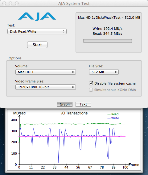

jimmbobb Posted October 25, 2013 Share Posted October 25, 2013 Thanks for the brilliant work! I have an external usb 3.0 dual drive enclosure - Nextar MX, set up as 2 individual drives. Weird thing is that I'm getting 100MB/s throughput on the one drive, but only about 48MB/s on the other. The two drives are identical WD drives. These drives were operating flawlessly at the higher data rate under M/L - this problem occurred immediately after upgrade to Mavericks. What could be causing this? Cheers Link to comment https://www.insanelymac.com/forum/topic/286860-genericusbxhci-usb-30-driver-for-os-x-with-source/page/16/#findComment-1958068 Share on other sites More sharing options...
