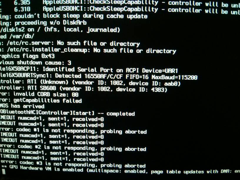

miscz Posted November 11, 2014 Share Posted November 11, 2014 This is the last thing visible before it boots to desktop and stops at the still spinning beach ball. It boots ok with -x but obviously that's not a solution. Link to comment https://www.insanelymac.com/forum/topic/285760-help-topic-for-help-in-os-x-yosemite-1010-and-below/page/86/#findComment-2084269 Share on other sites More sharing options...
icemank121 Posted November 12, 2014 Share Posted November 12, 2014 This is the last thing visible before it boots to desktop and stops at the still spinning beach ball. It boots ok with -x but obviously that's not a solution.uploadfromtaptalk1415749704502.jpg You probably need this IOPCIFamily, install with Kext Helper for Yosemite and reboot. Theres also a Clover patch as well for it. http://www.insanelymac.com/forum/topic/302075-amd-yosemite-kernel-testing-for-help-use-the-help-topic/page-6?do=findComment&comment=2083624 Link to comment https://www.insanelymac.com/forum/topic/285760-help-topic-for-help-in-os-x-yosemite-1010-and-below/page/86/#findComment-2084277 Share on other sites More sharing options...

miscz Posted November 12, 2014 Share Posted November 12, 2014 You probably need this IOPCIFamily, install with Kext Helper for Yosemite and reboot. Theres also a Clover patch as well for it. http://www.insanelymac.com/forum/topic/302075-amd-yosemite-kernel-testing-for-help-use-the-help-topic/page-6?do=findComment&comment=2083624 Thanks, this made boot progress a bit, up to login screen. 90% of time it spins a beach ball after typing password, sometimes it gets to desktop but works without qe/ci. PCI IDs for my GPU (HD7850) were in stock kexts so it should work out of the box. What could be wrong? Link to comment https://www.insanelymac.com/forum/topic/285760-help-topic-for-help-in-os-x-yosemite-1010-and-below/page/86/#findComment-2084314 Share on other sites More sharing options...

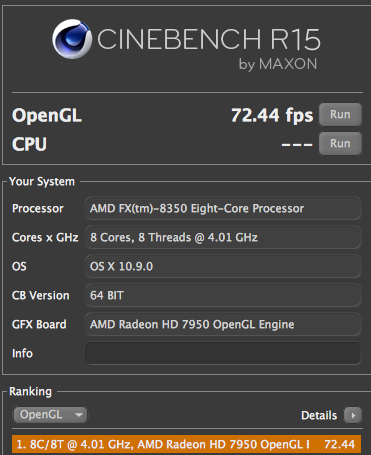

spakk Posted November 12, 2014 Share Posted November 12, 2014 ... I am not yet come to start my AMD Hackintosh Regarding to post here the details of Cinebench R15... sory, Gils Link to comment https://www.insanelymac.com/forum/topic/285760-help-topic-for-help-in-os-x-yosemite-1010-and-below/page/86/#findComment-2084537 Share on other sites More sharing options...
gils83 Posted November 12, 2014 Share Posted November 12, 2014 ... I am not yet come to start my AMD Hackintosh Regarding to post here the details of Cinebench R15... sory, Gils not problem cinebench , it's problem screen white on Yosemite (Asus M5A97pro / HD 7950 ) Link to comment https://www.insanelymac.com/forum/topic/285760-help-topic-for-help-in-os-x-yosemite-1010-and-below/page/86/#findComment-2084546 Share on other sites More sharing options...

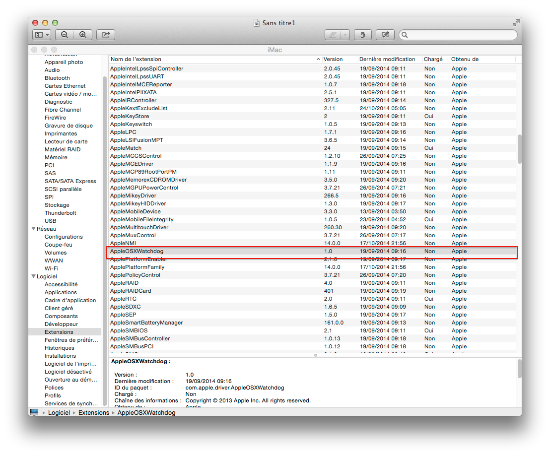

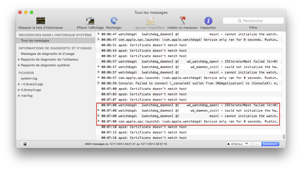

miscz Posted November 13, 2014 Share Posted November 13, 2014 tu es dieux le père !!! j'aurais jamais cru que ça marche !!! seulement , il y a beaucoup de kext à remplacer qui dépendent de ACPIPlaform Mavericks , impressionnant , je vais faire un mkext de ceux ML 10.9 (13A603) Merci hervé you are the father gods !!! I never thought that it works !!! only, there is a lot of kext to replace dependent ACPIPlaform Mavericks, awesome, I'll make a mkext those ML 10.9 (13A603) Herve thank you I can say that it might work. I rolled back this kext and got past spinning beach ball. USB doesn't work at all now but it's a start. Link to comment https://www.insanelymac.com/forum/topic/285760-help-topic-for-help-in-os-x-yosemite-1010-and-below/page/86/#findComment-2084653 Share on other sites More sharing options...
gils83 Posted November 13, 2014 Share Posted November 13, 2014 I can say that it might work. I rolled back this kext and got past spinning beach ball. USB doesn't work at all now but it's a start. il faut récupérer tout ce qui dépend de ACPIP de Mavericks , les usb en font partis we need to get everything depends ACPIP's Mavericks, usb make parties ; boot -v for see kext no loading and you list kext résultat kabini_10.10.mp4.zip 1 Link to comment https://www.insanelymac.com/forum/topic/285760-help-topic-for-help-in-os-x-yosemite-1010-and-below/page/86/#findComment-2084659 Share on other sites More sharing options...
